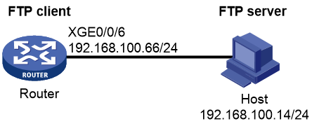

As shown in Figure 1, the host is connected to Ten-GigabitEthernet 0/0/6 of the router. The router acts as the FTP client and the host acts as the FTP server. Configure the network to meet the following requirements:
· Use FTP to download software upgrade file test.ipe from the FTP server to the FTP client to upgrade the router.
· Use username 123456 and password 123456 to log in to the FTP server.

interface Ten-GigabitEthernet0/0/6
ip address 192.168.100.66 255.255.255.0
