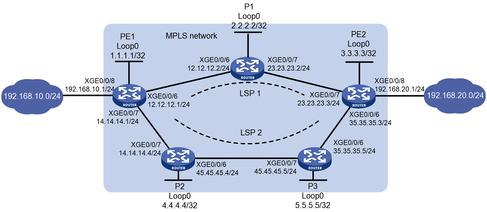

Example: Configuring dynamical LSPs by using LDP
As shown in Figure 2, on the MPLS network of the carrier, PE 1 and PE 2 have two routes to each other.
·     Configure LDP on the MPLS network to dynamically establish LSPs, so subnets 192.168.10.0/24 and 192.168.20.0/24 can transmit packets to each other over the LSPs.
·     By default, packets are transmitted over LSP 1. When LSP 1 fails, packets are transmitted over LSP 2.
·     All devices on the MPLS network allow only routes destined for 1.1.1.1/32, 2.2.2.2/32, 3.3.3.3/32, 4.4.4.4/32, 5.5.5.5/32, 192.168.10.0/24, and 192.168.20.0/24 to trigger LDP to establish LSPs. Other routes are not allowed to trigger LSP establishment to avoid affecting device performance due to excessive LSPs.
Figure 2 Network diagram
Analysis
·     To create LSPs dynamically through LDP, configure a routing protocol to ensure IP connectivity between the LSRs. This example uses OSPF.
·     To use LSP 1 as the primary LSP and LSP 2 as the backup LSP for packet forwarding, configure the primary route between subnet 192.168.10.0/24 and 192.168.20.0/24 as LSP 1 and the backup route as LSP 2. In this example, OSPF automatically calculates the route cost for LSP 1 to be smaller than that for LSP 2, so LSP 1 is preferred.
·     To ensure that LDP establishes LSPs only for specific routes, configure LSP generation policies on each LSR.

Table 1 Assign IP addresses to the network interfaces.
Configure IP addresses and masks for interfaces as shown in Figure 2. (Details not shown.)
Table 2 Configure OSPF on each router to ensure IP connectivity between them:
# Configure PE 1.
[PE1] ospf 1
[PE1-ospf-1] area 0
[PE1-ospf-1-area-0.0.0.0] network 1.1.1.1 0.0.0.0
[PE1-ospf-1-area-0.0.0.0] network 12.12.12.0 0.0.0.255
[PE1-ospf-1-area-0.0.0.0] network 14.14.14.0 0.0.0.255
[PE1-ospf-1-area-0.0.0.0] network 192.168.10.0 0.0.0.255
[PE1-ospf-1-area-0.0.0.0] quit
[PE1-ospf-1] quit
# Configure P 1.
[P1] ospf 1
[P1-ospf-1] area 0
[P1-ospf-1-area-0.0.0.0] network 2.2.2.2 0.0.0.0
[P1-ospf-1-area-0.0.0.0] network 12.12.12.0 0.0.0.255
[P1-ospf-1-area-0.0.0.0] network 23.23.23.0 0.0.0.255
[P1-ospf-1-area-0.0.0.0] quit
[P1-ospf-1] quit
# Configure P 2.
[P2] ospf 1
[P2-ospf-1] area 0
[P2-ospf-1-area-0.0.0.0] network 4.4.4.4 0.0.0.0
[P2-ospf-1-area-0.0.0.0] network 14.14.14.0 0.0.0.255
[P2-ospf-1-area-0.0.0.0] network 45.45.45.0 0.0.0.255
[P2-ospf-1-area-0.0.0.0] quit
[P2-ospf-1] quit
# Configure P 3.
[P3] ospf 1
[P3-ospf-1] area 0
[P3-ospf-1-area-0.0.0.0] network 5.5.5.5 0.0.0.0
[P3-ospf-1-area-0.0.0.0] network 45.45.45.0 0.0.0.255
[P3-ospf-1-area-0.0.0.0] network 35.35.35.0 0.0.0.255
[P3-ospf-1-area-0.0.0.0] quit
[P3-ospf-1] quit
# Configure PE 2.
[PE2] ospf 1
[PE2-ospf-1] area 0
[PE2-ospf-1-area-0.0.0.0] network 3.3.3.3 0.0.0.0
[PE2-ospf-1-area-0.0.0.0] network 23.23.23.0 0.0.0.255
[PE2-ospf-1-area-0.0.0.0] network 35.35.35.0 0.0.0.255
[PE2-ospf-1-area-0.0.0.0] network 192.168.20.0 0.0.0.255
[PE2-ospf-1-area-0.0.0.0] quit
[PE2-ospf-1] quit
# After the configuration is completed, execute the display ospf routing command on each router to verify that the routers have learned the routes to each other. Use PE1 as an example:
[PE1] display ospf routing
       OSPF Process 1 with Router ID 1.1.1.1
                   Routing Table

PE 1 should have established OSPF peering with P 1 and P 2, and PE 2 with P 2 and P 3. Execute the display ospf peer verbose command to verify that the OSPF neighbors are in Full state. Use PE1 as an example:
[PE1] display ospf peer verbose
                  Neighbors
 Area 0.0.0.0 interface 14.14.14.1(Ten-GigabitEthernet0/0/7)'s neighbors
 Router ID: 4.4.4.4          Address: 14.14.14.4       GR state: Normal
   State:  Full  Mode: Nbr is master  Priority: 1
   DR: 14.14.14.4  BDR: 14.14.14.1  MTU: 0
   Options is 0x42 (-|O|-|-|-|-|E|-)
   Dead timer due in 40  sec
   Neighbor is up for 00:03:30
   Authentication Sequence: [ 0 ]
   Neighbor state change count: 6
   BFD status: Disabled
                  Neighbors
 Area 0.0.0.0 interface 12.12.12.1(Ten-GigabitEthernet0/0/6)'s neighbors
 Router ID: 2.2.2.2          Address: 12.12.12.2       GR state: Normal
   DR: 12.12.12.2  BDR: 12.12.12.1  MTU: 0
   Dead timer due in 36  sec
   Neighbor is up for 00:03:24
Table 3 Enable basic MPLS and MPLS LDP:
# Configure PE 1.
[PE1] mpls lsr-id 1.1.1.1
[PE1] mpls ldp
[PE1-ldp] quit
[PE1] interface ten-gigabitethernet 0/0/6
[PE1-Ten-GigabitEthernet0/0/6] mpls enable
[PE1-Ten-GigabitEthernet0/0/6] mpls ldp enable
[PE1-Ten-GigabitEthernet0/0/6] quit
[PE1] interface ten-gigabitethernet 0/0/7
[PE1-Ten-GigabitEthernet0/0/7] mpls enable
[PE1-Ten-GigabitEthernet0/0/7] mpls ldp enable
[PE1-Ten-GigabitEthernet0/0/7] quit
# Configure P 1.
[P1] mpls lsr-id 2.2.2.2
[P1] mpls ldp
[P1-ldp] quit
[P1] interface ten-gigabitethernet 0/0/6
[P1-Ten-GigabitEthernet0/0/6] mpls enable
[P1-Ten-GigabitEthernet0/0/6] mpls ldp enable
[P1-Ten-GigabitEthernet0/0/6] quit
[P1] interface ten-gigabitethernet 0/0/7
[P1-Ten-GigabitEthernet0/0/7] mpls enable
[P1-Ten-GigabitEthernet0/0/7] mpls ldp enable
[P1-Ten-GigabitEthernet0/0/7] quit
# Configure P 2.
[P2] mpls lsr-id 4.4.4.4
[P2] mpls ldp
[P2-ldp] quit
[P2] interface ten-gigabitethernet 0/0/6
[P2-Ten-GigabitEthernet0/0/6] mpls enable
[P2-Ten-GigabitEthernet0/0/6] mpls ldp enable
[P2-Ten-GigabitEthernet0/0/6] quit
[P2] interface ten-gigabitethernet 0/0/7
[P2-Ten-GigabitEthernet0/0/7] mpls enable
[P2-Ten-GigabitEthernet0/0/7] mpls ldp enable
[P2-Ten-GigabitEthernet0/0/7] quit
# Configure P 3.
[P3] mpls lsr-id 5.5.5.5
[P3] mpls ldp
[P3-ldp] quit
[P3] interface ten-gigabitethernet 0/0/6
[P3-Ten-GigabitEthernet0/0/6] mpls enable
[P3-Ten-GigabitEthernet0/0/6] mpls ldp enable
[P3-Ten-GigabitEthernet0/0/6] quit
[P3] interface ten-gigabitethernet 0/0/7
[P3-Ten-GigabitEthernet0/0/7] mpls enable
[P3-Ten-GigabitEthernet0/0/7] mpls ldp enable
[P3-Ten-GigabitEthernet0/0/7] quit
# Configure PE 2.
[PE2] mpls lsr-id 3.3.3.3
[PE2] mpls ldp
[PE2-ldp] quit
[PE2] interface ten-gigabitethernet 0/0/6
[PE2-Ten-GigabitEthernet0/0/6] mpls enable
[PE2-Ten-GigabitEthernet0/0/6] mpls ldp enable
[PE2-Ten-GigabitEthernet0/0/6] quit
[PE2] interface ten-gigabitethernet 0/0/7
[PE2-Ten-GigabitEthernet0/0/7] mpls enable
[PE2-Ten-GigabitEthernet0/0/7] mpls ldp enable
[PE2-Ten-GigabitEthernet0/0/7] quit
After the configuration is completed, PE 1 should have established local LDP sessions with P 1 and P 2, and PE 2 with P 2 and P 3.
Execute the display mpls ldp peer command on each router to view the LDP peer information. Use PE1 as an example:
[PE1] display mpls ldp peer
Total number of peers: 2
Peer LDP ID             State         Role     GR   MD5  KA Sent/Rcvd
2.2.2.2:0               Operational   Passive  Off  Off  55/55
4.4.4.4:0               Operational   Passive  Off  Off  6/6
Table 4 Configure an LSP generation policy to establish LSPs for routes destined for 1.1.1.1/32, 2.2.2.2/32, 3.3.3.3/32, 4.4.4.4/32, 5.5.5.5/32, 192.168.10.0/24, and 192.168.20.0/24:
# On PE 1, configure IP prefix list PE1, and configure LDP to use only the routes permitted by the prefix list to establish LSPs.
[PE1] ip prefix-list PE1 index 10 permit 1.1.1.1 32
[PE1] ip prefix-list PE1 index 20 permit 2.2.2.2 32
[PE1] ip prefix-list PE1 index 30 permit 3.3.3.3 32
[PE1] ip prefix-list PE1 index 40 permit 4.4.4.4 32
[PE1] ip prefix-list PE1 index 50 permit 5.5.5.5 32
[PE1] ip prefix-list PE1 index 60 permit 192.168.10.0 24
[PE1] ip prefix-list PE1 index 70 permit 192.168.20.0 24
[PE1] mpls ldp
[PE1-ldp] lsp-trigger prefix-list PE1
[PE1-ldp] quit
# On P 1, configure IP prefix list P1, and configure LDP to use only the routes permitted by the prefix list to establish LSPs.
[P1] ip prefix-list P1 index 10 permit 1.1.1.1 32
[P1] ip prefix-list P1 index 20 permit 2.2.2.2 32
[P1] ip prefix-list P1 index 30 permit 3.3.3.3 32
[P1] ip prefix-list P1 index 40 permit 4.4.4.4 32
[P1] ip prefix-list P1 index 50 permit 5.5.5.5 32
[P1] ip prefix-list P1 index 60 permit 192.168.10.0 24
[P1] ip prefix-list P1 index 70 permit 192.168.20.0 24
[P1] mpls ldp
[P1-ldp] lsp-trigger prefix-list P1
[P1-ldp] quit
# On P 2, configure IP prefix list P2, and configure LDP to use only the routes permitted by the prefix list to establish LSPs.
[P2] ip prefix-list P2 index 10 permit 1.1.1.1 32
[P2] ip prefix-list P2 index 20 permit 2.2.2.2 32
[P2] ip prefix-list P2 index 30 permit 3.3.3.3 32
[P2] ip prefix-list P2 index 40 permit 4.4.4.4 32
[P2] ip prefix-list P2 index 50 permit 5.5.5.5 32
[P2] ip prefix-list P2 index 60 permit 192.168.10.0 24
[P2] ip prefix-list P2 index 70 permit 192.168.20.0 24
[P2] mpls ldp
[P2-ldp] lsp-trigger prefix-list P2
[P2-ldp] quit
# On P 3, configure IP prefix list P3, and configure LDP to use only the routes permitted by the prefix list to establish LSPs.
[P3] ip prefix-list P3 index 10 permit 1.1.1.1 32
[P3] ip prefix-list P3 index 20 permit 2.2.2.2 32
[P3] ip prefix-list P3 index 30 permit 3.3.3.3 32
[P3] ip prefix-list P3 index 40 permit 4.4.4.4 32
[P3] ip prefix-list P3 index 50 permit 5.5.5.5 32
[P3] ip prefix-list P3 index 60 permit 192.168.10.0 24
[P3] ip prefix-list P3 index 70 permit 192.168.20.0 24
[P3] mpls ldp
[P3-ldp] lsp-trigger prefix-list P3
[P3-ldp] quit
# On PE 2, configure IP prefix list PE 2, and configure LDP to use only the routes permitted by the prefix list to establish LSPs.
[PE2] ip prefix-list PE2 index 10 permit 1.1.1.1 32
[PE2] ip prefix-list PE2 index 20 permit 2.2.2.2 32
[PE2] ip prefix-list PE2 index 30 permit 3.3.3.3 32
[PE2] ip prefix-list PE2 index 40 permit 4.4.4.4 32
[PE2] ip prefix-list PE2 index 50 permit 5.5.5.5 32
[PE2] ip prefix-list PE2 index 60 permit 192.168.10.0 24
[PE2] ip prefix-list PE2 index 70 permit 192.168.20.0 24
[PE2] mpls ldp
[PE2-ldp] lsp-trigger prefix-list PE2
[PE2-ldp] quit
After the configuration is completed, execute the display mpls ldp lsp command on PE 1 to view LDP LSP information. The output shows that the LSP destined for subnet 192.168.20.0/24 uses P 1 as the next hop by default.
[PE1] display mpls ldp lsp
Status Flags: * - stale, L - liberal, B - backup
  FECs: 7      Ingress LSPs: 5     Transit LSPs: 5     Egress LSPs: 2
FEC                In/Out Label    Nexthop         OutInterface
1.1.1.1/32         3/-
                   -/1151(L)
                   -/1151(L)
2.2.2.2/32         -/3             12.12.12.2      XGE0/0/6
                   1151/3          12.12.12.2      XGE0/0/6
                   -/1150(L)
3.3.3.3/32         -/1150          12.12.12.2      XGE0/0/6
                   1150/1150       12.12.12.2      XGE0/0/6
                   -/1148(L)
4.4.4.4/32         -/1149(L)
                   -/3             14.14.14.4      XGE0/0/7
                   1149/3          14.14.14.4      XGE0/0/7
5.5.5.5/32         -/1148(L)
                   -/1149          14.14.14.4      XGE0/0/7
                   1148/1149       14.14.14.4      XGE0/0/7
192.168.10.0/24    1145/-
                   -/1146(L)
                   -/1146(L)
192.168.20.0/24    -/1147          12.12.12.2      XGE0/0/6
                   1146/1147       12.12.12.2      XGE0/0/6
                   -/1147(L)
# Perform MPLS ping to test the validity and reachability of an MPLS LSP.
[PE1] ping mpls -a 192.168.10.1 ipv4 192.168.20.0 24
MPLS ping FEC 192.168.20.0/24 with 100 bytes of data:
100 bytes from 23.23.23.3: Sequence=1 time=2 ms
100 bytes from 23.23.23.3: Sequence=2 time=2 ms
100 bytes from 23.23.23.3: Sequence=3 time=2 ms
100 bytes from 23.23.23.3: Sequence=4 time=2 ms
100 bytes from 23.23.23.3: Sequence=5 time=2 ms
--- Ping statistics for FEC 192.168.20.0/24 ---
5 packets transmitted, 5 packets received, 0.0% packet loss
Round-trip min/avg/max = 2/2/2 ms
# When P 1 fails, execute the display mpls ldp lsp command. The output shows that the LSP destined for subnet 192.168.20.0/24 uses P 2 as the next hop.
1.1.1.1/32         3/-
                   -/1150(L)
2.2.2.2/32         -/1149          14.14.14.4      XGE0/0/7
                   1150/1149       14.14.14.4      XGE0/0/7
3.3.3.3/32         -/1148          14.14.14.4      XGE0/0/7
                   1147/1148       14.14.14.4      XGE0/0/7
4.4.4.4/32         -/3             14.14.14.4      XGE0/0/7
5.5.5.5/32         -/1151          14.14.14.4      XGE0/0/7
                   1148/1151       14.14.14.4      XGE0/0/7
192.168.10.0/24    1151/-
                   -/1146(L)
                   -/1146(L)
192.168.20.0/24    -/1147          14.14.14.4      XGE0/0/7
                   1146/1147       14.14.14.4      XGE0/0/7
100 bytes from 35.35.35.3: Sequence=1 time=1 ms
100 bytes from 35.35.35.3: Sequence=2 time=1 ms
100 bytes from 35.35.35.3: Sequence=3 time=1 ms
100 bytes from 35.35.35.3: Sequence=4 time=1 ms
100 bytes from 35.35.35.3: Sequence=5 time=1 ms
Round-trip min/avg/max = 1/1/1 ms
Configuration files

·     P 3:
ospf 1
 area 0.0.0.0
 mpls lsr-id 5.5.5.5
mpls ldp
interface LoopBack0
 ip address 2.2.2.2 255,255,255,255
interface Ten-GigabitEthernet0/0/6
 port link-mode route
ip address 35.35.35.5 255.255.255.0
 mpls enable
 mpls ldp enable
ip address 45.45.45.5 255.255.255.0
 mpls enable
 mpls ldp enable
·     PE 2:
ospf 1
 area 0.0.0.0
  network 33.0.0.0 0.0.0.255
 mpls lsr-id 3.3.3.3
mpls ldp
interface LoopBack0
 ip address 3.3.3.3 255,255,255,255
ip address 35.35.35.3 255.255.255.0
 mpls enable
 mpls ldp enable
interface Ten-GigabitEthernet0/0/7
ip address 23.23.23.3 255.255.255.0
 mpls enable
 mpls ldp enable
ip address 192.168.20.1 255.255.255.0
