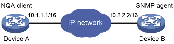

Example: Configuring a UDP jitter operation
As shown in Figure 1, configure a UDP jitter operation to test the jitter, delay, and round-trip time between Device A and Device B.
Figure 1 Network diagram
Software version used
This configuration example was created and verified on R9141P16 of the SR6602-I device.

Procedures
Configuring Device B
# Enable the NQA server.
<DeviceB> system-view
[DeviceB] nqa server enable
# Configure a UDP listening service to listen on the IP address 10.2.2.2 and UDP port 9000.
[DeviceB] nqa server udp-echo 10.2.2.2 9000
Configuring Device A
# Create a UDP jitter operation.
<DeviceA> system-view
[DeviceA] nqa entry admin test
[DeviceA-nqa-admin-test] type udp-jitter
# Configure 10.2.2.2 as the destination IP address and port 9000 as the destination port.
[DeviceA-nqa-admin-test-udp-jitter] destination ip 10.2.2.2
[DeviceA-nqa-admin-test-udp-jitter] destination port 9000
# Configure the operation to repeat at an interval of 1000 milliseconds.
[DeviceA-nqa-admin-test-udp-jitter] frequency 1000
[DeviceA-nqa-admin-test-udp-jitter] quit
# Start the UDP jitter operation.
[DeviceA] nqa schedule admin test start-time now lifetime forever
# Stop the UDP jitter operation after the operation runs for a time period, for example, 30 seconds.
[DeviceA] undo nqa schedule admin test
# Display the most recent result of the UDP jitter operation.
[DeviceA] display nqa result admin test

Example: Configuring a UDP echo operation
As shown in Figure 4, configure a UDP echo operation to test the round-trip time between Device A and Device B. The destination port number is 8000.
Figure 4 Network diagram

Example: Configuring a voice operation
As shown in Figure 5, configure a voice operation to test the jitter, delay, MOS, and ICPIF between Device A and Device B.
Figure 5 Network diagram

Example: Configuring a DLSw operation
As shown in Figure 6, configure a DLSw operation to test the response time of the DLSw device.
Figure 6 Network diagram
