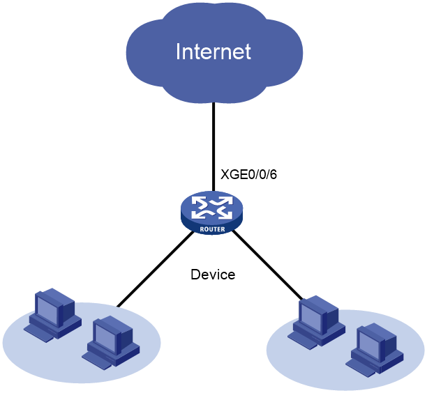

As shown in Figure 1, the device might receive a large number of ICMP packets from the Internet, which causes high CPU usage and degraded device performance. Apply a QoS policy to a control plane to police incoming ICMP packets to 640 kbps.
Analysis
By default, the device applies a predefined QoS policy to the control plane. You can use the display qos policy control-plane pre-defined command to display the predefined QoS policy applied to the control plane. Each protocol has a default rate limit value.
Use the if-match command in traffic class view to match ICMP packets, and use the car command in traffic behavior view to set the CIR to 640 kbps.

# Create traffic class ICMP, and configure it to match ICMP packets.
<Device> system-view
[Device] traffic classifier ICMP
[Device-classifier-ICMP] if-match control-plane protocol icmp
[Device-classifier-ICMP] quit
# Create traffic behavior ICMP, and configure a traffic policing action with the CIR as 640 kbps.
[Device] traffic behavior ICMP
[Device-behavior-ICMP] car cir 640
[Device-behavior-ICMP] quit
# Create QoS policy ICMP, and associate the traffic class with the traffic behavior.
[Device] qos policy ICMP
[Device-qospolicy-ICMP] classifier ICMP behavior ICMP
[Device-qospolicy-ICMP] quit
# Apply the QoS policy to the control plane.
[Device] control-plane slot 0
[Device-cp] qos apply policy ICMP inbound
[Device-cp] quit
# Use the display qos policy control-plane command to display information about the QoS policy applied to the control plane.
[Device] display qos policy control-plane slot 0
Control plane slot 0
Direction: Inbound
Policy: ICMP
Classifier: default-class
Matched : 0 (Packets) 0 (Bytes)
Operator: AND
Rule(s) :
If-match any
Behavior: be
-none-
Classifier: ICMP
Operator: AND
Rule(s) :
If-match control-plane protocol icmp
Behavior: ICMP
Committed Access Rate:
CIR 640 (kbps), CBS 40000 (Bytes), EBS 0 (Bytes)
Green action : pass
Yellow action : pass
Red action : discard
Green packets : 0 (Packets) 0 (Bytes)
Red packets : 0 (Packets) 0 (Bytes)
The output shows that the QoS policy has been correctly applied to the control plane.
