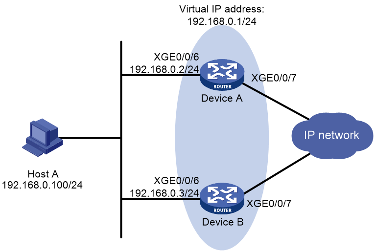

Example: Configuring a single VRRP group
As shown in Figure 1, two gateway devices are deployed at the network egress of Host A. Device A and Device B form a VRRP group that acts as the default gateway for Host A. The network requirements are as follows:
·     Device A operates as the master to forward packets from Host A to Host B.
·     When Device A fails, Device B takes over to forward packets for Host A.
·     When Device A recovers, Device A acts as the gateway again.
Figure 1 Network diagram
Analysis
·     To enable Device A to become the master in the VRRP group, you need to configure a higher priority for Device A.
·     To enable the master to automatically adjust its VRRP priority according to uplink interface state, configure preemption mode and uplink interface monitoring settings for the VRRP group. This configuration implements master/backup switchover upon a role change in the VRRP group.
·     To avoid frequent role changes in the VRRP group, configure a preemption delay.

Configuring Device A
# Configure an IP address for interface Ten-GigabitEthernet 0/0/6.
<DeviceA> system-view
[DeviceA] interface ten-gigabitethernet 0/0/6
[DeviceA-Ten-GigabitEthernet0/0/6] ip address 192.168.0.2 24
# Create VRRP group 1 and configure the virtual IP address for VRRP group 1 as 192.168.0.1.
[DeviceA-Ten-GigabitEthernet0/0/6] vrrp vrid 1 virtual-ip 192.168.0.1
# Assign Device A a higher priority than Device B in VRRP group 1, so Device A can become the master.
[DeviceA-Ten-GigabitEthernet0/0/6] vrrp vrid 1 priority 110
# Configure Device A to operate in preemptive mode, so it can become the master whenever it operates correctly. Set the preemption delay to five seconds to avoid frequent status switchover.
[DeviceA-Ten-GigabitEthernet0/0/6] vrrp vrid 1 preempt-mode delay 5
[DeviceA-Ten-GigabitEthernet0/0/6] quit
# Create track entry 1 associated with the physical state of uplink interface Ten-GigabitEthernet 0/0/7.
[DeviceA] track 1 interface ten-gigabitethernet 0/0/7
# Create track entry 1. When the track entry transits to Negative state, Device A decreases its priority by 50 in the VRRP group.
[DeviceA-Ten-GigabitEthernet0/0/6] vrrp vrid 1 track 1 priority reduced 50
Configuring Device B
<DeviceB> system-view
[DeviceB] interface ten-gigabitethernet 0/0/6
[DeviceB-Ten-GigabitEthernet0/0/6] ip address 192.168.0.3 24
[DeviceB-Ten-GigabitEthernet0/0/6] vrrp vrid 1 virtual-ip 192.168.0.1
# Set the priority of Device B to 100 in VRRP group 1.
[DeviceB-Ten-GigabitEthernet0/0/6] vrrp vrid 1 priority 100
# Configure Device B to operate in preemptive mode, and set the preemption delay to five seconds.
[DeviceB-Ten-GigabitEthernet0/0/6] vrrp vrid 1 preempt-mode delay 5
[DeviceB-Ten-GigabitEthernet0/0/6] quit
# Ping Host B from Host A. (Details not shown.)

The output shows that Device A is operating as the master in VRRP group 1 to forward packets from Host A to Host B, and Device B is the backup.
# When Device A fails, verify that Host A can still ping Host B. (Details not shown.)

The output shows that when Device A fails, Device B takes over to forward packets from Host A to Host B.
# After Device A recovers, display detailed information about VRRP group 1 on Device A.

The output shows that after Device A resumes normal operation, it becomes the master to forward packets from Host A to Host B.

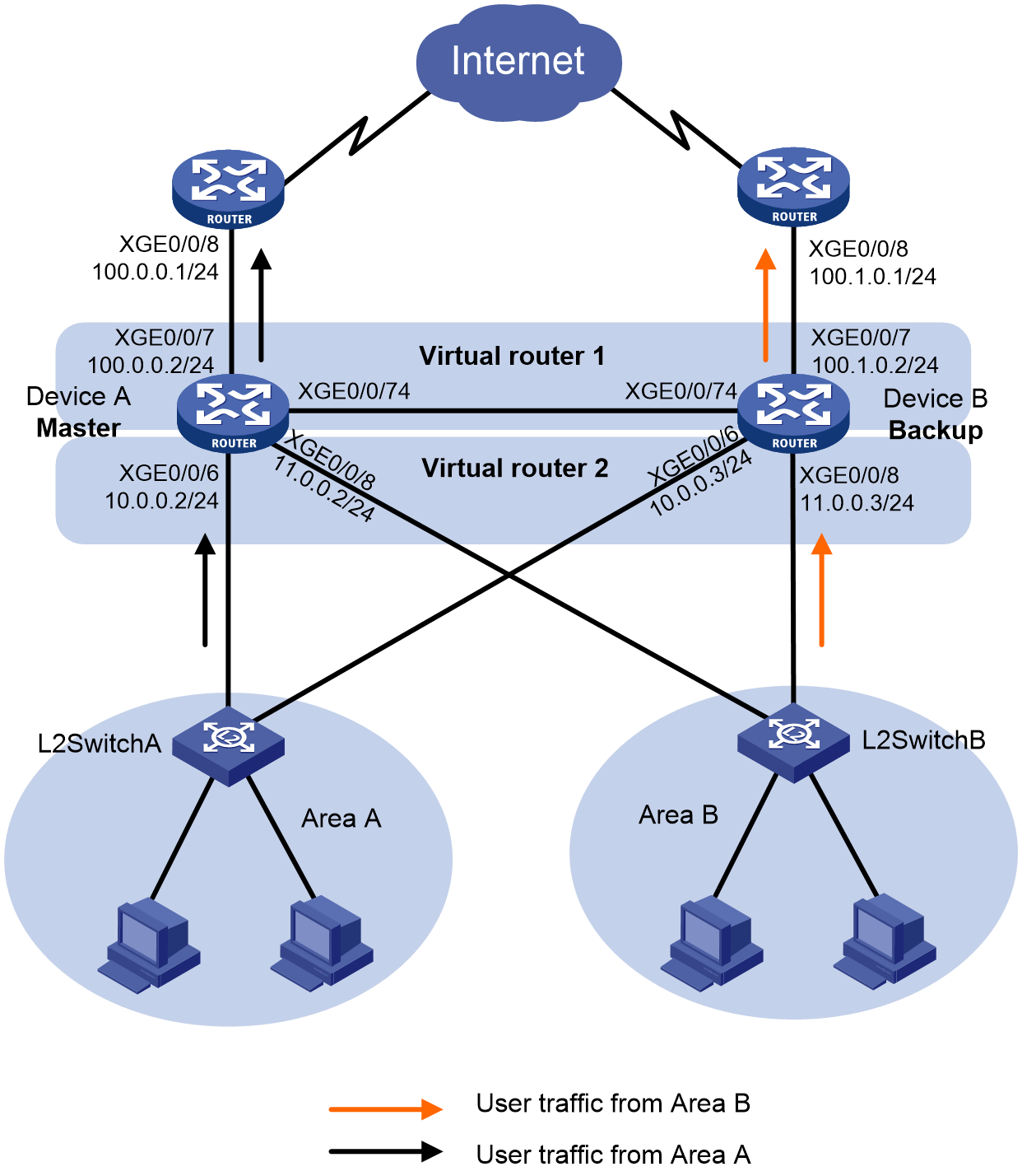

Example: Configuring multiple VRRP groups
As shown in Figure 2, to achieve gateway redundancy and load balancing for internal host traffic, a company deploys two devices at the internal network egress. Two devices formed two VRRP groups in load balancing mode as default gateways for areas A and B, respectively. The network requirements are as follows:
·     Device A operates as the master in VRRP group 1. Device B operates as the master in VRRP group 2. Typically, Device A forwards user data in area A, and Device B forwards user data in area B.
·     When Device A or its uplink interface fails, Device B takes over to forward host traffic in area A. When Device A recovers, it acts as the gateway for VRRP group 1 again.
·     When Device B or its uplink interface fails, Device A takes over to forward host traffic in area B. When Device B recovers, it acts as the gateway for VRRP group 2 again.
Figure 2 Network diagram
Analysis
·     To enable Device A to become the master in VRRP group 1, you need to configure a higher priority for Device A in VRRP group 1. To enable Device B to become the master in VRRP group 2, you need to configure a higher priority for Device B in VRRP group 2.
·     To avoid frequent role changes in the VRRP groups, configure a preemption delay.
[DeviceA-Ten-GigabitEthernet0/0/6] ip address 10.0.0.2 24
# Assign IP addresses to other interfaces in Figure 2 in the same way. (Details not shown.)
# Create VRRP group 1 and configure the virtual IP address for VRRP group 1 as 10.0.0.1. Assign Device A a higher priority than Device B in VRRP group 1, so Device A can become the master.
[DeviceA-Ten-GigabitEthernet0/0/6] vrrp vrid 1 virtual-ip 10.0.0.1
[DeviceA-Ten-GigabitEthernet0/0/6] vrrp vrid 1 priority 120
# Create VRRP group 2 and configure the virtual IP address for VRRP group 2 as 11.0.0.1.
[DeviceA] interface ten-gigabitethernet 0/0/8
[DeviceA-Ten-GigabitEthernet0/0/8] vrrp vrid 2 virtual-ip 11.0.0.1
[DeviceA-Ten-GigabitEthernet0/0/8] quit
# Configure Device A to operate in preemptive mode, and set the preemption delay to five seconds.
# Create track entry 1. When the track entry transits to Negative state, Device A decreases its priority by 50 in VRRP group 1.
[DeviceB-Ten-GigabitEthernet0/0/6] ip address 10.0.0.3 24
[DeviceB-Ten-GigabitEthernet0/0/6] vrrp vrid 1 virtual-ip 10.0.0.1
# Create VRRP group 2 and configure the virtual IP address for VRRP group 2 as 11.0.0.1. Assign Device B a higher priority than Device A in VRRP group 2, so Device B can become the master.
[DeviceB] interface ten-gigabitethernet 0/0/8
[DeviceB-Ten-GigabitEthernet0/0/8] vrrp vrid 2 virtual-ip 11.0.0.1
[DeviceB-Ten-GigabitEthernet0/0/8] vrrp vrid 2 priority 120
[DeviceB-Ten-GigabitEthernet0/0/8] vrrp vrid 2 preempt-mode delay 5
[DeviceB-Ten-GigabitEthernet0/0/8] quit
# Create track entry 2 associated with the physical state of uplink interface Ten-GigabitEthernet 0/0/7.
[DeviceB] track 2 interface ten-gigabitethernet 0/0/7
# Create track entry 2. When the track entry transits to Negative state, Device B decreases its priority by 50 in VRRP group 2.
[DeviceB-Ten-GigabitEthernet0/0/8] vrrp vrid 2 track 2 priority reduced 50
1.     Verify that the hosts in area A and area B can ping the external network.
# Ping 100.0.0.1 on host A in area A.
<host A> ping 100.0.0.1
PING 100.0.0.1 (100.0.0.1): 56 data bytes
56 bytes from 100.0.0.1: seq=0 ttl=128 time=22.43 ms
56 bytes from 100.0.0.1: seq=1 ttl=128 time=7.17 ms
56 bytes from 100.0.0.1: seq=2 ttl=128 time=8.91 ms
56 bytes from 100.0.0.1: seq=3 ttl=128 time=7.45 ms
56 bytes from 100.0.0.1: seq=4 ttl=128 time=9.11 ms
--- 100.0.0.1 ping statistics ---
5 packets transmitted, 5 packets received, 0% packet loss
round-trip min/avg/max = 7.17/11.01/22.43 ms
# Ping 100.1.0.1 on host C in area B.
<host C> ping 100.1.0.1
PING 100.1.0.1 (100.1.0.1): 56 data bytes
56 bytes from 100.1.0.1: seq=0 ttl=128 time=22.43 ms
56 bytes from 100.1.0.1: seq=1 ttl=128 time=7.17 ms
56 bytes from 100.1.0.1: seq=2 ttl=128 time=8.91 ms
56 bytes from 100.1.0.1: seq=3 ttl=128 time=7.45 ms
56 bytes from 100.1.0.1: seq=4 ttl=128 time=9.11 ms
--- 100.1.0.1 ping statistics ---
2.     Use the display vrrp verbose command to verify the configuration.
# Display detailed VRRP group information Device A. Verify that Device A is the master in VRRP group 1 and backup in VRRP group 2.
[DeviceA] display vrrp verbose
IPv4 Virtual Router Information:
 Running Mode       : Standard
 Total number of virtual routers : 2
   Interface Ten-GigabitEthernet0/0/6
     VRID           : 1                    Adver Timer  : 100
     Admin Status   : Up                   State        : Master
     Config Pri     : 120                  Running Pri  : 120
     Preempt Mode   : Yes                  Delay Time   : 5
     Auth Type      : None
     Virtual IP     : 10.0.0.1
     Virtual MAC    : 0000-5e00-0101
     Master IP      : 10.0.0.2
   VRRP Track Information:
     Track Object   : 1                   State : Positive   Pri Reduced : 50
   Interface Ten-GigabitEthernet0/0/8
     VRID           : 2                    Adver Timer  : 100
     Admin Status   : Up                   State        : Backup
     Config Pri     : 100                  Running Pri  : 100
     Preempt Mode   : Yes                  Delay Time   : 0
     Auth Type      : None
     Become Master  : 3550ms left
     Virtual IP     : 11.0.0.1
     Master IP      : 11.0.0.3
# Display detailed VRRP group information Device B. Verify that Device B is the backup in VRRP group 1 and master in VRRP group 2.
[DeviceB] display vrrp verbose
     Auth Type      : None
     Become Master  : 3500ms left
     Auth Type      : None
     Virtual MAC    : 0000-5e00-0102
     Track Object   : 2                   State : Positive   Pri Reduced : 50
# When Device A becomes faulty, execute the display vrrp verbose command to display detailed VRRP group information on Device B. Verify that Device B preempts as the master in VRRP group 1.
     Auth Type      : None
     Master IP      : 10.0.0.3
     Auth Type      : None
The output shows that the hosts in area A and area B can still ping the external network when Device A becomes faulty.
# After Device A recovers, display detailed VRRP group information on Device A.
     Auth Type      : None
     Auth Type      : None
The output shows that after Device A recovers, it resumes the original priority and becomes the master in VRRP group 1 again to forward host traffic from area A to the external network.
