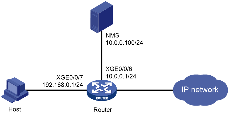

As shown in Figure 3, configure the device to monitor the incoming traffic statistic on Ten-GigabitEthernet0/0/7, and send RMON alarms when either of the following conditions is met:
· The 5-second delta sample for the traffic statistic crosses the rising threshold (10000).
· The 5-second delta sample for the traffic statistic drops below the falling threshold (5000).
Analysis
· For the NMS to manage and monitor the router, configure the SNMP agent on the router.
· For the router to periodically monitor the traffic on Ten-GigabitEthernet0/0/7, first define an RMON statistics entry to collect traffic statistics.
· For the router to send traps to the NMS when the traffic on Ten-GigabitEthernet0/0/7 is abnormal, create an alarm entry on the router, and set the alarm threshold.

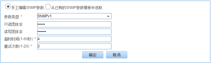

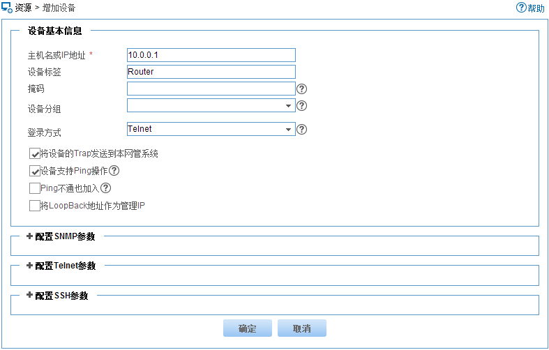

2. Configure the SNMP agent.
# Configure the SNMP agent (the device) with the same SNMP settings as the NMS at 10.0.0.100. This example uses SNMPv1, read community public, and write community private.
[Router] snmp-agent community read public
[Router] snmp-agent community write private
[Router] snmp-agent sys-info version v1

# Add a device.
2. Click the Resources tab.
3. From the navigation pane, select Resource Management > Add Device.
¡ On
the Add Device page, configure the following parameters:
Enter 10.0.0.1 in the Host Name/IP field.
¡ Set the device label to Router.
¡ Select Telnet from the Login Type list.
¡ Use the default values for other parameters.
Figure 4 Adding a device
# Expand the SNMP Settings section. Click Configure.
· Set the parameter type to SNMPv1.
· Set the read community to public.
· Set the write and read community to private.
· Use the default settings for other parameters, and then click OK.
