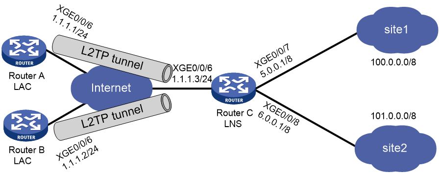

Example: Configuring multi-instance L2TP
As shown in Figure 1, multiple enterprises share Router C as an LNS, and different enterprise users connect to Router A and Router B separately to communicate with their respective headquarters, Site 1 and Site 2. Configure multi-instance L2TP on Router C so that it can provide L2TP access services to Router A and Router B at the same time. In this way, users from different enterprises can remotely access their respective internal enterprise networks.

Configuring Router C
# Enable L2TP globally.
<RouterC> system-view
[RouterC] l2tp enable
# Configure a local user and set the password.
[RouterC] local-user 1 class network
[RouterC-luser-network-1] password simple 1234
[RouterC-luser-network-1] service-type ppp
[RouterC-luser-network-1] quit
[RouterC] local-user 2 class network
[RouterC-luser-network-2] password simple 1234
[RouterC-luser-network-2] service-type ppp
[RouterC-luser-network-2] quit
# Configure VPN instances vpn1 and vpn2.
[RouterC] ip vpn-instance vpn1
[RouterC-vpn-instance-vpn1] route-distinguisher 100:1
[RouterC-vpn-instance-vpn1] vpn-target 100:1 import-extcommunity [RouterC-vpn-instance-vpn1] vpn-target 100:1 export-extcommunity
[RouterC-vpn-instance-vpn1] quit
[[RouterC] ip vpn-instance vpn2
[RouterC-vpn-instance-vpn2] route-distinguisher 200:1
[RouterC-vpn-instance-vpn2] vpn-target 200:1 import-extcommunity
[RouterC-vpn-instance-vpn2] vpn-target 200:1 export-extcommunity
[RouterC-vpn-instance-vpn2] quit
# Configure address pools.
[RouterC] ip pool 1 100.0.0.2 100.0.0.100
[RouterC] ip pool 2 101.0.0.2 101.0.0.100
# Create VT interface 1.
[RouterC] interface virtual-template 1
# Configure the VT interface to use PAP for authenticating the peer.
[RouterC-Virtual-Template1] ppp authentication-mode pap
# Configure the interface to allocate addresses from address pool 1 to clients.
[RouterC-Virtual-Template1] remote address pool 1
# Bind the VT interface to VPN instance vpn1.
[RouterC-Virtual-Template1] ip binding vpn-instance vpn1
[RouterC-Virtual-Template1] ip address 100.0.0.1 8
[RouterC-Virtual-Template1] quit
# Create VT interface 2.
[RouterC] interface virtual-template 2
[RouterC-Virtual-Template2] ppp authentication-mode pap
# Configure the interface to allocate addresses from address pool 2 to clients.
[RouterC-Virtual-Template2] remote address pool 2
# Bind the VT interface to VPN instance vpn2.
[RouterC-Virtual-Template2] ip binding vpn-instance vpn2
[RouterC-Virtual-Template2] ip address 101.0.0.1 8
[RouterC-Virtual-Template2] quit
# Create L2TP group 1 in LNS mode.
[RouterC] l2tp-group 1 mode lns
# Configure the local tunnel name as lns-A on the LNS and specify VT interface 1 for receiving calls from the peer named lac-A.
[RouterC-l2tp1] tunnel name lns-A
[RouterC-l2tp1] undo tunnel authentication
[RouterC-l2tp1] allow l2tp virtual-template 1 remote lac-A
[RouterC-l2tp1] quit
[RouterC] l2tp-group 2 mode lns
# Configure the local tunnel name as lns-B on the LNS and specify VT interface 2 for receiving calls from the peer named lac-B.
[RouterC-l2tp2] tunnel name lns-B
[RouterC-l2tp2] undo tunnel authentication
[RouterC-l2tp2] allow l2tp virtual-template 2 remote lac-B
[RouterC-l2tp2] quit
# Assign IP addresses to interfaces and bind interfaces to VPN instances.
[RouterC] interface gigabitethernet 1/0/1
[RouterC-GigabitEthernet1/0/1] ip address 1.1.1.3 24
[RouterC-GigabitEthernet1/0/1] quit
[RouterC] interface ten-gigabitethernet 0/0/7
[RouterC-Ten-GigabitEthernet0/0/7] ip binding vpn-instance vpn1
[RouterC-Ten-GigabitEthernet0/0/7] ip address 5.0.0.1 8
[RouterC-Ten-GigabitEthernet0/0/7] quit
[RouterC] interface ten-gigabitethernet 0/0/8
[RouterC-Ten-GigabitEthernet0/0/8] ip binding vpn-instance vpn2
[RouterC-Ten-GigabitEthernet0/0/8] ip address 6.0.0.1 8
[RouterC-Ten-GigabitEthernet0/0/8] quit
Configuring Router A
<RouterA> system-view
[RouterA] l2tp enable
# Configure an L2TP group.
[RouterA] l2tp-group 1 mode lac
# Configure the local tunnel name as lac-A on the LAC and specify LNS IP address 1.1.1.3.
[RouterA-l2tp1] tunnel name lac-A
[RouterA-l2tp1] undo tunnel authentication
[RouterA-l2tp1] lns-ip 1.1.1.3
[RouterA-l2tp1] quit
# Create a virtual-PPP interface. On the interface, configure the PPP username as 1 and password as 1234, and configure the PPP authentication mode as PAP.
[RouterA] interface virtual-PPP 1
[RouterA-Virtual-PPP1] ip address ppp-negotiate
[RouterA-Virtual-PPP1] ppp pap local-user 1 password simple 1234
[RouterA-Virtual-PPP1] quit
# Assign an IP address to interface GigabitEthernet 1/0/1.
[RouterA] interface gigabitethernet 1/0/1
[RouterA-GigabitEthernet1/0/1] ip address 1.1.1.1 24
[RouterA-GigabitEthernet1/0/1] quit
# Configure a private network route, so that the packets to the HQ of the company are forwarded through an L2TP tunnel.
[RouterA] ip route-static 5.0.0.0 8 Virtual-PPP 1
# Trigger the LAC to automatically establish an L2TP tunnel.
[RouterA-Virtual-PPP1] l2tp-auto-client l2tp-group 1
Configuring Router B
<RouterB> system-view
[RouterB] l2tp enable
[RouterB] l2tp-group 1 mode lac
# Configure the local tunnel name as lac-B on the LAC and specify LNS IP address 1.1.1.3.
[RouterB-l2tp1] tunnel name lac-B
[RouterB-l2tp1] undo tunnel authentication
[RouterB-l2tp1] lns-ip 1.1.1.3
[RouterB-l2tp1] quit
# Create a virtual-PPP interface. On the interface, configure the PPP username as 2 and password as 1234, and configure the PPP authentication mode as PAP.
[RouterB] interface virtual-PPP 1
[RouterB-Virtual-PPP1] ip address ppp-negotiate
[RouterB-Virtual-PPP1] ppp pap local-user 2 password simple 1234
[RouterB-Virtual-PPP1] quit
[RouterB-GigabitEthernet1/0/1] ip address 1.1.1.2 24
[RouterB-GigabitEthernet1/0/1] quit
[RouterB] ip route-static 6.0.0.0 8 virtual-PPP 1
[RouterB-Virtual-PPP1] l2tp-auto-client l2tp-group 1

3. Verify that Router A can ping IP address 5.0.0.1 of Router C and the L2TP tunnel has been successfully established.
[RouterA] ping -a 100.0.0.2 5.0.0.1
Ping 5.0.0.1 (5.0.0.1): 56 data bytes, press CTRL_C to break
56 bytes from 5.0.0.1: icmp_seq=0 ttl=128 time=0.452 ms
56 bytes from 5.0.0.1: icmp_seq=1 ttl=128 time=0.625 ms
56 bytes from 5.0.0.1: icmp_seq=2 ttl=128 time=0.673 ms
56 bytes from 5.0.0.1: icmp_seq=3 ttl=128 time=0.687 ms
56 bytes from 5.0.0.1: icmp_seq=4 ttl=128 time=0.679 ms
--- Ping statistics for 5.0.0.1 ---
5 packets transmitted, 5 packets received, 0.0% packet loss
round-trip min/avg/max/std-dev = 0.452/0.623/0.687/0.088 ms
4. Verify that Router B can ping IP address 6.0.0.1 of Router C and the L2TP tunnel has been successfully established.
[RouterB] ping 6.0.0.1
Ping 6.0.0.1 (6.0.0.1): 56 data bytes, press CTRL_C to break
56 bytes from 6.0.0.1: icmp_seq=0 ttl=128 time=0.452 ms
56 bytes from 6.0.0.1: icmp_seq=1 ttl=128 time=0.625 ms
56 bytes from 6.0.0.1: icmp_seq=2 ttl=128 time=0.673 ms
56 bytes from 6.0.0.1: icmp_seq=3 ttl=128 time=0.687 ms
56 bytes from 6.0.0.1: icmp_seq=4 ttl=128 time=0.679 ms
--- Ping statistics for 6.0.0.1 ---
Configuration files
· Router C:
interface Virtual-Template1
ip address 100.0.0.1 255.0.0.0
interface Virtual-Template2
ip address 101.0.0.1 255.0.0.0
port link-mode route
combo enable copper
ip address 1.1.1.3 255.255.255.0
ip address 5.0.0.1 255.0.0.0
ip address 6.0.0.1 255.0.0.0
password cipher $c$3$Wf7ut8Li9ryKmOvk53vSKPHvBQHOu8w=
service-type ppp
authorization-attribute user-role network-operator
password cipher $c$3$rpUZj85qaeXDflgm1P5af58Kj/maHXM=
service-type ppp
tunnel name lns-A
tunnel name lns-B
l2tp enable
· Router A:
interface Virtual-PPP1
ppp pap local-user 1 password cipher $c$3$CYBBKjOoTx2nLdklyFk5zUtfXOKC5f8=
ip address 1.1.1.1 255.255.255.0
ip route-static 5.0.0.0 8 Virtual-PPP1
lns-ip 1.1.1.3
tunnel name lac-A
l2tp enable
· Router B:
ppp pap local-user 2 password cipher $c$3$w9MwmqfWlBN/bbkspWTwTE9V3Zxe6Sk=
ip address 1.1.1.2 255.255.255.0
ip route-static 6.0.0.0 8 Virtual-PPP1
lns-ip 1.1.1.3
tunnel name lac-B
l2tp enable
