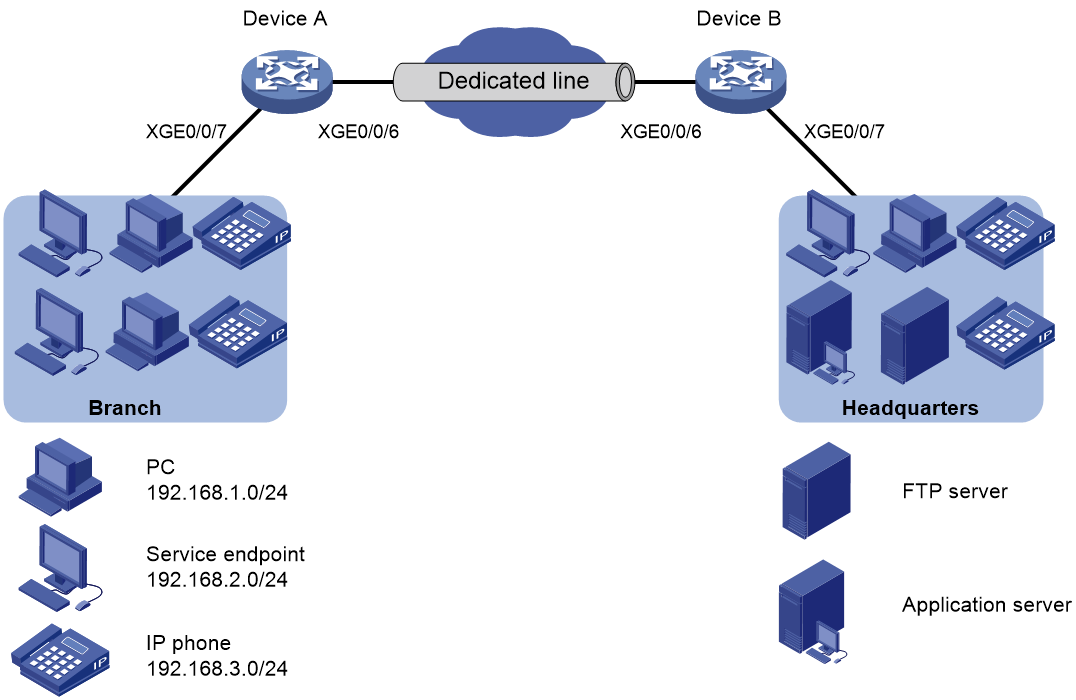

As shown in Figure 1, a company connects its headquarters and branch through a dedicated line. Three types of traffic are transmitted over the dedicated line: FTP traffic, service application traffic, and IP voice traffic. The total bandwidth of the dedicated line is 20 Mbps. Traffic policing has been configured on Device B as follows:
· The CIR for IP voice traffic is 10 Mbps.
· The CIR for service application traffic is 3 Mbps.
· The CIR for FTP traffic is 7 Mbps.
To match the traffic policing configuration and avoid packet loss, configure GTS on Device A to shape different types of traffic.
Software versions used
This configuration example was created and verified on Release 9141P16 of the SR6602-I router.
Procedures
