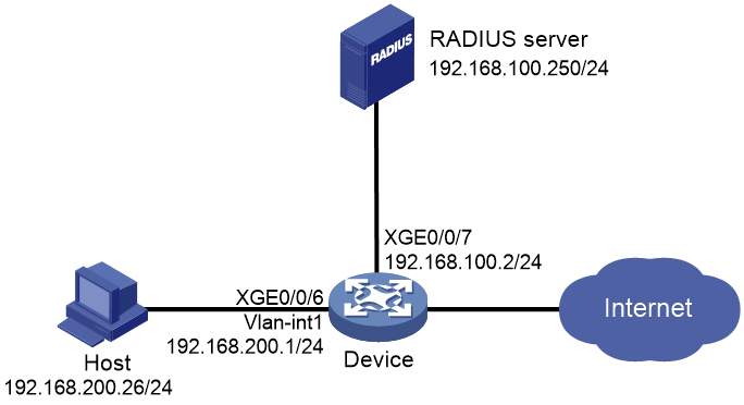

As shown in Figure 1, the router works together with the RADIUS server to perform 802.1X authentication for users connected to Ten-GigabitEthernet 0/0/6. Configure the network to meet the following requirements:
· Configure the router to exclude the domain names from the usernames sent to the RADIUS server.
· Set the username to localuser.
· Use the IMC server as the RADIUS server to perform authentication and accounting for users, and configure local authentication as the secondary authentication method when RADIUS authentication fails.
· Implement port-based access and specify mandatory 802.1X authentication domain bbb on the port.

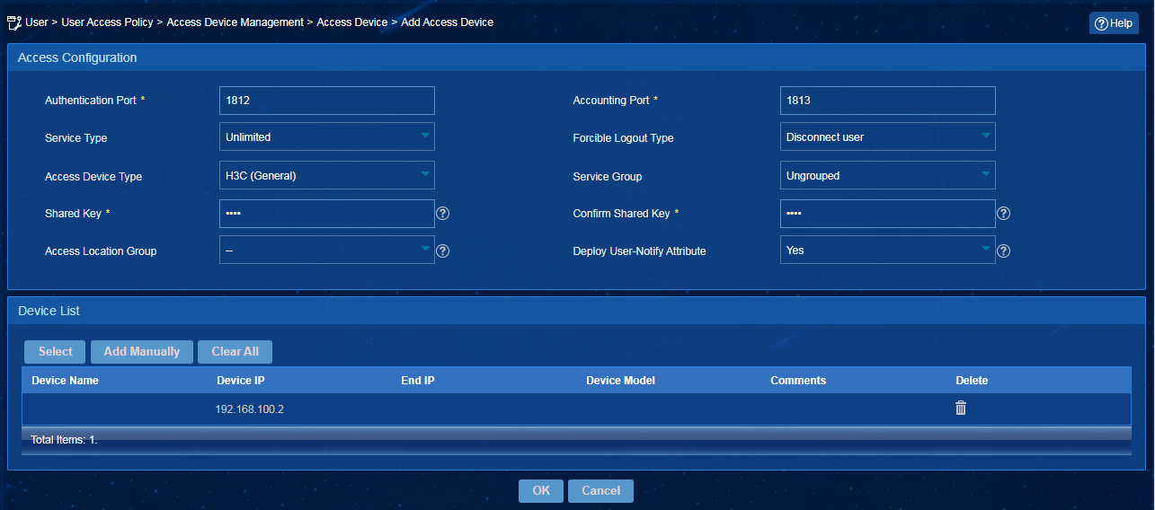

Add an access device
1. Log in to IMC and click the User tab.
2. From the navigation pane, select User Access Policy > Access Device Management > Access Device.
3. Click Add.
4. On the page that opens, configure the following parameters:
¡ Set the authentication port and accounting port to 1812 and 1813, respectively.
¡ Select H3C (General) from the Access Device Type list.
¡ Set the shared key to name for secure communication with the device and confirm the shared key.
¡ Select an access device from the device list or manually add an access device. In this example, the device IP address is 192.168.100.2.
¡ Use the default settings for other parameters, and then click OK.
Figure 2 Adding an access device

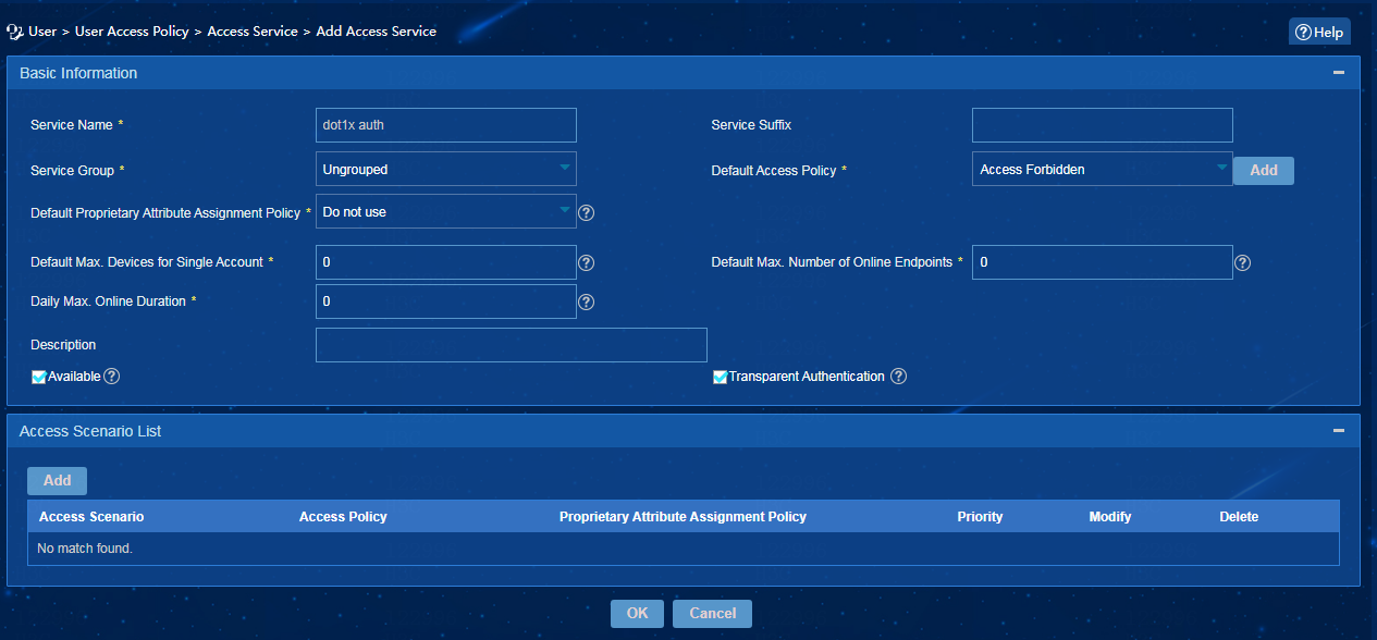

Adding an access service
1. Click the User tab.
2. From the navigation pane, select User Access Policy > Access Service.
3. Click Add.
¡ Enter access service name dot1x auth.
Figure 3 Adding an access service

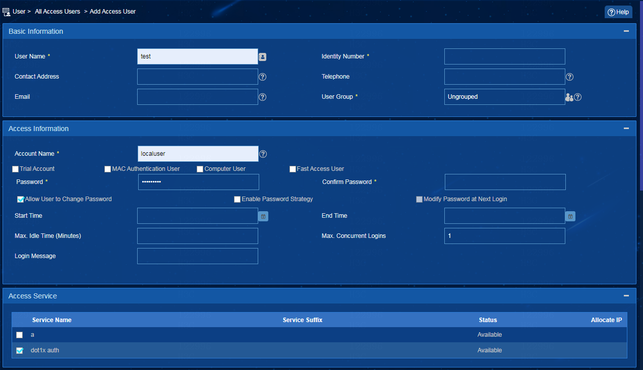

Adding an access user
2. From the navigation pane, select Access User > All Access Users.
3. Click Add.
The Add Access User page opens.
4. In the Access Information area, click the Add User button for the User Name field.
5. On the page that opens, configure the following parameters:
¡ Enter test in the User Name field.
¡ Enter account name localuser and set the password to localpass.
¡ Select dot1x auth in the Access Service area.
Figure 4 Adding an access user
