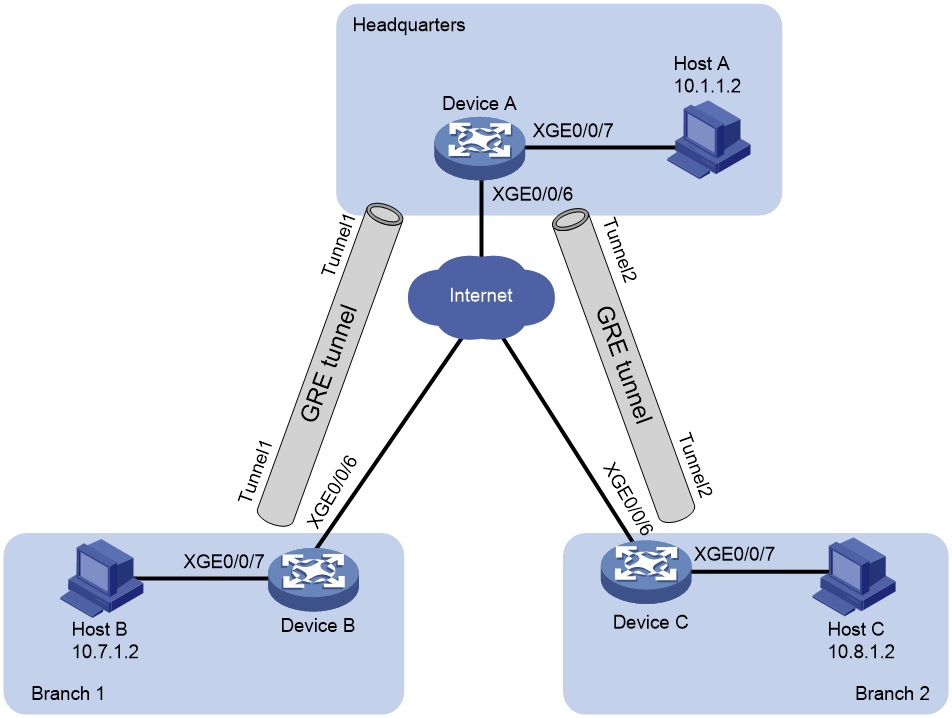

GRE with OSPF Configuration Examples
Introduction
This document provides GRE with OSPF configuration examples.
The following information applies to Comware 9-based routers. Procedures and information in the examples might be slightly different depending on the software or hardware version of the routers.
This document assumes that you have basic knowledge of GRE and OSPF.
Example: Configuring load sharing NAT server
As shown in Figure 1, Device A is the gateway of the headquarters. Device B and Device C are the gateways of Branch 1 and Branch 2, respectively. The gateways have obtained public IP addresses from an ISP and can communicate with one another. Configure GRE with OSPF to meet the following requirements:
· The headquarters and the branches communicate with one another through the GRE tunnels established between the headquarters and the branches.
· The gateways learn the routes reaching the destination networks through the tunnel interfaces.

Procedures
# Configure an IPv4 routing protocol on the gateways so that the gateways can reach one another. (Details not shown.)
Configuring Device A
# Configure an IP address for GigabitEthernet 1/0/1.
<DeviceA> system-view
[DeviceA-GigabitEthernet1/0/1] ip address 191.2.1.1 255.255.255.0
[DeviceA-GigabitEthernet1/0/1] quit
# Configure IP addresses for other interfaces. (Details not shown.)
# Create tunnel interface Tunnel 1, and specify the tunnel mode as GRE/IPv4.
[DeviceA] interface tunnel 1 mode gre
# Configure an IP address for tunnel interface Tunnel 1.
[DeviceA-Tunnel1] ip address 10.5.1.1 24
# Configure the source interface of Tunnel 1 as GigabitEthernet 1/0/1.
[DeviceA-Tunnel1] source gigabitethernet 1/0/1
# Configure the destination address of Tunnel 1 as the IP address of GigabitEthernet 1/0/1 on Device B.
[DeviceA-Tunnel1] destination 191.3.1.1
[DeviceA-Tunnel1] quit
# Create tunnel interface Tunnel 2, and specify the tunnel mode as GRE/IPv4.
[DeviceA] interface tunnel 2 mode gre
# Configure an IP address for tunnel interface Tunnel 2.
[DeviceA-Tunnel2] ip address 10.6.1.1 24
# Configure the source interface of Tunnel 2 as GigabitEthernet 1/0/1.
[DeviceA-Tunnel2] source gigabitethernet 1/0/1
# Configure the destination address of Tunnel 2 as the IP address of GigabitEthernet 1/0/1 on Device C.
[DeviceA-Tunnel2] destination 191.4.1.1
[DeviceA-Tunnel2] quit
# Configure the OSPF router ID as 10.6.1.1.
[DeviceA] router id 10.6.1.1
# Enable OSPF process 1.
[DeviceA] ospf 1
# Create OSPF area 0.
[DeviceA-ospf-1] area 0
# Enable OSPF on interfaces whose primary IP addresses are on network 10.1.1.0/24, 10.5.1.0/24, or 10.6.1.0/24 in area 0.
[DeviceA-ospf-1-area-0.0.0.0] network 10.1.1.0 0.0.0.255
[DeviceA-ospf-1-area-0.0.0.0] network 10.5.1.0 0.0.0.255
[DeviceA-ospf-1-area-0.0.0.0] network 10.6.1.0 0.0.0.255
Configuring Device B
<DeviceB> system-view
[DeviceB-GigabitEthernet1/0/1] ip address 191.3.1.1 255.255.255.0
[DeviceB-GigabitEthernet1/0/1] quit
[DeviceB] interface tunnel 1 mode gre
[DeviceB-Tunnel1] ip address 10.5.1.2 24
[DeviceB-Tunnel1] source gigabitethernet 1/0/1
# Configure the destination address of Tunnel 1 as the IP address of GigabitEthernet 1/0/1 on Device A.
[DeviceB-Tunnel1] destination 191.2.1.1
[DeviceB-Tunnel1] quit
# Configure the OSPF router ID as 10.7.1.1.
[DeviceB] router id 10.7.1.1
[DeviceB] ospf 1
[DeviceB-ospf-1] area 0
# Enable OSPF on interfaces whose primary IP addresses are on network 10.7.1.0/24 or 10.5.1.0/24 in area 0.
[DeviceB-ospf-1-area-0.0.0.0] network 10.7.1.0 0.0.0.255
[DeviceB-ospf-1-area-0.0.0.0] network 10.5.1.0 0.0.0.255
Configuring Device C
<DeviceC> system-view
[DeviceC] interface gigabitethernet 1/0/1
[DeviceC-GigabitEthernet1/0/1] ip address 191.4.1.1 255.255.255.0
[DeviceC-GigabitEthernet1/0/1] quit
[DeviceC] interface tunnel 2 mode gre
[DeviceC-Tunnel2] ip address 10.6.1.2 24
[DeviceC-Tunnel2] source gigabitethernet 1/0/1
# Configure the destination address of Tunnel 2 as the IP address of GigabitEthernet 1/0/1 on Device A.
[DeviceC-Tunnel2] destination 191.2.1.1
[DeviceC-Tunnel2] quit
# Configure the OSPF router ID as 10.8.1.1.
[DeviceC] router id 10.8.1.1
[DeviceC] ospf 1
[DeviceC-ospf-1] area 0
# Enable OSPF on interfaces whose primary IP addresses are on network 10.8.1.0/24 or 10.6.1.0/24 in area 0.
[DeviceC-ospf-1-area-0.0.0.0] network 10.8.1.0 0.0.0.255
[DeviceC-ospf-1-area-0.0.0.0] network 10.6.1.0 0.0.0.255
# Verify that Host A can ping Host B successfully.
C:\> ping 10.7.1.2
Pinging 10.7.1.2 with 32 bytes of data:
Reply from 10.7.1.2: bytes=32 time=19ms TTL=253
Reply from 10.7.1.2: bytes=32 time<1ms TTL=253
Ping statistics for 10.7.1.2:
Minimum = 0ms, Maximum = 19ms, Average = 4ms
# Verify that Host A can ping Host C successfully.
C:\> ping 10.8.1.2
Pinging 10.8.1.2 with 32 bytes of data:
Reply from 10.8.1.2: bytes=32 time=18ms TTL=253
Reply from 10.8.1.2: bytes=32 time<1ms TTL=253
Ping statistics for 10.8.1.2:
# Verify that Host B can ping Host C successfully.
C:\> ping 10.8.1.2
Reply from 10.8.1.2: bytes=32 time=20ms TTL=251
Reply from 10.8.1.2: bytes=32 time<1ms TTL=251
port link-mode route
ip address 10.7.1.1 255.255.255.0
interface Tunnel1 mode gre
source GigabitEthernet1/0/1
ip address 10.5.1.2 255.255.255.0
router id 10.7.1.1
ospf 1
area 0.0.0.0
Device C
ip address 10.8.1.1 255.255.255.0
interface Tunnel2 mode gre
ip address 10.6.1.2 255.255.255.0
router id 10.8.1.1
ospf 1
area 0.0.0.0
