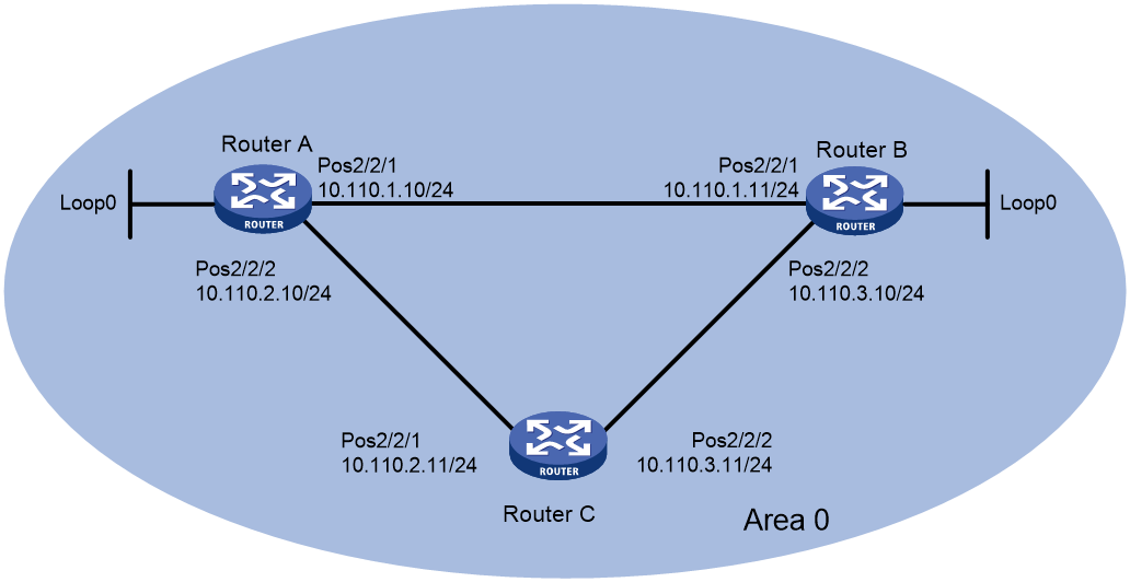

Example: Using optical fibers to directly connect PPP-enabled POS interfaces
Use a pair of single-mode fibers (one Tx and one Rx) to directly connect the POS interfaces of Router A and Router B, Router A and Router C, and Router B and Router C through PPP. Each device uses the Open Shortest Path First (OSPF) protocol to connect to the other two devices. Configure the network to meet the following requirements:
· When the link between Router A and Router B is intact, the traffic forwarding path from Router A to Router B is Router A -> Router B.
· When Router A receives the multiplexer section remote defect indication (MS-RDI) signals from the peer Router B and the MS-RDI signals continue for 100ms, the physical state of the interface will be automatically set to down.
· When interface POS 2/1/1 on Router A is down, the traffic forwarding path from Router A to Router B is Router A—>Router C—>Router B.
Figure 1 Network diagram
Analysis
· To automatically set the physical state of the interface to down upon receiving an MS-RDI signal from the peer, configure the action to take when alarms are received on the current interface. An RDI alarm occurs if the device receives MS-RDI signals from the remote end.
· To ensure that the POS interface is shut down if the MS-RDI signal persists for 100ms rather than immediately upon receiving an MS-RDI signal from the peer, configure the physical state change suppression interval as 100ms on the POS interface.

ip address 10.110.1.10 255.255.255.0
ospf 1
area 0.0.0.0
network 10.110.2.0 0.0.0.255
network 10.110.3.0 0.0.0.255
