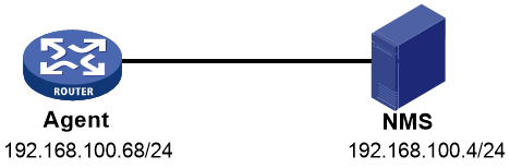

Example: Configuring SNMPv1 or SNMPv2c
As shown in Figure 1, configure SNMPv1/SNMPv2c to meet the following requirements:
· The server manages the device and backs up the configuration files of the device as an NMS via SNMPv1/SNMPv2c.
· The device proactively sends an notification to the NMS when a fault occurs.

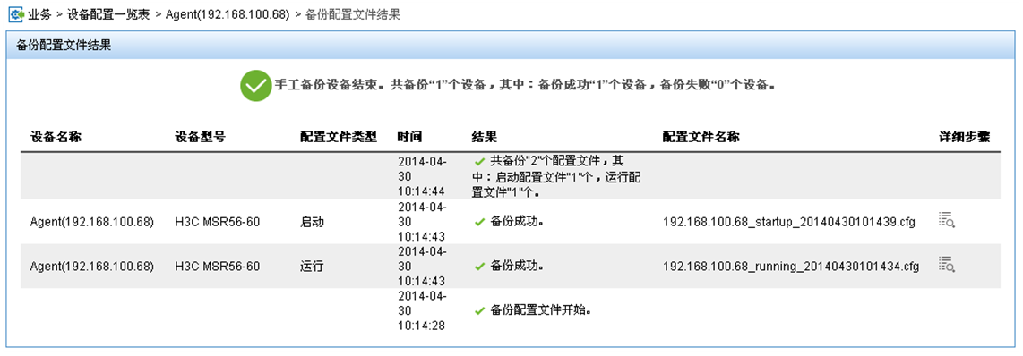

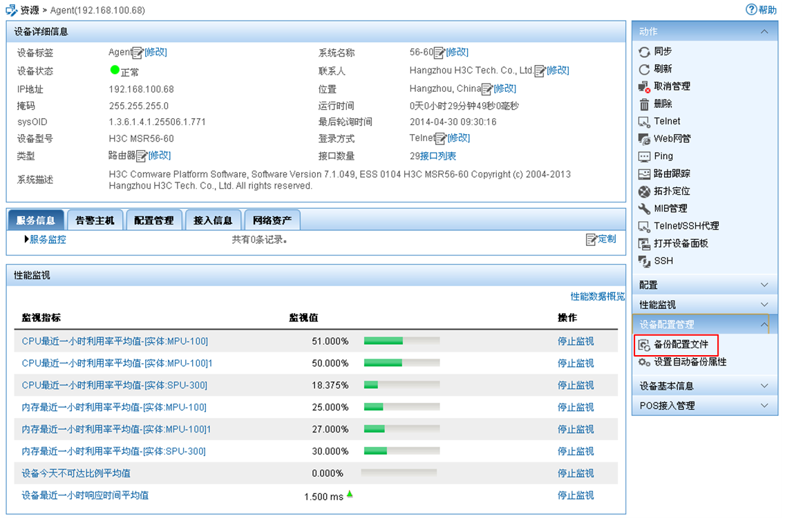

Table 5 Back up the configuration files of the device from the NMS.
# Navigate to the Resource > Device View > Agent page, and then click Backup Configuration File at the right.
Figure 6 Backing up configuration files of the device
# Information as follows is displayed if the configuration files are backed up successfully.
Figure 7 Configuration files backed up successfully
