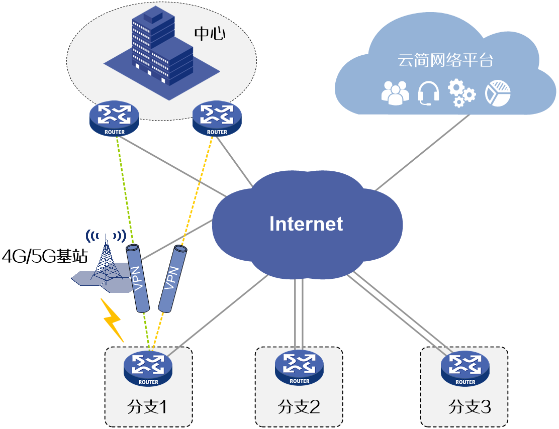

Branches connect to the center using a Hub-Spoke topology, where the center functions as the Hub site and each branch functions as a Spoke site. Branch 1 connects to the center using a wired link and a 4G/5G backup link, and Branches 2 and 3 use two wired links for access. Create Cloudnet VPN tunnels between the center and branches based on actual service requirements. Use the Cloudnet platform to ensure online service security between the center and the branches. For example, to establish Cloudnet VPN tunnels between the center and branch 1:
· Establish two VPN tunnels between the center and branch 1.
· Configure the two tunnels to operate in master/backup state. When the master tunnel disconnects, configure the backup tunnel to take over services.
Figure 1 Network diagram

Table 1 Create two center VPNs on the center and configure the priorities for the two VPN domains. Adjust the VPN domain priorities to establish a master-backup relationship.
Table 2 Create two branch VPNs on branch 1. Configure the egress interface and VPN domain for each branch VPN, for the two VPN tunnels established between branch 1 and the center to back up each other.

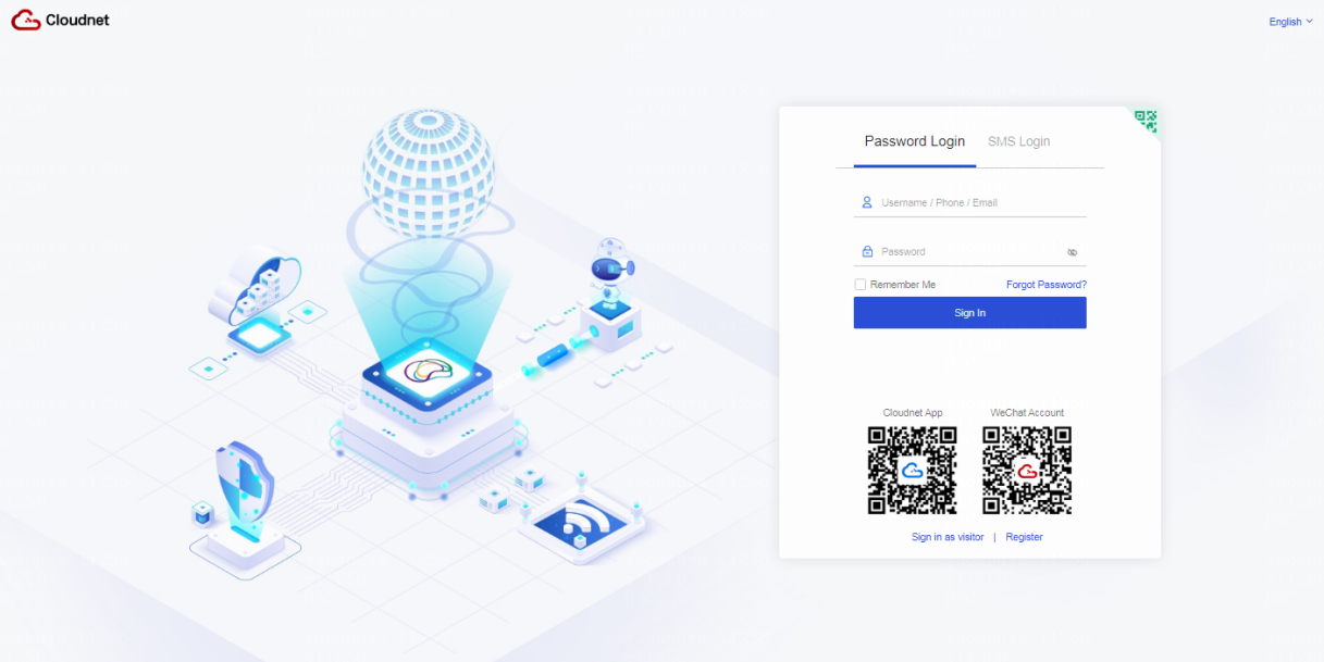

Log in to the Cloudnet platform
Table 1 Open a browser, and enter https://oasis.h3c.com/ in the address bar to access the Cloudnet interface. As shown in Figure 2, enter the username and password of your Cloudnet account and click to log in to Cloudnet. This configuration uses username admin as an example.
Figure 2 H3C Cloudnet interface

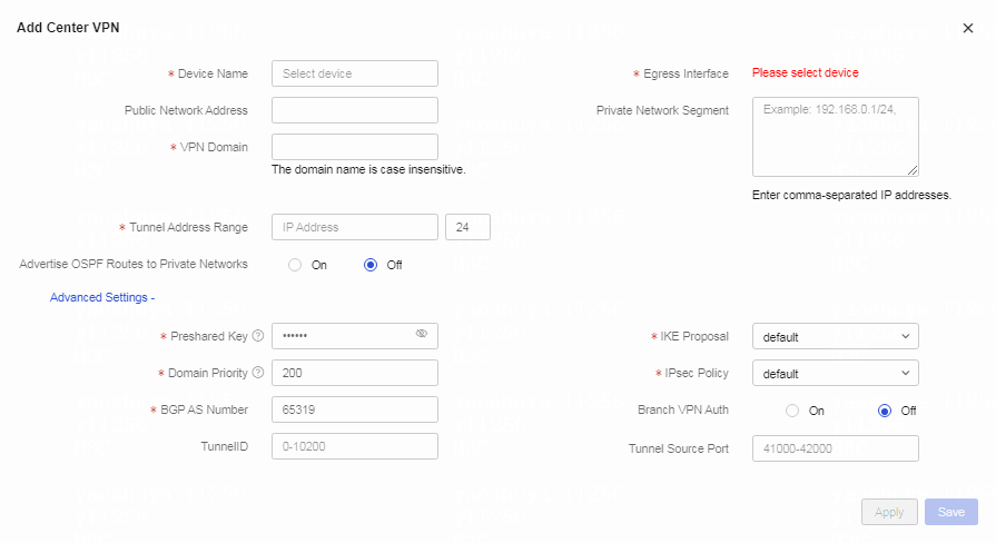

Table 1 Click the Center VPN tab. Click Add (ADVPN Scene).
Table 2 Configure center VPN parameters. Parameters marked with a red asterisk (*) are required.
Configure center VPN1 as follows:
a. Select the center device from the Device Name field.
b. Select the egress interface.
c. Specify the VPN domain name for the center VPN in the VPN Domain field.
d. Specify the tunnel address.
e. Enter the preshared key.
f. Enter the priority of the VPN domain. Smaller the value, higher the priority.
g. Use the default settings in the BGP AS Number, IKE Proposal, IPsec Policy, TunnelID, Tunnel Source Port, and Branch VPN Auth fields.
h. Click Apply.
Figure 5 Configuring advanced settings for the center VPN
After the configuration and application, the center VPN page displays the application status of center VPN 1.

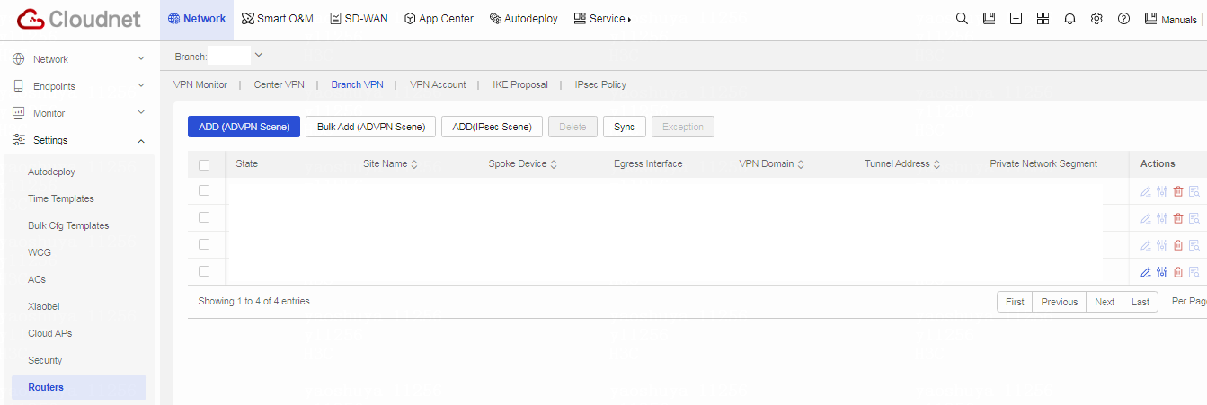

Creating branch VPN 1
Table 1 Click the Branch VPN tab. Click Add (ADVPN Scene).
Figure 6 Creating a branch VPN for the ADVPN scene
Table 2 Configure branch VPN parameters.
Configure branch VPN 1 as follows:
a. Select the branch device from the Device Name field.
b. Select the egress interface of the branch device.
c. Select the VPN domain configured for the center VPN.
d. Select the private network interfaces of the branch device.
e. Select the traffic forwarding mode. If you select local forwarding, the branch forwards only the VPN traffic to the center VPN. If you select centralized forwarding, the branch forwards all traffic to the center VPN.
f. Retain the default settings for advanced configuration fields.
g. Click Apply.
Figure 7 Creating branch VPN 1
After the configuration and application, the branch VPN page displays the application status of branch VPN 1.

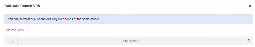

Creating branch VPNs in bulk
NOTE: Use this method to create branch VPNs in bulk for devices of the same model. In this method, you must first select the target sites after clicking the Bulk Add button. Each site has a router by default, and selecting a site is equivalent to selecting the corresponding router. |
Table 1 Click the Branch VPN tab. Click Bulk Add (ADVPN Scene). Select the target sites and then click Next.
Figure 8 Creating branch VPNs in bulk

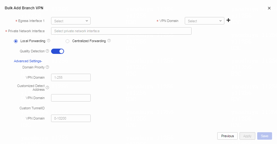

Table 2 Configure branch VPN parameters. Parameters marked with a red asterisk (*) are required.
Configure branch VPNs as follows:
a. Select the egress interface of the branch device.
b. Select the VPN domain configured for the center VPN.
c. Select the private network interfaces of the branch device.
d. Select the traffic forwarding mode. If you select local forwarding, the branch forwards only the VPN traffic to the center VPN. If you select centralized forwarding, the branch forwards all traffic to the center VPN.
e. Retain the default settings for advanced configuration fields.
f. Click Apply.
Figure 9 Creating branch VPNs in bulk

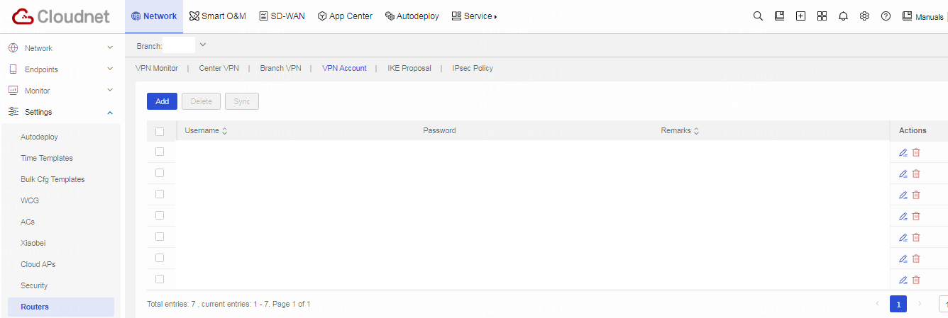

(Optional) Configuring a VPN account
Table 1 On the VPN page, click the VPN Account tab.
Table 2 Click Add. Configure a VPN account as follows:
a. Specify the VPN account name.
b. Set the VPN account password.
c. Enter the VPN account password again in the Confirm Password field.
d. Specify the remarks as needed.
e. Click OK.
Figure 11 Adding a VPN account
Table 3 On the VPN Account tab, select the target VPN accounts, and then click Sync to synchronize the accounts to the center device.
Table 4 In the dialog box that opens, select the target sites and then click OK.
Figure 12 Selecting the target sites for account synchronization
Table 5 In the confirmation dialog box that opens, click OK.

Figure 19 Selecting the configured IPsec policy for a center VPN

After you complete the above configuration, the center and the branch establish a VPN tunnel. On the VPN page, click the VPN Monitor tab, and view the state of the VPN tunnel.
