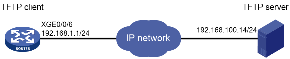

Example: Configuring an EAA monitor policy for automatic configuration rollback
As shown in Figure 2, the administrator remotely configures the router. To avoid network disconnectivity caused by certain configurations, back up the configuration file in advance. Use NQA to monitor network connectivity. Configure EAA monitor policy to automatically restore the available backup configuration and restart the device when the network is disconnected.
Figure 2 Network diagram
Analysis
Use an EAA monitor policy to monitor the state of the NQA reaction entry. When the monitored object exceeds the threshold of the specified type, the EAA monitor policy is automatically triggered. The NQA reaction entry state (MIB value) is as follows:
·     When the state is invalid (MIB value is 1), the NQA operation is not started.
·     When the state is overThreshold (MIB value is 2), the monitored object exceeds the threshold of the specified type.
·     When the state is belowThreshold (MIB value is 3), the monitored object does not exceed the threshold of the specified type.

Example: Configuring an EAA monitor policy to monitor and maintain the device running status automatically
As shown in Figure 3, the router has network connectivity to the TFTP server. To prevent high CPU usage on the router, configure an EAA monitor policy to monitor the CPU usage of the router automatically and perform the following actions when the CPU usage exceeds 80%:
·     Display the memory information, interface statistics, and routing table information at the time when the CPU usage exceeds 80%, and save them to a specified file.
·     Upload the file to the TFTP server.
·     After uploading the file to the TFTP server, delete the local file.
Figure 3 Network diagram
Software version used
This configuration example was created and verified on R9141P16 of the SR6602-I router.

Example: Configuring an EAA monitor policy to enable primary/backup link switchover based on the link quality
As shown in Figure 5, Router A and Router B are reachable to each other. Typically, the direct link between Router A and Router B acts as the primary link, and the link through Router C acts as the backup link. Configure an EAA monitor policy on Router A to meet the following requirements:
·     When the primary link has a packet loss rate exceeding 20% or a delay greater than 200 ms, switch over the traffic to the backup link.
·     When the primary link does not have packet loss and has a latency less than 100 ms, switch back the traffic to the primary link.
Figure 5 Network diagram
Analysis
