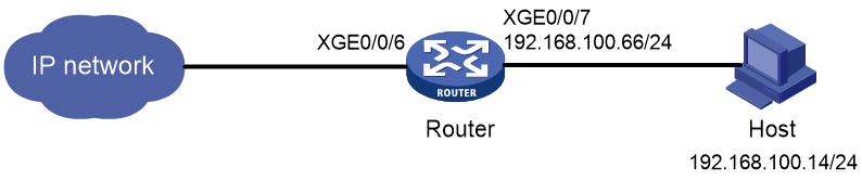

As shown in Figure 1, the router is connected to the host. Use For loop Tcl commands to create subinterfaces Ten-GigabitEthernet 0/0/6.1 to Ten-GigabitEthernet 0/0/6.4 for Ten-GigabitEthernet 0/0/6, and configure incremental IP addresses and VLAN termination settings with incremental VLAN IDs for the subinterfaces.

As shown in Figure 2, the router is connected to the host. Use While loop Tcl commands to create subinterfaces Ten-GigabitEthernet 0/0/6.1 to Ten-GigabitEthernet 0/0/6.4 for Ten-GigabitEthernet 0/0/6, and configure incremental IP addresses and VLAN termination settings with incremental VLAN IDs for the subinterfaces.
