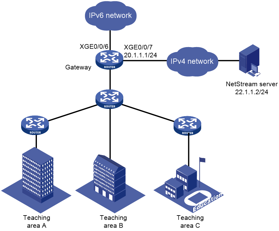

As shown in Figure 1, configure IPv4 NetStream on the gateway to monitor traffic and user behavior of internal users in the teaching areas.

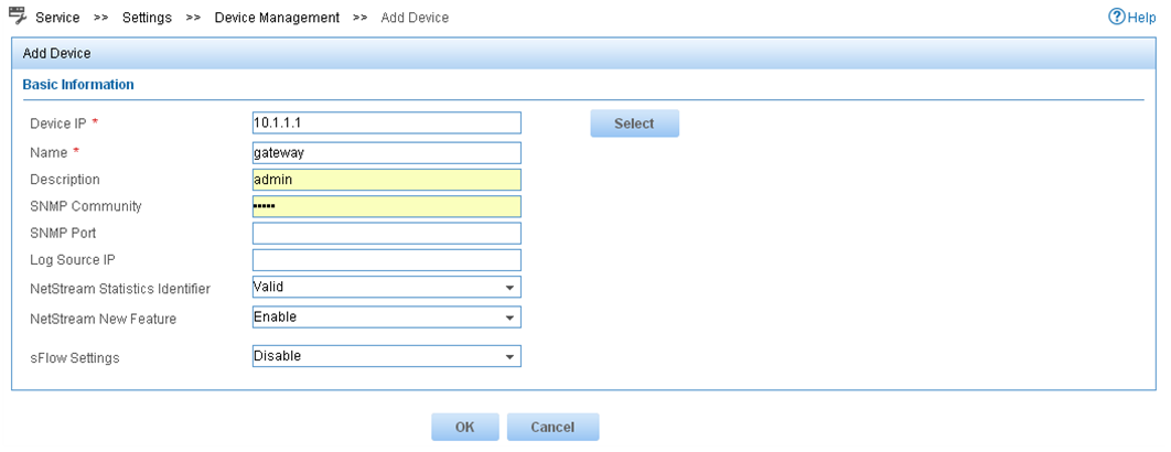

Configuring IMC
Adding a device
1. Log in to IMC.
2. Click the Service tab.
3. From the left navigation pane, select Traffic Analysis and Audit > Settings.
4. In the Guide to Quick Traffic Analysis And Audit Configuration area, click Device Management.
5. Click Add.

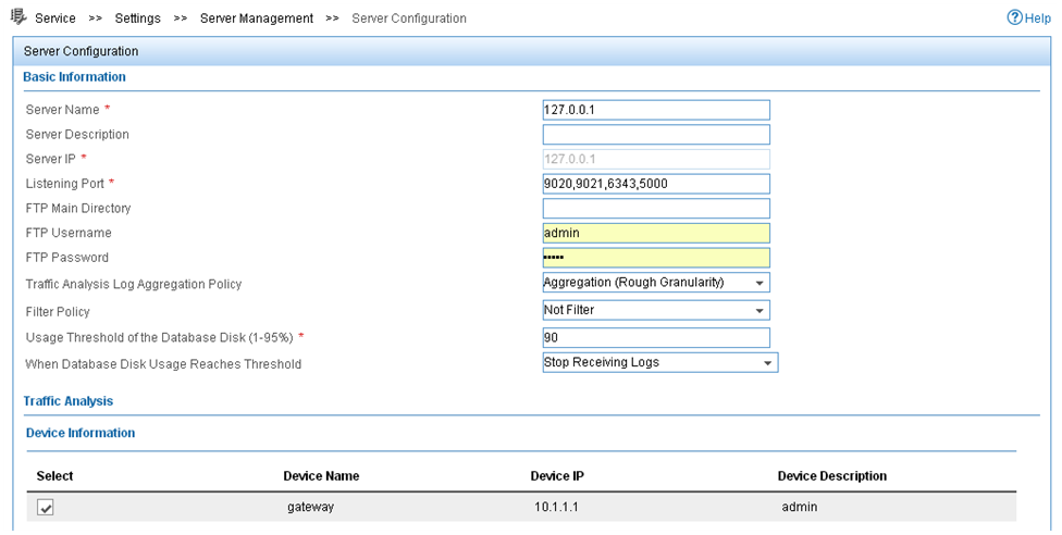

Deploying the server configuration
1. Click the Service tab.
2. From the left navigation pane, select Traffic Analysis and Audit > Settings.
3. On the Settings page that opens, click Server Management.
4. Click the Modify icon for the NTA/UBA server.
5. On the Server Configuration page shown in Figure 3, configure the server parameters and then click Deploy.
Figure 3 Deploying the server configuration

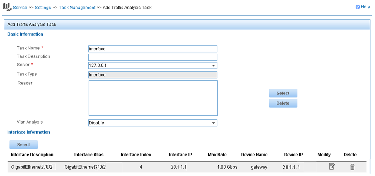

Adding a traffic analysis task
You can add multiple types of traffic analysis tasks. This example uses the interface traffic analysis task type.
To add an interface traffic analysis task:
3. On the Settings page that opens, click Traffic Analysis Task Management.
4. Click Add. The Select Task Type page opens.
5. Select Interface and click Next. The Add Traffic Analysis Task page opens.
6. Configure basic information and interface information, and then click OK.
Figure 4 Adding a traffic analysis task

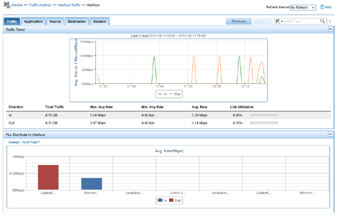

2. Display the report of the interface traffic analysis task:
a. Click the Service tab.
b. From the left navigation pane, select Traffic Analysis and Audit > Interface Traffic Analysis Task. Use either of the following methods to access the report page of interface traffic analysis task Interface:
- In the Summary List area, click the name of the interface traffic analysis task.
- On the left navigation pane, move your mouse pointer to the shortcut menu icon next to Interface Traffic Analysis Task, and then select Interface from the menu.
Figure 5 Interface traffic analysis

As shown in Figure 6, configure IPv6 NetStream on the gateway to monitor the network access traffic and behavior of internal users.

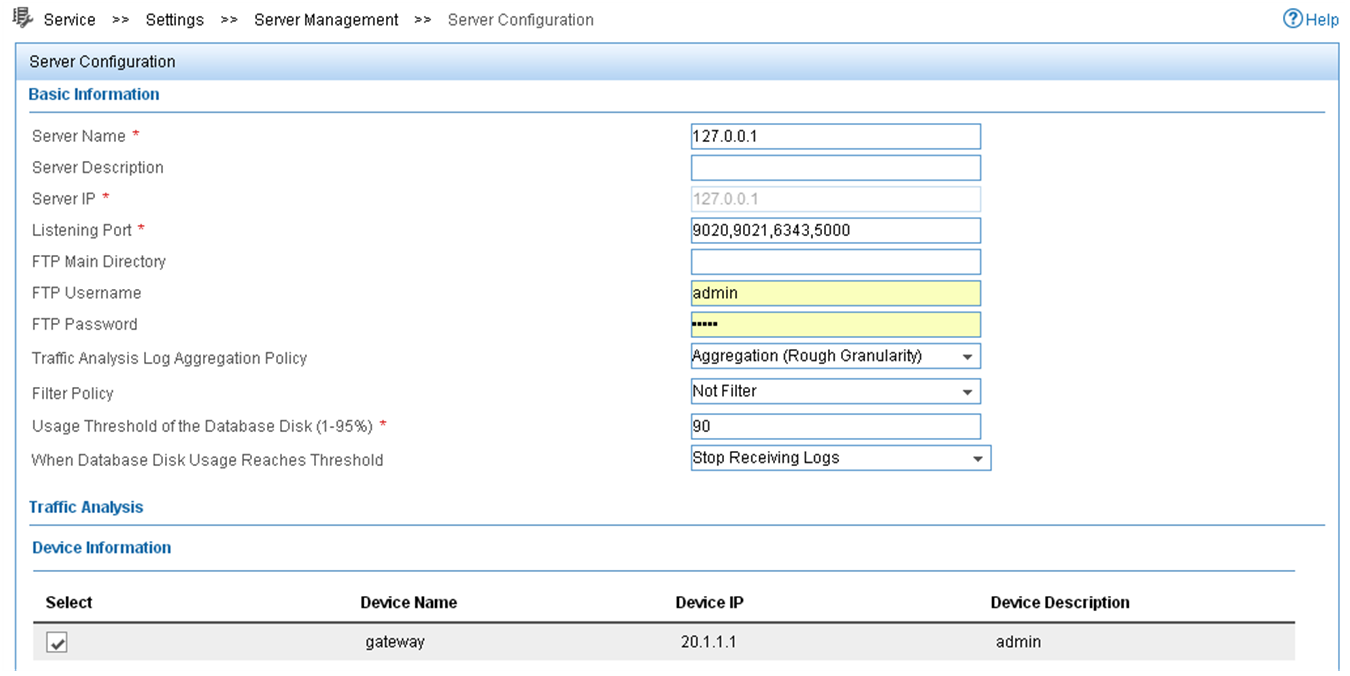

5. On the Server Configuration page shown in Figure 8, configure the server parameters and then click Deploy.
Figure 8 Deploying the server configuration
Figure 10 Interface traffic analysis
