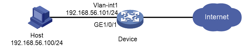

As shown in Figure 1, the device performs local 802.1X authentication on GigabitEthernet 1/0/1 to control Internet access of users. The interface performs port-based access control for 802.1X authentication.
Figure 1 Network diagram

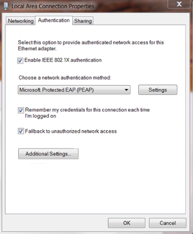

If the host runs the Windows XP built-in 802.1X client, configure the network connection properties as follows:
1.     Click the Authentication tab of the properties window.
2.     Select the Enable IEEE 802.1X authentication for this network option.
3.     Select MD5 challenge as the EAP type.
4.     Click OK.

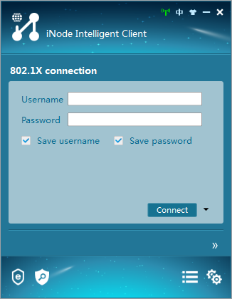

1.     Run the iNode client.
Figure 2 iNode client

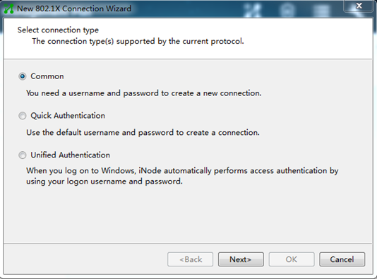

3.     On the New 802.1X Connection Wizard window, select Common, and then click Next.

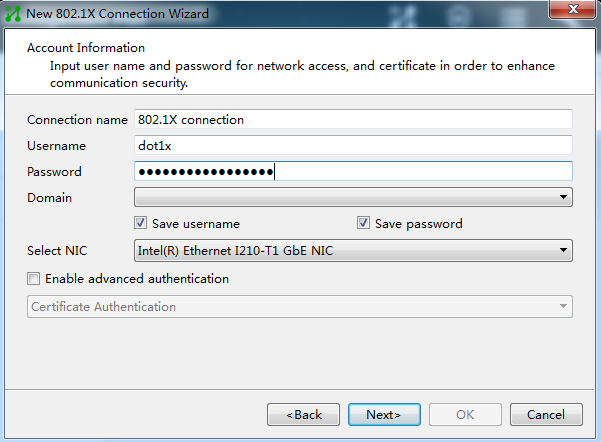

4.     Enter the 802.1X connection name, username, and password, and then click Next.

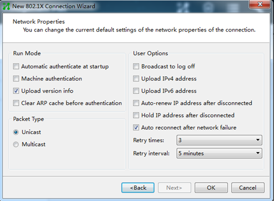

5.     Configure the network property settings, and then click OK.
Do not select Upload version info in the Run Mode area. The device cannot recognize the version number in EAP packets.
Figure 5 Configuring 802.1X connection properties

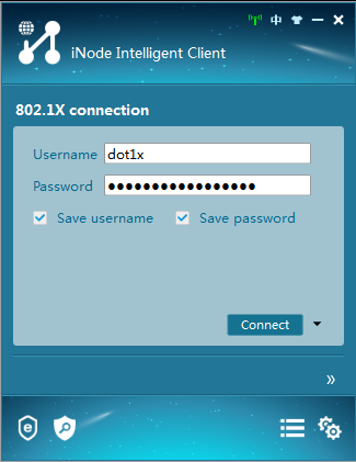

6.     Initiate the 802.1X connection.
Enter the username and password on the iNode client, and then click Connect.
Figure 6 Initiating the 802.1X connection

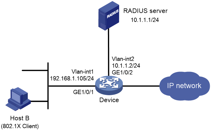

As shown in Figure 7:
·     The device uses the RADIUS server for 802.1X user authentication and authorization.
·     IMC acts as the RADIUS server.
·     The user on Host B uses the Windows XP built-in 802.1X client to interact with the device for 802.1X authentication.
Figure 7 Network diagram

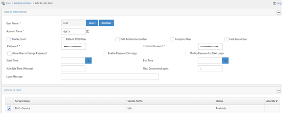

d.     Add an access user and specify the access service for the access user.

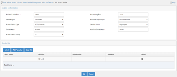

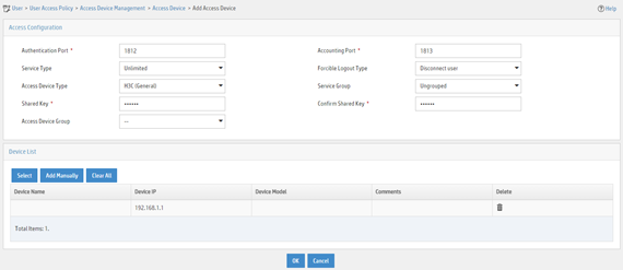

1.     Log in to IMC.
2.     Click the User tab.
3.     From the navigation pane, select User Access Policy > Access Device Management > Access Device.
4.     Click Add.
5.     On the page that opens, configure access device parameters.
a.     Set the ports for authentication and accounting to 1812 and 1813, respectively.
b.     Set the shared key to expert for secure authentication and accounting communication, and confirm the shared key.
c.     Select H3C (General) from the Access Device Type list.
d.     Select an access device from the device list or manually add an access device. In this example, the device IP address is 10.1.1.2.
e.     Use the default values for other parameters.
f.     Click OK.
Figure 8 Adding an access device

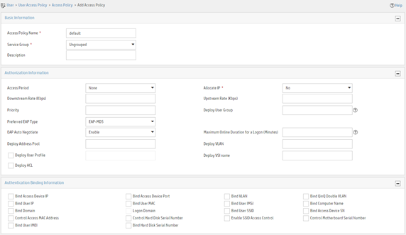

Adding an access policy
1.     Click the User tab.
2.     From the navigation pane, select User Access Policy > Access Policy.
3.     Click Add.
4.     On the page that opens, configure access policy parameters.
a.     Enter access policy name default.
b.     Use the default values for other parameters.
c.     Click OK.
Figure 9 Adding an access policy

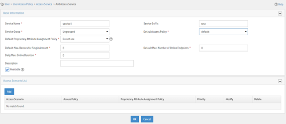

4.     On the page that opens, configure access service parameters.
a.     Enter service name service1 and set the service suffix to test. The service suffix is the authentication domain for the 802.1X user.
IMPORTANT
IMPORTANT:
With the service suffix configured, you must configure the device to send usernames that include the domain name to the RADIUS server. By default, the device includes the domain name in the usernames sent to a RADIUS server.
b.     Select default from the Default Access Policy list.
c.     Use the default values for other parameters.
d.     Click OK.
Figure 10 Adding an access service

Configuring the 802.1X client
This example uses the Windows XP built-in 802.1X client to describe the procedure. The configuration is as shown in Figure 12.
Figure 12 Configuring the Windows XP built-in 802.1X client
Verify that you can use the user account to pass 802.1X authentication:
# Use the host to visit an Internet webpage. The Windows status bar displays a message and asks you to enter your username and password.
# Enter username guest@test and password 123456TESTplat&!.

Example: Configuring 802.1X with guest VLAN and authorization VLAN assignment
As shown in Figure 13:
·     Use a RADIUS server to perform authentication, authorization, and accounting for 802.1X users that connect to GigabitEthernet 1/0/2. Implement port-based access control on the port.
·     Configure VLAN 10 as the 802.1X guest VLAN on GigabitEthernet 1/0/2. The host and the update server are both in VLAN 10, and the host can access the update server and download the 802.1X client software.
·     To prevent users in the guest VLAN from accessing the Internet, apply a QoS policy to the outbound direction of VLAN 10 to filter packets destined for the Internet (5.1.1.1).
·     After the host passes 802.1X authentication, the access device assigns the host to the same VLAN (VLAN 5) as the interface (GigabitEthernet 1/0/3) for Internet access.
Figure 13 Network diagram

Adding the device to the IMC Platform as an access device
1.     Log in to IMC.
4.     Click Add.
b.     Select H3C (General) from the Access Device Type list.
c.     Set the shared key to expert for secure authentication and accounting communication.
d.     Select an access device from the device list or manually add an access device. In this example, the IP address of the access device is 10.1.1.2.
f.     Click OK.
The IP address of the access device specified on the RADIUS server must be the same as the source IP address of the RADIUS packets sent from the device. On the device, the source IP address is chosen in the following order:
a.     IP address specified by using the nas-ip command.
b.     IP address specified by using the radius nas-ip command.
c.     IP address of the outbound interface (the default).
In this example, the device uses the IP address of the outbound interface as the source IP address of RADIUS packets.
Figure 14 Adding an access device

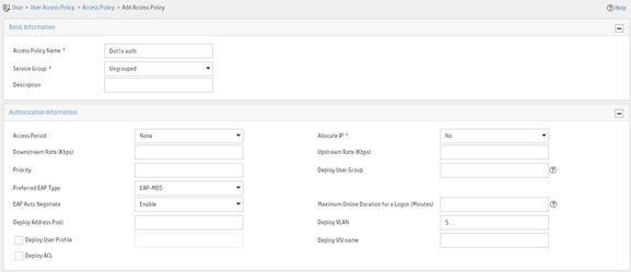

a.     Enter access policy name Dot1x auth.
b.     Enter 5 in the Deploy VLAN field.
c.     Configure other parameters as needed.
d.     Click OK.
Figure 15 Adding an access policy

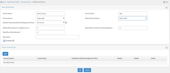

2.     From the navigation pane, select User Access Policy > Access Service.
3.     Click Add.
a.     Enter service name Dot1x Service and set the service suffix to bbb. The service suffix is the authentication domain for the 802.1X user.
IMPORTANT
IMPORTANT:
b.     Select Dot1x auth from the Default Access Policy list.
d.     Click OK.
Figure 16 Adding an access service
Adding an access user
2.     From the navigation pane, select Access User > Access User.
3.     Click Add.
4.     On the page that opens, configure access user parameters.
a.     Select the user or add a user named test.
b.     Enter account name dot1x and password 123456TESTplat&!.
c.     Select Dot1x Service in the Access Service area.
d.     Configure other parameters as needed.
e.     Click OK.
Figure 17 Adding an access user
# Configure the 802.1X client. Make sure the 802.1X client can update its IP address after the access port is assigned to the guest VLAN or an authorization VLAN. (Details not shown.)
# Verify the 802.1X guest VLAN configuration on GigabitEthernet 1/0/2.
[Device] display dot1x interface gigabitethernet 1/0/2
# Verify that GigabitEthernet 1/0/2 is assigned to VLAN 10 before any user passes authentication on the port.
[Device] display vlan 10
# After a user passes authentication, display information on GigabitEthernet 1/0/2. Verify that GigabitEthernet 1/0/2 is assigned to VLAN 5.
[Device] display interface gigabitethernet 1/0/2

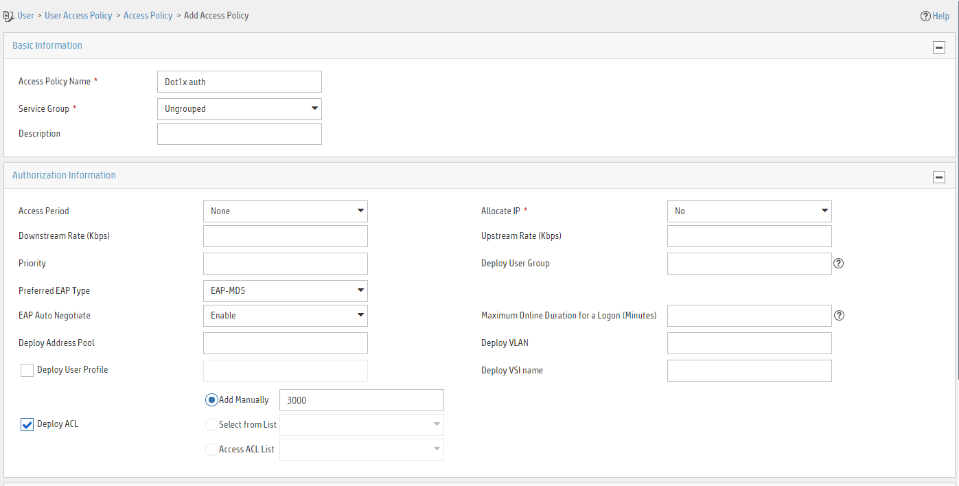

Example: Configuring 802.1X with ACL assignment
As shown in Figure 18, the user on the host that connects to GigabitEthernet 1/0/1 must pass 802.1X authentication to access the Internet.
Perform 802.1X authentication on GigabitEthernet 1/0/1. Use the RADIUS server at 10.1.1.1 as the authentication and authorization server, and the RADIUS server at 10.1.1.2 as the accounting server.
Configure ACL assignment on GigabitEthernet 1/0/1 to deny access of 802.1X users to the FTP server from 8:00 to 18:00 on weekdays.
Figure 18 Network diagram
Analysis
·     For the device to use the RADIUS server for user authentication, perform the following tasks on the RADIUS server:
a.     Add the device as an access device to the RADIUS server.
b.     Add an access policy.
c.     Add an access service and specify the access policy in the access service.
·     For the device to perform RADIUS-based authentication and authorization for the 802.1X user, configure AAA settings on the device, including ISP domain settings and RADIUS scheme settings.
·     To assign an ACL to the user after the user passes authentication and use the ACL to restrict the user's access behaviors, perform the following tasks:
¡     Specify the ACL in the user account on the RADIUS server.
¡     Create the ACL and configure its rules on the device.
1.     Log in to IMC.
4.     Click Add.
d.     Select an access device from the device list or manually add an access device. In this example, the device IP address is 192.168.1.1.
e.     Use the default values for other parameters and click OK.
Figure 19 Adding an access device
3.     Click Add.
b.     In the Authorization Information area, select Deploy ACL and manually enter ACL number 3000.
d.     Click OK.
Figure 20 Adding an access policy
3.     Click Add.
IMPORTANT
IMPORTANT:
d.     Click OK.
Figure 21 Adding an access service
3.     Click Add.
4.     On the page that opens, configure user parameters.
e.     Click OK.
Figure 22 Adding an access user
# Configure the 802.1X client. Make sure the client is able to update its IP address after the access port is assigned to the 802.1X guest VLAN or an authorization VLAN. (Details not shown.)
# Use the user account to pass authentication. (Details not shown.)
# Verify that the user cannot ping the FTP server at any time from 8:00 to 18:00 on any weekday.
C:\>ping 10.0.0.1
Pinging 10.0.0.1 with 32 bytes of data:
Request timed out.
Request timed out.
Request timed out.
Request timed out.
Ping statistics for 10.0.0.1:
    Packets: Sent = 4, Received = 0, Lost = 4 (100% loss),
The output shows that ACL 3000 is active on the user, and the user cannot access the FTP server.
