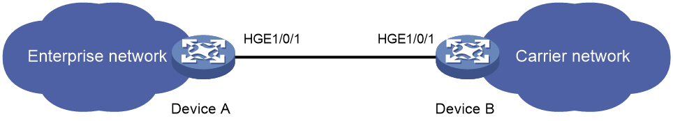

As shown in Figure 1, the edge devices Device A and Device B connect the enterprise network and the carrier network. Configure Ethernet OAM on Device A and Device B to meet the following Service Level Agreement (SLA) requirements:
·     Device A and Device B automatically monitor the link between them.
·     The administrator can view critical link events on the link between Device A and Device B.
·     The administrator can obtain the link status by observing link error event statistics.
Figure 1 Network diagram
Analysis
For Device A to establish an Ethernet OAM connection with Device B, configure HundredGigE 1/0/1 on Device A to operate in active mode, and configure HundredGigE 1/0/1 on Device B to operate in passive mode.
To implement link event detection based on the network environment, configure errored frame event detection parameters and use global settings for other detection parameters.
