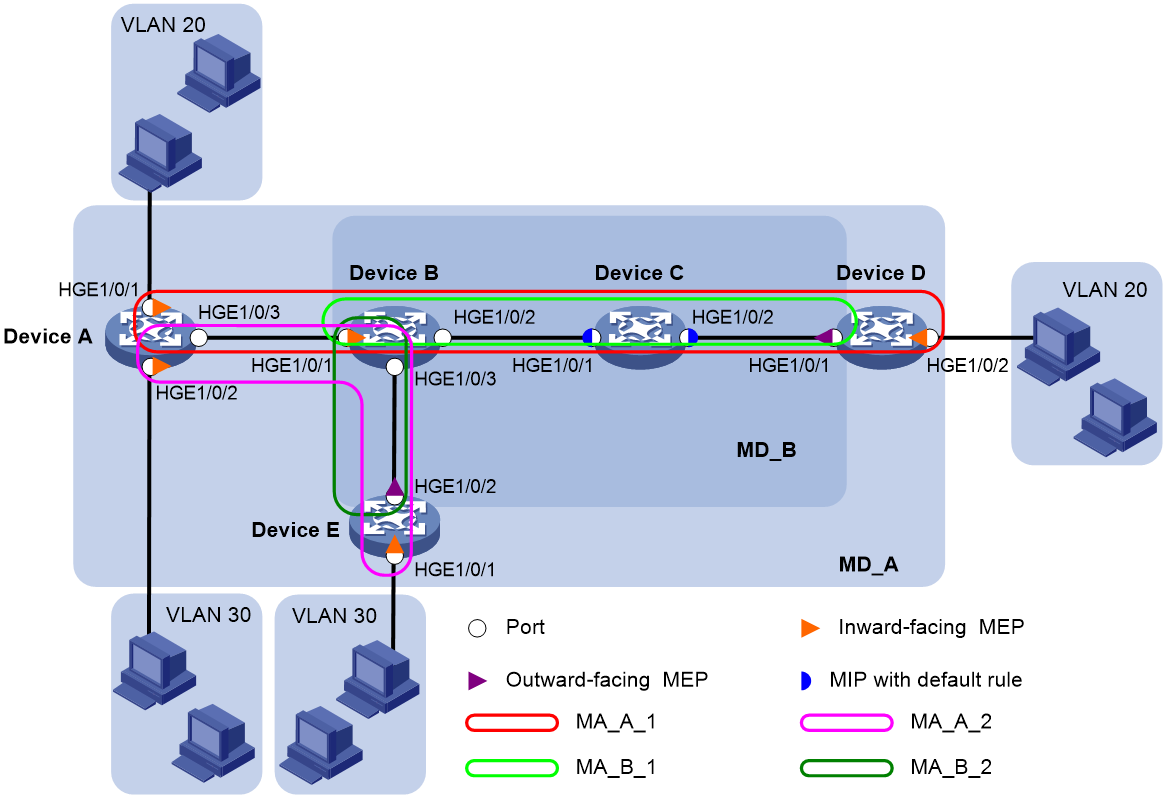

As shown in Figure 1, Device B and Device C reside in the central equipment room of a company. Device A, Device D, and Device E reside in other areas.
·     Research and development department users in VLAN 20 access the enterprise network through Device A and Device D.
·     Marketing department users in VLAN 30 access the enterprise network through Device A and Device E.
Configure CFD to verify and locate link faults.
Figure 1 Network diagram

To accurately locate link faults, assign the enterprise network to MD_A (level 5) and the central equipment room network to MD_B (level 3). MD_A nests MD_B.
To effectively implement CFD, assign MAs based on the VLANs of service traffic:
·     Assign VLAN 20 in MD_A to MA_A_1.
·     Assign VLAN 30 in MD_A to MA_A_2.
·     Assign VLAN 20 in MD_B to MA_B_1.
·     Assign VLAN 30 in MD_B to MA_A_2.
To verify link connectivity, configure MEPs on the interfaces located at the boundary of MAs, for example, MA_B_1:
·     Configure MEPs on interface HGE1/0/1 of Device B and Device D to allow CFD packets from VLAN 20 to pass through the following interfaces:
¡     HGE1/0/1 and HGE1/0/2 of Device B.
¡     HGE1/0/1 and HGE1/0/2 of Device C.
¡     HGE1/0/1 of Device D.
·     Configure HGE1/0/1 of Device B as an inward-facing MEP because CFD packets are forwarded through other interfaces on the device.
·     Configure HGE1/0/1 of Device D as an outward-facing MEP because CFD packets are forwarded through the interface.
To accurately locate link faults between Device B and Device D, configure the default MIP generation rule on Device C.
To detect connectivity among MEPs, configure CC on the MEPs.
To verify link faults detected through CC, use LB. To trace faulty paths or locate link faults, use LT after the status information of the entire network is obtained.
Figure 2 shows a CFD configuration diagram based on the previous analysis.
Figure 2 CFD configuration diagram

In this example, the MAC addresses of Device A through Device E are 0010-FC01-6511, 0010-FC02-6512, 0010-FC03-6513, 0010-FC04-6514, and 0010-FC05-6515, respectively.
1.     Verify the configuration when the network is operating correctly:
# Display information about remote MEP 1001 in service instance 1 on Device A.
[DeviceA] display cfd remote-mep service-instance 1 mep 1001
MEP ID   MAC address      State        Time                  MAC status
1002     0010-fc04-6514   OK           2019/07/26 12:54:52   UP
The output shows that the remote MEP is operating correctly.
# Enable LB on Device A to verify the status of the link between MEP 1001 and MEP 1002 in service instance 1.
[DeviceA] cfd loopback service-instance 1 mep 1001 target-mep 1002
Loopback to MEP 1002 with the sequence number start from 1001-43404:
Reply from 0010-fc04-6514: sequence number=1001-43404 Time=5ms
Reply from 0010-fc04-6514: sequence number=1001-43405 Time=5ms
Reply from 0010-fc04-6514: sequence number=1001-43406 Time=5ms
Reply from 0010-fc04-6514: sequence number=1001-43407 Time=5ms
Reply from 0010-fc04-6514: sequence number=1001-43408 Time=5ms
Sent: 5        Received: 5        Lost: 0
The output shows that no link fault occurs on the link between MEP 1001 and MEP 1002 in service instance 1.
2.     Verify the configuration when a link fault occurs:
1002     0010-fc04-6514   FAILED       2019/07/26 13:01:52   DOWN
The output shows that the remote MEP is operating incorrectly.
Loopback to MEP 1002 with the sequence number start from 1001-43904:
Sent: 5        Received: 0        Lost: 5
The output shows that a link fault occurs on the link between MEP 1001 and MEP 1002 in service instance 1.
# Identify the path between MEP 3001 and MEP 3002 in service instance 3 on Device B.
[DeviceB] cfd linktrace service-instance 3 mep 3001 target-mep 3002
Linktrace to MEP 3002 with the sequence number 3001-43862:
MAC Address               TTL     Last Mac         Relay Action
0010-fc03-6513            63      0010-fc02-6512   MPDB
The output shows that MEP 3001 receives only the LTR messages from the MIP. No LTR messages are sent from MEP 3002 (HundredGigE 1/0/1 on Device D). The link between Device C and Device D fails, and you do not need to troubleshoot the network outside MD_B.
