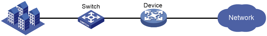

Example: Configuring network layer attack protection
As shown in Figure 3, Device A is the gateway for the internal network. To protect Device A against IP packet attacks from internal and external networks, configure the following network layer attack protection features:
·     Configure strict uRPF check to prevent source address spoofing attacks.
·     Disabling sending ICMP time exceeded messages. The device will not be flooded by ICMP time exceeded messages when receiving a large number of packets with TTL set to 1.

Procedures
# Specify IP addresses for interfaces. (Details not shown.)
# Enable strict uRPF check.
[DeviceA] ip urpf strict
# Disable sending ICMP time exceeded messages. Sending ICMP time exceeded messages is disabled by default.
[DeviceA] undo ip ttl-expires enable
1.     Verify that Device A can prevent source address spoofing attacks:
# Verify that Device A can filter out packets with forged source IP addresses. (Details not shown.)
# Verify the uRPF configuration.
[DeviceA] display ip urpf
Global uRPF configuration information:
   Check type: strict
2.     Verify that TTL attack protection functions on Device A:
# Enable ICMP debugging by executing the debugging ip icmp command on Device A. (Details not shown.)
# Use a PC to send packets in which the TTL is 1 to Device A. (Details not shown.)
# Verify that Device A does not display any debugging information and that the PC does not receive any ICMP time exceeded messages. (Details not shown.)
# Enable sending ICMP time exceeded messages and send packets in which the TTL is 1 to Device A. (Details not shown.)
# Verify that Device A responds with ICMP time exceeded messages.

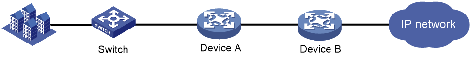

Example: Configuring transport layer attack protection
As shown in Figure 4, the device is the gateway for the internal network. Configure SYN Cookie protection on the device to protect against SYN flood attacks. With this feature enabled, the device responds to a SYN packet with a SYN ACK packet without establishing a TCP semi-connection. The device establishes a TCP connection only when it receives an ACK packet from the sender.
Figure 4 Network diagram

Procedures
# Enable SYN Cookie.
<Device> system-view
[Device] tcp syn-cookie enable
# Verify that the device does not have any TCP semi-connections. The state "SYN_RECEIVED" represents semi-connections.
[Device] display tcp
