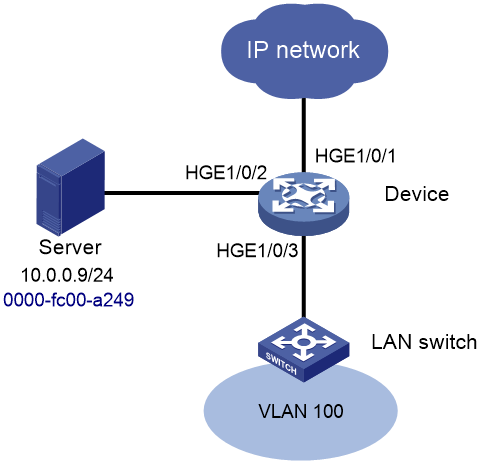

As shown in Figure 1, for secure communication between users in VLAN 100 and the server, perform the following tasks:
·     Assign HundredGigE 1/0/2 and HundredGigE 1/0/3 to VLAN 100.
·     Add a static MAC address entry on Device to bind the server MAC address to HundredGigE 1/0/2.
Figure 1 Network diagram

# Create VLAN 100, and assign HundredGigE 1/0/2 to VLAN 100.
<Device> system-view
[Device] vlan 100
[Device-vlan100] quit
[Device] interface hundredgige 1/0/2
[Device-HundredGigE1/0/2] port access vlan 100
[Device-HundredGigE1/0/2] quit
# Configure HundredGigE 1/0/3 (port connected to the LAN switch) as a trunk port, and assign the port to VLAN 100.
[Device] interface hundredgige 1/0/3
[Device-HundredGigE1/0/3] port link-type trunk
[Device-HundredGigE1/0/3] port trunk permit vlan 100
[Device-HundredGigE1/0/3] quit
# Add a static entry for MAC address 0000-fc00-a249 on HundredGigE 1/0/2 that belongs to VLAN 100.
[Device] mac-address static 0000-fc00-a249 interface hundredgige 1/0/2 vlan 100
# Verify that any 10.0.0.0/24 host in VLAN 100 can communicate with the server. (Details not shown.)
# Verify that the static MAC address entry has been added.
[Device] display mac-address
MAC Address      VLAN ID    State            Port/NickName            Aging
0000-fc00-a249   100        Static           HGE1/0/2                 N
7425-8a02-4d00   100        Learned          HGE1/0/3                 Y
Configuration files
sysname Device
vlan 1
vlan 100
interface HundredGigE1/0/2
 mac-address static 0000-fc00-a249 vlan 100
interface HundredGigE1/0/3
 port trunk permit vlan 1 100

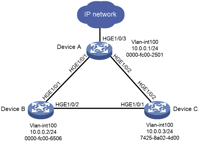

As shown in Figure 2, Devices A, B, and C form a loop because of cable misconnection, and spanning tree protocols are not enabled on the devices. As a result, MAC addresses are frequently moves among Devices A, B, and C. To deal with loop-triggered MAC flapping, perform the following tasks:
·     Display MAC address move records to locate the Layer 2 loop.
·     Configure MAC address move suppression on Device A to eliminate the Layer 2 loop.
Figure 2 Network diagram
Analysis
To meet the network requirements, you must perform the following tasks:
·     For Devices A, B, and C to communicate with each other, assign all inter-connected ports to VLAN 100.
·     Configure MAC address move suppression on one or more ports of Device A.
·     To monitor the port status change of Device A, enable the log monitoring of the current terminal feature.
·     For loop detection, create VLAN-interface 100 and assign an IP address to the interface on each device.
·     To display MAC address move records, ping Device B from Device A.

Configuring Device A
# Enable the monitoring of logs on the current terminal.
<DeviceA> terminal monitor
<DeviceA> terminal debugging
# Create VLAN 100.
<DeviceA> system-view
[DeviceA] vlan 100
[DeviceA-vlan100] quit
# Configure HundredGigE 1/0/1 and HundredGigE 1/0/2 as trunk ports, and assign the ports to VLAN 100.
[DeviceA] interface range hundredgige 1/0/1 hundredgige 1/0/2
[DeviceA-if-range] port link-type trunk
[DeviceA-if-range] port trunk permit vlan 100
[DeviceA-if-range] quit
# Set the suppression interval to 300 seconds. A suppressed port will automatically come up after 300 seconds.
[DeviceA] mac-address notification mac-move suppression interval 300
# Set the suppression threshold to 0. A port will be shut down when the system detects a MAC address move on the port within a MAC move detection interval (1 minute by default).
[DeviceA] mac-address notification mac-move suppression threshold 0
# Enable MAC address move suppression on HundredGigE 1/0/1.
[DeviceA] interface hundredgige 1/0/1
[DeviceA-HundredGigE1/0/1] mac-address notification mac-move suppression
[DeviceA-HundredGigE1/0/1] quit
# Create VLAN-interface 100, and assign an IP address to the interface.
[DeviceA] interface vlan-interface 100
[DeviceA-Vlan-interface100] ip address 10.0.0.1 24
[DeviceA-Vlan-interface100] quit
Configuring Device B and Device C
1.     Configure Device B:
# Create VLAN 100.
<DeviceB> system-view
[DeviceB] vlan 100
[DeviceB-vlan100] quit
[DeviceB] interface range hundredgige 1/0/1 hundredgige 1/0/2
[DeviceB-if-range] port link-type trunk
[DeviceB-if-range] port trunk permit vlan 100
[DeviceB-if-range] quit
[DeviceB] interface vlan-interface 100
[DeviceB-Vlan-interface100] ip address 10.0.0.2 24
[DeviceB-Vlan-interface100] quit
2.     Configure Device C in the same way Device B was configured. (Details not shown.)
# Ping Device B from Device A. (Details not shown.)
# Verify that HundredGigE 1/0/1 on Device A is shut down.
[DeviceA] %Dec 11 09:51:06:309 2016 DeviceA IFNET/3/PHY_UPDOWN: -MDC=1; Physical state on the HundredGigE1/0/1 changed to down.
%Dec 11 09:51:06:323 2016 DeviceA IFNET/5/LINK_UPDOWN: -MDC=1; Line protocol state on
the interface HundredGigE1/0/1 changed to down.
# Verify that HundredGigE 1/0/1 is shut down because a MAC address move is detected.
[DeviceA] display interface hundredgige 1/0/1
HundredGigE1/0/1
Current state: mac-address moving down
Line protocol state: DOWN
# Verify that HundredGigE 1/0/1 comes up automatically after 300 seconds.
[DeviceA] %Dec 11 09:56:07:002 2016 DeviceA IFNET/3/PHY_UPDOWN: -MDC=1; Physical state on the HundredGigE1/0/1 changed to up.
%Dec 11 09:56:07:004 2016 DeviceA IFNET/5/LINK_UPDOWN: -MDC=1; Line protocol state on
the interface HundredGigE1/0/1 changed to up.
# Verify that the MAC address of Device B's VLAN-interface 100 moves between HundredGigE 1/0/1 and HundredGigE 1/0/2. You can manually shut down either port to eliminate the loop.
[DeviceA] display mac-address mac-move
MAC address    VLAN Current port  Source port   Last time              Times
0000-fc00-6506 100  HGE1/0/2      HGE1/0/1      2014-12-11 09:29:48    3
0000-fc00-6506 100  HGE1/0/1      HGE1/0/2      2014-12-11 09:51:03    4
---  2 MAC address moving records found  ---
