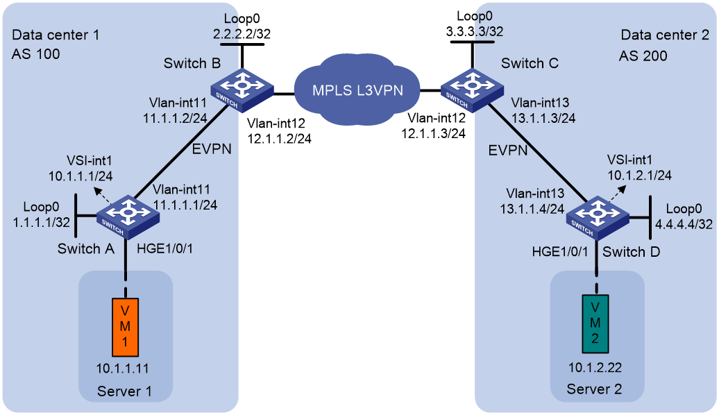

As shown in Figure 1:
·     Data center 1 and data center 2 are interconnected through an MPLS L3VPN network. The two data centers can communicate with each other through the MPLS L3VPN network.
·     Switch A and Switch D are distributed EVPN gateways in the data centers.
·     Switch B and Switch C act as both EVPN EDs and MPLS L3VPN PEs.
Figure 1 Network diagram
Analysis
For the switches within a data center to reach each other, configure a routing protocol on the switches to advertise routes for interfaces (including the loopback interfaces). In this example, OSPF is used.
To enable communication between the data centers, you must perform the following tasks on Switch B and Switch C:
·     Configure both MPLS L3VPN and EVPN.
·     Configure the BGP EVPN address family and the BGP VPNv4 address family to exchange routes.

# On Switch D, create Ethernet service instance 1000 on HundredGigE 1/0/1 to match VLAN 100 and map the Ethernet service instance to VSI vpn1.
[SwitchD] vlan 100
[SwitchD-vlan100] quit
[SwitchD] interface hundredgige 1/0/1
[SwitchD-HundredGigE1/0/1] port link-type trunk
[SwitchD-HundredGigE1/0/1] port trunk permit vlan 100
[SwitchD-HundredGigE1/0/1] quit
[SwitchD-HundredGigE1/0/1] service-instance 1000
[SwitchD-HundredGigE1/0/1-srv1000] encapsulation s-vid 100
[SwitchD-HundredGigE1/0/1-srv1000] xconnect vsi vpn1
[SwitchD-HundredGigE1/0/1-srv1000] quit
Establishing BGP EVPN peer relationship within a data center
Data center 1
# Configure Switch A to advertise BGP EVPN routes.
[SwitchA] bgp 100
[SwitchA-bgp-default] peer 2.2.2.2 as-number 100
[SwitchA-bgp-default] peer 2.2.2.2 connect-interface loopback 0
[SwitchA-bgp-default] address-family l2vpn evpn
[SwitchA-bgp-default-evpn] peer 2.2.2.2 enable
[SwitchA-bgp-default-evpn] quit
[SwitchA-bgp-default] quit
# Configure Switch B to advertise BGP EVPN routes.
[SwitchB] bgp 100
[SwitchB-bgp-default] peer 1.1.1.1 as-number 100
[SwitchB-bgp-default] peer 1.1.1.1 connect-interface loopback 0
[SwitchB-bgp-default] address-family l2vpn evpn
[SwitchB-bgp-default-evpn] peer 1.1.1.1 enable
[SwitchB-bgp-default-evpn] quit
[SwitchB-bgp-default] quit
Data center 2
# Configure Switch C to advertise BGP EVPN routes.
[SwitchC] bgp 200
[SwitchC-bgp-default] peer 4.4.4.4 as-number 200
[SwitchC-bgp-default] peer 4.4.4.4 connect-interface loopback 0
[SwitchC-bgp-default] address-family l2vpn evpn
[SwitchC-bgp-default-evpn] peer 4.4.4.4 enable
[SwitchC-bgp-default-evpn] quit
[SwitchC-bgp-default] quit
# Configure Switch D to advertise BGP EVPN routes.
[SwitchD] bgp 200
[SwitchD-bgp-default] peer 3.3.3.3 as-number 200
[SwitchD-bgp-default] peer 3.3.3.3 connect-interface loopback 0
[SwitchD-bgp-default] address-family l2vpn evpn
[SwitchD-bgp-default-evpn] peer 3.3.3.3 enable
[SwitchD-bgp-default-evpn] quit
[SwitchD-bgp-default] quit
Establishing MPLS L3VPN connections between ASs
Configuring Switch B
# Configure the LSR ID as 2.2.2.2 for the local node, enable LDP globally, and enable MPLS and IPv4 LDP on HundredGigE 1/0/2.
[SwitchB] mpls lsr-id 2.2.2.2
[SwitchB] mpls ldp
[SwitchB-ldp] quit
[SwitchB] interface vlan-interface 12
[SwitchB–Vlan-interface12] mpls enable
[SwitchB–Vlan-interface12] mpls ldp enable
[SwitchB–Vlan-interface12] quit
# Configure BGP to advertise VPNv4 routes.
[SwitchB] bgp 100
[SwitchB-bgp-default] peer 12.1.1.3 as-number 200
[SwitchB-bgp-default] address-family vpnv4
[SwitchB-bgp-default-vpnv4] peer 12.1.1.3 enable
[SwitchB-bgp-default-vpnv4] quit
Configuring Switch C
# Configure the LSR ID as 3.3.3.3 for the local node, enable LDP globally, and enable MPLS and IPv4 LDP on HundredGigE 1/0/1.
[SwitchC] mpls lsr-id 3.3.3.3
[SwitchC] mpls ldp
[SwitchC -ldp] quit
[SwitchC] interface vlan-interface 12
[SwitchC–Vlan-interface12] mpls enable
[SwitchC–Vlan-interface12] mpls ldp enable
[SwitchC–Vlan-interface12] quit
[SwitchC] bgp 200
[SwitchC-bgp-default] peer 12.1.1.2 as-number 100
[SwitchC-bgp-default] address-family vpnv4
[SwitchC-bgp-default-vpnv4] peer 12.1.1.2 enable
[SwitchC-bgp-default-vpnv4] quit
Configuring the BGP EVPN address family and the BGP VPNv4 address family to exchange routes
# On Switch B, configure the BGP EVPN address family and the BGP VPNv4 address family to exchange routes.
[SwitchB] bgp 100
[SwitchB-bgp-default-evpn] advertise l3vpn route
[SwitchB-bgp-default-vpnv4] advertise evpn route
# On Switch C, configure the BGP EVPN address family and the BGP VPNv4 address family to exchange routes.
[SwitchC] bgp 200
[SwitchC-bgp-default-evpn] advertise l3vpn route
[SwitchC-bgp-default-vpnv4] advertise evpn route
# On Switch B, display the BGP VPNv4 routing table. Verify that BGP EVPN routes are redistributed to the routing table.
[SwitchB] display bgp routing-table vpnv4
 BGP local router ID is 2.2.2.2
 Status codes: * - valid, > - best, d - dampened, h - history
               s - suppressed, S - stale, i - internal, e - external
               a - additional-path
       Origin: i - IGP, e - EGP, ? - incomplete
 Total number of routes from all PEs: 1
 Route distinguisher: 1:2(vpna)
 Total number of routes: 3
     Network            NextHop         MED        LocPrf     PrefVal Path/Ogn
* >i 10.1.1.0/24        1.1.1.1         0          100        0       i
* >i 10.1.1.11/32       1.1.1.1         0          100        0       i
* >e 10.1.2.0/24        12.1.1.3                              0       200i
 Route distinguisher: 1:3
 Total number of routes: 1
# Display BGP VPNv4 route advertisement information. Verify that the BGP EVPN routes are advertised to the BGP VPNv4 neighbor.
[SwitchB] display bgp routing-table vpnv4 10.1.1.0 advertise-info
 BGP local router ID: 2.2.2.2
 Local AS number: 100
 Paths:   1 best
 BGP routing table information of 10.1.1.0/24(TxPathID:0):
 Advertised to VPN peers (1 in total):
    12.1.1.3
 Inlabel              : 1150
# Display BGP EVPN routes. Verify that an IP prefix advertisement route is generated based on the route that is redistributed in to the BGP EVPN address family from the BGP VPNv4 address family.
[SwitchB] display bgp l2vpn evpn
               a - additional-path
 Total number of routes from all PEs: 2
 Route distinguisher: 1:1
*>  Network : [5][0][24][10.1.1.0]/80
    NextHop : 1.1.1.1                             LocPrf    :100
    PrefVal : 0                                   OutLabel  : NULL
    MED     : 0
    Path/Ogn: i
 Total number of routes: 2
*>i Network : [2][0][48][0005-0005-0005][32][10.1.1.11]/136
    NextHop : 1.1.1.1                             LocPrf    : 100
    MED     : 0
    Path/Ogn: i
*>e Network : [5][0][24][10.1.2.0]/80
    NextHop : 127.0.0.1                           LocPrf    : 0
    MED     : 0
    Path/Ogn: 200i
 Route distinguisher: 1:10
    MED     : 0
    Path/Ogn: i
# Display detailed advertisement information about the IP prefix advertisement route. Verify that the switch has advertised the route to the EVPN neighbor.
[SwitchB] display bgp l2vpn evpn [5][0][24][10.1.2.0]/80 advertise-info
 Paths:   1 best
 BGP routing table information of [5][0][24][10.1.2.0]/80(TxPathID:0):
 Advertised to peers (1 in total):
    1.1.1.1
