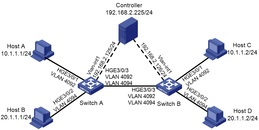

As shown in Figure 1, configure OpenFlow to meet the following requirements:
·     The controller can deploy dynamic flow entries.
·     Host A and Host C can communicate with each other based on the flow entries deployed by the controller.
·     Host B and Host D can communicate with each other based on the flow entries deployed by the controller.
Figure 1 Network diagram

Procedures
Configuring Switch A
# Create VLAN 4092 and VLAN 4094.
<SwitchA> system-view
[SwitchA] vlan 4092
[SwitchA-vlan4092] quit
[SwitchA] vlan 4094
[SwitchA-vlan4094] quit
# Configure HundredGigE 3/0/1, HundredGigE 3/0/2, and HundredGigE 3/0/3.
[SwitchA] interface hundredgige 3/0/1
[SwitchA-HundredGigE3/0/1] port access vlan 4092
[SwitchA-HundredGigE3/0/1] quit
[SwitchA] interface hundredgige 3/0/2
[SwitchA-HundredGigE3/0/2] port access vlan 4094
[SwitchA-HundredGigE3/0/2] quit
[SwitchA] interface hundredgige 3/0/3
[SwitchA-HundredGigE3/0/3] port link-type trunk
[SwitchA-HundredGigE3/0/3] port trunk permit vlan 4092 4094
[SwitchA-HundredGigE3/0/3] quit
# Enable LLDP globally.
[SwitchA] lldp global enable
# Configure VLAN-interface 1 on Switch A for communicating with the controller.
[SwitchA] interface Vlan-interface 1
[SwitchA-Vlan-interface1] ip address 192.168.2.125 255.255.255.0
[SwitchA-Vlan-interface1] quit
# Create OpenFlow instance 1. Associate VLAN 4092 and VLAN 4094 with it in loosen mode.
[SwitchA] openflow instance 1
[SwitchA-of-inst-1] classification vlan 4092 mask 4093 loosen
# Specify 192.168.2.225 as the IP address of controller 0 for OpenFlow instance 1 and activate the instance..
[SwitchA-of-inst-1] controller 0 address ip 192.168.2.225
[SwitchA-of-inst-1] active instance
[SwitchA-of-inst-1] quit

The output shows the following information:
·     The ARP request/reply packets and ICMP request/replay packets between Host B and Host D successfully trigger the controller to deploy flow entries.
·     Switch A forwards packets based on the flow entries that are deployed by the controller.

·     Switch A:
lldp global enable
vlan 4092
vlan 4094
openflow instance 1
 active instance
interface Vlan-interface1
interface HundredGigE3/0/1
 port link-mode bridge
interface HundredGigE3/0/2
interface HundredGigE3/0/3
 port trunk permit vlan 1 4092 4094
·     Switch B:
lldp global enable
vlan 4092
vlan 4094
openflow instance 1
 active instance
 ip address 192.168.2.126 255.255.255.0
