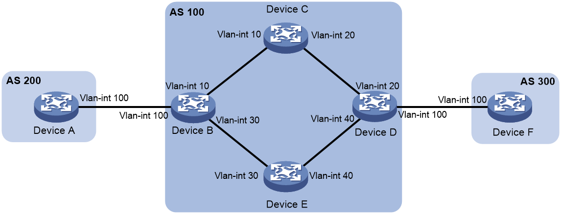

As shown in Figure 1, a company's two departments reside in different ASs. Device A and Device F are the egress devices of the two departments. OSPF is the IGP protocol in AS 100.
·     Configure BGP to make the two departments reachable to each other.
·     Configure routing polices to specify the link Device B<>Device C<>Device D as the primary link to forward traffic between Device A and Device F. When the primary link fails, the link Device B<>Device E<>Device D forwards the traffic.
Figure 1 Network diagram

Analysis
To meet the network requirements, you must perform the following tasks:
·     Configure the link Device B<—>Device C<—>Device D as the primary link:
¡     On Device B, set the local preference to 200 for the path Device D—>Device C—>Device B. The path Device D—>Device E—>Device B uses the default local preference 100.
¡     On Device D, set the local preference to 200 for the path Device B—>Device C—>Device D. The path Device B—>Device E—>Device D uses the default local preference 100.
·     Set a higher preference for IBGP routes to ensure that IBGP routes rather than OSPF external routes are used in AS 100.

[DeviceD] route-policy local-pre permit node 10
[DeviceD-route-policy-local-pre-10] if-match ip address acl 2000
[DeviceD-route-policy-local-pre-10] apply local-preference 200
[DeviceD-route-policy-local-pre-10] quit
# Apply routing policy local-pre to routes outgoing to peer 10.1.0.101.
[DeviceD] bgp 100
[DeviceD-bgp-default] address-family ipv4 unicast
[DeviceD-bgp-default-ipv4] peer 10.1.0.101 route-policy local-pre export
# Set the preference for IBGP routes to 100 (higher than the default preference of OSPF external routes 150).
[DeviceD-bgp-default-ipv4] preference 255 100 130
[DeviceD-bgp-default-ipv4] quit
# On Device B, display the BGP routing table.
[DeviceB] display bgp routing-table ipv4
 Total number of routes: 3
 BGP local router ID is 2.2.2.2
 Status codes: * - valid, > - best, d - dampened, h - history
               s - suppressed, S - stale, i - internal, e – external
               a - additional-path
       Origin: i - IGP, e - EGP, ? - incomplete
     Network            NextHop         MED        LocPrf     PrefVal Path/Ogn
* >e 120.1.0.0/24       120.1.0.1       0                     0       200i
* >i 120.2.0.0/24       10.2.0.101      0          200        0       300i
*  i                    13.1.1.101      0          100        0       300i
The output shows that Device B has two routes to 120.2.0.0/24 with local preferences 100 and 200.
# Trace the path that traffic traverses from Device A to Device F.
[DeviceA] tracert 120.2.0.1
traceroute to 120.2.0.1 (120.2.0.1), 30 hops at most, 52 bytes each packet, press CTRL+C to break
 1  120.1.0.2 (120.1.0.2)  2.208 ms  1.119 ms  1.085 ms
 2  10.1.0.102 (10.1.0.102)  1.083 ms  1.100 ms  1.085 ms
 3  10.2.0.101 (10.2.0.101)  2.364 ms  1.099 ms  1.086 ms
 4  120.2.0.1 (120.2.0.1)  3.825 ms  3.693 ms  4.008 ms
The output shows that traffic is forwarded along the path Device A—>Device B—>Device C—>Device D—>Device F.
# When the primary link fails, display the BGP routing table on Device B.
 Total number of routes: 2
               a - additional-path
* >i 120.2.0.0/24       13.1.1.101      0          100        0       300i
The output shows that Device B has one route to 120.2.0.0/24.
 1  120.1.0.2 (120.1.0.2)  2.308 ms  1.127 ms  1.091 ms
 2  192.168.0.102 (192.168.0.102)  1.086 ms  1.102 ms  1.096 ms
 3  13.1.1.101 (13.1.1.101)  2.451 ms  2.087 ms  1.092 ms
 4  120.2.0.1 (120.2.0.1)  3.533 ms  3.818 ms  4.002 ms
The output shows that traffic is forwarded along the path Device A—>Device B—>Device E—>Device D—>Device F.
