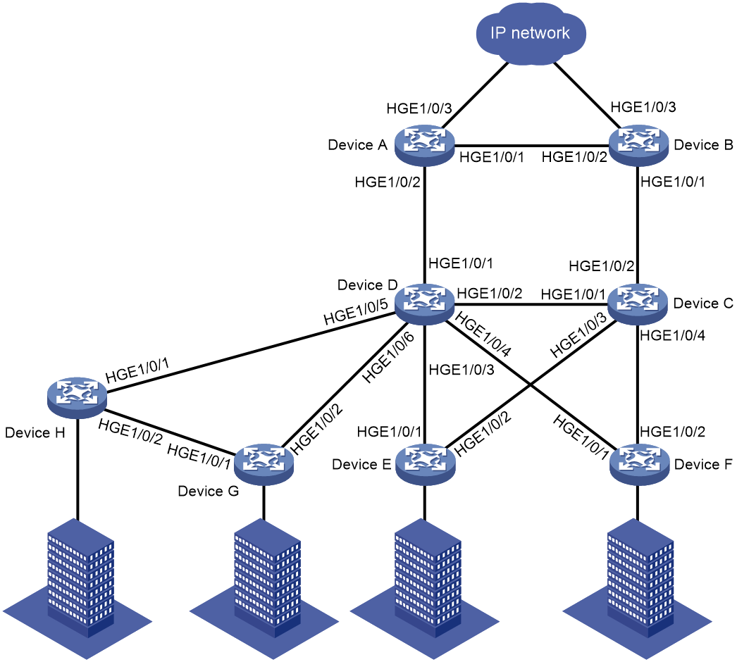

Example: Configuring a single ring
As shown in Figure 1, area A and area B are connected to a ring-shaped distribution layer network. Configure RRPP to implement the following requirements in the network:
·     Eliminate loops and implement link recovery in the Layer 2 network.
·     Implement link load balancing by forwarding voice traffic in VLAN 100 through VLAN 150 and video traffic in VLAN 151 through VLAN 200.
·     Improve RRPP topology convergence speed by setting the physical state change suppression interval to 0 seconds for all Ethernet interfaces on the RRPP ring.
Figure 1 Network diagram

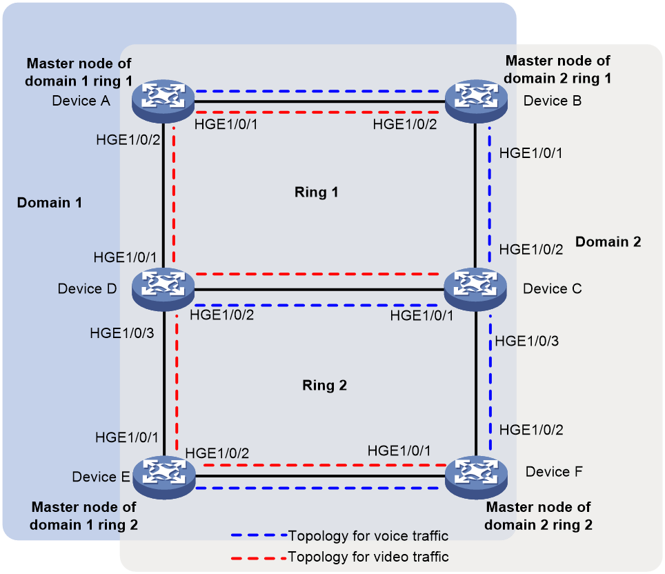

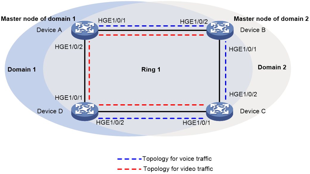

Analysis
For voice and video traffic to be forwarded in different topologies, create two RRPP domains.
·     In RRPP domain 1, specify VLAN 100 through VLAN 150 as protected VLANs, and specify Device A as the master node.
·     In RRPP domain 2, specify VLAN 151 through VLAN 200 as protected VLANs, and specify Device B as the master node.
To implement load balancing for voice and video traffic, perform the following tasks:
·     On Device A, specify HundredGigE 1/0/1 as the primary port, and HundredGigE 1/0/2 as the secondary port.
·     On Device B, specify HundredGigE 1/0/2 as the primary port, and HundredGigE 1/0/1 as the secondary port.
Figure 2 Topologies for voice and video traffic

[DeviceC-rrpp-domain1] quit
# Create RRPP domain 2.
[DeviceC] rrpp domain 2
# Configure VLAN 2000 as the primary control VLAN of RRPP domain 2.
[DeviceC-rrpp-domain2] control-vlan 2000
# Configure the VLANs mapped to MSTI 2 as the protected VLANs of RRPP domain 2.
[DeviceC-rrpp-domain2] protected-vlan reference-instance 2
# Configure Device C as the transit node of primary ring 1, with HundredGigE 1/0/1 as the primary port and HundredGigE 1/0/2 as the secondary port. Enable ring 1.
[DeviceC-rrpp-domain2] ring 1 node-mode transit primary-port hundredgige 1/0/1 secondary-port hundredgige 1/0/2 level 0
[DeviceC-rrpp-domain2] ring 1 enable
[DeviceC-rrpp-domain2] quit
# Enable RRPP.
[DeviceC] rrpp enable
Configuring Device D
# Create VLANs 100 through 200.
<DeviceD> system-view
[DeviceD] vlan 100 to 200
# Map VLANs 100 through 150 to MSTI 1, and VLANs 151 through 200 to MSTI 2.
[DeviceD] stp region-configuration
[DeviceD-mst-region] instance 1 vlan 100 to 150
[DeviceD-mst-region] instance 2 vlan 151 to 200
# Activate the MST region configuration.
[DeviceD-mst-region] active region-configuration
[DeviceD-mst-region] quit
# Configure HundredGigE 1/0/1 as a trunk port.
[DeviceD] interface hundredgige 1/0/1
[DeviceD-HundredGigE1/0/1] undo shutdown
[DeviceD-HundredGigE1/0/1] port link-type trunk
# Assign the port to VLANs 100 through 200, and remove it from VLAN 1.
[DeviceD-HundredGigE1/0/1] port trunk permit vlan 100 to 200
[DeviceD-HundredGigE1/0/1] undo port trunk permit vlan 1
# Set the physical state change suppression interval to 0 seconds on the port.
[DeviceD-HundredGigE1/0/1] link-delay up 0
[DeviceD-HundredGigE1/0/1] link-delay down 0
# Disable the spanning tree feature on the port.
[DeviceD-HundredGigE1/0/1] undo stp enable
[DeviceD-HundredGigE1/0/1] quit
# Configure HundredGigE 1/0/2 in the same way HundredGigE 1/0/1 is configured.
[DeviceD] interface hundredgige 1/0/2
[DeviceD-HundredGigE1/0/2] undo shutdown
[DeviceD-HundredGigE1/0/2] port link-type trunk
[DeviceD-HundredGigE1/0/2] port trunk permit vlan 100 to 200
[DeviceD-HundredGigE1/0/2] undo port trunk permit vlan 1
[DeviceD-HundredGigE1/0/2] link-delay up 0
[DeviceD-HundredGigE1/0/2] link-delay down 0
[DeviceD-HundredGigE1/0/2] undo stp enable
[DeviceD-HundredGigE1/0/2] quit
# Create RRPP domain 1.
[DeviceD] rrpp domain 1
# Configure VLAN 1000 as the primary control VLAN of RRPP domain 1.
[DeviceD-rrpp-domain1] control-vlan 1000
# Configure the VLANs mapped to MSTI 1 as the protected VLANs of RRPP domain 1.
[DeviceD-rrpp-domain1] protected-vlan reference-instance 1
# Configure Device D as the transit node of primary ring 1, with HundredGigE 1/0/1 as the primary port and HundredGigE 1/0/2 as the secondary port. Enable ring 1.
[DeviceD-rrpp-domain1] ring 1 node-mode transit primary-port hundredgige 1/0/1 secondary-port hundredgige 1/0/2 level 0
[DeviceD-rrpp-domain1] ring 1 enable
[DeviceD-rrpp-domain1] quit
[DeviceD] rrpp domain 2
[DeviceD-rrpp-domain2] control-vlan 2000
[DeviceD-rrpp-domain2] protected-vlan reference-instance 2
[DeviceD-rrpp-domain2] ring 1 node-mode transit primary-port hundredgige 1/0/1 secondary-port hundredgige 1/0/2 level 0
[DeviceD-rrpp-domain2] ring 1 enable
[DeviceD-rrpp-domain2] quit
# Enable RRPP.
[DeviceD] rrpp enable
# View detailed information about RRPP domain 1 on Device A.
[DeviceA] display rrpp verbose domain 1
 Domain ID     : 1
Control VLAN  : Primary 1000, Secondary 1001
Protected VLAN: Reference instance 1
Hello timer   : 1 seconds, Fail timer: 3 seconds
Fast detection status: Disabled
Fast-Hello timer: 20 ms, Fast-Fail timer: 60 ms
Fast-Edge-Hello timer: 10 ms, Fast-Edge-Fail timer: 30 ms
Ring ID       : 1
Ring Level    : 0
Node Mode     : Master
Ring State    : Completed
Enable Status : Yes    Active Status: Yes
Primary port  : HGE1/0/1                    Port status: UP
Secondary port: HGE1/0/2                    Port status: BLOCKED
The output shows the following information:
·     Device A is the master node in RRPP domain 1.
·     The primary ring state of RRPP domain 1 is completed.
·     The primary port is up, and the secondary port is blocked.
# View detailed information about RRPP domain 2 on Device A.
[DeviceA] display rrpp verbose domain 2
Domain ID     : 2
Control VLAN  : Primary 2000, Secondary 2001
Protected VLAN: Reference instance 2
Ring ID       : 1
Ring Level    : 0
Node Mode     : Transit
Ring State    : -
Secondary port: HGE1/0/2                    Port status: UP
·     Device A is the transit node in RRPP domain 2.
·     The primary and secondary ports are up.
# View detailed information about RRPP domain 1 on Device B.
[DeviceB] display rrpp verbose domain 1
 Domain ID     : 1
Ring ID       : 1
Ring Level    : 0
Node Mode     : Transit
Ring State    : -
Primary port  : HGE1/0/2                    Port status: UP
Secondary port: HGE1/0/1                    Port status: UP
·     Device B is the transit node in RRPP domain 1.
# View detailed information about RRPP domain 2 on Device B.
[DeviceB] display rrpp verbose domain 2
 Domain ID     : 2
Ring ID       : 1
Ring Level    : 0
Node Mode     : Master
Secondary port: HGE1/0/1                    Port status: BLOCKED
·     Device B is the master node in RRPP domain 2.
·     The primary ring state of RRPP domain 2 is completed.
# View detailed information about RRPP domain 1 on Device C.
[DeviceC] display rrpp verbose domain 1
 Domain ID     : 1
Ring ID       : 1
Ring Level    : 0
Node Mode     : Transit
Ring State    : -
·     Device C is the transit node in RRPP domain 1.
# View detailed information about RRPP domain 2 on Device C.
[DeviceC] display rrpp verbose domain 2
 Domain ID     : 2
Ring ID       : 1
Ring Level    : 0
Node Mode     : Transit
Ring State    : -
·     Device C is the transit node in RRPP domain 2.
# View detailed RRPP domain information on Device D. (Details not shown.)

Example: Configuring intersecting rings
As shown in Figure 3, a ring-shaped access layer network is connected to a ring-shaped distribution layer network. Configure RRPP to implement the following requirements in the network:
Figure 3 Network diagram
Analysis
·     In RRPP domain 1, specify VLAN 100 through VLAN 150 as protected VLANs. Specify Device A as the master node of primary ring 1, and Device E as the master node of subring 2.
·     In RRPP domain 2, specify VLAN 151 through VLAN 200 as protected VLANs. Specify Device B as the master node of primary ring 1, and Device F as the master node of subring 2.
·     On Device E, specify HundredGigE 1/0/2 as the primary port, and HundredGigE 1/0/1 as the secondary port.
·     On Device F, specify HundredGigE 1/0/1 as the primary port, and HundredGigE 1/0/2 as the secondary port.

Configuring Device A
<DeviceA> system-view
[DeviceA] vlan 100 to 200
[DeviceA] stp region-configuration
[DeviceA-mst-region] instance 1 vlan 100 to 150
[DeviceA-mst-region] instance 2 vlan 151 to 200
[DeviceA-mst-region] active region-configuration
[DeviceA-mst-region] quit
[DeviceA] interface hundredgige 1/0/1
[DeviceA-HundredGigE1/0/1] undo shutdown
[DeviceA-HundredGigE1/0/1] port link-type trunk
[DeviceA-HundredGigE1/0/1] port trunk permit vlan 100 to 200
[DeviceA-HundredGigE1/0/1] undo port trunk permit vlan 1
[DeviceA-HundredGigE1/0/1] link-delay up 0
[DeviceA-HundredGigE1/0/1] link-delay down 0
[DeviceA-HundredGigE1/0/1] undo stp enable
[DeviceA-HundredGigE1/0/1] quit
[DeviceA] interface hundredgige 1/0/2
[DeviceA-HundredGigE1/0/2] undo shutdown
[DeviceA-HundredGigE1/0/2] port link-type trunk
[DeviceA-HundredGigE1/0/2] port trunk permit vlan 100 to 200
[DeviceA-HundredGigE1/0/2] undo port trunk permit vlan 1
[DeviceA-HundredGigE1/0/2] link-delay up 0
[DeviceA-HundredGigE1/0/2] link-delay down 0
[DeviceA-HundredGigE1/0/2] undo stp enable
[DeviceA-HundredGigE1/0/2] quit
[DeviceA] rrpp domain 1
[DeviceA-rrpp-domain1] control-vlan 1000
[DeviceA-rrpp-domain1] protected-vlan reference-instance 1
# Configure Device A as the master node of primary ring 1, with HundredGigE 1/0/1 as the primary port and HundredGigE 1/0/2 as the secondary port. Enable ring 1.
[DeviceA-rrpp-domain1] ring 1 node-mode master primary-port hundredgige 1/0/1 secondary-port hundredgige 1/0/2 level 0
[DeviceA-rrpp-domain1] ring 1 enable
[DeviceA-rrpp-domain1] quit
[DeviceA] rrpp domain 2
[DeviceA-rrpp-domain2] control-vlan 2000
[DeviceA-rrpp-domain2] protected-vlan reference-instance 2
# Configure Device A as the transit node of primary ring 1, with HundredGigE 1/0/1 as the primary port and HundredGigE 1/0/2 as the secondary port. Enable ring 1.
[DeviceA-rrpp-domain2] ring 1 node-mode transit primary-port HundredGigE 1/0/1 secondary-port HundredGigE 1/0/2 level 0
[DeviceA-rrpp-domain2] ring 1 enable
[DeviceA-rrpp-domain2] quit
# Enable RRPP.
[DeviceA] rrpp enable
Configuring Device B
<DeviceB> system-view
[DeviceB] vlan 100 to 200
[DeviceB] stp region-configuration
[DeviceB-mst-region] instance 1 vlan 100 to 150
[DeviceB-mst-region] instance 2 vlan 151 to 200
[DeviceB-mst-region] active region-configuration
[DeviceB-mst-region] quit
[DeviceB] interface hundredgige 1/0/1
[DeviceB-HundredGigE1/0/1] undo shutdown
[DeviceB-HundredGigE1/0/1] port link-type trunk
[DeviceB-HundredGigE1/0/1] port trunk permit vlan 100 to 200
[DeviceB-HundredGigE1/0/1] undo port trunk permit vlan 1
[DeviceB-HundredGigE1/0/1] link-delay up 0
[DeviceB-HundredGigE1/0/1] link-delay down 0
[DeviceB-HundredGigE1/0/1] undo stp enable
[DeviceB-HundredGigE1/0/1] quit
[DeviceB] interface hundredgige 1/0/2
[DeviceB-HundredGigE1/0/2] undo shutdown
[DeviceB-HundredGigE1/0/2] port link-type trunk
[DeviceB-HundredGigE1/0/2] port trunk permit vlan 100 to 200
[DeviceB-HundredGigE1/0/2] undo port trunk permit vlan 1
[DeviceB-HundredGigE1/0/2] link-delay up 0
[DeviceB-HundredGigE1/0/2] link-delay down 0
[DeviceB-HundredGigE1/0/2] undo stp enable
[DeviceB-HundredGigE1/0/2] quit
[DeviceB] rrpp domain 1
[DeviceB-rrpp-domain1] control-vlan 1000
[DeviceB-rrpp-domain1] protected-vlan reference-instance 1
# Configure Device B as the transit node of primary ring 1, with HundredGigE 1/0/2 as the primary port and HundredGigE 1/0/1 as the secondary port. Enable ring 1.
[DeviceB-rrpp-domain1] ring 1 node-mode transit primary-port hundredgige 1/0/2 secondary-port hundredgige 1/0/1 level 0
[DeviceB-rrpp-domain1] ring 1 enable
[DeviceB-rrpp-domain1] quit
[DeviceB] rrpp domain 2
[DeviceB-rrpp-domain2] control-vlan 2000
[DeviceB-rrpp-domain2] protected-vlan reference-instance 2
# Configure Device B as the master node of primary ring 1, with HundredGigE 1/0/2 as the primary port and HundredGigE 1/0/1 as the secondary port. Enable ring 1.
[DeviceB-rrpp-domain2] ring 1 node-mode master primary-port hundredgige 1/0/2 secondary-port hundredgige 1/0/1 level 0
[DeviceB-rrpp-domain2] ring 1 enable
[DeviceB-rrpp-domain2] quit
# Enable RRPP.
[DeviceB] rrpp enable
Configuring Device C
<DeviceC> system-view
[DeviceC] vlan 100 to 200
[DeviceC] stp region-configuration
[DeviceC-mst-region] instance 1 vlan 100 to 150
[DeviceC-mst-region] instance 2 vlan 151 to 200
[DeviceC-mst-region] active region-configuration
[DeviceC-mst-region] quit
[DeviceC] interface hundredgige 1/0/1
[DeviceC-HundredGigE1/0/1] undo shutdown
[DeviceC-HundredGigE1/0/1] port link-type trunk
[DeviceC-HundredGigE1/0/1] port trunk permit vlan 100 to 200
[DeviceC-HundredGigE1/0/1] undo port trunk permit vlan 1
[DeviceC-HundredGigE1/0/1] link-delay up 0
[DeviceC-HundredGigE1/0/1] link-delay down 0
[DeviceC-HundredGigE1/0/1] undo stp enable
[DeviceC-HundredGigE1/0/1] quit
[DeviceC] interface hundredgige 1/0/2
[DeviceC-HundredGigE1/0/2] undo shutdown
[DeviceC-HundredGigE1/0/2] port link-type trunk
[DeviceC-HundredGigE1/0/2] port trunk permit vlan 100 to 200
[DeviceC-HundredGigE1/0/2] undo port trunk permit vlan 1
[DeviceC-HundredGigE1/0/2] link-delay up 0
[DeviceC-HundredGigE1/0/2] link-delay down 0
[DeviceC-HundredGigE1/0/2] undo stp enable
[DeviceC-HundredGigE1/0/2] quit
# Configure HundredGigE 1/0/3 in the same way HundredGigE 1/0/1 is configured.
[DeviceC] interface hundredgige 1/0/3
[DeviceC-HundredGigE1/0/3] undo shutdown
[DeviceC-HundredGigE1/0/3] port link-type trunk
[DeviceC-HundredGigE1/0/3] port trunk permit vlan 100 to 200
[DeviceC-HundredGigE1/0/3] undo port trunk permit vlan 1
[DeviceC-HundredGigE1/0/3] link-delay up 0
[DeviceC-HundredGigE1/0/3] link-delay down 0
[DeviceC-HundredGigE1/0/3] undo stp enable
[DeviceC-HundredGigE1/0/3] quit
[DeviceC] rrpp domain 1
[DeviceC-rrpp-domain1] control-vlan 1000
[DeviceC-rrpp-domain1] protected-vlan reference-instance 1
[DeviceC-rrpp-domain1] ring 1 node-mode transit primary-port hundredgige 1/0/1 secondary-port hundredgige 1/0/2 level 0
[DeviceC-rrpp-domain1] ring 1 enable
# Configure Device C as the edge node of subring 2, with HundredGigE 1/0/3 as the edge port. Enable ring 2.
[DeviceC-rrpp-domain1] ring 2 node-mode edge edge-port hundredgige 1/0/3
[DeviceC-rrpp-domain1] ring 2 enable
[DeviceC-rrpp-domain2] ring 2 node-mode edge edge-port hundredgige 1/0/3
[DeviceC-rrpp-domain2] ring 2 enable
# Enable RRPP.
[DeviceD] interface hundredgige 1/0/3
[DeviceD-HundredGigE1/0/3] undo shutdown
[DeviceD-HundredGigE1/0/3] port link-type trunk
[DeviceD-HundredGigE1/0/3] port trunk permit vlan 100 to 200
[DeviceD-HundredGigE1/0/3] undo port trunk permit vlan 1
[DeviceD-HundredGigE1/0/3] link-delay up 0
[DeviceD-HundredGigE1/0/3] link-delay down 0
[DeviceD-HundredGigE1/0/3] undo stp enable
[DeviceD-HundredGigE1/0/3] quit
# Configure Device D as the assistant edge node of subring 2, with HundredGigE 1/0/3 as the edge port. Enable ring 2.
[DeviceD-rrpp-domain1] ring 2 node-mode assistant-edge edge-port hundredgige 1/0/3
[DeviceD-rrpp-domain1] ring 2 enable
[DeviceD-rrpp-domain2] ring 2 node-mode assistant-edge edge-port hundredgige 1/0/3
[DeviceD-rrpp-domain2] ring 2 enable
# Enable RRPP.
Configuring Device E
<DeviceE> system-view
[DeviceE] vlan 100 to 200
[DeviceE] stp region-configuration
[DeviceE-mst-region] instance 1 vlan 100 to 150
[DeviceE-mst-region] instance 2 vlan 151 to 200
[DeviceE-mst-region] active region-configuration
[DeviceE-mst-region] quit
[DeviceE] interface hundredgige 1/0/1
[DeviceE-HundredGigE1/0/1] undo shutdown
[DeviceE-HundredGigE1/0/1] port link-type trunk
[DeviceE-HundredGigE1/0/1] port trunk permit vlan 100 to 200
[DeviceE-HundredGigE1/0/1] undo port trunk permit vlan 1
[DeviceE-HundredGigE1/0/1] link-delay up 0
[DeviceE-HundredGigE1/0/1] link-delay down 0
[DeviceE-HundredGigE1/0/1] undo stp enable
[DeviceE-HundredGigE1/0/1] quit
[DeviceE] interface hundredgige 1/0/2
[DeviceE-HundredGigE1/0/2] undo shutdown
[DeviceE-HundredGigE1/0/2] port link-type trunk
[DeviceE-HundredGigE1/0/2] port trunk permit vlan 100 to 200
[DeviceE-HundredGigE1/0/2] undo port trunk permit vlan 1
[DeviceE-HundredGigE1/0/2] link-delay up 0
[DeviceE-HundredGigE1/0/2] link-delay down 0
[DeviceE-HundredGigE1/0/2] undo stp enable
[DeviceE-HundredGigE1/0/2] quit
[DeviceE] rrpp domain 1
[DeviceE-rrpp-domain1] control-vlan 1000
[DeviceE-rrpp-domain1] protected-vlan reference-instance 1
# Configure Device E as the master node of subring 2, with HundredGigE 1/0/2 as the primary port and HundredGigE 1/0/1 as the secondary port. Enable ring 2.
[DeviceE-rrpp-domain1] ring 2 node-mode master primary-port hundredgige 1/0/2 secondary-port hundredgige 1/0/1 level 1
[DeviceE-rrpp-domain1] ring 2 enable
[DeviceE-rrpp-domain1] quit
[DeviceE] rrpp domain 2
[DeviceE-rrpp-domain2] control-vlan 2000
[DeviceE-rrpp-domain2] protected-vlan reference-instance 2
# Configure Device E as the transit node of subring 2, with HundredGigE 1/0/2 as the primary port and HundredGigE 1/0/1 as the secondary port. Enable ring 2.
[DeviceE-rrpp-domain2] ring 2 node-mode transit primary-port hundredgige 1/0/2 secondary-port hundredgige 1/0/1 level 1
[DeviceE-rrpp-domain2] ring 2 enable
[DeviceE-rrpp-domain2] quit
# Enable RRPP.
[DeviceE] rrpp enable
Configuring Device F
<DeviceF> system-view
[DeviceF] vlan 100 to 200
[DeviceF] stp region-configuration
[DeviceF-mst-region] instance 1 vlan 100 to 150
[DeviceF-mst-region] instance 2 vlan 151 to 200
[DeviceF-mst-region] active region-configuration
[DeviceF-mst-region] quit
[DeviceF] interface hundredgige 1/0/1
[DeviceF-HundredGigE1/0/1] undo shutdown
[DeviceF-HundredGigE1/0/1] port link-type trunk
[DeviceF-HundredGigE1/0/1] port trunk permit vlan 100 to 200
[DeviceF-HundredGigE1/0/1] undo port trunk permit vlan 1
[DeviceF-HundredGigE1/0/1] link-delay up 0
[DeviceF-HundredGigE1/0/1] link-delay down 0
[DeviceF-HundredGigE1/0/1] undo stp enable
[DeviceF-HundredGigE1/0/1] quit
[DeviceF] interface hundredgige 1/0/2
[DeviceF-HundredGigE1/0/2] undo shutdown
[DeviceF-HundredGigE1/0/2] port link-type trunk
[DeviceF-HundredGigE1/0/2] port trunk permit vlan 100 to 200
[DeviceF-HundredGigE1/0/2] undo port trunk permit vlan 1
[DeviceF-HundredGigE1/0/2] link-delay up 0
[DeviceF-HundredGigE1/0/2] link-delay down 0
[DeviceF-HundredGigE1/0/2] undo stp enable
[DeviceF-HundredGigE1/0/2] quit
[DeviceF] rrpp domain 1
[DeviceF-rrpp-domain1] control-vlan 1000
[DeviceF-rrpp-domain1] protected-vlan reference-instance 1
# Configure Device F as the transit node of subring 2, with HundredGigE 1/0/1 as the primary port and HundredGigE 1/0/2 as the secondary port. Enable ring 2.
[DeviceF-rrpp-domain1] ring 2 node-mode transit primary-port hundredgige 1/0/1 secondary-port hundredgige 1/0/2 level 1
[DeviceF-rrpp-domain1] ring 2 enable
[DeviceF-rrpp-domain1] quit
[DeviceF] rrpp domain 2
[DeviceF-rrpp-domain2] control-vlan 2000
[DeviceF-rrpp-domain2] protected-vlan reference-instance 2
# Configure Device F as the master node of subring 2, with HundredGigE 1/0/1 as the primary port and HundredGigE 1/0/2 as the secondary port. Enable ring 2.
[DeviceF-rrpp-domain2] ring 2 node-mode master primary-port hundredgige 1/0/1 secondary-port hundredgige 1/0/2 level 1
[DeviceF-rrpp-domain2] ring 2 enable
[DeviceF-rrpp-domain2] quit
# Enable RRPP.
[DeviceF] rrpp enable
 Domain ID     : 1
Ring ID       : 1
Ring Level    : 0
Node Mode     : Master
·     Device A is the master node of primary ring 1 in RRPP domain 1.
 Domain ID     : 2
Ring ID       : 1
Ring Level    : 0
Node Mode     : Transit
Ring State    : -
·     Device A is the transit node of primary ring 1 in RRPP domain 2.
 Domain ID     : 1
Ring ID       : 1
Ring Level    : 0
Node Mode     : Transit
Ring State    : -
·     Device B is the transit node of primary ring 1 in RRPP domain 1.
 Domain ID     : 2
Ring ID       : 1
Ring Level    : 0
Node Mode     : Master
·     Device B is the master node of primary ring 1 in RRPP domain 2.
 Domain ID     : 1
Ring ID       : 1
Ring Level    : 0
Node Mode     : Transit
Ring State    : -
Ring ID       : 2
Ring Level    : 1
Node Mode     : Edge
Ring State    : -
Common port   : HGE1/0/1                    Port status: UP
Edge port     : HGE1/0/3                    Port status: UP
·     Device C is the transit node of primary ring 1 and edge node of subring 2 in RRPP domain 1.
 Domain ID     : 2
Ring ID       : 1
Ring Level    : 0
Node Mode     : Transit
Ring State    : -
Ring ID       : 2
Ring Level    : 1
Node Mode     : Edge
Ring State    : -
·     Device C is the transit node of primary ring 1 and edge node of subring 2 in RRPP domain 2.
# View detailed information about RRPP domain 1 on Device D.
[DeviceD] display rrpp verbose domain 1
 Domain ID     : 1
Ring ID       : 1
Ring Level    : 0
Node Mode     : Transit
Ring State    : -
Ring ID       : 2
Ring Level    : 1
Node Mode     : Assistant-edge
Ring State    : -

# View detailed information about RRPP domain 2 on Device D.
[DeviceD] display rrpp verbose domain 2
 Domain ID     : 2
Ring ID       : 1
Ring Level    : 0
Node Mode     : Transit
Ring State    : -
Ring ID       : 2
Ring Level    : 1
Ring State    : -
·     Device D is the transit node of primary ring 1 and assistant edge node of subring 2 in RRPP domain 2.
# View detailed information about RRPP domain 1 on Device E.
[DeviceE] display rrpp verbose domain 1
 Domain ID     : 1
Ring ID       : 2
Ring Level    : 1
Node Mode     : Master
·     Device E is the master node of subring 2 in RRPP domain 1.
·     The subring state of RRPP domain 1 is completed.
# View detailed information about RRPP domain 2 on Device E.
[DeviceE] display rrpp verbose domain 2
 Domain ID     : 2
Ring ID       : 2
Ring Level    : 1
Node Mode     : Transit
Ring State    : -
·     Device E is the transit node of subring 2 in RRPP domain 2.
# View detailed information about RRPP domain 1 on Device F.
[DeviceF] display rrpp verbose domain 1
 Domain ID     : 1
Ring ID       : 2
Ring Level    : 1
Node Mode     : Transit
Ring State    : -
·     Device F is the transit node of subring 2 in RRPP domain 1.
# View detailed information about RRPP domain 2 on Device F.
[DeviceF] display rrpp verbose domain 2
 Domain ID     : 2
Ring ID       : 2
Ring Level    : 1
Node Mode     : Master
·     Device F is the master node of subring 2 in RRPP domain 2.
·     The subring state of RRPP domain 2 is completed.
Configuration files
·     Device A:
 sysname DeviceA
vlan 1
vlan 100 to 200
interface HundredGigE1/0/1
 port link-mode bridge
 link-delay up 0
 link-delay down 0
 undo stp enable
interface HundredGigE1/0/2
 link-delay up 0
 link-delay down 0
 undo stp enable
rrpp domain 1
 control-vlan 1000
 ring 1 node-mode master primary-port HundredGigE1/0/1 secondary-port HundredGigE1/0/2 level 0
 ring 1 enable
rrpp domain 2
 control-vlan 2000
 ring 1 node-mode transit primary-port HundredGigE1/0/1 secondary-port HundredGigE1/0/2 level 0
 ring 1 enable
rrpp enable
·     Device B:
 sysname DeviceB
vlan 1
vlan 100 to 200
 link-delay up 0
 link-delay down 0
 undo stp enable
 link-delay up 0
 link-delay down 0
 undo stp enable
rrpp domain 1
 control-vlan 1000
 ring 1 node-mode transit primary-port HundredGigE1/0/2 secondary-port HundredGigE1/0/1 level 0
 ring 1 enable
rrpp domain 2
 control-vlan 2000
 ring 1 node-mode master primary-port HundredGigE1/0/2 secondary-port HundredGigE1/0/1 level 0
 ring 1 enable
rrpp enable
·     Device C:
 sysname DeviceC
vlan 1
vlan 100 to 200
 link-delay up 0
 link-delay down 0
 undo stp enable
 link-delay up 0
 link-delay down 0
 undo stp enable
interface HundredGigE1/0/3
 link-delay up 0
 link-delay down 0
 undo stp enable
rrpp domain 1
 control-vlan 1000
 ring 1 enable
 ring 2 node-mode edge edge-port HundredGigE1/0/3
 ring 2 enable
rrpp domain 2
 control-vlan 2000
 ring 1 enable
 ring 2 enable
rrpp enable
·     Device D:
 sysname DeviceD
vlan 1
vlan 100 to 200
 link-delay up 0
 link-delay down 0
 undo stp enable
 link-delay up 0
 link-delay down 0
 undo stp enable
 link-delay up 0
 link-delay down 0
 undo stp enable
rrpp domain 1
 control-vlan 1000
 ring 1 enable
 ring 2 node-mode assistant-edge edge-port HundredGigE1/0/3
 ring 2 enable
rrpp domain 2
 control-vlan 2000
 ring 1 enable
 ring 2 enable
rrpp enable
·     Device E:
 sysname DeviceE
vlan 1
vlan 100 to 200
 link-delay up 0
 link-delay down 0
 undo stp enable
 link-delay up 0
 link-delay down 0
 undo stp enable
rrpp domain 1
 control-vlan 1000
 ring 2 node-mode master primary-port HundredGigE1/0/2 secondary-port HundredGigE1/0/1 level 1
 ring 2 enable
rrpp domain 2
 control-vlan 2000
 ring 2 node-mode transit primary-port HundredGigE1/0/2 secondary-port HundredGigE1/0/1 level 1
 ring 2 enable
rrpp enable
·     Device F:
 sysname DeviceF
vlan 1
vlan 100 to 200
 link-delay up 0
 link-delay down 0
 undo stp enable
 link-delay up 0
 link-delay down 0
 undo stp enable
rrpp domain 1
 control-vlan 1000
 ring 2 node-mode transit primary-port HundredGigE1/0/1 secondary-port HundredGigE1/0/2 level 1
 ring 2 enable
rrpp domain 2
 control-vlan 2000
 ring 2 node-mode master primary-port HundredGigE1/0/1 secondary-port HundredGigE1/0/2 level 1
 ring 2 enable
rrpp enable

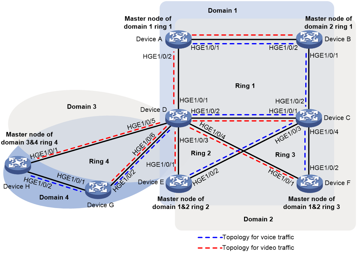

Example: Configuring dual-homed intersecting rings
As shown in Figure 5, a ring-shaped campus network is connected to a ring-shaped distribution layer network through an access layer device. Configure RRPP to implement the following requirements in the network:
·     Reduce the number of Edge-Hello packets.
Figure 5 Network diagram
Analysis
For voice and video traffic to be forwarded in different topologies, create four RRPP domains.
·     In RRPP domain 1 and domain 4, specify VLAN 100 through VLAN 150 as protected VLANs, and configure the node roles as follows:
¡     Specify Device A as the master node of primary ring 1.
¡     Specify Device E as the master node of subring 2.
¡     Specify Device F as the master node of subring 3.
¡     Specify Device H as the master node of subring 4.
·     In RRPP domain 2 and domain 3, specify VLAN 151 through VLAN 200 as protected VLANs, and configure the node roles as follows:
¡     Specify Device B as the master node of primary ring 1.
·     On Device E, specify HundredGigE 1/0/1 as the secondary port in RRPP domain 1 and primary port in RRPP domain 2. Specify HundredGigE 1/0/2 as the primary port in RRPP domain 1 and secondary port in RRPP domain 2.
·     On Device F, specify HundredGigE 1/0/1 as the secondary port in RRPP domain 1 and primary port in RRPP domain 2. Specify HundredGigE 1/0/2 as the primary port in RRPP domain 1 and secondary port in RRPP domain 2.
·     On Device H, specify HundredGigE 1/0/1 as the primary port in RRPP domain 3 and secondary port in RRPP domain 4. Specify HundredGigE 1/0/2 as the secondary port in RRPP domain 3 and primary port in RRPP domain 4.
To reduce the number of Edge-Hello packets, add ring 2 and ring 3 in RRPP domain 1 and 2 to a ring group.
# Configure Device D as the assistant edge node of subring 3, with HundredGigE 1/0/4 as the edge port. Enable ring 3.
[DeviceD-rrpp-domain2] ring 3 node-mode assistant-edge edge-port hundredgige 1/0/4
[DeviceD-rrpp-domain2] ring 3 enable
# Create RRPP domain 3.
[DeviceD] rrpp domain 3
# Configure VLAN 3000 as the primary control VLAN of RRPP domain 3.
[DeviceD-rrpp-domain3] control-vlan 3000
# Configure the VLANs mapped to MSTI 1 as the protected VLANs of RRPP domain 3.
[DeviceD-rrpp-domain3] protected-vlan reference-instance 1
# Configure Device D as the transit node of primary ring 4, with HundredGigE 1/0/5 as the primary port and HundredGigE 1/0/6 as the secondary port. Enable ring 4.
[DeviceD-rrpp-domain3] ring 4 node-mode transit primary-port hundredgige 1/0/5 secondary-port hundredgige 1/0/6 level 0
[DeviceD-rrpp-domain3] ring 4 enable
[DeviceD-rrpp-domain3] quit
# Create RRPP domain 4.
[DeviceD] rrpp domain 4
# Configure VLAN 4000 as the primary control VLAN of RRPP domain 4.
[DeviceD-rrpp-domain4] control-vlan 4000
# Configure the VLANs mapped to MSTI 2 as the protected VLANs of RRPP domain 4.
[DeviceD-rrpp-domain4] protected-vlan reference-instance 2
[DeviceD-rrpp-domain4] ring 4 node-mode transit primary-port hundredgige 1/0/5 secondary-port hundredgige 1/0/6 level 0
[DeviceD-rrpp-domain4] ring 4 enable
[DeviceD-rrpp-domain4] quit
# Create RRPP ring group 1, and add subrings 2 and 3 in RRPP domains 1 and 2 to the RRPP ring group.
[DeviceD] rrpp ring 1
[DeviceD-ring-group1] domain 1 ring 2 3
[DeviceD-ring-group1] domain 2 ring 2 3
[DeviceD-ring-group1] quit
# Enable RRPP.
# Configure Device E as the master node of subring 2, with HundredGigE 1/0/1 as the primary port and HundredGigE 1/0/2 as the secondary port. Enable ring 2.
[DeviceE-rrpp-domain2] ring 2 node-mode master primary-port hundredgige 1/0/1 secondary-port hundredgige 1/0/2 level 1
# Enable RRPP.
# Configure Device F as the master node of subring 3, with HundredGigE 1/0/2 as the primary port and HundredGigE 1/0/1 as the secondary port. Enable ring 3.
[DeviceF-rrpp-domain1] ring 3 node-mode master primary-port hundredgige 1/0/2 secondary-port hundredgige 1/0/1 level 1
[DeviceF-rrpp-domain1] ring 3 enable
# Configure Device F as the master node of subring 3, with HundredGigE 1/0/1 as the primary port and HundredGigE 1/0/2 as the secondary port. Enable ring 3.
[DeviceF-rrpp-domain2] ring 3 node-mode master primary-port hundredgige 1/0/1 secondary-port hundredgige 1/0/2 level 1
[DeviceF-rrpp-domain2] ring 3 enable
# Enable RRPP.
Configuring Device G
<DeviceG> system-view
[DeviceG] vlan 100 to 200
[DeviceG] stp region-configuration
[DeviceG-mst-region] instance 1 vlan 100 to 150
[DeviceG-mst-region] instance 2 vlan 151 to 200
[DeviceG-mst-region] active region-configuration
[DeviceG-mst-region] quit
[DeviceG] interface hundredgige 1/0/1
[DeviceG-HundredGigE1/0/1] undo shutdown
[DeviceG-HundredGigE1/0/1] port link-type trunk
[DeviceG-HundredGigE1/0/1] port trunk permit vlan 100 to 200
[DeviceG-HundredGigE1/0/1] undo port trunk permit vlan 1
[DeviceG-HundredGigE1/0/1] link-delay up 0
[DeviceG-HundredGigE1/0/1] link-delay down 0
[DeviceG-HundredGigE1/0/1] undo stp enable
[DeviceG-HundredGigE1/0/1] quit
[DeviceG] interface hundredgige 1/0/2
[DeviceG-HundredGigE1/0/2] undo shutdown
[DeviceG-HundredGigE1/0/2] port link-type trunk
[DeviceG-HundredGigE1/0/2] port trunk permit vlan 100 to 200
[DeviceG-HundredGigE1/0/2] undo port trunk permit vlan 1
[DeviceG-HundredGigE1/0/2] link-delay up 0
[DeviceG-HundredGigE1/0/2] link-delay down 0
[DeviceG-HundredGigE1/0/2] undo stp enable
[DeviceG-HundredGigE1/0/2] quit
[DeviceG] rrpp domain 3
[DeviceG-rrpp-domain3] control-vlan 3000
[DeviceG-rrpp-domain3] protected-vlan reference-instance 1
# Configure Device G as the transit node of primary ring 4, with HundredGigE 1/0/2 as the primary port and HundredGigE 1/0/1 as the secondary port. Enable ring 4.
[DeviceG-rrpp-domain1] ring 4 node-mode transit primary-port hundredgige 1/0/2 secondary-port hundredgige 1/0/1 level 0
[DeviceG-rrpp-domain1] ring 4 enable
[DeviceG-rrpp-domain1] quit
[DeviceG] rrpp domain 4
[DeviceG-rrpp-domain4] control-vlan 4000
[DeviceG-rrpp-domain4] protected-vlan reference-instance 2
[DeviceG-rrpp-domain4] ring 4 node-mode transit primary-port hundredgige 1/0/2 secondary-port hundredgige 1/0/1 level 0
[DeviceG-rrpp-domain4] ring 4 enable
[DeviceG-rrpp-domain4] quit
# Enable RRPP.
[DeviceG] rrpp enable
Configuring Device H
<DeviceH> system-view
[DeviceH] vlan 100 to 200
[DeviceH] stp region-configuration
[DeviceH-mst-region] instance 1 vlan 100 to 150
[DeviceH-mst-region] instance 2 vlan 151 to 200
[DeviceH-mst-region] active region-configuration
[DeviceH-mst-region] quit
[DeviceH] interface hundredgige 1/0/1
[DeviceH-HundredGigE1/0/1] undo shutdown
[DeviceH-HundredGigE1/0/1] port link-type trunk
[DeviceH-HundredGigE1/0/1] port trunk permit vlan 100 to 200
[DeviceH-HundredGigE1/0/1] undo port trunk permit vlan 1
[DeviceH-HundredGigE1/0/1] link-delay up 0
[DeviceH-HundredGigE1/0/1] link-delay down 0
[DeviceH-HundredGigE1/0/1] undo stp enable
[DeviceH-HundredGigE1/0/1] quit
[DeviceH] interface hundredgige 1/0/2
[DeviceH-HundredGigE1/0/2] undo shutdown
[DeviceH-HundredGigE1/0/2] port link-type trunk
[DeviceH-HundredGigE1/0/2] port trunk permit vlan 100 to 200
[DeviceH-HundredGigE1/0/2] undo port trunk permit vlan 1
[DeviceH-HundredGigE1/0/2] link-delay up 0
[DeviceH-HundredGigE1/0/2] link-delay down 0
[DeviceH-HundredGigE1/0/2] undo stp enable
[DeviceH-HundredGigE1/0/2] quit
[DeviceH] rrpp domain 3
[DeviceH-rrpp-domain3] control-vlan 3000
[DeviceH-rrpp-domain3] protected-vlan reference-instance 1
# Configure Device H as the master node of primary ring 4, with HundredGigE 1/0/1 as the primary port and HundredGigE 1/0/2 as the secondary port. Enable ring 4.
[DeviceH-rrpp-domain3] ring 4 node-mode master primary-port hundredgige 1/0/1 secondary-port hundredgige 1/0/2 level 0
[DeviceH-rrpp-domain3] ring 4 enable
[DeviceH-rrpp-domain3] quit
[DeviceH] rrpp domain 4
[DeviceH-rrpp-domain4] control-vlan 4000
[DeviceH-rrpp-domain4] protected-vlan reference-instance 2
# Configure Device H as the master node of primary ring 4, with HundredGigE 1/0/2 as the primary port and HundredGigE 1/0/1 as the secondary port. Enable ring 4.
[DeviceH-rrpp-domain4] ring 4 node-mode master primary-port hundredgige 1/0/2 secondary-port hundredgige 1/0/1 level 0
[DeviceH-rrpp-domain4] ring 4 enable
[DeviceH-rrpp-domain4] quit
# Enable RRPP.
[DeviceH] rrpp enable
 Domain ID     : 1
Ring ID       : 1
Ring Level    : 0
Node Mode     : Transit
Ring State    : -
Ring ID       : 2
Ring Level    : 1
Node Mode     : Edge
Ring State    : -
Ring ID       : 3
Ring Level    : 1
Node Mode     : Edge
Ring State    : -
Edge port     : HGE1/0/4                    Port status: UP
·     Device C is the transit node of primary ring 1 and edge node of subrings 2 and 3 in RRPP domain 1.
 Domain ID     : 2
Ring ID       : 1
Ring Level    : 0
Node Mode     : Transit
Ring State    : -
Ring ID       : 2
Ring Level    : 1
Node Mode     : Edge
Ring State    : -
Ring ID       : 3
Ring Level    : 1
Node Mode     : Edge
Ring State    : -
·     Device C is the transit node of primary ring 1 and edge node of subrings 2 and 3 in RRPP domain 2.
# View RRPP ring group information for the edge node and assistant edge node on Device C.
[DeviceC] display rrpp ring-group 1
Ring Group 1:
Domain 1 Ring 2 to 3
Domain 2 Ring 2 to 3
 Domain ID     : 1
Ring ID       : 1
Ring Level    : 0
Node Mode     : Transit
Ring State    : -
Ring ID       : 2
Ring Level    : 1
Ring State    : -
Ring ID       : 3
Ring Level    : 1
Ring State    : -
·     Device D is the transit node of primary ring 1 and assistant edge node of subrings 2 and 3 in RRPP domain 1.
 Domain ID     : 2
Ring ID       : 1
Ring Level    : 0
Node Mode     : Transit
Ring State    : -
Ring ID       : 2
Ring Level    : 1
Ring State    : -
Ring ID       : 3
Ring Level    : 1
Ring State    : -
·     Device D is the transit node of primary ring 1 and assistant edge node of subrings 2 and 3 in RRPP domain 2.
# View detailed information about RRPP domain 3 on Device D.
[DeviceD] display rrpp verbose domain 3
 Domain ID     : 3
 Control VLAN  : Primary 3000, Secondary 3001
Ring ID       : 4
Ring Level    : 0
Node Mode     : Transit
Ring State    : -
Primary port  : HGE1/0/5                    Port status: UP
Secondary port: HGE1/0/6                    Port status: UP
·     Device D is the transit node of primary ring 4 in RRPP domain 3.
# View detailed information about RRPP domain 4 on Device D.
[DeviceD] display rrpp verbose domain 4
 Domain ID     : 4
 Control VLAN  : Primary 4000, Secondary 4001
Ring ID       : 4
Ring Level    : 0
Node Mode     : Transit
Ring State    : -
·     Device D is the transit node of primary ring 4 in RRPP domain 4.
# View RRPP ring group information for the edge node and assistant edge node on Device D.
[DeviceD] display rrpp ring-group 1
Ring Group 1:
 Domain ID     : 1
Ring ID       : 2
Ring Level    : 1
Node Mode     : Master
 Domain ID     : 2
Ring ID       : 2
Ring Level    : 1
Node Mode     : Master
·     Device E is the master node of subring 2 in RRPP domain 2.

 Domain ID     : 1
Ring ID       : 3
Ring Level    : 1
Node Mode     : Master
·     Device F is the master node of subring 3 in RRPP domain 1.
 Domain ID     : 2
Ring ID       : 3
Ring Level    : 1
Node Mode     : Master
·     Device F is the master node of subring 3 in RRPP domain 2.
# View detailed information about RRPP domain 3 on Device H.
[DeviceH] display rrpp verbose domain 3
 Domain ID     : 3
Ring ID       : 4
Ring Level    : 0
Node Mode     : Master
·     Device H is the master node of primary ring 4 in RRPP domain 3.
·     The primary ring state of RRPP domain 3 is completed.
# View detailed information about RRPP domain 4 on Device H.
[DeviceH] display rrpp verbose domain 4
 Domain ID     : 4
Ring ID       : 4
Ring Level    : 0
Node Mode     : Master
·     Device H is the master node of primary ring 4 in RRPP domain 4.
·     The primary ring state of RRPP domain 4 is completed.
# View detailed information about RRPP domain 3 on Device G.
[DeviceG] display rrpp verbose domain 3
 Domain ID     : 3
Ring ID       : 4
Ring Level    : 0
Node Mode     : Transit
Ring State    : -
·     Device G is the transit node of primary ring 4 in RRPP domain 3.
# View detailed information about RRPP domain 4 on Device G.
[DeviceG] display rrpp verbose domain 4
 Domain ID     : 4
Ring ID       : 4
Ring Level    : 0
Node Mode     : Transit
Ring State    : -
·     Device G is the transit node of primary ring 4 in RRPP domain 4.

·     Device G:
 sysname DeviceG
vlan 1
vlan 100 to 200
 link-delay up 0
 link-delay down 0
 undo stp enable
 link-delay up 0
 link-delay down 0
 undo stp enable
rrpp domain 3
 control-vlan 3000
 ring 4 node-mode transit primary-port HundredGigE1/0/2 secondary-port HundredGigE1/0/1 level 0
 ring 4 enable
rrpp domain 4
 control-vlan 4000
 ring 4 node-mode master primary-port HundredGigE1/0/2 secondary-port HundredGigE1/0/1 level 0
 ring 4 enable
rrpp enable
·     Device H:
 sysname DeviceH
vlan 1
vlan 100 to 200
 link-delay up 0
 link-delay down 0
 undo stp enable
 link-delay up 0
 link-delay down 0
 undo stp enable
rrpp domain 3
 control-vlan 3000
 ring 4 node-mode master primary-port HundredGigE1/0/1 secondary-port HundredGigE1/0/2 level 0
 ring 4 enable
rrpp domain 4
 control-vlan 4000
 ring 4 enable
rrpp enable
