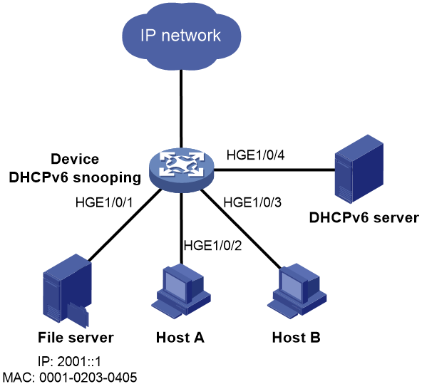

As shown in Figure 1, Host A, Host B, and the file server use static IPv4 addresses.
Enable static IPv4SG and configure static IPSG bindings on Device A and Device B to meet the following requirements:
·     The interface HundredGigE 1/0/1 of Device A allows IP packets from Host A to pass.
·     All interfaces of Device A allow IP packets from Host B to pass.
·     The interface HundredGigE 1/0/1 of Device B allows only IP packets from Host A and Host B to pass.
·     The interface HundredGigE 1/0/2 of Device B allows only IP packets from the file server to pass.
Figure 1 Network diagram
Analysis
To meet the network requirements, you must perform the following tasks:
·     To allow IP packets from Host A to pass through HundredGigE 1/0/1 on Device A, configure a static IPSG binding for Host A on the interface.
·     To allow IP packets from Host B to pass through all interfaces on Device A, configure a global static IPSG binding for Host B.
·     To allow IP packets from both hosts to pass through HundredGigE 1/0/1 on Device B, configure static IPSG bindings for the hosts on the interface.
·     To allow only IP packets from the file server to pass through HundredGigE 1/0/2 on Device B, configure a static IPSG binding for the file server on the interface.

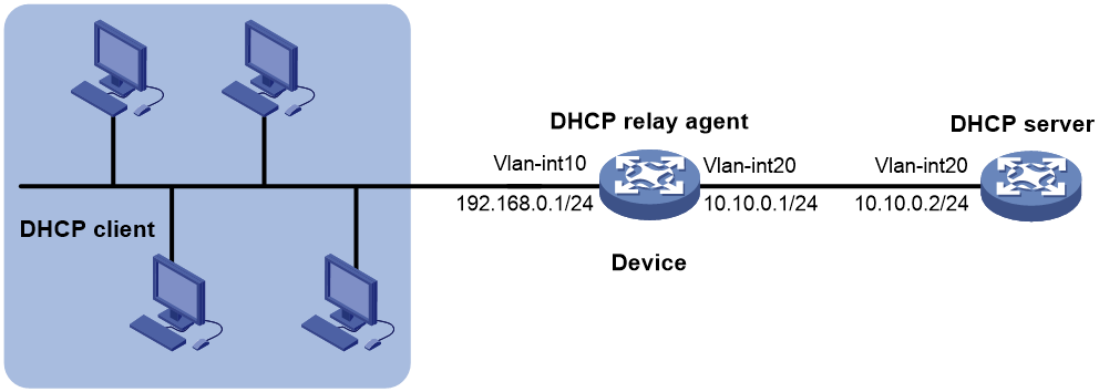

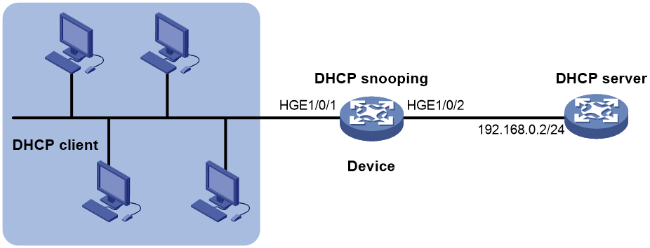

As shown in Figure 2, the DHCP clients obtain IP addresses from the DHCP server.
·     Enable DHCP snooping on the device to make sure the DHCP clients obtain IP addresses from the authorized DHCP server.
·     Enable dynamic IPv4SG on HundredGigE 1/0/1 to filter incoming packets by using the IPSG bindings that are generated based on DHCP snooping entries. Only packets from the DHCP clients are allowed to pass.
Figure 2 Network diagram
Analysis
·     To enable the DHCP clients to obtain IP addresses from the DHCP server, configure HundredGigE 1/0/2 as the DHCP trusted port. By default, all ports are untrusted ports after DHCP snooping is enabled.
·     To generate DHCP snooping entries for the DHCP clients, enable recording of client information in DHCP snooping entries on HundredGigE 1/0/1. By default, recording of DHCP snooping entries is disabled.

192.168.0.4     0001-0203-0404 HGE1/0/1                 1    DHCP snooping
192.168.0.5     0001-0203-0405 HGE1/0/1                 1    DHCP snooping
# Verify that the DHCP server can be pinged from the clients. (Details not shown.)
# Verify that the DHCP server cannot be pinged from the clients when the clients are assigned IP addresses manually. (Details not shown.)
Configuration files
vlan 1
dhcp snooping enable
interface HundredGigE1/0/1
 port link-mode bridge
 ip verify source ip-address mac-address
 dhcp snooping binding record
interface HundredGigE1/0/2
 dhcp snooping trust
Example: Configuring dynamic IPv4SG based on DHCP relay agent
As shown in Figure 3, DHCP relay is enabled on the device. The DHCP clients obtain IP addresses from the DHCP server through the DHCP relay agent.
Enable dynamic IPv4SG on VLAN-interface 10 to filter incoming packets by using the dynamic IPSG bindings generated based on the DHCP relay entries.
Figure 3 Network diagram
Analysis
To generate DHCP relay entries for the DHCP clients, enable recording of relay entries on the delay agent. By default, the DHCP relay agent does not record client information in relay entries.
Hardware
Software version
S6805 switch series
Release 6607, Release 6616, Release 6616P01, Release 6635 and later
S6825 switch series
S6850 switch series
S9850 switch series
Release 6555P01, Release 6607, Release 6616, Release 6616P01, Release 6635 and later
S9820-64H switch
S9820-8C switch
Procedures
Configuring the DHCP server
# Create VLAN-interface 20, and assign an IP address to VLAN-interface 20.
<DHCPserver> system-view
[DHCPserver] interface vlan-interface 20
[DHCPserver-Vlan-interface20] ip address 10.10.0.2 24
# Enable the DHCP server on VLAN-interface 20.
[DHCPserver-Vlan-interface20] dhcp select server
[DHCPserver-Vlan-interface20] quit
# Enable DHCP.
[DHCPserver] dhcp enable
# Create DHCP address pool 1.
[DHCPserver] dhcp server ip-pool 1
# Specify the assignable subnet as 192.168.0.0/24 and the address lease duration as 7 days.
[DHCPserver-dhcp-pool-1] network 192.168.0.0 24
[DHCPserver-dhcp-pool-1] expired day 7
[DHCPserver-dhcp-pool-1] quit
# Configure a static route for the subnet where VLAN-interface 10 of the DHCP relay agent resides on the DHCP server.
[DHCPserver] ip route-static 192.168.0.0 24 10.10.0.1
Configuring the device
# Create VLAN 10, and assign HundredGigE 1/0/1 to VLAN 10.
<Device> system-view
[Device] vlan 10
[Device-vlan10] port hundredgige 1/0/1
[Device-vlan10] quit
# Assign an IP address to VLAN-interface 10.
[Device] interface vlan-interface 10
[Device-Vlan-interface10] ip address 192.168.0.1 255.255.255.0
[Device-Vlan-interface10] quit
# Create VLAN 20, and assign HundredGigE 1/0/2 to VLAN 20.
[Device] vlan 20
[Device-vlan20] port hundredgige 1/0/2
[Device-vlan20] quit
# Assign an IP address to VLAN-interface 20.
[Device] interface vlan-interface 20
[Device-Vlan-interface20] ip address 10.10.0.1 255.255.255.0
[Device-Vlan-interface20] quit
# Enable DHCP.
[Device] dhcp enable
# Enable recording of relay entries on the delay agent.
[Device] dhcp relay client-information record
# Enable the DHCP relay agent on VLAN-interface 10.
[Device-Vlan-interface10] dhcp select relay
# Specify the IP address of the DHCP server on the relay agent.
[Device-Vlan-interface10] dhcp relay server-address 10.10.0.2
# Enable IPv4SG on VLAN-interface 10 and verify the source IP address and MAC address for dynamic IPSG.
[Device-Vlan-interface10] ip verify source ip-address mac-address
Configuring the DHCP clients
# Configure the DHCP clients to use DHCP for IP address acquisition. (Details not shown.)
# Verify that the device has generated dynamic IPSG bindings for the clients based on DHCP relay entries.
<Device> display ip source binding dhcp-relay
Total entries found: 4
IP Address      MAC Address    Interface                VLAN Type
192.168.0.2     0001-0203-0402 Vlan10                   10   DHCP relay
192.168.0.3     0001-0203-0403 Vlan10                   10   DHCP relay
192.168.0.4     0001-0203-0404 Vlan10                   10   DHCP relay
192.168.0.5     0001-0203-0405 Vlan10                   10   DHCP relay
Configuration files
 dhcp enable
vlan 10
vlan 20
interface Vlan-interface10
 dhcp select relay
interface Vlan-interface20
 port access vlan 10
 port access vlan 20

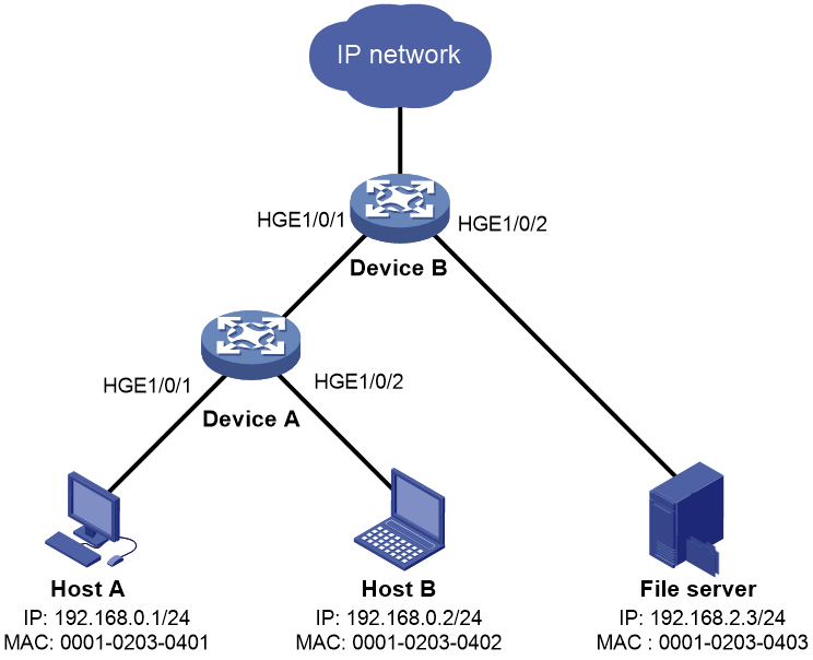

Example: Configuring static IPv6SG and dynamic IPv6SG
As shown in Figure 4, the file server uses static IPv6 address 2001::1. Host A and Host B obtain IP addresses from the DHCPv6 server.
Configure IPv6SG on the device to meet the following requirements:
·     The interface HundredGigE 1/0/1 allows only packets from the file server to pass.
·     The interface HundredGigE 1/0/2 allows only packets from Host A to pass.
·     The interface HundredGigE 1/0/3 allows only packets from Host B to pass.
Figure 4  Network diagram
Analysis
·     To enable Host A and Host B to obtain IP addresses from the DHCPv6 server, configure HundredGigE 1/0/4 as the DHCP trusted port. By default, all ports are untrusted ports after DHCPv6 snooping is enabled.
·     To allow only incoming packets from the file server on HundredGigE 1/0/1, configure a static IPSG binding for the file server.
·     To allow only packets from Host A to pass through HundredGigE 1/0/2 and only packets from Host B to pass through HundredGigE 1/0/3, perform the following tasks:
¡     Enable IPv6SG on HundredGigE 1/0/2 and HundredGigE 1/0/3.
¡     To generate DHCPv6 snooping entries for Host A and Host B, enable recording of client information in DHCPv6 snooping entries on HundredGigE 1/0/2 and HundredGigE 1/0/3. By default, recording of DHCP snooping entries is disabled.
Hardware
Software version
S6805 switch series
S6825 switch series
S6850 switch series
S9850 switch series
S9820-64H switch
S9820-8C switch
IPv6SG does not use the VLAN information (if specified) in static IPSG bindings to filter packets.
Procedures
# Configure the DHCPv6 server and the DHCPv6 clients (Host A and Host B). (Details not shown.)
# Enable IPv6SG on HundredGigE 1/0/1.
[Device] interface hundredgige 1/0/1
[Device-HundredGigE1/0/1] ipv6 verify source ip-address mac-address
# Configure a static IPSG binding for the file server on HundredGigE 1/0/1.
[Device-HundredGigE1/0/1] ipv6 source binding ip-address 2001::1 mac-address 0001-0203-0405
[Device-HundredGigE1/0/1] quit
# Enable DHCPv6 snooping.
[Device] ipv6 dhcp snooping enable
# Configure HundredGigE 1/0/4 as a trusted port.
[Device] interface hundredgige 1/0/4
[Device-HundredGigE1/0/4] ipv6 dhcp snooping trust
[Device-HundredGigE1/0/4] quit
# Enable IPv6SG on HundredGigE 1/0/2 and verify the source IPv6 address and MAC address for dynamic IPv6SG.
[Device] interface hundredgige 1/0/2
[Device-HundredGigE1/0/2] ipv6 verify source ip-address mac-address
# Enable recording of client information in DHCPv6 snooping entries on HundredGigE 1/0/2.
[Device-HundredGigE1/0/2] ipv6 dhcp snooping binding record
[Device-HundredGigE1/0/2] quit
# Enable IPv6SG on HundredGigE 1/0/3 and verify the source IPv6 address and MAC address for dynamic IPv6SG.
[Device] interface hundredgige 1/0/3
[Device-HundredGigE1/0/3] ipv6 verify source ip-address mac-address
# Enable recording of client information in DHCPv6 snooping entries on HundredGigE 1/0/3.
[Device-HundredGigE1/0/3] ipv6 dhcp snooping binding record
[Device-HundredGigE1/0/3] quit
# Verify that the file server can ping the DHCPv6 server. (Details not shown.)
# Verify that the device has a static IPSG binding for the file server.
[Device] display ipv6 source binding static
Total entries found: 1
IPv6 Address         MAC Address    Interface               VLAN Type
2001::1              0001-0203-0405 HGE1/0/1                N/A  Static
# Verify that the device has generated dynamic IPSG bindings for Host A and Host B based on DHCP snooping entries.
[Device] display ipv6 source binding dhcpv6-snooping
Total entries found: 2
2001::2              0001-0203-0406 HGE1/0/2                1    DHCPv6 snooping
2001::3              0001-0203-0407 HGE1/0/3                1    DHCPv6 snooping
# Verify that Host A and Host B can ping the DHCPv6 server. (Details not shown.)
# Verify that Host A and Host B cannot ping the DHCPv6 server when they are assigned IPv6 addresses manually. (Details not shown.)
Configuration files
interface HundredGigE1/0/3
interface HundredGigE1/0/4
