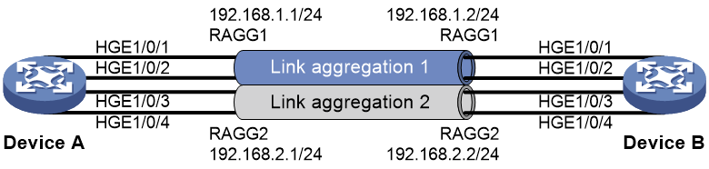

As shown in Figure 1, both Device A and Device B forward traffic from VLAN 10 and VLAN 20.
Configure link aggregation on Device A and Device B to meet the following requirements:
·     VLAN 10 on Device A can communicate with VLAN 10 on Device B.
·     VLAN 20 on Device A can communicate with VLAN 20 on Device B.

Analysis
To enable traffic from VLAN 10 and VLAN 20 to pass through Layer 2 aggregate interface Bridge-aggregation 1, perform the following tasks:
·     Configure Layer 2 aggregate interface Bridge-aggregation 1 as a trunk port.
·     Assign the aggregate interface to VLAN 10 and VLAN 20.

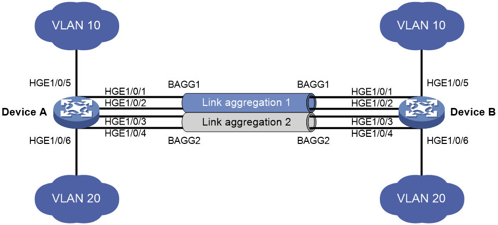

As shown in Figure 2, both Device A and Device B forward traffic from VLAN 10 and VLAN 20.
·     VLAN 10 on Device A can communicate with VLAN 10 on Device B. VLAN 20 on Device A can communicate with VLAN 20 on Device B.
·     The packets from VLAN 10 are load shared across the Selected ports of link aggregation group 1 by source MAC addresses. The packets from VLAN 20 are load shared across the Selected ports of link aggregation group 2 by destination MAC addresses.
Figure 2 Network diagram
Analysis
To meet the network requirements, you must perform the following tasks:
·     To configure different load sharing modes for packets in different link aggregation groups, configure link aggregation load sharing modes in Layer 2 aggregate interface view.
·     To enable packets from VLAN 10 to pass through aggregate interface Bridge-aggregation 1, assign the aggregate interface to VLAN 10. To enable packets from VLAN 20 to pass through aggregate interface Bridge-aggregation 2, assign the aggregate interface to VLAN 20.

[DeviceA] interface bridge-aggregation 2
# Configure Layer 2 aggregation group 2 to load share packets based on destination MAC addresses.
[DeviceA-Bridge-Aggregation2] link-aggregation load-sharing mode destination-mac
[DeviceA-Bridge-Aggregation2] quit
# Assign ports HundredGigE 1/0/3 and HundredGigE 1/0/4 to aggregation group 2.
[DeviceA] interface hundredgige 1/0/3
[DeviceA-HundredGigE1/0/3] port link-aggregation group 2
[DeviceA-HundredGigE1/0/3] quit
[DeviceA] interface hundredgige 1/0/4
[DeviceA-HundredGigE1/0/4] port link-aggregation group 2
[DeviceA-HundredGigE1/0/4] quit
# Assign Layer 2 aggregate interface Bridge-aggregation 2 to VLAN 20.
[DeviceA-Bridge-Aggregation2] port access vlan 20
Configuring HundredGigE1/0/3 done.
Configuring HundredGigE1/0/4 done.
2.     Configure Device B in the same way Device A is configured. (Details not shown.)
# Display the information about Selected ports in link aggregation groups on Device A.
[DeviceA] display link-aggregation verbose
Loadsharing Type: Shar -- Loadsharing, NonS -- Non-Loadsharing
Port Status: S -- Selected, U -- Unselected , I -- Individual
Port: A -- Auto port, M -- Management port, R -- Reference port
Flags:  A -- LACP_Activity, B -- LACP_Timeout, C -- Aggregation,
        G -- Defaulted, H -- Expired
Aggregation Interface: Bridge-Aggregation1
Aggregation Mode: Static
Management VLANs: None
  Port             Status  Priority  Oper-Key
  HGE1/0/1(R)      S       32768     1
  HGE1/0/2         S       32768     1
Aggregation Interface: Bridge-Aggregation2
  HGE1/0/3(R)      S       32768     2
  HGE1/0/4         S       32768     2
The output shows the following information:
·     Link aggregation groups 1 and 2 are both Layer 2 static aggregation groups.
·     Each aggregation group has two Selected ports for forwarding traffic.
# Display the link aggregation load sharing mode of Bridge-aggregation 1.
[DeviceA]display link-aggregation load-sharing mode interface Bridge-Aggregation 1
The dynamic load sharing mode takes effect if it exists.
Bridge-Aggregation1 load-sharing mode:
Dynamic:
  N/A
Static:
  source-mac address
The output shows that link aggregation group 1 load shares packets based on source MAC addresses.
# Display the link aggregation load sharing mode of Bridge-aggregation 2.
[DeviceA]display link-aggregation load-sharing mode interface Bridge-Aggregation 2
Bridge-Aggregation2 load-sharing mode:
Dynamic:
  N/A
Static:
  destination-mac address
The output shows that link aggregation group 2 load shares packets based on destination MAC addresses.

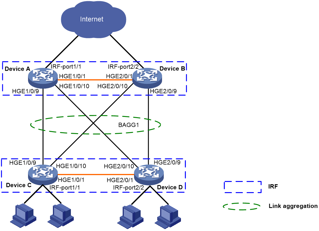

Example: Configuring Layer 2 link aggregation in an IRF fabric
On the network as shown in Figure 3, perform the following tasks:
·     Set up a two-chassis IRF fabric at the access layer and a two-chassis IRF fabric at the distribution layer of the enterprise network.
·     Configure link aggregation to improve the reliability of the links between the access-layer and distribution-layer IRF fabrics and implement load sharing.
·     Run LACP MAD on the two IRF fabrics to detect IRF split.
Figure 3 Network diagram

3.     Configure a Layer 2 aggregation group on Device A:
# Create Layer 2 aggregate interface Bridge-Aggregation 1, and configure the link aggregation mode as dynamic.
[DeviceA] interface bridge-aggregation 1
[DeviceA-Bridge-Aggregation1] link-aggregation mode dynamic
# Configure Layer 2 aggregation group 1 to load share packets based on source IP addresses.
[DeviceA-Bridge-Aggregation1] link-aggregation load-sharing mode source-ip
[DeviceA-Bridge-Aggregation1] quit
# Assign ports HundredGigE 1/0/9, HundredGigE1/0/10, HundredGigE 2/0/9, and HundredGigE 2/0/10 to link aggregation group 1.
[DeviceA] interface range hundredgige 1/0/9 to hundredgige 1/0/10
hundredgige 2/0/9 to hundredgige 2/0/10
[DeviceA-if-range] port link-aggregation group 1
[DeviceA-if-range] quit
[DeviceA]
Configure LACP MAD on the IRF fabric:
# Set the domain ID of the IRF fabric to 1.
[DeviceA] irf domain 1
# Enable LACP MAD on Bridge-Aggregation 1.
[DeviceA] interface Bridge-Aggregation 1
[DeviceA-Bridge-Aggregation1] mad enable
You need to assign a domain ID (range: 0-4294967295)
[Current domain is: 1]:
The assigned domain ID is: 1
MAD LACP only enable on dynamic aggregation interface.
4.     Configure IRF on Device C in the same way IRF is configured on Device A. (Details not shown.)
5.     Configure IRF on Device D in the same way IRF is configured on Device B. (Details not shown.)
Device C and Device D perform master election, and the one that has lost the election reboots to form an IRF fabric with the master. In this example, Device C reboots.
6.     Configure a Layer 2 dynamic aggregation group Bridge-Aggregation 1 on Device C in the same way Bridge-Aggregation 1 is configured on Device A. (Details not shown.)
7.     Configure LACP MAD on the IRF fabric:
# Set the domain ID of the IRF fabric to 2.
<DeviceC> system-view
[DeviceC] irf domain 2
[DeviceC] interface Bridge-Aggregation 1
[DeviceC-Bridge-Aggregation1] mad enable
[Current domain is: 2]:
The assigned domain ID is: 2
# Display the information about the link aggregation groups on Device A.
Port Status: S -- Selected, U -- Unselected, I -- Individual
Aggregate Interface: Bridge-Aggregation1
Creation Mode: Manual
Aggregation Mode: Dynamic
System ID: 0x8000, 00a0-fc00-5800
Local:
  Port                Status   Priority Index    Oper-Key               Flag
  HGE1/0/9(R)         S        32768    10       1                      {ACG}
  HGE1/0/10           S        32768    11       1                      {ACG}
  HGE2/0/9            S        32768    138      1                      {ACG}
  HGE2/0/10           S        32768    139      1                      {ACG}
Remote:
  Actor               Priority Index    Oper-Key SystemID               Flag
  HGE1/0/9            32768    0        0        0x8000, 0000-0000-0000 {EF}
  HGE1/0/10           32768    0        0        0x8000, 0000-0000-0000 {EF}
  HGE2/0/9            32768    0        0        0x8000, 0000-0000-0000 {EF}
  HGE2/0/10           32768    0        0        0x8000, 0000-0000-0000 {EF}
The output shows that the local member ports and the corresponding peer member ports are all Selected. In the dynamic link aggregation mode, each local member port and its peer member port have the same Selected state through exchanging LACPDUs. The user data traffic can be forwarded correctly.
# Display the load sharing mode of Layer 2 aggregation group 1 on Device A.
[DeviceA] display link-aggregation load-sharing mode interface Bridge-Aggregation 1
Dynamic:
  N/A
Static:
source-ip address
The output shows that Layer 2 aggregation group 1 load shares packets based on source IP addresses.
# Shut down physical IRF port HundredGigE 2/0/1 on Device B.
A log message appears on Device A.
[DeviceA]%Jul  9 6:52:41:734 2019 DeviceA STM/3/STM_LINK_DOWN: IRF port 1 went down.
%Jul  9 6:52:41:800 2019 DeviceA IFNET/3/PHY_UPDOWN: Physical state on the interface HundredGigE1/0/1 changed to down.
%Jul  9 6:52:41:854 2019 DeviceA IFNET/5/LINK_UPDOWN: Line protocol state on the interface HundredGigE1/0/1 changed to down.
%Jul  9 6:52:41:867 2019 DeviceA DEV/3/BOARD_REMOVED: Board was removed from slot 2, type is Comware.
The output shows that IRF split occurs on the distribution layer because HundredGigE 2/0/1 that is bound to IRF port 2/2 is physically down.

Example: Configuring Layer 3 link aggregation load sharing
On the network as shown in Figure 5, perform the following tasks:
·     Configure Layer 3 static aggregation groups 1 and 2 on Device A and Device B.
·     Configure IP addresses and subnet masks for the corresponding Layer 3 aggregate interfaces.
·     Configure link aggregation group 1 to load share packets based on source IP addresses.
·     Configure link aggregation group 2 to load share packets based on destination IP addresses.

# Display detailed information about all aggregation groups on Device A.
Aggregate Interface: Route-Aggregation1
  HGE1/0/2         S       32768    1
Aggregate Interface: Route-Aggregation2
  HGE1/0/4         S       32768    2
The output shows that:
·     Link aggregation groups 1 and 2 are both load-shared Layer 3 static aggregation groups.
·     Each aggregation group contains two Selected ports.
# Display the group-specific load sharing modes of all aggregation groups on Device A.
Route-Aggregation1 load-sharing mode:
Dynamic:
  N/A
Static:
  source-ip address
Route-Aggregation2 load-sharing mode:
Dynamic:
  N/A
Static:
  destination-ip address
·     Link aggregation group 1 load shares packets based on source IP addresses.
·     Link aggregation group 2 load shares packets based on destination IP addresses.
