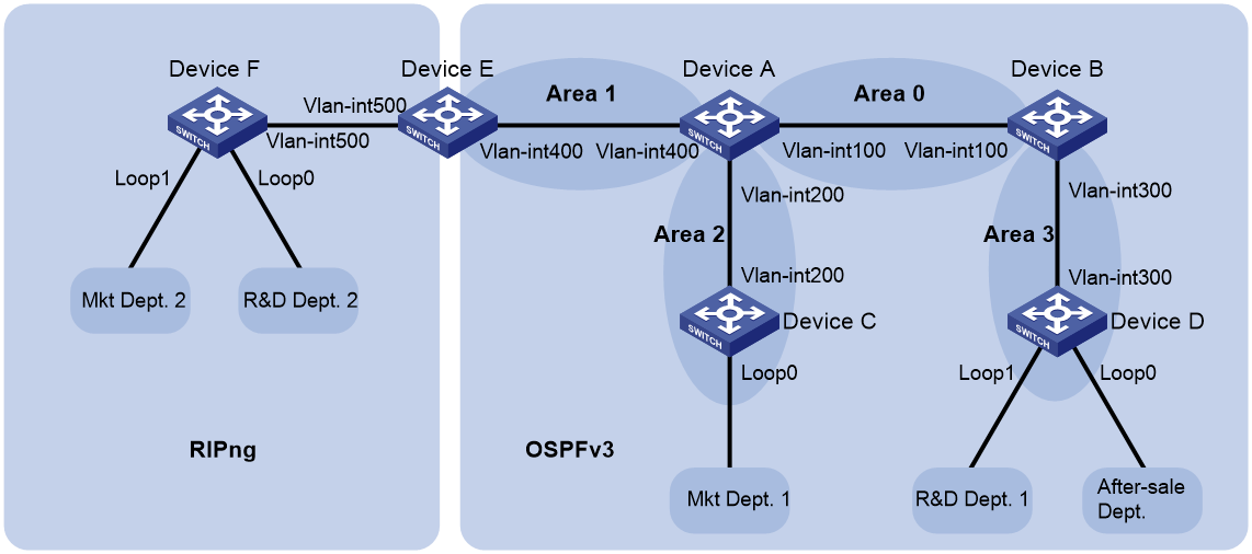

As shown in Figure 1, the devices of an enterprise reside in OSPFv3 and RIPng domains.
Configure route redistribution between OSPFv3 and RIPng to interconnect the devices.
Configure route filtering on Device E, Device C, and Device D to meet the following requirements:
·     The route destined for R&D department 2 is not redistributed to OSPFv3.
·     Marketing department 1 cannot reach R&D department 1.
·     R&D department 1 and the After-sale service department cannot reach Marketing department 2.
Figure 1 Network diagram

Configuring IPv6 addresses
# Configure an IPv6 address for VLAN-interface 100.
<DeviceA> system-view
[DeviceA] interface vlan-interface 100
[DeviceA-Vlan-interface100] ipv6 address 1::1 64
# Configure IPv6 addresses for other interfaces in the same way VLAN-interface 100 is configured. (Details not shown.)

# On Device E, configure IPv6 basic ACL 2000 to permit any subnet except 14::1/64.
<DeviceE> system-view
[DeviceE] acl ipv6 basic 2000
[DeviceE-acl-ipv6-basic-2000] rule 0 deny source 14::1 64
[DeviceE-acl-ipv6-basic-2000] rule permit source any
[DeviceE-acl-ipv6-basic-2000] quit
# On Device E, use ACL 2000 to filter routes redistributed from RIPng.
[DeviceE] ospfv3
[DeviceE-ospfv3-1] filter-policy 2000 export ripng 1
[DeviceE-ospfv3-1] quit

The output on Device C and Device D shows that Device E has filtered out the route destined for R&D development 2.

·     Device A:
ospfv3 1
 router-id 6.6.6.6
 area 0.0.0.0
 area 0.0.0.1
 area 0.0.0.2
vlan 100
vlan 200
vlan 400
interface Vlan-interface100
 ospfv3 1 area 0.0.0.0
 ipv6 address 1::1/64
interface Vlan-interface200
 ospfv3 1 area 0.0.0.2
 ipv6 address 2::1/64
interface Vlan-interface400
 ospfv3 1 area 0.0.0.1
 ipv6 address 4::1/64
·     Device B:
ospfv3 1
 router-id 5.5.5.5
 area 0.0.0.0
 area 0.0.0.3
vlan 100
vlan 300
 ipv6 address 1::2/64
interface Vlan-interface300
 ospfv3 1 area 0.0.0.3
 ipv6 address 3::1/64
·     Device C:
ospfv3 1
 router-id 4.4.4.4
 filter-policy 2000 import
 area 0.0.0.2
vlan 200
interface LoopBack0
 ipv6 address 13::1/64
 ipv6 address 2::2/64
acl ipv6 basic 2000
 rule 0 deny source 12::/64
 rule 5 permit
·     Device D:
ospfv3 1
 router-id 3.3.3.3
 area 0.0.0.3
vlan 300
interface LoopBack0
 ipv6 address 11::1/64
interface LoopBack1
 ipv6 address 12::1/64
 ipv6 address 3::2/64
acl ipv6 basic 2000
 rule 0 deny source 15::/64
 rule 5 permit
·     Device E:
ospfv3 1
 router-id 2.2.2.2
 import-route direct
import-route ripng 1
 area 0.0.0.1
ripng 1
 import-route direct
 import-route ospfv3 1
vlan 400
vlan 500
 ipv6 address 4::2/64
interface Vlan-interface500
 ipv6 address 5::1/64
 ripng 1 enable
acl ipv6 basic 2000
 rule 0 deny source 14::/64
 rule 5 permit
·     Device F:
ripng 1
vlan 500
interface LoopBack0
 ipv6 address 14::1/64
 ripng 1 enable
interface LoopBack1
 ipv6 address 15::1/64
 ripng 1 enable
 ipv6 address 5::2/64
 ripng 1 enable
