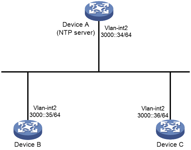

As shown in Figure 1, configure NTP client/server mode so that all devices can be synchronized to Device A, the NTP server.

Configuring Device A
# Assign an IP address to VLAN-interface 2.
<DeviceA> system-view
[DeviceA] interface Vlan-interface 2
[DeviceA-Vlan-interface2] ip address 1.0.1.11 24
[DeviceA-Vlan-interface2] quit
# Enable the NTP service.
[DeviceA] ntp-service enable
# Specify the local clock as the reference source, with the stratum level 2.
[DeviceA] ntp-service refclock-master 2
Configuring Device B
# Assign an IP address to VLAN-interface 2. (Details not shown.)
<DeviceB> system-view
[DeviceB] ntp-service enable
# Specify Device A as the NTP server of Device B so that Device B is synchronized to Device A.
[DeviceB] ntp-service unicast-server 1.0.1.11
Configuring Device C
<DeviceC> system-view
[DeviceC] ntp-service enable
# Specify Device A as the NTP server of Device C so that Device C is synchronized to Device A.
[DeviceC] ntp-service unicast-server 1.0.1.11
# Verify that Device B has synchronized to Device A, and the clock stratum level is 3 on Device B and 2 on Device A.
[DeviceB] display ntp-service status
 Clock status: synchronized
 Clock stratum: 3
 System peer: 1.0.1.11
 Local mode: client
 Reference clock ID: 1.0.1.11
 Leap indicator: 00
 Clock jitter: 0.003479 s
 Stability: 0.000 pps
 Clock precision: 2^-21
 Root delay: 1.95313 ms
 Root dispersion: 28.38135 ms
 Reference time: d5ed8cd5.577006ea  Wed, Sep 5 2019 16:24:53.341
# Verify that an IPv4 NTP association has been established between Device B and Device A.
[DeviceB] display ntp-service sessions
        source          reference       stra reach poll  now offset  delay disper
[12345]1.0.1.11        127.127.1.0        2   255   64   38 -10.22 1.9531 3.3416
Notes: 1 source(master), 2 source(peer), 3 selected, 4 candidate, 5 configured.
 Total sessions: 1
Configuration files
·     Device A:
interface Vlan-interface2
 ip address 1.0.1.11 255.255.255.0
 ntp-service enable
·     Device B:
 ip address 1.0.1.12 255.255.255.0
 ntp-service enable
·     Device C:
 ip address 1.0.1.13 255.255.255.0
 ntp-service enable

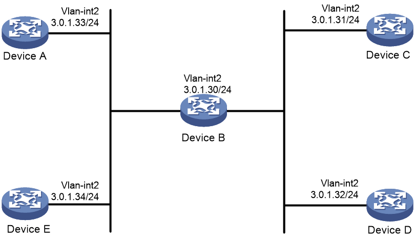

As shown in Figure 2, the devices are on the same network segment. Configure NTP broadcast mode so that all the devices can be synchronized to Device C, the NTP server.
[DeviceC] ntp-service refclock-master 2
[DeviceC] interface Vlan-interface 2
[DeviceC-Vlan-interface2] ip address 3.0.1.31 24
# Configure Device C to operate in broadcast server mode and send broadcast messages from VLAN-interface 2.
[DeviceC-Vlan-interface2] ntp-service broadcast-server
Configuring Device A, Device B, Device D, and Device E
# Configure Device A to operate in broadcast client mode and receive broadcast messages on VLAN-interface 2.
[DeviceA-Vlan-interface2] ntp-service broadcast-client
# Configure Device B, Device D, and Device E in the same way Device A is configured. (Details not shown.)
# Verify that Device A has synchronized to Device C, and the clock stratum level is 3 on Device A and 2 on Device C.
[DeviceA-Vlan-interface2] display ntp-service status
 Clock stratum: 3
 System peer: 3.0.1.31
 Local mode: bclient
 Reference clock ID: 3.0.1.31
 Leap indicator: 00
 Clock jitter: 0.000061 s
 Root delay: 0.00000 ms
 Root dispersion: 7951.43127 ms
 Reference time: d5ee8d88.2faabed0  Thu, Sep 6 2019 10:40:08.186
# Verify that an IPv4 NTP association has been established between Device A and Device C.
[DeviceA-Vlan-interface2] display ntp-service sessions
 [1234]3.0.1.31        127.127.1.0        2   254   64   82 -2.190 0.0000 7937.5
 Total sessions: 1
Configuration files
·     Device C:
 ip address 3.0.1.31 255.255.255.0
 ntp-service enable
·     Device A:
 ip address 3.0.1.33 255.255.255.0
 ntp-service enable
·     Device B:
 ip address 3.0.1.30 255.255.255.0
 ntp-service enable
·     Device D:
 ip address 3.0.1.32 255.255.255.0
 ntp-service enable
·     Device E:
 ip address 3.0.1.34 255.255.255.0
 ntp-service enable

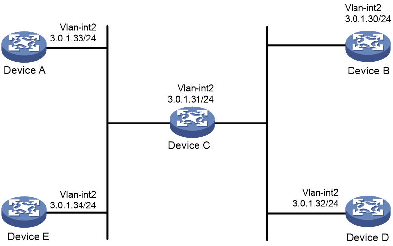

As shown in Figure 3, the devices are on different network segments. Configure NTP multicast mode so that all the devices can be synchronized to Device C, the NTP server.
# Configure Device C to operate in multicast server mode and send multicast messages from VLAN-interface 2.
[DeviceC-Vlan-interface2] ntp-service multicast-server
Configuring Device D
<DeviceD> system-view
[DeviceD] ntp-service enable
[DeviceD] interface Vlan-interface 2
[DeviceD-Vlan-interface2] ip address 3.0.1.32 24
# Configure Device D to operate in multicast client mode and receive multicast messages on VLAN-interface 2.
[DeviceD-Vlan-interface2] ntp-service multicast-client
# Configure Device B to operate in multicast client mode and receive multicast messages on VLAN-interface 2.
[DeviceB-Vlan-interface2] ntp-service multicast-client
[DeviceB-Vlan-interface2] quit
Because Device A and Device C are on different subnets, you must enable the multicast functions on Device B before Device A can receive multicast messages from Device C.
# Enable IP multicast routing and IGMP.
[DeviceB] multicast routing
[DeviceB] interface vlan-interface 2
[DeviceB-Vlan-interface2] pim dm
[DeviceB] vlan 3
[DeviceB-vlan3] port HundredGigE 1/0/1
[DeviceB-vlan3] quit
[DeviceB] interface vlan-interface 3
[DeviceB-Vlan-interface3] ip address 1.0.1.10 24
[DeviceB-Vlan-interface3] igmp enable
[DeviceB-Vlan-interface3] igmp static-group 224.0.1.1
[DeviceB-Vlan-interface3] quit
[DeviceB] igmp-snooping
[DeviceB-igmp-snooping] quit
[DeviceB] interface HundredGigE 1/0/1
[DeviceB-HundredGigE 1/0/1] igmp-snooping static-group 224.0.1.1 vlan 3
# Assign an IP address to VLAN-interface 3.
[DeviceA] interface Vlan-interface 3
[DeviceA-Vlan-interface3] ip address 1.0.1.11 24
# Configure Device A to operate in multicast client mode and receive multicast messages on VLAN-interface 3.
[DeviceA-Vlan-interface3] ntp-service multicast-client
[DeviceA-Vlan-interface3] display ntp-service status
 Clock stratum: 3
 Local mode: bclient
 Leap indicator: 00
 Root delay: 1.69373 ms
 Root dispersion: 1950.18005 ms
 Reference time: d5ee9b15.2f3a684d  Thu, Sep 6 2019 11:37:57.184

Example: Configuring NTP authentication in client/server mode
As shown in Figure 4, configure NTP authentication in client/server mode so that all devices can be synchronized to Device A, the NTP server.
Figure 4 Network diagram
# Enable NTP authentication on Device A.
[DeviceA] ntp-service authentication enable
# Set an authentication key, and input the key in plain text.
[DeviceA] ntp-service authentication-keyid 42 authentication-mode md5 simple aNiceKey
# Specify the key as a trusted key.
[DeviceA] ntp-service reliable authentication-keyid 42
# Enable NTP authentication on Device B.
[DeviceB] ntp-service authentication enable
[DeviceB] ntp-service authentication-keyid 42 authentication-mode md5 simple aNiceKey
[DeviceB] ntp-service reliable authentication-keyid 42
# Specify Device A as the NTP server of Device B, and associate the server with key 42.
[DeviceB] ntp-service unicast-server 1.0.1.11 authentication-keyid 42
# Enable NTP authentication on Device C.
[DeviceC] ntp-service authentication enable
[DeviceC] ntp-service authentication-keyid 42 authentication-mode md5 simple aNiceKey
[DeviceC] ntp-service reliable authentication-keyid 42
# Specify Device A as the NTP server of Device C, and associate the server with key 42.
[DeviceC] ntp-service unicast-server 1.0.1.11 authentication-keyid 42
 Clock stratum: 3
 Local mode: client
 Leap indicator: 00
 Clock jitter: 0.005096 s
 Root delay: 0.00655 ms
 Root dispersion: 1.15869 ms
 Reference time: d0c62687.ab1bba7d  Mon, Sep 6 2019 16:06:26.764
 [1245]1.0.1.11        127.127.1.0        2     1   64  519   -0.0 0.0065    0.0
Notes: 1 source(master),2 source(peer),3 selected,4 candidate,5 configured.
 Total sessions : 1
Configuration files

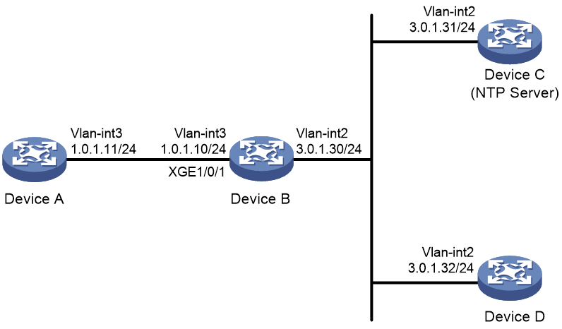

Example: Configuring IPv6 NTP client/server mode
As shown in Figure 1, configure IPv6 NTP client/server mode so that all devices can synchronize to Device A, the NTP server.
Figure 6 Network diagram
# Assign an IPv6 address to VLAN-interface 2.
[DeviceA] interface vlan-interface 2
[DeviceA-Vlan-interface2] ipv6 address 3000::34 64
# Assign an IPv6 address to each interface. (Details not shown.)
[DeviceB] ntp-service unicast-server 3000::34
[DeviceC] ntp-service unicast-server 3000::34
 Clock stratum: 3
 System peer: 3000::34
 Local mode: client
 Reference clock ID: 95.197.17.40
 Leap indicator: 00
# Verify that an IPv6 NTP association has been established between Device B and Device A.
[DeviceB] display ntp-service ipv6 sessions
 Source: [12345] 3000::34
 Reference: 127.127.1.0           Clock stratum: 2
 Reachabilities: 3                Poll interval: 64
 Last receive time: 62            Offset: 0.1272
 Roundtrip delay: 1.8158          Dispersion: 188.47
 Total sessions: 1
# Configure routing protocols so that all devices can reach each other. (Details not shown.)
[DeviceC-Vlan-interface2] ipv6 address 3000::2 64
# Configure Device C to operate in IPv6 multicast server mode and send multicast messages from VLAN-interface 2.
[DeviceC-Vlan-interface2] ntp-service ipv6 multicast-server ff24::1
[DeviceC-Vlan-interface2] quit
# Configure routing protocols and assign an IP address to each interface so that all devices can reach each other. (Details not shown.)
# Configure Device D to operate in IPv6 multicast client mode and receive multicast messages on VLAN-interface 2.
[DeviceD-Vlan-interface2] ntp-service ipv6 multicast-client ff24::1
[DeviceD-Vlan-interface2] quit
# Configure Device B to operate in IPv6 multicast client mode and receive multicast messages on VLAN-interface 2.
[DeviceB-Vlan-interface2] ntp-service ipv6 multicast-client ff24::1
Because Device A and Device C are on different subnets, you must enable IPv6 multicast functions on Device B before Device A can receive multicast messages from Device C.
# Enable IPv6 multicast functions.
[DeviceB] ipv6 multicast routing
[DeviceB-mrib6] quit
[DeviceB-Vlan-interface2] ipv6 pim dm
[DeviceB] vlan 3
[DeviceB-Vlan-interface3] mld enable
[DeviceB-Vlan-interface3] mld static-group ff24::1
[DeviceB] mld-snooping
[DeviceB-mld-snooping] quit
[DeviceB-HundredGigE 1/0/1] mld-snooping static-group ff24::1 vlan 3
# Configure Device A to operate in IPv6 multicast client mode and receive multicast messages on VLAN-interface 3.
[DeviceA-Vlan-interface3] ntp-service ipv6 multicast-client ff24::1
[DeviceA-Vlan-interface3] quit
[DeviceA] display ntp-service status
 Clock stratum: 3
 System peer: 3000::2
 Local mode: bclient
 Reference clock ID: 165.84.121.65
 Leap indicator: 00
Configuration files

Example: Configuring NTP authentication in broadcast mode
As shown in Figure 4, all devices are on the same network segment. Configure NTP authentication in broadcast mode so that all devices can synchronize to Device A, the NTP server.
Figure 8 Network diagram

Procedures
Configure Device C
# Specify the local clock as the reference source, with the stratum level 2 on Device C.
# Enable NTP authentication on Device C. Configure an NTP authentication key, with the key ID of 88 and key value of 123456. Input the key in plain text, and specify it as a trusted key.
[DeviceC] ntp-service authentication-keyid 88 authentication-mode md5 simple 123456
[DeviceC] ntp-service reliable authentication-keyid 88
# Specify Device C as an NTP broadcast server, and associate key 88 with Device C.
[DeviceC] interface vlan-interface 2
[DeviceC-Vlan-interface2] ntp-service broadcast-server authentication-keyid 88
Configure Device A
# Enable NTP authentication on Device A. Configure an NTP authentication key, with the key ID of 88 and key value of 123456. Input the key in plain text, and specify it as a trusted key.
[DeviceA] ntp-service authentication-keyid 88 authentication-mode md5 simple 123456
[DeviceA] ntp-service reliable authentication-keyid 88
# Configure Device A to operate in NTP broadcast client mode and receive NTP broadcast messages on VLAN-interface 2.
[DeviceA-Vlan-interface2] ip address 3.0.1.33 24
 Clock stratum: 3
 Local mode: bclient
 Leap indicator: 00
 Clock jitter: 0.000092 s
 Root delay: 2.42615 ms
 Root dispersion: 1950.98877 ms
 Reference time: d5eed631.2f498d71  Thu, Sep 6 2019 15:50:09.184
Configuration files
·     Device A, Device B, Device D, and Device E:
 ntp-service enable
 ntp-service authentication-keyid 88 authentication-mode md5 cipher $c$3$pU6KvpS80MadhM2zM
CCSR07HX4qEbJhHvQ==
·     Device C:
 ntp-service enable
 ntp-service authentication-keyid 88 authentication-mode md5 cipher $c$3$iJudDKiqCVO+gOaG53
63/fz4M3dQvHo2Fw==
 ntp-service refclock-master 3
