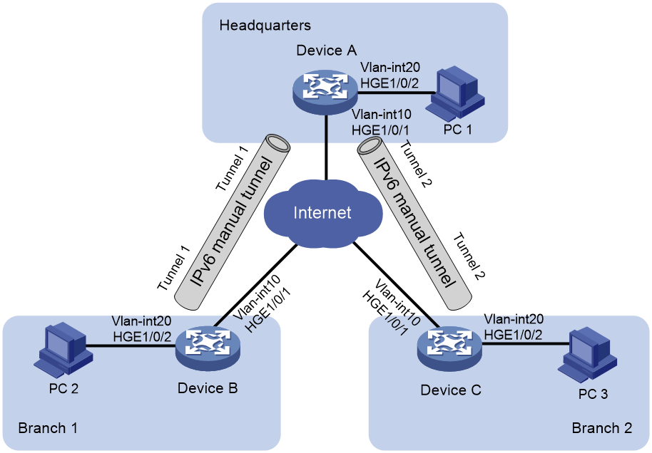

As shown in Figure 1, in IPv6 networks, Device A, Device B, and Device C act as the gateways of the headquarters, Branch 1, and Branch 2, respectively.
Configure IPv6 over IPv4 manual tunnels to ensure that the headquarters can communicate with the two branches over IPv4 networks.
Configure OSPFv3 on the gateways to ensure the following:
·     The gateways have routes to destination IPv6 addresses through tunnel interfaces.
·     Branch 1 and Branch 2 can communicate with each other through the headquarters.
Figure 1 Network diagram
Device
Interface
IP address
Device A
Vlan-int10
20.1.1.1/24
Vlan-int20
2001::1/64
Tunnel1
3001::1/64
Tunnel2
4001::1/64
Device B
Vlan-int10
30.1.1.1/24
Vlan-int20
5001::1/64
Tunnel1
3001::2/64
Device C
Vlan-int10
40.1.1.1/24
Vlan-int20
6001::1/64
Tunnel2
4001::2/64

For tunnel interfaces to send and receive packets, you must configure a tunnel-type service loopback group.
On the device, a tunneled packet cannot be directly routed based on its destination address. It is sent to a tunnel-type service loopback group, which then delivers the packet to the forwarding module for Layer 3 forwarding.
