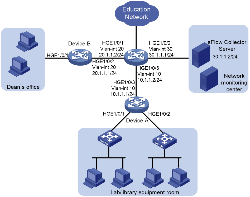

As shown in Figure 1, perform the following tasks:
·     Configure flow sampling to sample packets on Device A and Device B.
·     Configure counter sampling to periodically collect the counter information on Device A and Device B.
Figure 1 Network diagram

Configuring Device A
# Create VLAN 10. Assign HundredGigE 1/0/1 through HundredGigE 1/0/3 to VLAN 10.
<DeviceA> system-view
[DeviceA] vlan 10
[DeviceA-vlan10] port hundredgige 1/0/1 to hundredgige 1/0/3
[DeviceA-vlan10] quit
# Assign an IP address to VLAN-interface 10.
[DeviceA] interface vlan-interface 10
[DeviceA-Vlan-interface10] ip address 10.1.1.1 255.255.255.0
[DeviceA-Vlan-interface10] quit
# Assign IP addresses to other interfaces. (Details not shown.)
# Assign an IP address to the sFlow agent.
[DeviceA] sflow agent ip 10.1.1.1
# Specify the sFlow collector ID as 1, IP address as 30.1.1.2, and port number as 5000.
[DeviceA] sflow collector 1 ip 30.1.1.2 port 5000
# Enable counter sampling and set the counter sampling interval to 120 seconds on HundredGigE 1/0/1.
[DeviceA] interface hundredgige 1/0/1
[DeviceA-HundredGigE1/0/1] sflow counter interval 120
# Specify sFlow collector 1 for counter sampling on HundredGigE 1/0/1.
[DeviceA-HundredGigE1/0/1] sflow counter collector 1
[DeviceA-HundredGigE1/0/1] quit
# Enable counter sampling and set the counter sampling interval to 120 seconds on HundredGigE 1/0/2.
[DeviceA] interface hundredgige 1/0/2
[DeviceA-HundredGigE1/0/2] sflow counter interval 120
# Specify sFlow collector 1 for counter sampling on HundredGigE 1/0/2.
[DeviceA-HundredGigE1/0/2] sflow counter collector 1
[DeviceA-HundredGigE1/0/2] quit
# Enable flow sampling and set the sampling interval to 100000 on HundredGigE 1/0/1.
[DeviceA-HundredGigE1/0/1] sflow sampling-rate 100000
# Specify sFlow collector 1 for flow sampling on HundredGigE 1/0/1.
[DeviceA-HundredGigE1/0/1] sflow flow collector 1
# Enable flow sampling and set the sampling interval to 100000 on HundredGigE 1/0/2.
[DeviceA-HundredGigE1/0/2] sflow sampling-rate 100000
# Specify sFlow collector 1 for flow sampling on HundredGigE 1/0/2.
[DeviceA-HundredGigE1/0/2] sflow flow collector 1
Configuring Device B
# Create VLAN 20. Assign HundredGigE 1/0/1 and HundredGigE 1/0/2 to VLAN 20.
<DeviceB> system-view
[DeviceB] vlan 20
[DeviceB-vlan20] port HundredGigE 1/0/1 to HundredGigE 1/0/2
[DeviceB-vlan20] quit
# Assign an IP address to VLAN-interface 20.
[DeviceB] interface vlan-interface 20
[DeviceB-Vlan-interface20] ip address 20.1.1.1 255.255.255.0
[DeviceB-Vlan-interface20] quit
[DeviceB] sflow agent ip 20.1.1.1
[DeviceB] sflow collector 1 ip 30.1.1.2 port 5000
# Enable counter sampling and set the counter sampling interval to 30 seconds on HundredGigE 1/0/1.
[DeviceB] interface hundredgige 1/0/1
[DeviceB-HundredGigE1/0/1] sflow counter interval 30
[DeviceB-HundredGigE1/0/1] sflow counter collector 1
# Enable flow sampling and set the sampling interval to 20000 on HundredGigE 1/0/1.
[DeviceB-HundredGigE1/0/1] sflow sampling-rate 20000
[DeviceB-HundredGigE1/0/1] sflow flow collector 1
[DeviceB-HundredGigE1/0/1] quit
# Verify the following items on Device A:
·     HundredGigE 1/0/1 and HundredGigE 1/0/2 enabled with sFlow are active.
·     The counter sampling interval is 120 seconds.
·     The flow sampling interval is 100000.
[DeviceA] display sflow
sFlow datagram version: 5
Global information:
Agent IP: 10.1.1.1(CLI)
Source address:
Collector information:
ID    IP              Port  Aging      Size VPN-instance Description
1     30.1.1.2         5000  N/A        1400             "CLI Collector"
Port information:
Interface      CID   Interval(s) FID   MaxHLen Rate       Mode          Status
HGE1/0/1        1    120         1     128     100000     random        Active
HGE1/0/2        1    120         1     128     100000     random        Active
