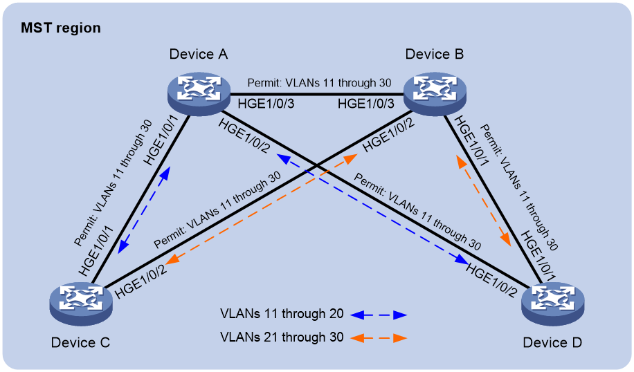

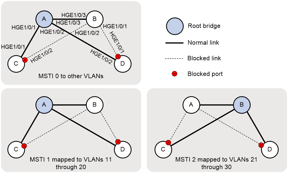

As shown in Figure 1, Device A and Device B operate at the core layer, and Device C and Device D operate at the distribution layer. The ports on the devices have the same path cost, and they all permit VLANs 11 through 30.
Configure MSTP to meet the following requirements:
·     Device A, Device B, Device C, and Device D belong to the same MST region.
·     MSTIs are used to share the traffic of VLANs 11 through 20 and of VLANs 21 through 30.
Figure 1 Network diagram

To use redundant links to share the traffic of different VLANs (as shown in Figure 2), perform the following tasks:
·     Configure Device A as the root bridge of MSTI 1.
·     Configure Device B as the root bridge of MIST 2.
·     Assign priorities to Device A, Device B, Device C, and Device D in MSTI 0 in descending order for Device A to be the regional root bridge.
Figure 2 MSTIs mapped to different VLANs

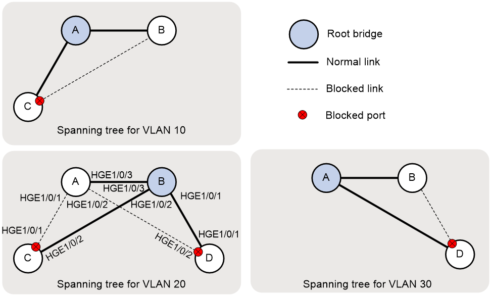

1.     Verify that Layer 2 loops have been eliminated in each MSTI:
Use the display stp brief command to display brief spanning tree information on each device.
# Display brief spanning tree information on Device A.
[DeviceA] display stp brief
 MST ID   Port                                    Role  STP State   Protection
 0        HundredGigE1/0/1                        DESI  FORWARDING  NONE
 0        HundredGigE1/0/2                        DESI  FORWARDING  NONE
 0        HundredGigE1/0/3                        DESI  FORWARDING  NONE
 1        HundredGigE1/0/1                        DESI  FORWARDING  NONE
 1        HundredGigE1/0/2                        DESI  FORWARDING  NONE
 1        HundredGigE1/0/3                        DESI  FORWARDING  NONE
 2        HundredGigE1/0/1                        DESI  FORWARDING  NONE
 2        HundredGigE1/0/2                        DESI  FORWARDING  NONE
 2        HundredGigE1/0/3                        ROOT  FORWARDING  NONE
# Display brief spanning tree information on Device B.
[DeviceB] display stp brief
 0        HundredGigE1/0/3                        ROOT  FORWARDING  NONE
 1        HundredGigE1/0/3                        ROOT  FORWARDING  NONE
 2        HundredGigE1/0/3                        DESI  FORWARDING  NONE
# Display brief spanning tree information on Device C.
[DeviceC] display stp brief
 0        HundredGigE1/0/1                       ROOT  FORWARDING  NONE
 0        HundredGigE1/0/2                       ALTE  DISCARDING  NONE
 1        HundredGigE1/0/1                       ROOT  FORWARDING  NONE
 1        HundredGigE1/0/2                       ALTE  DISCARDING  NONE
 2        HundredGigE1/0/1                       ALTE  DISCARDING  NONE
 2        HundredGigE1/0/2                       ROOT  FORWARDING  NONE
# Display brief spanning tree information on Device D.
[DeviceD] display stp brief
 0        HundredGigE1/0/1                        ALTE  DISCARDING  NONE
 0        HundredGigE1/0/2                        ROOT  FORWARDING  NONE
 1        HundredGigE1/0/1                        ALTE  DISCARDING  NONE
 1        HundredGigE1/0/2                        ROOT  FORWARDING  NONE
 2        HundredGigE1/0/1                        ROOT  FORWARDING  NONE
 2        HundredGigE1/0/2                        ALTE  DISCARDING  NONE

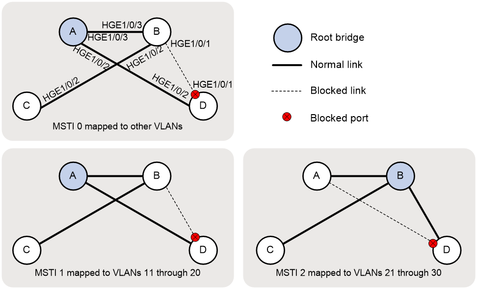

Based on the output, the topology for each MSTI is shown in Figure 3.
Figure 3 MSTI topologies
Based on the output, the topology for each MSTI is shown in Figure 4.
Figure 4 MSTI topologies

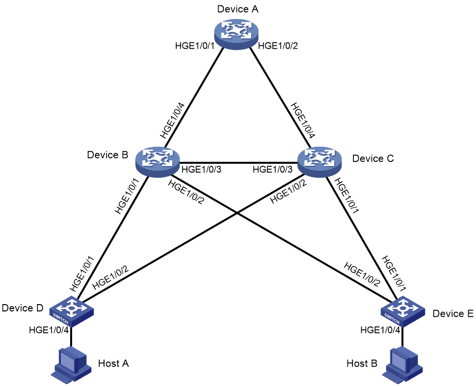

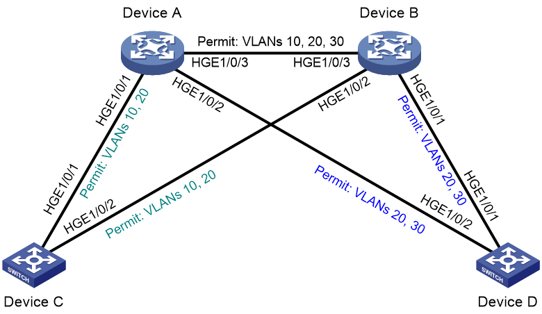

Example: Configuring PVST
As shown in Figure 5, Device A and Device B operate at the distribution layer, and Device C and Device D operate at the access layer. The ports on the devices have the same path cost.
Configure PVST to meet the following requirements:
·     Redundant links are used for load sharing.
·     Packets of each VLAN are forwarded along its spanning tree.
Figure 5 Network diagram
Analysis
For traffic of different VLANs to be shared along the spanning trees in Figure 6, perform the following tasks:
·     Configure Device A as the root bridge of the spanning trees for VLAN 10 and VLAN 30.
·     Configure Device B as the root bridge of the spanning tree for VLAN 20.
Figure 6 VLAN spanning tree topologies

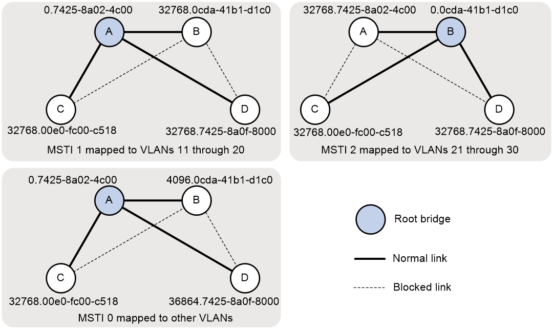

 VLAN ID  Port                                    Role  STP State   Protection
 1        HundredGigE1/0/3                        DESI  DISCARDING  NONE
 10       HundredGigE1/0/1                        DESI  FORWARDING  NONE
 10       HundredGigE1/0/3                        DESI  FORWARDING  NONE
 20       HundredGigE1/0/1                        DESI  FORWARDING  NONE
 20       HundredGigE1/0/2                        DESI  FORWARDING  NONE
 20       HundredGigE1/0/3                        ROOT  FORWARDING  NONE
 30       HundredGigE1/0/2                        DESI  FORWARDING  NONE
 30       HundredGigE1/0/3                        DESI  FORWARDING  NONE
 10       HundredGigE1/0/2                        DESI  FORWARDING  NONE
 10       HundredGigE1/0/3                        ROOT  FORWARDING  NONE
 20       HundredGigE1/0/3                        DESI  FORWARDING  NONE
 30       HundredGigE1/0/1                        DESI  FORWARDING  NONE
 30       HundredGigE1/0/3                        ROOT  FORWARDING  NONE
 10       HundredGigE1/0/1                        ROOT  FORWARDING  NONE
 10       HundredGigE1/0/2                        ALTE  DISCARDING  NONE
 20       HundredGigE1/0/1                        ALTE  DISCARDING  NONE
 20       HundredGigE1/0/2                        ROOT  FORWARDING  NONE
 20       HundredGigE1/0/1                        ROOT  FORWARDING  NONE
 20       HundredGigE1/0/2                        ALTE  DISCARDING  NONE
 30       HundredGigE1/0/1                        ALTE  DISCARDING  NONE
 30       HundredGigE1/0/2                        ROOT  FORWARDING  NONE
Based on the output, the topology for each VLAN is shown in Figure 7.
Figure 7 VLAN spanning tree topologies

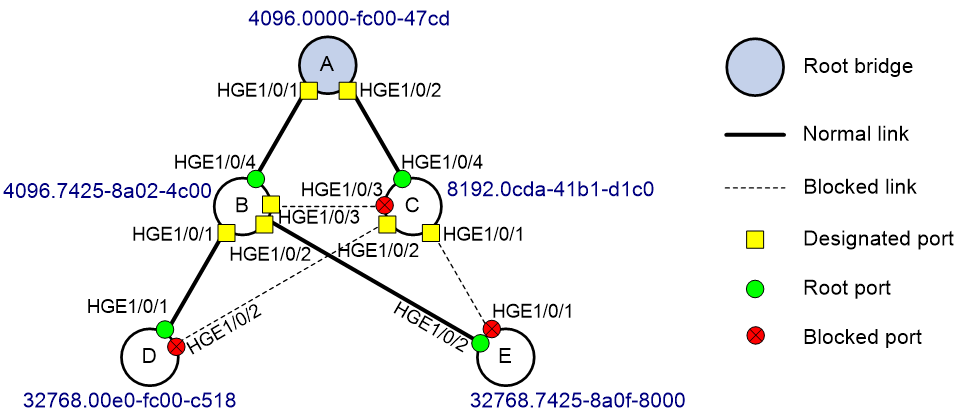

Example: Configuring RSTP
As shown in Figure 8, Device A operates at the core layer, Device B and Device C operate at the distribution layer, and Device D and Device E operate at the access layer. The ports on the devices have the same path cost.
Configure RSTP as follows:
·     Configure Device A as the root bridge, and enable root guard to retain its root bridge role when configuration errors or malicious attacks occur.
·     Configure Device C as a backup of Device B. When Device B fails, traffic is forwarded through Device C.
·     Configure HundredGigE 1/0/4 on Device D and HundredGigE 1/0/4 on Device E as edge ports, and enable BPDU guard on the ports.
Figure 8 Network diagram
Analysis
For Device C to be a backup of Device B, make sure Device C's priority is lower than Device B's priority. In this example, configure the priorities of Device B and Device C as 4096 and 8192.
For Device A to be the root bridge, make sure Device A has the lowest bridge ID (containing the device's priority and MAC address) in the network. In this example, because Device A already has the lowest MAC address, configure the priority as 4096 for Device A to hold the lowest bridge ID.
To configure a device as the root bridge, you also can use the stp root primary or stp priority 0 command to set the device's priority to 0.

·     Identify the designated ports in the RSTP topology that is calculated based on the device configuration, as shown in Figure 9.
Figure 9 RSTP topology

1.     Verify that Layer 2 loops have been eliminated in the network:
# Display the brief spanning tree information on Device A.
# Display the brief spanning tree information on Device B.
 0        HundredGigE1/0/4                        ROOT  FORWARDING  NONE
# Display the brief spanning tree information on Device C.
 0        HundredGigE1/0/3                        ALTE  DISCARDING  NONE
# Display the brief spanning tree information on Device D.
 0        HundredGigE1/0/4                        DESI  FORWARDING  BPDU
# Display the brief spanning tree information on Device E.
[DeviceE] display stp brief

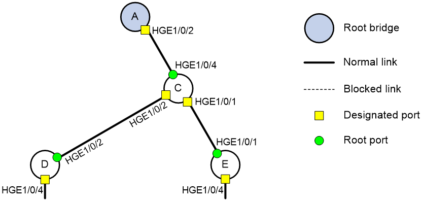

Based on the output, the topology for the network is shown in Figure 10.
Figure 10 Network topology

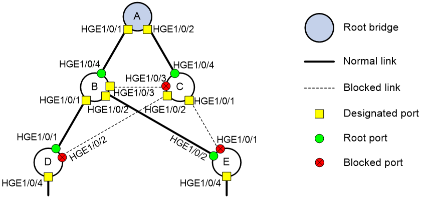

Based on the network topology, the topology for the network is shown in Figure 11.
Figure 11 Network topology
