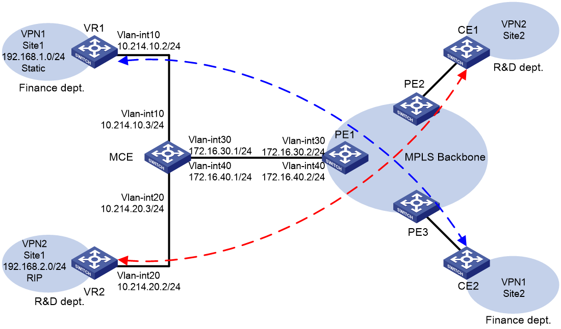

As shown in Figure 1, an enterprise has two MPLS L3VPNs. VPN 1 for the finance department uses static routes, and VPN 2 for the R&D department uses RIP routes. Site 1 of VPN 1 and Site 1 of VPN 2 are connected to the MPLS backbone through the same CE device (MCE). Site 2 of VPN 1 and Site 2 of VPN 2 are connected to the MPLS backbone through separate CEs (CE 1 and CE 2).
Configure the MCE to allow communication between the local and remote sites of the same VPN and isolate access between sites of different VPNs.
Configure the MCE and PE 1 to use OSPF to exchange VPN routes.

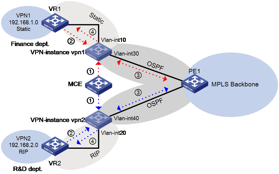

Analysis
To meet the network requirements, you must perform the following tasks:
1.     Create VPN instances on the MCE and PE 1, and bind each VPN instance to the interfaces that need to forward data for that VPN instance.
2.     Redistribute the VPN routes to the routing table of the corresponding VPN instance.
3.     Advertise the VPN routes to PE 1 through OSPF, and receive remote VPN routes from PE 1.
4.     Redistribute the remote VPN routes to the local VPN sites.

2.     Configure routing between the MCE and VPN sites:
# On VR 1, assign IP address 10.214.10.2/24 to the interface connected to the MCE. (Details not shown.)
# On VR 1, configure a default route with the next hop as the MCE.
<VR1> system-view
[VR1] ip route-static 0.0.0.0 0.0.0.0 10.214.10.3
# On the MCE, configure a static route to 192.168.1.0/24 with the next hop 10.214.10.2, and bind the static route to the VPN instance vpn1.
[MCE] ip route-static vpn-instance vpn1 192.168.1.0 24 10.214.10.2
# On the MCE, display the routing table for the VPN instance vpn1.
[MCE] display ip routing-table vpn-instance vpn1
Destinations : 7        Routes : 7
10.214.10.0/24      Direct 0     0           10.214.10.3     Vlan10
10.214.10.3/32      Direct 0     0           127.0.0.1       InLoop0
127.0.0.0/8         Direct 0     0           127.0.0.1       InLoop0
127.0.0.1/32        Direct 0     0           127.0.0.1       InLoop0
172.16.30.0/24      Direct 0     0           172.16.30.1     Vlan30
172.16.30.1/32      Direct 0     0           127.0.0.1       InLoop0
192.168.1.0/24      Static 60    0           10.214.10.2     Vlan10
The output shows that the MCE has a static route for the VPN instance vpn1.
# On VR 2, assign IP address 10.214.20.2/24 to the interface connected to the MCE. (Details not shown.)
# On VR 2, enable RIP process 20 to advertise networks 192.168.2.0/24 and 10.214.20.0/24, and disable route summarization.
<VR2> system-view
[VR2] rip 20
[VR2-rip-20] network 192.168.2.0
[VR2-rip-20] network 10.0.0.0
[VR2-rip-20] undo summary
# On the MCE, enable RIP process 20 for the VPN instance vpn2 to exchange routes with VPN 2 site 1.
[MCE] rip 20 vpn-instance vpn2
# On the MCE, advertise the network 10.214.20.0 and disable route summarization.
[MCE-rip-20] network 10.0.0.0
[MCE-rip-20] undo summary
# On the MCE, redistribute OSPF routes.
[MCE-rip-20] import-route ospf 20
[MCE-rip-20] quit
# On the MCE, display the routing table for the VPN instance vpn2.
[MCE] display ip routing-table vpn-instance vpn2
Destinations : 5        Routes : 5
10.214.20.0/24      Direct 0    0            10.214.20.3     Vlan20
10.214.20.3/32      Direct 0    0            127.0.0.1       InLoop0
172.16.40.0/30      Direct 0    0            172.16.40.1     Vlan40
172.16.40.1/32      Direct 0    0            127.0.0.1       InLoop0
192.168.2.0/24      RIP    100  1            10.214.20.2     Vlan20
The output shows that the MCE has learned a RIP route to VPN 2, which is in a different routing table from the static route to VPN 1. The routes from different VPNs are separated.

# Verify that PE 1 has learned the RIP route of VPN 2 through OSPF.
[PE1] display ip routing-table vpn-instance vpn2
Destinations : 14        Routes : 14
Destination/Mask   Proto   Pre Cost        NextHop         Interface
0.0.0.0/32         Direct  0   0           127.0.0.1       InLoop0
100.100.21.1/32    Direct  0   0           127.0.0.1       InLoop0
127.0.0.0/32       Direct  0   0           127.0.0.1       InLoop0
127.255.255.255/32 Direct  0   0           127.0.0.1       InLoop0
172.16.40.0/24     Direct  0   0           172.16.40.2     Vlan40
172.16.40.0/32     Direct  0   0           172.16.40.2     Vlan40
172.16.40.2/32     Direct  0   0           127.0.0.1       InLoop0
172.16.40.255/32   Direct  0   0           172.16.40.2     Vlan40
192.168.2.0/24     O_INTRA 150 1           172.16.40.1     Vlan40
224.0.0.0/4        Direct  0   0           0.0.0.0         NULL0
224.0.0.0/24       Direct  0   0           0.0.0.0         NULL0
255.255.255.255/32 Direct  0   0           127.0.0.1       InLoop0
Configuration files
·     VR 1:
 vlan 10
interface Vlan-interface10
 ip address 10.214.10.2 255.255.255.0
 ip route-static 0.0.0.0 0 10.214.10.3
·     VR 2:
rip 20
 network 10.0.0.0
 network 192.168.2.0
 vlan 20
interface Vlan-interface20
 ip address 10.214.20.2 255.255.255.0
·     MCE:
ip vpn-instance vpn1
 route-distinguisher 10:1
ip vpn-instance vpn2
 route-distinguisher 20:1
ospf 10 router-id 100.100.10.1 vpn-instance vpn1
 import-route static
 vpn-instance-capability simple
 area 0.0.0.0
  network 172.16.30.0 0.0.0.255
ospf 20 router-id 100.100.20.1 vpn-instance vpn2
 import-route rip 20
 area 0.0.0.0
  network 172.16.40.0 0.0.0.255
 undo summary
 network 10.0.0.0
vlan 10
vlan 20
vlan 30
vlan 40
interface LoopBack0
 ip binding vpn-instance vpn1
 ip address 100.100.10.1 255.255.255.255
interface LoopBack1
 ip binding vpn-instance vpn2
 ip address 100.100.20.1 255.255.255.255
 ip address 10.214.10.3 255.255.255.0
 ip address 10.214.20.3 255.255.255.0
interface Vlan-interface30
 ip address 172.16.30.1 255.255.255.0
interface Vlan-interface40
 ip address 172.16.40.1 255.255.255.0
 ip route-static vpn-instance vpn1 192.168.1.0 255.255.255.0 10.214.10.2
·     PE 1:
 domain-id 0.0.0.10
 area 0.0.0.0
 domain-id 0.0.0.20
 area 0.0.0.0
vlan 30
vlan 40
interface LoopBack0
 ip address 100.100.11.1 255.255.255.255
interface LoopBack1
 ip address 100.100.21.1 255.255.255.255
 ip address 172.16.30.2 255.255.255.0
 ip address 172.16.40.2 255.255.255.0

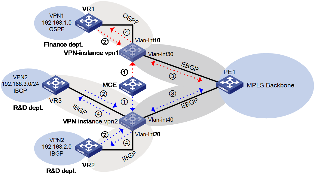

Example: Configuring the MCE to advertise VPN routes to the PE by using BGP (on switches)
As shown in Figure 3, an enterprise has two MPLS L3VPNs. VPN 1 for the finance department uses OSPF, and VPN 2 for the R&D department uses IBGP. Site 1 of VPN 1, Site 2 of VPN 2, and Site 1 of VPN 2 are connected to the MPLS backbone through the same CE device (MCE). Site 3 of VPN 2 and Site 2 of VPN 1 are connected to the MPLS backbone through separate CEs (CE 1 and CE 2).
Configure the MCE and PE 1 to use BGP to exchange VPN routes.
Figure 3 Network diagram
Analysis
IBGP requires a fully meshed network or a router reflector. In this example, you must configure the MCE as the IBGP route reflector.
3.     Advertise the VPN routes to PE 1 through EBGP, and receive remote VPN routes from PE 1.

3.     Configure routing between the MCE and PE 1:
# On the MCE, create the BGP-VPN instance vpn1, and specify 172.16.30.2 (PE 1) as the EBGP peer in AS 200.
[MCE] bgp 100
[MCE-bgp-default] ip vpn-instance vpn1
[MCE-bgp-default-vpn1] peer 172.16.30.2 as-number 200
# Redistribute OSPF routes for BGP-VPN instance vpn1, and advertise network 172.16.30.0/24.
[MCE-bgp-default-vpn1] address-family ipv4
[MCE-bgp-default-ipv4-vpn1] import-route ospf
[MCE-bgp-default-ipv4-vpn1] peer 172.16.30.2 enable
[MCE-bgp-default-ipv4-vpn1] network 172.16.30.0 24
[MCE-bgp-default-ipv4-vpn1] quit
[MCE-bgp-default-vpn1] quit
# On PE 1, enter the view of the BGP-VPN instance vpn1, specify 172.16.30.1 (the MCE) as the EBGP peer in AS 100, and advertise network 172.16.30.0/24.
[PE1] bgp 200
[PE1-bgp-default] ip vpn-instance vpn1
[PE1-bgp-default-vpn1] peer 172.16.30.1 as-number 100
[PE1-bgp-default-vpn1] address-family ipv4
[PE1-bgp-default-ipv4-vpn1] peer 172.16.30.1 enable
[PE1-bgp-default-ipv4-vpn1] network 172.16.30.0 24
[PE1-bgp-default-ipv4-vpn1] quit
[PE1-bgp-default-vpn1] quit
# On the MCE, enter the view of the BGP-VPN instance vpn2, specify 172.16.40.2 (PE 1) as the EBGP peer in AS 200, and advertise network 172.16.40.0/24.
[MCE-bgp-default] ip vpn-instance vpn2
[MCE-bgp-default-vpn2] peer 172.16.40.2 as-number 200
[MCE-bgp-default-vpn2] address-family ipv4
[MCE-bgp-default-ipv4-vpn2] peer 172.16.40.2 enable
[MCE-bgp-default-ipv4-vpn2] network 172.16.40.0 24
[MCE-bgp-default-ipv4-vpn2] quit
[MCE-bgp-default-vpn2] quit
[MCE-bgp-default] quit
# On PE 1, enter the view of the BGP-VPN instance vpn2, specify 172.16.40.1 (the MCE) as the EBGP peer in AS 100, and advertise network 172.16.40.0/24.
[PE1-bgp-default] ip vpn-instance vpn2
[PE1-bgp-default-vpn2] peer 172.16.40.1 as-number 100
[PE1-bgp-default-vpn2] address-family ipv4
[PE1-bgp-default-ipv4-vpn2] peer 172.16.40.1 enable
[PE1-bgp-default-ipv4-vpn2] network 172.16.40.0 24
[PE1-bgp-default-ipv4-vpn2] quit
[PE1-bgp-default-vpn2] quit
[PE1-bgp-default] quit
# On PE 1, verify that the VPN instance vpn1 has learned the BGP route to VPN 1 site 1.
[PE1] display ip routing-table vpn-instance vpn1
172.16.30.0/24      Direct 0    0            172.16.30.2     Vlan30
172.16.30.2/24      Direct 0    0            127.0.0.1       InLoop0
192.168.1.0/24      BGP    255  3            172.16.30.1     Vlan30
# On PE 1, verify that the VPN instance vpn2 has learned the BGP routes to the sites of VPN 2.
Destinations : 16        Routes : 16
10.214.20.0/24     BGP     255 0           172.16.40.1     Vlan40
10.214.50.0/24     BGP     255 0           172.16.40.1     Vlan40
192.168.2.0/24     BGP     255 0           172.16.40.1     Vlan40
192.168.3.0/24     BGP     255 0           172.16.40.1     Vlan40
Configuration files
·     VR 1:
ospf 1
 area 0.0.0.0
  network 10.214.10.0 0.0.0.255
  network 192.168.1.0 0.0.0.255
 vlan 10
·     VR 2:
 vlan 20
bgp 100
 router-id 2.2.2.2
 peer 10.214.20.3 as-number 100
 address-family ipv4 unicast
  network 10.214.20.0 255.255.255.0
  network 192.168.2.0 255.255.255.0
  peer 10.214.20.3 enable
·     VR 3:
 vlan 21
interface Vlan-interface21
 ip address 10.214.50.2 255.255.255.0
bgp 100
 router-id 3.3.3.3
 peer 10.214.50.3 as-number 100
  network 3.3.3.3 255.255.255.255
  network 10.214.50.0 255.255.255.0
  network 192.168.3.0 255.255.255.0
  peer 10.214.50.3 enable
·     MCE:
vlan 10
vlan 20 to 21
vlan 30
vlan 40
interface LoopBack0
 ip address 101.101.10.1 255.255.255.255
 ip address 10.214.50.3 255.255.255.0
bgp 100
   import-route ospf 1
   network 172.16.30.0 255.255.255.0
  peer 10.214.20.2 as-number 100
  peer 10.214.50.2 as-number 100
   network 172.16.40.0 255.255.255.0
   peer 10.214.20.2 enable
   peer 10.214.20.2 reflect-client
   peer 10.214.50.2 enable
   peer 10.214.50.2 reflect-client
ospf 1 router-id 101.101.10.1 vpn-instance vpn1
 area 0.0.0.0
·     PE 1:
vlan 30
vlan 40
interface LoopBack0
interface LoopBack1
bgp 200
