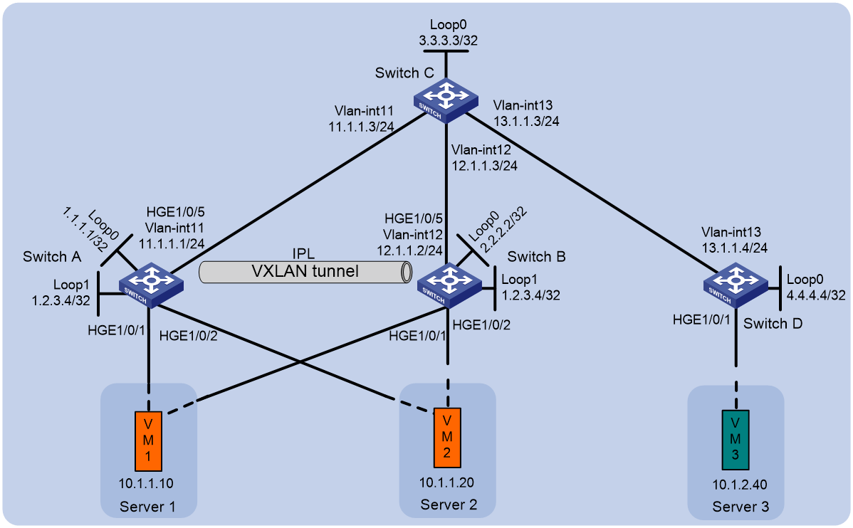

Example: Configuring DRNI using an Ethernet aggregate link as the IPL on EVPN VTEPs
As shown in Figure 1, perform the following tasks to make sure the VMs can communicate with one another:
·     Configure VXLAN 10 on Switch A, Switch B, and Switch D.
·     Configure DRNI on Switch A and Switch B to virtualize them into one VTEP. Configure an Ethernet aggregate link as the IPL between the switches.
·     Configure Switch C as a route reflector (RR).
Figure 1 Network diagram
Analysis
To make sure the overlay network has connectivity, configure a routing protocol on the switches to advertise routes for reaching their interfaces, including the loopback interfaces. In this example, OSPF is used.
To conserve resources, configure Switch C to reflect routes for Switch A, Switch B, and Switch D.

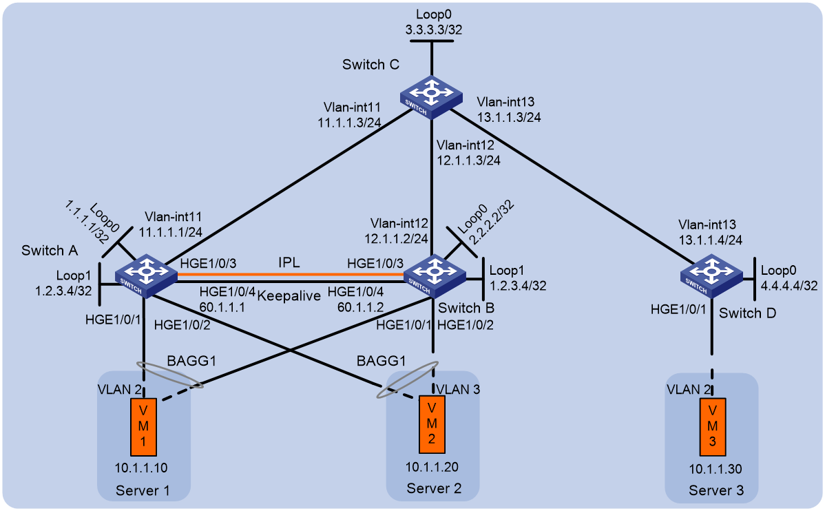

Configuring DRNI
Configuring Switch A
Choose one of the following frame match criterion creation methods for dynamic ACs. Use the same method on Switch A and Switch B. This example uses the default method.
·     Enable the device to create frame match criteria based on VXLAN IDs for the dynamic ACs on the IPL.
[SwitchA] l2vpn drni peer-link ac-match-rule vxlan-mapping
·     Use the default setting for dynamic ACs on the IPL to use frame match criteria identical to those of site-facing ACs.
# Specify the virtual VTEP address as 1.2.3.4.
[SwitchA] evpn drni group 1.2.3.4
# Configure DR system parameters.
[SwitchA] drni system-mac 0001-0001-0001
[SwitchA] drni system-number 1
[SwitchA] drni system-priority 10
[SwitchA] drni restore-delay 180
[SwitchA] drni keepalive ip destination 60.1.1.2 source 60.1.1.1
# Create Layer 2 dynamic aggregate interface Bridge-Aggregation 3.
[SwitchA] interface bridge-aggregation 3
[SwitchA-Bridge-Aggregation3] link-aggregation mode dynamic
[SwitchA-Bridge-Aggregation3] quit
# Assign HundredGigE 1/0/3 to aggregation group 3.
[SwitchA] interface hundredgige 1/0/3
[SwitchA-HundredGigE1/0/3] port link-aggregation group 3
[SwitchA-HundredGigE1/0/3] quit
# Specify Bridge-Aggregation 3 as the IPP.
[SwitchA-Bridge-Aggregation3] port drni intra-portal-port 1
[SwitchA-Bridge-Aggregation3] undo mac-address static source-check enable
# Disable static source check and spanning tree on HundredGigE 1/0/5.
[SwitchA] interface hundredgige 1/0/5
[SwitchA-HundredGigE1/0/5] undo mac-address static source-check enable
[SwitchA-HundredGigE1/0/5] undo stp enable
[SwitchA-HundredGigE1/0/5] quit
# Create Layer 2 dynamic aggregate interface Bridge-Aggregation 4.
[SwitchA] interface bridge-aggregation 4
[SwitchA-Bridge-Aggregation4] link-aggregation mode dynamic
[SwitchA-Bridge-Aggregation4] quit
# Assign HundredGigE 1/0/1 to aggregation group 4.
[SwitchA] interface hundredgige 1/0/1
[SwitchA-HundredGigE1/0/1] port link-aggregation group 4
[SwitchA-HundredGigE1/0/1] quit
# Assign Bridge-Aggregation 4 to DR group 4.
[SwitchA-Bridge-Aggregation4] port drni group 4
# Create Layer 2 dynamic aggregate interface Bridge-Aggregation 5.
[SwitchA] interface bridge-aggregation 5
[SwitchA-Bridge-Aggregation5] link-aggregation mode dynamic
[SwitchA-Bridge-Aggregation5] quit
# Assign HundredGigE 1/0/2 to aggregation group 5.
[SwitchA] interface hundredgige 1/0/2
[SwitchA-HundredGigE1/0/2] port link-aggregation group 5
[SwitchA-HundredGigE1/0/2] quit
# Assign Bridge-Aggregation 5 to DR group 5.
[SwitchA-Bridge-Aggregation5] port drni group 5
# Exclude all interfaces used by EVPN from the shutdown action by DRNI MAD.
[SwitchA] drni mad exclude interface loopback 0
[SwitchA] drni mad exclude interface hundredgige 1/0/4
[SwitchA] drni mad exclude interface hundredgige 1/0/5
[SwitchA] drni mad exclude interface vlan-interface 11
Configuring Switch B
[SwitchB] l2vpn drni peer-link ac-match-rule vxlan-mapping
[SwitchB] evpn drni group 1.2.3.4
[SwitchB] drni system-mac 0001-0001-0001
[SwitchB] drni system-number 2
[SwitchB] drni system-priority 10
[SwitchB] drni restore-delay 180
[SwitchB] drni keepalive ip destination 60.1.1.1 source 60.1.1.2
[SwitchB] interface bridge-aggregation 3
[SwitchB-Bridge-Aggregation3] link-aggregation mode dynamic
[SwitchB-Bridge-Aggregation3] quit
[SwitchB] interface hundredgige 1/0/3
[SwitchB-HundredGigE1/0/3] port link-aggregation group 3
[SwitchB-HundredGigE1/0/3] quit
[SwitchB-Bridge-Aggregation3] port drni intra-portal-port 1
[SwitchB-Bridge-Aggregation3] undo mac-address static source-check enable
[SwitchB] interface hundredgige 1/0/5
[SwitchB-HundredGigE1/0/5] undo mac-address static source-check enable
[SwitchB-HundredGigE1/0/5] undo stp enable
[SwitchB-HundredGigE1/0/5] quit
[SwitchB] interface bridge-aggregation 4
[SwitchB-Bridge-Aggregation4] link-aggregation mode dynamic
[SwitchB-Bridge-Aggregation4] quit
[SwitchB] interface hundredgige 1/0/1
[SwitchB-HundredGigE1/0/1] port link-aggregation group 4
[SwitchB-HundredGigE1/0/1] quit
[SwitchB-Bridge-Aggregation4] port drni group 4
[SwitchB] interface bridge-aggregation 5
[SwitchB-Bridge-Aggregation5] link-aggregation mode dynamic
[SwitchB-Bridge-Aggregation5] quit
[SwitchB] interface hundredgige 1/0/2
[SwitchB-HundredGigE1/0/2] port link-aggregation group 5
[SwitchB-HundredGigE1/0/2] quit
[SwitchB-Bridge-Aggregation5] port drni group 5
[SwitchB] drni mad exclude interface loopback 0
[SwitchB] drni mad exclude interface hundredgige 1/0/4
[SwitchB] drni mad exclude interface hundredgige 1/0/5
[SwitchA] drni mad exclude interface vlan-interface 12
Configuring BGP to advertise BGP EVPN routes
# Configure BGP to advertise BGP EVPN routes.
[SwitchA] bgp 200
[SwitchA-bgp-default] peer 3.3.3.3 as-number 200
[SwitchA-bgp-default] peer 3.3.3.3 connect-interface loopback 0
[SwitchA-bgp-default] address-family l2vpn evpn
[SwitchA-bgp-default-evpn] peer 3.3.3.3 enable
[SwitchA-bgp-default-evpn] quit
[SwitchA-bgp-default] quit
[SwitchB] bgp 200
[SwitchB-bgp-default] peer 3.3.3.3 as-number 200
[SwitchB-bgp-default] peer 3.3.3.3 connect-interface loopback 0
[SwitchB-bgp-default] address-family l2vpn evpn
[SwitchB-bgp-default-evpn] peer 3.3.3.3 enable
[SwitchB-bgp-default-evpn] quit
[SwitchB-bgp-default] quit
Configuring Switch C
# Configure BGP to advertise BGP EVPN routes and configure the switch as an RR.
[SwitchC] bgp 200
[SwitchC-bgp-default] group evpn
[SwitchC-bgp-default] peer 1.1.1.1 group evpn
[SwitchC-bgp-default] peer 2.2.2.2 group evpn
[SwitchC-bgp-default] peer 4.4.4.4 group evpn
[SwitchC-bgp-default] peer evpn as-number 200
[SwitchC-bgp-default] peer evpn connect-interface loopback 0
[SwitchC-bgp-default] address-family l2vpn evpn
[SwitchC-bgp-default-evpn] peer evpn enable
[SwitchC-bgp-default-evpn] undo policy vpn-target
[SwitchC-bgp-default-evpn] peer evpn reflect-client
[SwitchC-bgp-default-evpn] quit
[SwitchC-bgp-default] quit
Configuring Switch D
[SwitchD] bgp 200
[SwitchD-bgp-default] peer 3.3.3.3 as-number 200
[SwitchD-bgp-default] peer 3.3.3.3 connect-interface loopback 0
[SwitchD-bgp-default] address-family l2vpn evpn
[SwitchD-bgp-default-evpn] peer 3.3.3.3 enable
[SwitchD-bgp-default-evpn] quit
[SwitchD-bgp-default] quit
Mapping Ethernet service instances to VSIs
# On Bridge-Aggregation 4, create Ethernet service instance 1000 to match VLAN 2.
[SwitchA-Bridge-Aggregation4] port link-type trunk
[SwitchA-Bridge-Aggregation4] port trunk permit vlan 2
[SwitchA-Bridge-Aggregation4] service-instance 1000
[SwitchA-Bridge-Aggregation4-srv1000] encapsulation s-vid 2
# Map Ethernet service instance 1000 to VSI vpna.
[SwitchA-Bridge-Aggregation4-srv1000] xconnect vsi vpna
[SwitchA-Bridge-Aggregation4-srv1000] quit
# On Bridge-Aggregation 5, create Ethernet service instance 1000 to match VLAN 3.
[SwitchA-Bridge-Aggregation5] port link-type trunk
[SwitchA-Bridge-Aggregation5] port trunk permit vlan 3
[SwitchA-Bridge-Aggregation5] service-instance 1000
[SwitchA-Bridge-Aggregation5-srv1000] encapsulation s-vid 3
[SwitchA-Bridge-Aggregation5-srv1000] xconnect vsi vpna
[SwitchA-Bridge-Aggregation5-srv1000] quit
[SwitchB-Bridge-Aggregation4] port link-type trunk
[SwitchB-Bridge-Aggregation4] port trunk permit vlan 2
[SwitchB-Bridge-Aggregation4] service-instance 1000
[SwitchB-Bridge-Aggregation4-srv1000] encapsulation s-vid 2
[SwitchB-Bridge-Aggregation4-srv1000] xconnect vsi vpna
[SwitchB-Bridge-Aggregation4-srv1000] quit
[SwitchB-Bridge-Aggregation5] port link-type trunk
[SwitchB-Bridge-Aggregation5] port trunk permit vlan 3
[SwitchB-Bridge-Aggregation5] service-instance 1000
[SwitchB-Bridge-Aggregation5-srv1000] encapsulation s-vid 3
[SwitchB-Bridge-Aggregation5-srv1000] xconnect vsi vpna
[SwitchB-Bridge-Aggregation5-srv1000] quit
# On HundredGigE 1/0/1, create Ethernet service instance 1000 to match VLAN 2.
[SwitchD] interface hundredgige 1/0/1
[SwitchD-HundredGigE1/0/1] port link-type trunk
[SwitchD-HundredGigE1/0/1] port trunk permit vlan 2
[SwitchD-HundredGigE1/0/1] service-instance 1000
[SwitchD-HundredGigE1/0/1] encapsulation s-vid 2
[SwitchD-HundredGigE1/0/1] xconnect vsi vpna
[SwitchD-HundredGigE1/0/1] quit

# Verify that VM 1, VM 2, and VM 3 can communicate when both Switch A and Switch B are operating correctly. (Details not shown.)
# Verify that VM 1, VM 2, and VM 3 can communicate when Switch A's or Switch B's links to the local site are disconnected. (Details not shown.)
Configuration files
·     Switch A:
 vxlan tunnel mac-learning disable
ospf 1 router-id 1.1.1.1
 area 0.0.0.0
  network 1.1.1.1 0.0.0.0
  network 1.2.3.4 0.0.0.0
  network 11.1.1.0 0.0.0.255
vlan 11
l2vpn enable
 vxlan tunnel arp-learning disable
vsi vpna
 arp suppression enable
 vxlan 10
 evpn encapsulation vxlan
  route-distinguisher auto
  vpn-target auto export-extcommunity
  vpn-target auto import-extcommunity
interface Bridge-Aggregation3
interface Bridge-Aggregation4
 port drni group 4
  xconnect vsi vpna
interface Bridge-Aggregation5
 port drni group 5
  xconnect vsi vpna
interface LoopBack0
 ip address 1.1.1.1 255.255.255.255
interface LoopBack0
 ip address 1.2.3.4 255.255.255.255
interface Vlan-interface11
 ip address 11.1.1.1 255.255.255.0
interface HundredGigE1/0/4
 port link-mode route
 ip address 60.1.1.1 255.255.255.0
interface HundredGigE1/0/1
 port link-mode bridge
interface HundredGigE1/0/2
interface HundredGigE1/0/3
interface HundredGigE1/0/5
 port access vlan 11
bgp 200
 peer 3.3.3.3 connect-interface LoopBack0
  peer 3.3.3.3 enable
 drni mad exclude interface LoopBack0
 drni mad exclude interface HundredGigE1/0/4
 drni mad exclude interface HundredGigE1/0/5
 drni mad exclude interface Vlan-interface11
return
·     Switch B:
ospf 1 router-id 2.2.2.2
 area 0.0.0.0
  network 2.2.2.2 0.0.0.0
  network 12.1.1.0 0.0.0.255
vlan 12
l2vpn enable
vsi vpna
 vxlan 10
 port drni group 4
  xconnect vsi vpna
 port drni group 5
  xconnect vsi vpna
interface LoopBack0
 ip address 2.2.2.2 255.255.255.255
interface LoopBack1
interface Vlan-interface12
 ip address 12.1.1.2 255.255.255.0
 ip address 60.1.1.2 255.255.255.0
 port access vlan 12
bgp 200
  peer 3.3.3.3 enable
 drni mad exclude interface Vlan-interface12
return
·     Switch C:
ospf 1 router-id 3.3.3.3
 area 0.0.0.0
  network 3.3.3.3 0.0.0.0
  network 13.1.1.0 0.0.0.255
vlan 11 to 13
interface LoopBack0
 ip address 3.3.3.3 255.255.255.255
 ip address 11.1.1.3 255.255.255.0
 ip address 12.1.1.3 255.255.255.0
interface Vlan-interface13
 ip address 13.1.1.3 255.255.255.0
 port access vlan 11
 port access vlan 12
 port access vlan 13
bgp 200
 group evpn internal
 peer evpn connect-interface LoopBack0
  peer evpn enable
return
·     Switch D:
ospf 1 router-id 4.4.4.4
 area 0.0.0.0
  network 4.4.4.4 0.0.0.0
vlan 13
l2vpn enable
vsi vpna
 vxlan 10
interface LoopBack0
 ip address 4.4.4.4 255.255.255.255
 ip address 13.1.1.4 255.255.255.0
  xconnect vsi vpna
 port access vlan 13
bgp 200
  peer 3.3.3.3 enable

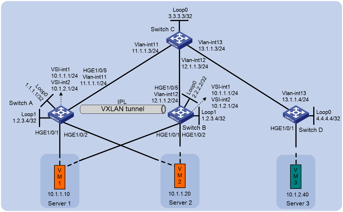

Example: Configuring DRNI using a VXLAN tunnel as the IPL on EVPN VTEPs
As shown in Figure 2, perform the following tasks to make sure the VMs can communicate with one another:
·     Configure DRNI on Switch A and Switch B to virtualize them into one VTEP. Manually set up a VXLAN tunnel as the IPL between the switches.
·     Create a monitor link group on Switch A and Switch B. Configure the transport-facing interfaces of Switch A and Switch B as uplink interfaces for the monitor link group, and member interfaces of DR interfaces as downlink interfaces.
·     Configure Switch C as an RR.
Figure 2 Network diagram
Analysis
To make sure the overlay network has connectivity,, configure a routing protocol on these switches to advertise routes for reaching their interfaces, including the loopback interfaces. In this example, OSPF is used.
Hardware
Software version
S6805 switch series
Release 6607, Release 6616, Release 6616P01, Release 6635 and later
S6825 switch series
S6850 switch series
S9850 switch series
Release 6555P01, Release 6607, Release 6616, Release 6616P01, Release 6635 and later
S9820-64H
Not supported
S9820-8C
Not supported
Manually create a VXLAN tunnel interface and configure it as the IPP. The IPL VXLAN tunnel supports only overlay services. You cannot use an automatically created VXLAN tunnel as an IPL.
The IPL VXLAN tunnel and transport VXLAN tunnels must use different physical interfaces as traffic outgoing interfaces.
Disable the spanning tree feature on the Layer 2 Ethernet interface that acts as the physical traffic outgoing interface of the IPL VXLAN tunnel. If you enable the spanning tree feature on that interface, the upstream device might falsely block the interfaces connected to the DR member devices.
Use the reserved vxlan command to specify a reserved VXLAN to forward DRNI protocol packets. The DR member devices in a DR system must have the same reserved VXLAN.
To prioritize transmission of DRNI protocol packets on the IPL, use the tunnel tos command on the VXLAN tunnel interface to set a high ToS value for tunneled packets.
Procedures
Configuring Layer 3 interfaces
# Configure the Layer 3 interfaces on Switch A.
<SwitchA> system-view
[SwitchA] interface loopback 0
[SwitchA-Loopback0] ip address 1.1.1.1 32
[SwitchA-Loopback0] quit
[SwitchA] interface loopback 1
[SwitchA-Loopback1] ip address 1.2.3.4 32
[SwitchA-Loopback1] quit
[SwitchA] vlan 11
[SwitchA-vlan11] port hundredgige 1/0/5
[SwitchA-vlan11] quit
[SwitchA] interface vlan-interface 11
[SwitchA-Vlan-interface11] ip address 11.1.1.1 24
[SwitchA-Vlan-interface11] quit
# Configure the Layer 3 interfaces on other switches. (Details not shown.)
Configuring OSPF
# Configure OSPF to advertise the networks attached to the Layer 3 interfaces.
[SwitchA] ospf 1 router-id 1.1.1.1
[SwitchA-ospf-1] area 0
[SwitchA-ospf-1-area-0.0.0.0] network 1.1.1.1 0.0.0.0
[SwitchA-ospf-1-area-0.0.0.0] network 1.2.3.4 0.0.0.0
[SwitchA-ospf-1-area-0.0.0.0] network 11.1.1.0 0.0.0.255
[SwitchA-ospf-1-area-0.0.0.0] quit
[SwitchA-ospf-1] quit
<SwitchB> system-view
[SwitchB] ospf 1 router-id 2.2.2.2
[SwitchB-ospf-1] area 0
[SwitchB-ospf-1-area-0.0.0.0] network 2.2.2.2 0.0.0.0
[SwitchB-ospf-1-area-0.0.0.0] network 1.2.3.4 0.0.0.0
[SwitchB-ospf-1-area-0.0.0.0] network 12.1.1.0 0.0.0.255
[SwitchB-ospf-1-area-0.0.0.0] quit
[SwitchB-ospf-1] quit
<SwitchC> system-view
[SwitchC] ospf 1 router-id 3.3.3.3
[SwitchC-ospf-1] area 0
[SwitchC-ospf-1-area-0.0.0.0] network 3.3.3.3 0.0.0.0
[SwitchC-ospf-1-area-0.0.0.0] network 11.1.1.0 0.0.0.255
[SwitchC-ospf-1-area-0.0.0.0] network 12.1.1.0 0.0.0.255
[SwitchC-ospf-1-area-0.0.0.0] network 13.1.1.0 0.0.0.255
[SwitchC-ospf-1-area-0.0.0.0] quit
[SwitchC-ospf-1] quit
<SwitchD> system-view
[SwitchD] ospf 1 router-id 4.4.4.4
[SwitchD-ospf-1] area 0
[SwitchD-ospf-1-area-0.0.0.0] network 4.4.4.4 0.0.0.0
[SwitchD-ospf-1-area-0.0.0.0] network 13.1.1.0 0.0.0.255
[SwitchD-ospf-1-area-0.0.0.0] quit
[SwitchD-ospf-1] quit
Configuring EVPN
# Enable L2VPN.
[SwitchA] l2vpn enable
# Disable remote MAC address learning and remote ARP learning.
[SwitchA] vxlan tunnel mac-learning disable
[SwitchA] vxlan tunnel arp-learning disable
# Specify the reserved VXLAN as VXLAN 1234.
[SwitchA] reserved vxlan 1234
# Create an EVPN instance on VSI vpna.
[SwitchA] vsi vpna
[SwitchA-vsi-vpna] arp suppression enable
[SwitchA-vsi-vpna] evpn encapsulation vxlan
# Configure the switch to automatically generate an RD and a route target for the EVPN instance.
[SwitchA-vsi-vpna-evpn-vxlan] route-distinguisher auto
[SwitchA-vsi-vpna-evpn-vxlan] vpn-target auto
[SwitchA-vsi-vpna-evpn-vxlan] quit
# Create VXLAN 10.
[SwitchA-vsi-vpna] vxlan 10
[SwitchA-vsi-vpna-vxlan-10] quit
[SwitchA-vsi-vpna] quit
# Enable L2VPN.
[SwitchB] l2vpn enable
[SwitchB] vxlan tunnel mac-learning disable
[SwitchB] vxlan tunnel arp-learning disable
[SwitchB] reserved vxlan 1234
[SwitchB] vsi vpna
[SwitchB-vsi-vpna] arp suppression enable
[SwitchB-vsi-vpna] evpn encapsulation vxlan
[SwitchB-vsi-vpna-evpn-vxlan] route-distinguisher auto
[SwitchB-vsi-vpna-evpn-vxlan] vpn-target auto
[SwitchB-vsi-vpna-evpn-vxlan] quit
# Create VXLAN 10.
[SwitchB-vsi-vpna] vxlan 10
[SwitchB-vsi-vpna-vxlan-10] quit
[SwitchB-vsi-vpna] quit
# Enable L2VPN.
[SwitchD] l2vpn enable
[SwitchD] vxlan tunnel mac-learning disable
[SwitchD] vxlan tunnel arp-learning disable
[SwitchD] vsi vpna
[SwitchD-vsi-vpna] arp suppression enable
[SwitchD-vsi-vpna] evpn encapsulation vxlan
[SwitchD-vsi-vpna-evpn-vxlan] route-distinguisher auto
[SwitchD-vsi-vpna-evpn-vxlan] vpn-target auto
[SwitchD-vsi-vpna-evpn-vxlan] quit
# Create VXLAN 10.
[SwitchD-vsi-vpna] vxlan 10
[SwitchD-vsi-vpna-vxlan-10] quit
[SwitchD-vsi-vpna] quit
Configuring DRNI
# Create a tunnel to Switch B, and set the ToS of tunneled packets to 100.
[SwitchA] interface tunnel 1 mode vxlan
[SwitchA-Tunnel1] source 1.1.1.1
[SwitchA-Tunnel1] destination 2.2.2.2
[SwitchA-Tunnel1] tunnel tos 100
[SwitchA-Tunnel1] quit
# Exclude the VXLAN tunnel outgoing interface from the shutdown action by DRNI MAD.
[SwitchA] drni mad exclude interface tunnel 1
# Specify the VXLAN tunnel interface as the IPP.
[SwitchA-Tunnel1] port drni intra-portal-port 1
# Create a tunnel to Switch A, and set the ToS of tunneled packets to 100.
[SwitchB] interface tunnel 1 mode vxlan
[SwitchB-Tunnel1] source 2.2.2.2
[SwitchB-Tunnel1] destination 1.1.1.1
[SwitchB-Tunnel1] tunnel tos 100
[SwitchB-Tunnel1] quit
[SwitchB] drni mad exclude interface tunnel 1
[SwitchB-Tunnel1] port drni intra-portal-port 1
[SwitchB] drni mad exclude interface vlan-interface 12
Configuring a monitor link group
# Create monitor link group 1 and assign uplink and downlink interfaces to it.
[SwitchA] monitor-link group 1
[SwitchA-mtlk-group1] port twenty-fivegige 1/0/1 downlink
[SwitchA-mtlk-group1] port twenty-fivegige 1/0/2 downlink
[SwitchA-mtlk-group1] port twenty-fivegige 1/0/4 uplink
[SwitchA-mtlk-group1] quit
[SwitchB] monitor-link group 1
[SwitchB-mtlk-group1] port twenty-fivegige 1/0/1 downlink
[SwitchB-mtlk-group1] port twenty-fivegige 1/0/2 downlink
[SwitchB-mtlk-group1] port twenty-fivegige 1/0/4 uplink
[SwitchB-mtlk-group1] quit
[SwitchA] bgp 200
[SwitchB] bgp 200
[SwitchC] bgp 200
[SwitchD] bgp 200
Verifying the configuration on a DR member device
The verification procedure uses Switch A as an example.
# Verify that Switch A has BGP EVPN routes.
[Switch A]display bgp l2vpn evpn
 BGP local router ID is 1.2.3.4
 Status codes: * - valid, > - best, d - dampened, h - history
               s - suppressed, S - stale, i - internal, e - external
               a - additional-path
       Origin: i - IGP, e - EGP, ? - incomplete
 Total number of routes from all PEs: 2
 Route distinguisher: 1:10
 Total number of routes: 4
     Network            NextHop         MED        LocPrf     PrefVal Path/Ogn
* >  [3][0][32][1.1.1.1]/80
                        1.1.1.1         0          100        32768   i
* >  [3][0][32][1.2.3.4]/80
                        1.2.3.4         0          100        32768   i
* >i [3][0][32][2.2.2.2]/80
                        2.2.2.2         0          100        0       i
* >i [3][0][32][4.4.4.4]/80
                        4.4.4.4         0          100        0       i
# Verify that the IPL Tunnel 1 is up, and Tunnel 0 to Switch D uses the virtual VTEP address as the source address.
[SwitchA] display interface Tunnel
Tunnel0
Current state: UP
Line protocol state: UP
Description: Tunnel0 Interface
Bandwidth: 64 kbps
Maximum transmission unit: 1464
Internet protocol processing: Disabled
Last clearing of counters: Never
Tunnel source 1.2.3.4, destination 4.4.4.4
Tunnel protocol/transport UDP_VXLAN/IP
Last 300 seconds input rate: 0 bytes/sec, 0 bits/sec, 0 packets/sec
Last 300 seconds output rate: 0 bytes/sec, 0 bits/sec, 0 packets/sec
Input: 0 packets, 0 bytes, 0 drops
Output: 0 packets, 0 bytes, 0 drops
Tunnel1
Current state: UP
Description: Tunnel1 Interface
Bandwidth: 64 kbps
Tunnel source 1.1.1.1, destination 2.2.2.2
Last 300 seconds input rate: 13 bytes/sec, 104 bits/sec, 0 packets/sec
Last 300 seconds output rate: 13 bytes/sec, 104 bits/sec, 0 packets/sec
Input: 332 packets, 36377 bytes, 0 drops
Output: 583 packets, 59132 bytes, 0 drops
# Verify that the VXLAN tunnels have been assigned to VXLAN 10.
[SwitchA] display l2vpn vsi verbose
VSI Name: vpna
  VSI Index               : 0
  VSI State               : Up
  MTU                     : 1500
  Bandwidth               : Unlimited
  Broadcast Restrain      : Unlimited
  Multicast Restrain      : Unlimited
  Unknown Unicast Restrain: Unlimited
  MAC Learning            : Enabled
  MAC Table Limit         : -
  MAC Learning rate       : -
  Drop Unknown            : -
  Flooding                : Enabled
  Statistics              : Disabled
  VXLAN ID                : 10
  Tunnels:
    Tunnel Name          Link ID    State    Type        Flood proxy
    Tunnel0              0x5000000  UP       Auto        Disabled
    Tunnel1              0x5000001  UP       Manual      Disabled
  ACs:
    AC                               Link ID  State       Type
    BAGG4 srv1000                    0        Up          Manual
    BAGG5 srv1000                    2        Up          Manual
Verifying the network connectivity of the VMs

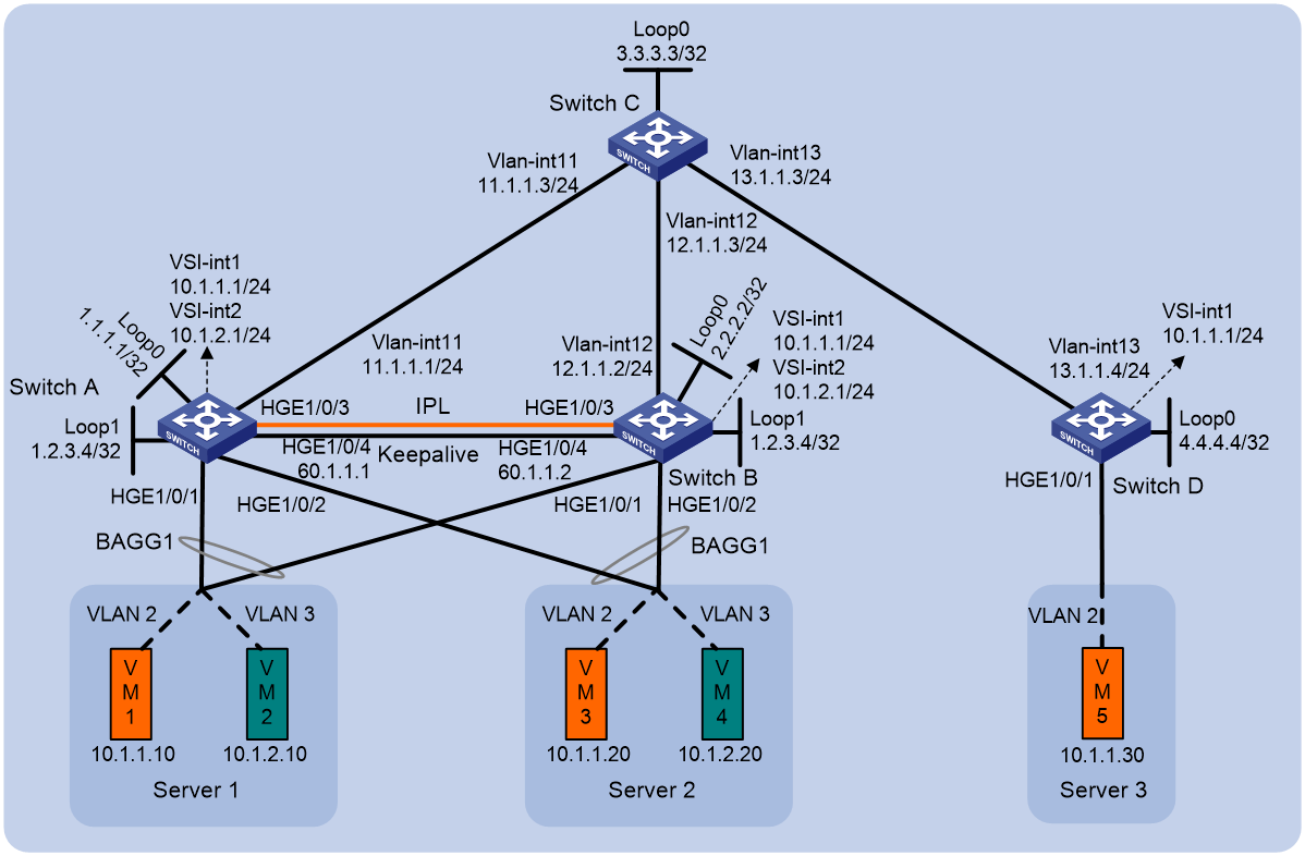

Example: Configuring DRNI using an Ethernet aggregate link as the IPL on EVPN gateways
As shown in Figure 3, perform the following tasks to make sure the VMs can communicate with one another:
·     Configure VXLAN 10 on Switch A, Switch B, and Switch D, and configure VXLAN 20 on Switch A and Switch B.
·     Configure Switch A, Switch B, and Switch D as distributed EVPN gateways to provide Layer 3 forwarding service for VMs.
Figure 3 Network diagram
Analysis

Configuring distributed EVPN gateways
# Configure RD and route target settings for VPN instance vpna.
[SwitchA] ip vpn-instance vpna
[SwitchA-vpn-instance-vpna] route-distinguisher 1:1
[SwitchA-vpn-instance-vpna] address-family ipv4
[SwitchA-vpn-ipv4-vpna] vpn-target 2:2
[SwitchA-vpn-ipv4-vpna] quit
[SwitchA-vpn-instance-vpna] address-family evpn
[SwitchA-vpn-evpn-vpna] vpn-target 1:1
[SwitchA-vpn-evpn-vpna] quit
[SwitchA-vpn-instance-vpna] quit
# Configure VSI-interface 1 as a distributed gateway.
[SwitchA] interface vsi-interface 1
[SwitchA-Vsi-interface1] ip binding vpn-instance vpna
[SwitchA-Vsi-interface1] ip address 10.1.1.1 255.255.255.0
[SwitchA-Vsi-interface1] mac-address 1-1-1
[SwitchA-Vsi-interface1] distributed-gateway local
[SwitchA-Vsi-interface1] local-proxy-arp enable
[SwitchA-Vsi-interface1] quit
# Configure VSI-interface 2 as a distributed gateway.
[SwitchA] interface vsi-interface 2
[SwitchA-Vsi-interface2] ip binding vpn-instance vpna
[SwitchA-Vsi-interface2] ip address 10.1.2.1 255.255.255.0
[SwitchA-Vsi-interface2] mac-address 2-2-2
[SwitchA-Vsi-interface2] distributed-gateway local
[SwitchA-Vsi-interface2] local-proxy-arp enable
[SwitchA-Vsi-interface2] quit
# Create VSI-interface 3. Associate VSI-interface 3 with VPN instance vpna, and configure the L3 VXLAN ID as 1000 for the VPN instance.
[SwitchA] interface vsi-interface 3
[SwitchA-Vsi-interface3] ip binding vpn-instance vpna
[SwitchA-Vsi-interface3] l3-vni 1000
[SwitchA-Vsi-interface3] quit
# Specify VSI-interface 1 as the gateway interface for VSI vpna.
[SwitchA] vsi vpna
[SwitchA-vsi-vpna] gateway vsi-interface 1
# Specify VSI-interface 2 as the gateway interface for VSI vpnb.
[SwitchA] vsi vpnb
[SwitchA-vsi-vpnb] gateway vsi-interface 2
[SwitchA-vsi-vpnb] quit
[SwitchB] ip vpn-instance vpna
[SwitchB-vpn-instance-vpna] route-distinguisher 1:1
[SwitchB-vpn-instance-vpna] address-family ipv4
[SwitchB-vpn-ipv4-vpna] vpn-target 2:2
[SwitchB-vpn-ipv4-vpna] quit
[SwitchB-vpn-instance-vpna] address-family evpn
[SwitchB-vpn-evpn-vpna] vpn-target 1:1
[SwitchB-vpn-evpn-vpna] quit
[SwitchB-vpn-instance-vpna] quit
[SwitchB] interface vsi-interface 1
[SwitchB-Vsi-interface1] ip binding vpn-instance vpna
[SwitchB-Vsi-interface1] ip address 10.1.1.1 255.255.255.0
[SwitchB-Vsi-interface1] mac-address 1-1-1
[SwitchB-Vsi-interface1] distributed-gateway local
[SwitchB-Vsi-interface1] local-proxy-arp enable
[SwitchB-Vsi-interface1] quit
[SwitchB] interface vsi-interface 2
[SwitchB-Vsi-interface2] ip binding vpn-instance vpna
[SwitchB-Vsi-interface2] ip address 10.1.2.1 255.255.255.0
[SwitchB-Vsi-interface2] mac-address 2-2-2
[SwitchB-Vsi-interface2] distributed-gateway local
[SwitchB-Vsi-interface2] local-proxy-arp enable
[SwitchB-Vsi-interface2] quit
[SwitchB] interface vsi-interface 3
[SwitchB-Vsi-interface3] ip binding vpn-instance vpna
[SwitchB-Vsi-interface3] l3-vni 1000
[SwitchB-Vsi-interface3] quit
[SwitchB] vsi vpna
[SwitchB-vsi-vpna] gateway vsi-interface 1
[SwitchB] vsi vpnb
[SwitchB-vsi-vpnb] gateway vsi-interface 2
[SwitchB-vsi-vpnb] quit
[SwitchD] ip vpn-instance vpna
[SwitchD-vpn-instance-vpna] route-distinguisher 1:1
[SwitchD-vpn-instance-vpna] address-family ipv4
[SwitchD-vpn-ipv4-vpna] vpn-target 2:2
[SwitchD-vpn-ipv4-vpna] quit
[SwitchD-vpn-instance-vpna] address-family evpn
[SwitchD-vpn-evpn-vpna] vpn-target 1:1
[SwitchD-vpn-evpn-vpna] quit
[SwitchD-vpn-instance-vpna] quit
[SwitchD] interface vsi-interface 1
[SwitchD-Vsi-interface1] ip binding vpn-instance vpna
[SwitchD-Vsi-interface1] ip address 10.1.1.1 255.255.255.0
[SwitchD-Vsi-interface1] mac-address 1-1-1
[SwitchD-Vsi-interface1] distributed-gateway local
[SwitchD-Vsi-interface1] local-proxy-arp enable
[SwitchD-Vsi-interface1] quit
# Create VSI-interface 3. Associate VSI-interface 3 with VPN instance vpna and configure the L3 VXLAN ID as 1000 for the VPN instance.
[SwitchD] interface vsi-interface 3
[SwitchD-Vsi-interface3] ip binding vpn-instance vpna
[SwitchD-Vsi-interface3] l3-vni 1000
[SwitchD-Vsi-interface3] quit
[SwitchD] vsi vpna
[SwitchD-vsi-vpna] gateway vsi-interface 1
Configuring DRNI
[SwitchA] drni system-mac 0001-0002-0003
[SwitchA] drni mad exclude interface vsi-interface 1
[SwitchA] drni mad exclude interface vsi-interface 2
[SwitchB] drni system-mac 0001-0002-0003
[SwitchB] drni mad exclude interface vsi-interface 1
[SwitchB] drni mad exclude interface vsi-interface 2
[SwitchA] bgp 200
[SwitchB] bgp 200
[SwitchC] bgp 200
[SwitchD] bgp 200
# Map Ethernet service instance 1000 to VSI vpnb.
[SwitchA-Bridge-Aggregation5-srv1000] xconnect vsi vpnb
[SwitchB-Bridge-Aggregation5-srv1000] xconnect vsi vpnb
[SwitchD-HundredGigE1/0/1-srv1000] encapsulation s-vid 2
[SwitchD-HundredGigE1/0/1-srv1000] xconnect vsi vpna
[SwitchD-HundredGigE1/0/1-srv1000] quit
               a - additional-path
 Route distinguisher: 1:1(vpna)
 Total number of routes: 2
* >  [5][0][24][10.1.1.0]/80
* >  [5][0][24][10.1.2.0]/80
                        4.4.4.4         0          100        0       i
 Route distinguisher: 1:20
                        4.4.4.4         0          100        0       i
# Verify that the VXLAN tunnel to Switch D is up, and the source address of the tunnel is the virtual VTEP address.
Tunnel0
Current state: UP
Bandwidth: 64 kbps
# Verify that ACs have been created on the IPP and mapped to VXLAN 10 and VXLAN 20.
VSI Name: Auto_L3VNI1000_3
  VSI Index               : 1
  VSI State               : Down
  MTU                     : 1500
  MAC Table Limit         : -
  Drop Unknown            : -
  Flooding                : Enabled
  Gateway Interface       : VSI-interface 3
  VXLAN ID                : 1000
VSI Name: vpna
  VSI Index               : 0
  VSI State               : Up
  MTU                     : 1500
  MAC Table Limit         : -
  Drop Unknown            : -
  Flooding                : Enabled
  Gateway Interface       : VSI-interface 1
  VXLAN ID                : 10
  Tunnels:
  ACs:
    BAGG3 srv2                       1        Up          Dynamic (MLAG)
VSI Name: vpnb
  VSI Index               : 2
  VSI State               : Up
  MTU                     : 1500
  MAC Table Limit         : -
  Drop Unknown            : -
  Flooding                : Enabled
  Gateway Interface       : VSI-interface 2
  VXLAN ID                : 20
  Tunnels:
  ACs:
    BAGG5 srv1000                    0        Up          Manual
    BAGG3 srv3                       1        Up          Dynamic (MLAG)
# Verify that the VMs can communicate when both Switch A and Switch B are operating correctly. (Details not shown.)
# Verify that VM 1 and VM 5 can communicate when Switch A's or Switch B's links to the local site are disconnected. (Details not shown.)

Example: Configuring DRNI using a VXLAN tunnel as the IPL on EVPN gateways
As shown in Figure 4, perform the following tasks to make sure the VMs can communicate with one another:
·     Configure VXLAN 10 on Switch A, Switch B, and Switch D, and configure VXLAN 20 on Switch A, and Switch B.
Figure 4 Network diagram
Analysis
[SwitchA] vsi vpna
[SwitchA] vsi vpnb
[SwitchB] vsi vpna
[SwitchB] vsi vpnb
[SwitchD] vsi vpna
Configuring DRNI
[SwitchA] drni mad exclude interface loopback0
[SwitchA] drni mad exclude interface hundredgige1/0/5
[SwitchB] drni mad exclude interface loopback0
[SwitchB] drni mad exclude interface hundredgige1/0/5
[SwitchA] bgp 200
[SwitchB] bgp 200
[SwitchC] bgp 200
[SwitchD] bgp 200
               a - additional-path
 Total number of routes from all PEs: 3
                        2.2.2.2         0          100        0       i
                        4.4.4.4         0          100        0       i
 Total number of routes: 3
                        2.2.2.2         0          100        0       i
[SwitchA] display interface tunnel
Tunnel0
Current state: UP
Bandwidth: 64 kbps
Tunnel1
Current state: UP
Bandwidth: 64 kbps
Last 300 seconds input rate: 149 bytes/sec, 1192 bits/sec, 1 packets/sec
Last 300 seconds output rate: 379 bytes/sec, 3032 bits/sec, 3 packets/sec
Input: 398 packets, 46446 bytes, 0 drops
Output: 3597 packets, 363591 bytes, 0 drops
# Verify that the VXLAN tunnels have been assigned to VXLAN 10 and VXLAN 20.
  VSI Index               : 1
  VSI State               : Down
  MTU                     : 1500
  MAC Table Limit         : -
  Drop Unknown            : -
  Flooding                : Enabled
  VXLAN ID                : 1000
VSI Name: vpna
  VSI Index               : 0
  VSI State               : Up
  MTU                     : 1500
  MAC Table Limit         : -
  Drop Unknown            : -
  Flooding                : Enabled
  VXLAN ID                : 10
  Tunnels:
  ACs:
VSI Name: vpnb
  VSI Index               : 2
  VSI State               : Up
  MTU                     : 1500
  MAC Table Limit         : -
  Drop Unknown            : -
  Flooding                : Enabled
  VXLAN ID                : 20
  Tunnels:
  ACs:
Configuration files
·     Switch A:
 address-family ipv4
  vpn-target 2:2 import-extcommunity
  vpn-target 2:2 export-extcommunity
 address-family evpn
  vpn-target 1:1 import-extcommunity
  vpn-target 1:1 export-extcommunity
 area 0.0.0.0
 hardware-resource vxlan l3gw
vlan 11
 l2vpn enable
 reserved vxlan 1234
 evpn global-mac 0002-0003-0004
vsi vpna
 vxlan 10
vsi vpnb
 vxlan 20
 port drni group 4
  xconnect vsi vpna
 port drni group 5
  xconnect vsi vpnb
interface LoopBack0
interface LoopBack1
 port access vlan 11
interface Vsi-interface1
 mac-address 0001-0001-0001
interface Vsi-interface2
 mac-address 0002-0002-0002
interface Vsi-interface3
 l3-vni 1000
interface Tunnel1 mode vxlan
 source 1.1.1.1
 destination 2.2.2.2
 tunnel tos 100
bgp 200
  peer 3.3.3.3 enable
 drni keepalive ip destination 12.1.1.2 source 11.1.1.1
 drni mad exclude interface Tunnel1
 drni mad exclude interface Vlan-interface 11
 drni mad exclude interface Vsi-interface1
 drni mad exclude interface Vsi-interface2
return
·     Switch B:
 address-family ipv4
 address-family evpn
 area 0.0.0.0
vlan 12
 l2vpn enable
 reserved vxlan 1234
vsi vpna
 vxlan 10
vsi vpnb
 vxlan 20
 port drni group 4
  xconnect vsi vpna
 port drni group 5
  xconnect vsi vpnb
interface LoopBack0
interface LoopBack1
 port access vlan 12
 l3-vni 1000
 source 2.2.2.2
 destination 1.1.1.1
 tunnel tos 100
bgp 200
  peer 3.3.3.3 enable
 drni keepalive ip destination 11.1.1.1 source 12.1.1.2
 drni mad exclude interface Vlan-interface 12
return
