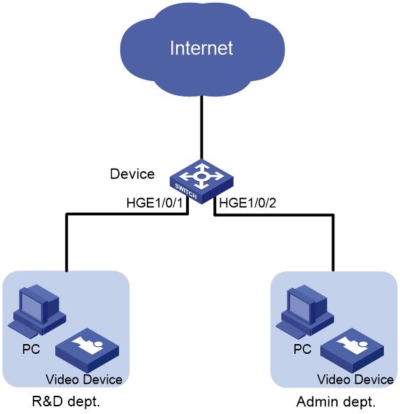

Example: Filtering packets by MAC address
As shown in Figure 1, the R&D department and the Administration department have video devices deployed. The video devices use MAC addresses prefixed with 000f-e2. Configure packet filtering on the device to allow outgoing video data to pass through only from 8:30 to 18:00 every day.
Figure 1 Network diagram
Analysis
Because the MAC addresses of the video devices are fixed, you can use an Ethernet frame header ACL to filter packets by MAC address. In the ACL, specify a MAC address and a mask to match the MAC addresses that have the same prefix.

Procedures
# Create a time range time1 for the time range from 8:30 to 18:00 every day.
<Device> system-view
[Device] time-range time1 8:30 to 18:00 daily
# Configure Ethernet frame header ACL 4000 to allow packets with source MAC addresses prefixed with 000f-e2 to pass through only during time1.
[Device] acl mac 4000
[Device-acl-mac-4000] rule permit source-mac 000f-e200-0000 ffff-ff00-0000 time-range time1
[Device-acl-mac-4000] rule deny source-mac 000f-e200-0000 ffff-ff00-0000
[Device-acl-mac-4000] quit
# Apply ACL 4000 to filter incoming packets on HundredGigE 1/0/1 and HundredGigE 1/0/2.
[Device] interface hundredgige 1/0/1
[Device-HundredGigE1/0/1] packet-filter mac 4000 inbound
[Device-HundredGigE1/0/1] quit
[Device] interface hundredgige 1/0/2
[Device-HundredGigE1/0/2] packet-filter mac 4000 inbound
[Device-HundredGigE1/0/2] quit
# Verify that the ACL is successfully applied for packet filtering.
[Device] display packet-filter interface inbound
Interface: HundredGigE1/0/1
 Inbound policy:
  MAC ACL 4000
Interface: HundredGigE1/0/2
 Inbound policy:
  MAC ACL 4000
# Verify that the video devices can communicate with the external network during the time range time1. (Details not shown.)
# Verify that the video devices cannot communicate with the external network beyond the time range time1. (Details not shown.)
Configuration files
interface HundredGigE1/0/1
 port link-mode bridge
interface HundredGigE1/0/2
 time-range time1 08:30 to 18:00 daily
acl mac 4000
 rule 0 permit source-mac 000f-e200-0000 ffff-ff00-0000 time-range time1
 rule 5 deny source-mac 000f-e200-0000 ffff-ff00-0000

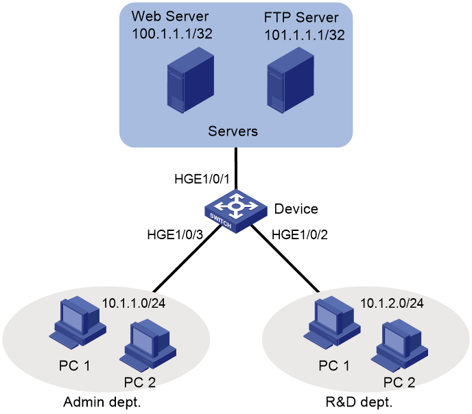

Example: Controlling FTP access
As shown in Figure 2, the device is an FTP server. Configure FTP access control on the device to meet the following requirements:
·     Users on subnet 10.1.2.0/24 can access the FTP server at any time.
·     Users on subnet 10.1.1.0/24 can access the FTP server during working hours (8:30 to 18:00) on working days (Monday to Friday).
·     Qualified users are assigned the level-15 user role.
Figure 2 Network diagram
Analysis
To meet the network requirements, you must perform the following tasks:
·     Configure two rules for the ACL. One rule permits packets from subnet 10.1.2.0/24. The other one permits packets from subnet 10.1.1.0/24 and takes effect only during working hours on working days.
·     Use the ACL to control access to the FTP server.

Procedures
# Configure the time range ftp for working hours 8:30 to 18:00 from Monday to Friday.
[Device] time-range ftp 8:30 to 18:00 working-day
# Create IPv4 basic ACL 2000.
[Device] acl basic 2000
# Configure a rule to permit packets from subnet 10.1.2.0/24.
[Device-acl-ipv4-basic-2000] rule permit source 10.1.2.0 0.0.0.255
# Configure a rule to permit packets from subnet 10.1.1.0/24 during the time range ftp.
[Device-acl-ipv4-basic-2000] rule permit source 10.1.1.0 0.0.0.255 time-range ftp
[Device-acl-ipv4-basic-2000] quit
# Enable FTP server on the device.
[Device] ftp server enable
# Add a local user named ftp and authorize this user to use the FTP service.
[Device] local-user ftp
[Device-luser-manage-ftp] service-type ftp
# Configure a password for the local user.
[Device-luser-manage-ftp] password simple 123456
# Assign the level-15 user role to the local user.
[Device-luser-manage-ftp] authorization-attribute user-role level-15
[Device-luser-manage-ftp] quit
# Use the ACL 2000 to control access to the FTP server.
[Device] ftp server acl 2000
# Verify that you can use the host at 10.1.2.100 to log in to the FTP server during working hours on wording days.
Microsoft Windows [Version 6.1.7601]
Copyright (c) 2009 Microsoft Corporation.  All rights reserved.
C:\>ftp 10.1.2.1
Connected to 10.1.2.1.
220 FTP service ready.
User (10.1.2.1:(none)): ftp
331 Password required for ftp.
Password:
230 User logged in.
# Verify that you can use the host at 10.1.1.100 to log in to the FTP server during working hours on working days.
C:\>ftp 10.1.2.1
Password:
230 User logged in.
# Verify that you can use the host at 10.1.2.100 to log in to the FTP server outside working hours.
C:\>ftp 10.1.2.1
Password:
230 User logged in.
# Verify that you cannot use the host at 10.1.1.100 to log in to the FTP server outside working hours.
C:\>ftp 10.1.2.1
ftp>
ftp> ls
Not connected.
Configuration files
 time-range ftp 08:30 to 18:00 working-day
acl basic 2000
 rule 0 permit source 10.1.2.0 0.0.0.255
 rule 5 permit source 10.1.1.0 0.0.0.255 time-range ftp
local-user ftp class manage
 password hash $h$6$HVOQzdJMVPtVd0A7$hFeYeT1ic7AgOPJ/z/Ci9db347bnJ2krcnzA+lD++iG
0jC5qSybNhuH7zi70tH4d42Y3mYtsqNaBGsN0f0ilvA==
 service-type ftp
 authorization-attribute user-role network-operator
 ftp server enable
 ftp server acl 2000

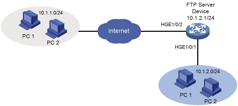

Example: Filtering packets by IP address
As shown in Figure 3, a company's internal network connects to the Internet through the device. The R&D department, Administration department, and servers are on different subnets.
Configure packet filtering to meet the following requirements:
·     The Administration department can access the Internet and servers at any time, but cannot access the R&D department at any time.
·     The R&D department can access only the servers during working hours (8:30 to 18:00) on working days (Monday to Friday). It can access the Internet and servers, but cannot access the Administration department outside working hours.
Figure 3 Network diagram
Analysis
·     To deny the Administration department to access the R&D department, perform the following tasks:
¡     Configure an advanced ACL to deny packets destined for subnet 10.1.2.0/24.
¡     Apply the ACL to filter incoming packets on HundredGigE 1/0/4.
·     To implement access control for the R&D department, perform the following tasks:
¡     Create a time range for the working hours (8:30 to 18:00) on working days (Monday to Friday).
¡     Create an advanced ACL and configure the following rules:
-     Configure rules to allow only packets destined for subnet 10.2.1.0/24 to pass through. Set the rules to be active during the time range.
-     To deny the R&D department to access the Administration department, configure a rule to deny packets destined for subnet 10.1.1.0/24.
¡     Apply the ACL to filter incoming packets on HundredGigE 1/0/3.

Procedures
Denying the Administration department to access the R&D department
# Create IPv4 advanced ACL 3000.
[Device] acl advanced 3000
# Configure a rule to deny packets destined for subnet 10.1.2.0/24 to pass through.
[Device-acl-ipv4-adv-3000] rule deny ip destination 10.1.2.0 0.0.0.255
[Device-acl-ipv4-adv-3000] quit
# Apply ACL 3000 to filter incoming packets on HundredGigE 1/0/4.
[Device] interface hundredgige 1/0/4
[Device-HundredGigE1/0/4] packet-filter 3000 inbound
[Device-HundredGigE1/0/4] quit
Configuring access control for the R&D department
# Configure a time range worktime for the time range of 8:30 to 18:00 from Monday to Friday.
[Device] time-range worktime 8:30 to 18:00 working-day
# Create IPv4 advanced ACL 3001.
[Device] acl advanced 3001
# Configure a rule to allow packets destined for subnet 10.2.1.0/24 to pass through during worktime.
[Device-acl-ipv4-adv-3001] rule permit ip destination 10.2.1.0 0.0.0.255 time-range worktime
# Configure a rule to deny all IP packets to pass through during worktime.
[Device-acl-ipv4-adv-3001] rule deny ip time-range worktime
# Configure a rule to deny packets destined for subnet 10.1.1.0/24 to pass through.
[Device-acl-ipv4-adv-3001] rule deny ip destination 10.1.1.0 0.0.0.255
[Device-acl-ipv4-adv-3001] quit
# Apply ACL 3001 to filter incoming packets on HundredGigE 1/0/3.
[Device] interface hundredgige 1/0/3
[Device-HundredGigE1/0/3] packet-filter 3001 inbound
[Device-HundredGigE1/0/3] quit
# Verify that the ACLs are successfully applied for packet filtering.

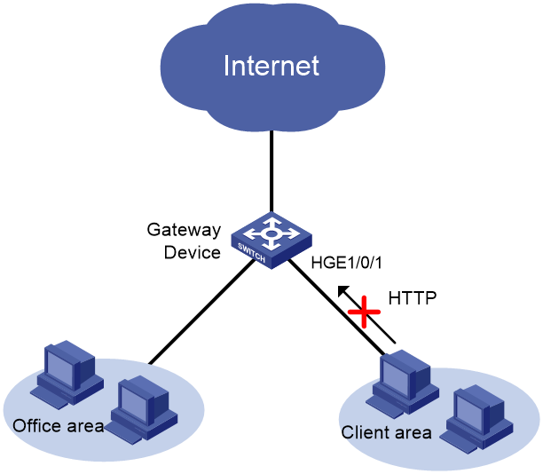

# Verify that you cannot ping through a website on the Internet from the R&D department at 9:30 on Monday.
C:\>ping www.google.com
Pinging www.google.com [173.194.127.242] with 32 bytes of data:
Request timed out.
Request timed out.
Request timed out.
Request timed out.
Ping statistics for 173.194.127.242:
    Packets: Sent = 4, Received = 0, Lost = 4 (100% loss),
C:\>
# Verify that you can ping through a website on the Internet from the Administration department at 9:30 on Monday.
Reply from 173.194.127.242: bytes=32 time=30ms TTL=50
    Minimum = 30ms, Maximum = 30ms, Average = 30ms
C:\>
# Verify that you can ping through a website on the Internet from the R&D department at 19:30 on Monday.
C:\>

Example: Filtering TCP packets
As shown in Figure 4, the R&D department, Administration department, and servers are on different networks, and they are connected through the device.
·     The Web server provides HTTP services to only the Administration department.
·     The FTP server provides FTP services to only the R&D department.
·     The TCP connections between hosts and the Web server can only be initiated by the hosts. The TCP connections between hosts and the FTP server can be initiated by either the hosts or the FTP server.
Figure 4 Network diagram
Analysis
·     To allow TCP connections initiated by the hosts to the Web server, perform the following tasks:
¡     Configure an advanced ACL rule as follows to allow packets sent by the Web server through established TCP connections to pass through:
-     Specify the established keyword (the ACK or RST flag bit set) in the rule to match established TCP connections.
-     Because a TCP initiator typically uses a TCP port number higher than 1023, specify a port number range higher than 1023 to match established TCP connections.
¡     Configure an advanced ACL rule to deny packets sent from the subnet where the Web server resides to the subnet where the hosts reside.
·     FTP uses TCP port 20 for data transfer and port 21 for FTP control. To identify FTP traffic, you must specify TCP ports 20 and 21 in ACL rules.
·     To identify HTTP packets, specify TCP port 80 in ACL rules.
Hardware
Software version
S6805 switch series
Release 6607, Release 6616, Release 6616P01, Release 6635 and later
S6825 switch series
S6850 switch series
S9850 switch series
Release 6555P01, Release 6607, Release 6616, Release 6616P01, Release 6635 and later
S9820-64H switch
S9820-8C switch
Procedures
Configuring access control for the Administration department
# Configure a rule to allow TCP packets from the Web server to the hosts on subnet 10.1.1.0/24, with TCP port number higher than 1023 and the ACK or RST flag set.
[Device-acl-ipv4-adv-3000] rule permit tcp established source 100.1.1.1 0 destination 10.1.1.0 0.0.0.255 destination-port gt 1023
# Configure a rule to deny TCP packets from subnet 100.1.1.1/32 to subnet 10.1.1.0/24 to pass through.
[Device-acl-ipv4-adv-3000] rule deny tcp source 100.1.1.1 0 destination 10.1.1.0 0.0.0.255
# Configure a rule to deny FTP packets sourced from 101.1.1.1/32 to pass through.
[Device-acl-ipv4-adv-3000] rule deny tcp source 101.1.1.1 0 source-port range 20 21
# Apply ACL 3000 to filter outgoing packets on HundredGigE 1/0/3.
[Device-HundredGigE1/0/3] packet-filter 3000 outbound
# Configure a rule to deny HTTP packets sourced from 100.1.1.1/32 to pass through.
[Device-acl-ipv4-adv-3001] rule deny tcp source 100.1.1.1 0 source-port eq 80
# Apply ACL 3001 to filter outgoing packets on HundredGigE 1/0/2.
[Device-HundredGigE1/0/2] packet-filter 3001 outbound
1.     Verify that the ACLs are successfully applied for packet filtering.
[Device] display packet-filter interface outbound
 Outbound policy:
  IPv4 ACL 3001
Interface: HundredGigE1/0/3
 Outbound policy:
  IPv4 ACL 3000
2.     Verify that you cannot Telnet to the FTP server from the Administration department.
C:\>telnet 101.1.1.1 21
Connecting To 101.1.1.1...Could not open connection to the host, on port 21:
 Connect failed
C:\>
3.     Verify that from the Web server, you can ping a host in the Administration department, but cannot access a shared folder on the host:
# Set a shared folder on a host in the Administration department. (Details not shown.)
# Ping the host from the Web server. The ping operation succeeds.
C:\>ping 10.1.1.110
Pinging 10.1.1.110 with 32 bytes of data:
Reply from 10.1.1.110: bytes=32 time=2ms TTL=128
Reply from 10.1.1.110: bytes=32 time=14ms TTL=128
Reply from 10.1.1.110: bytes=32 time=1ms TTL=128
Ping statistics for 10.1.1.110:
    Minimum = 1ms, Maximum = 14ms, Average = 4ms
C:\>
# Verify that you cannot access the share folder from the Web server. (Details not shown.)
4.     Verify that you cannot Telnet to the Web server from the R&D department.
C:\>telnet 100.1.1.1 80
Connecting To 100.1.1.1...Could not open connection to the host, on port 80:
 Connect failed
C:\>
