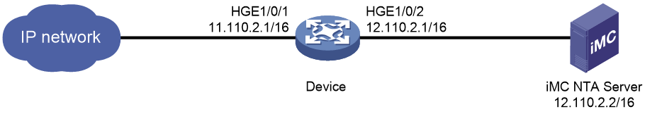

As shown in Figure 1, configure NetStream on the device to collect and export traffic statistics as follows:
·     Randomly capture one packet out of every 256 packets (both inbound and outbound) for NetStream traffic statistics collection on HundredGigE 1/0/1.
·     Export the collected traffic statistics to the IMC server with IP address 12.110.2.2/16 and UDP port 6343.
Figure 1 Network diagram

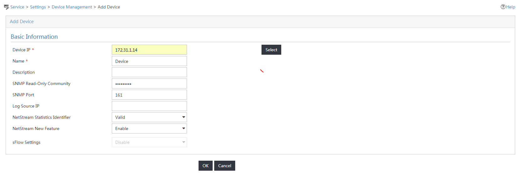

6.     On the Add Device page shown in Figure 2, perform the following steps:
a.     Enter the device IP address (12.110.2.1) in the Device IP field.
b.     Specify the device name, SNMP community name, SNMP port number, and other parameters as needed.
c.     Click OK.
Figure 2 Adding the device to IMC NTA

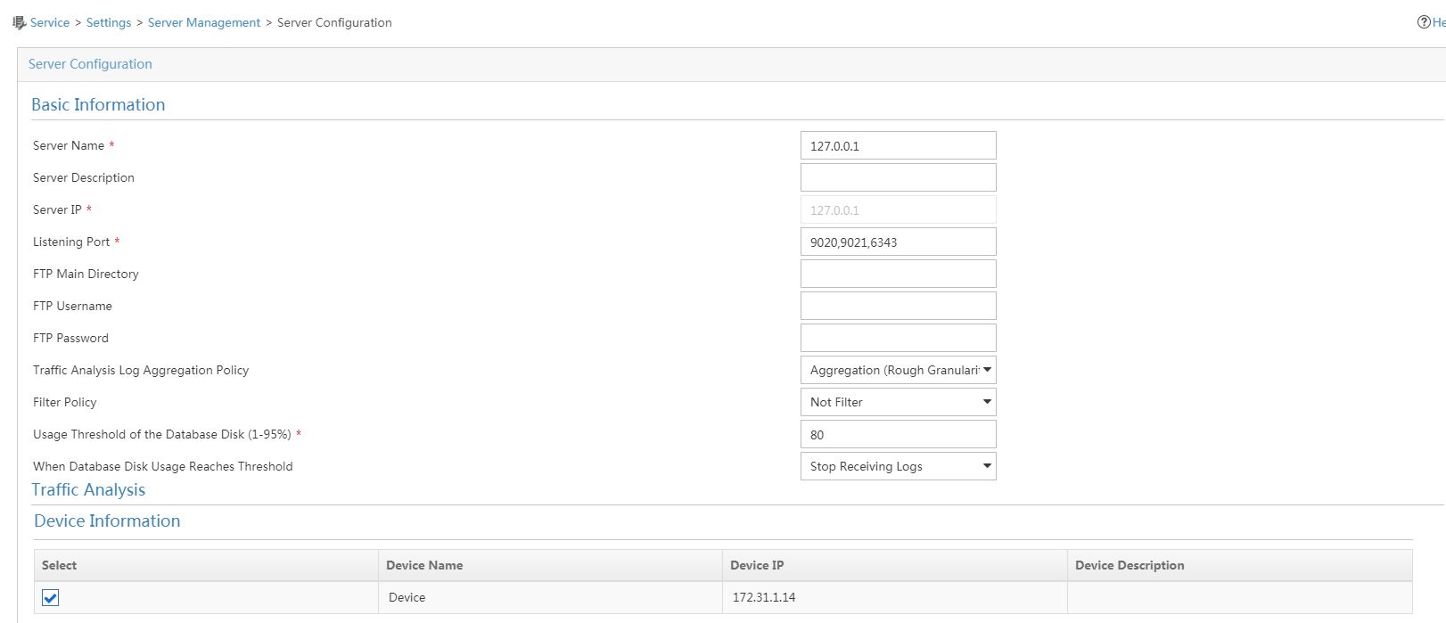

3.     On the Server Configuration page shown in Figure 3, configure the following parameters:
a.     Set port 6343 as the listening port for the server.
b.     Select the device (12.110.2.1) in the Traffic Analysis area.
c.     Use the default settings for other parameters.
d.     Click Deploy.
Figure 3 Server Configuration

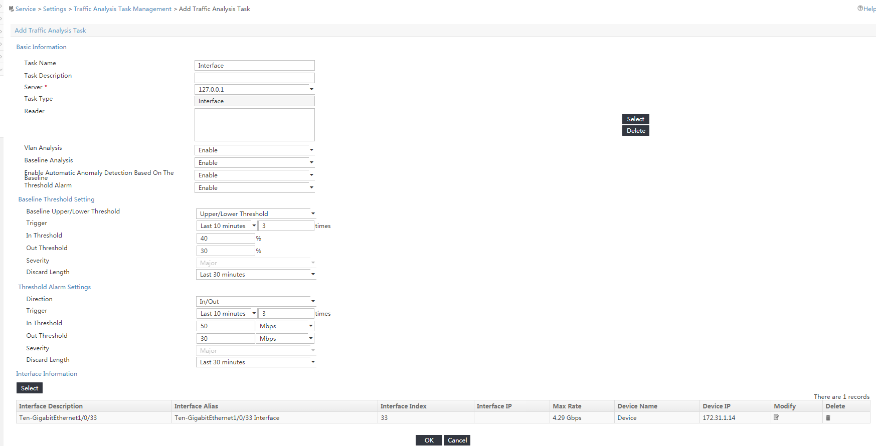

Adding a traffic analysis task
1.     On the Settings page, click Traffic Analysis Task Management.
The Traffic Analysis Task Management page opens.
2.     Click Add.
The Select Task Type page opens.
3.     Select Interface and click Next.
The Add Traffic Analysis Task page opens.
4.     In the Basic Information area, configure the following settings:
¡     Task Name—Enter a task name. This example uses Interface.
¡     ServerSelect 127.0.0.1 from the list.
¡     Reader—Click Select next to the Reader field, select the operator groups that have access to the analysis and reports provided by the task, and click OK.
¡     Vlan Analysis—Select Disable from the list.
¡     Baseline Analysis—Select Enable from the list.
The Enable Automatic Anomaly Detection Based On The Baseline parameter and the Baseline Threshold Setting area are displayed.
¡     Enable Automatic Anomaly Detection Based On The Baseline—Select Disable from the list.
¡     Threshold Alarm—Select Enable from the list.
The Threshold Alarm Settings area is displayed.
5.     In the Baseline Threshold Settings area, set the In Threshold to 40% and the Out Threshold to 30%.
6.     In the Threshold Alarm Settings area, set the In Threshold to 50 Mbps and the Out Threshold to 30 Mbps.
7.     In the Interface Information area, click Select and select interface HundredGigE 1/0/2.
8.     Use the default settings for other parameters.
9.     Click OK.
Figure 4 Adding an interface traffic analysis task

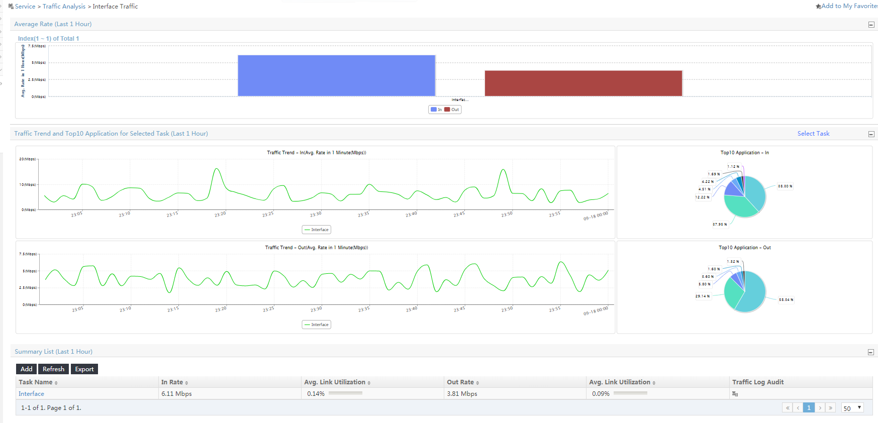

1.     View the interface traffic analysis task summary reports.
a.     Click the Service tab.
b.     From the left navigation pane, select Traffic Analysis and Audit > Interface Traffic Analysis Task.
The interface traffic analysis task summary reports are displayed, as shown in Figure 5.
Figure 5 Summary reports for interface traffic analysis tasks

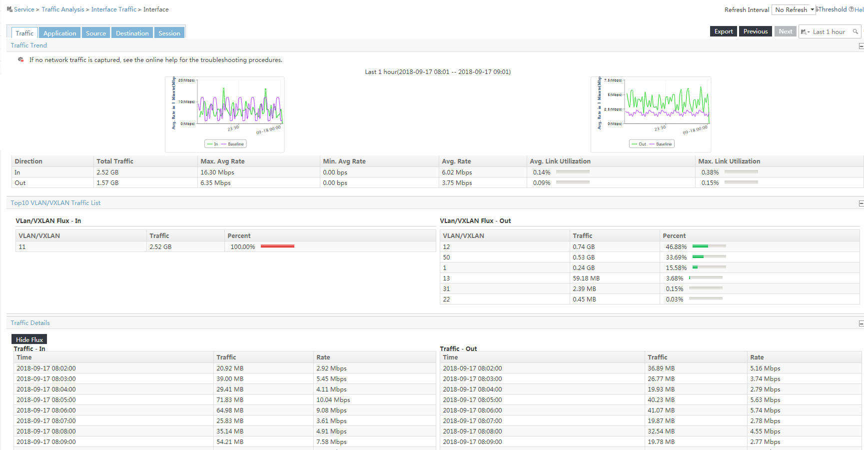

2.     View detailed reports for the interface traffic analysis task named Interface:
b.     From the left navigation tree, select Traffic Analysis and Audit > Interface Traffic Analysis Task.
c.     Use either of the following methods to access the report page of interface traffic analysis task Interface:
-     In the Summary List area, click the name of interface traffic analysis task.
-     On the left navigation pane, move your mouse pointer to the shortcut menu icon  next to imc_nta_icon_interface_trafficInterface Traffic Analysis Task, and then select Interface from the menu.
The Traffic tab displays the traffic analysis reports of the task.
Figure 6 Viewing the traffic analysis reports of the task

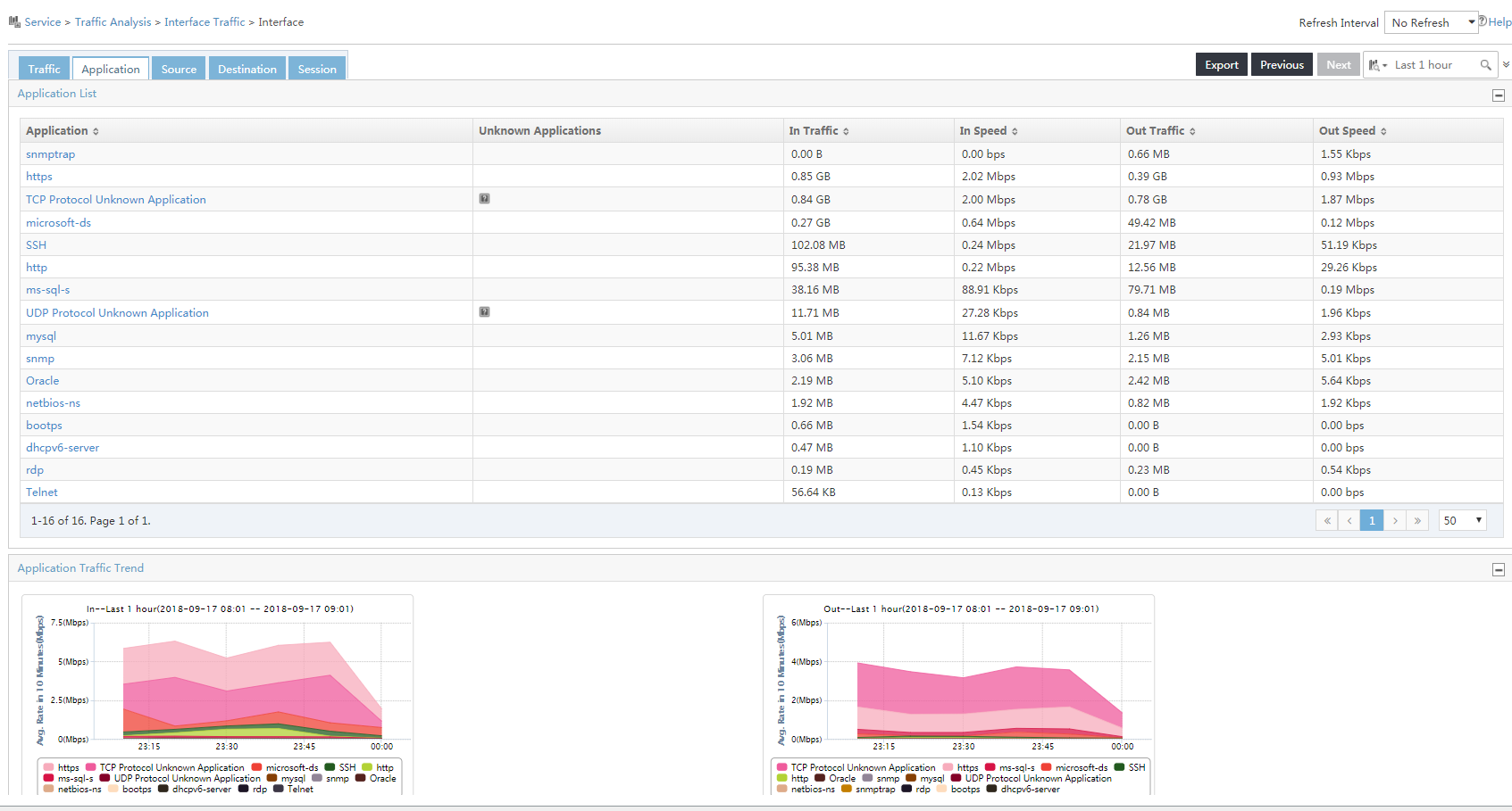

3.     To view the application usage reports of the task, click the Application tab.
Figure 7 Viewing the application usage reports of the task

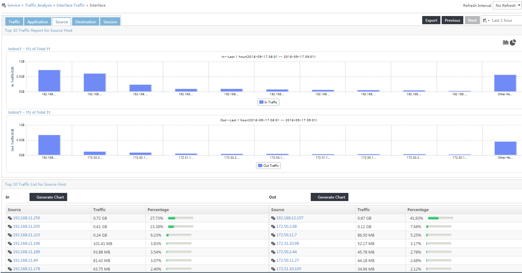

4.     To view the source host-based traffic analysis reports of the task, click the Source tab.
Figure 8 Viewing source host-based traffic analysis reports of the task

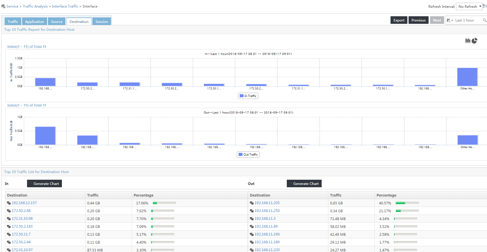

5.     To view the destination host-based traffic analysis reports of the task, click the Destination tab.
Figure 9 Viewing destination host-based traffic analysis reports of the task

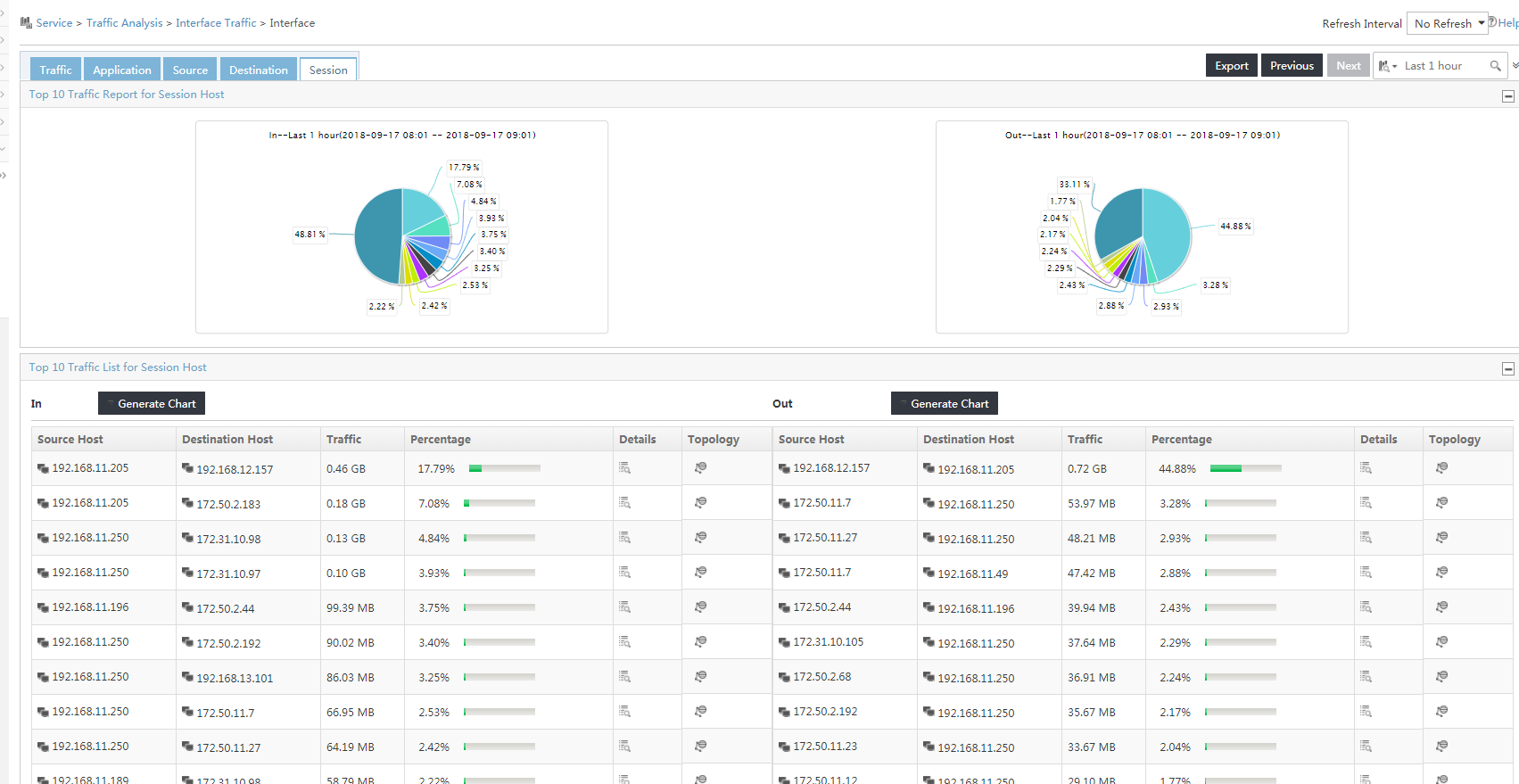

6.     To view the session-based traffic analysis reports of the task, click the Session tab.
Figure 10 Viewing session-based traffic analysis reports of the task
