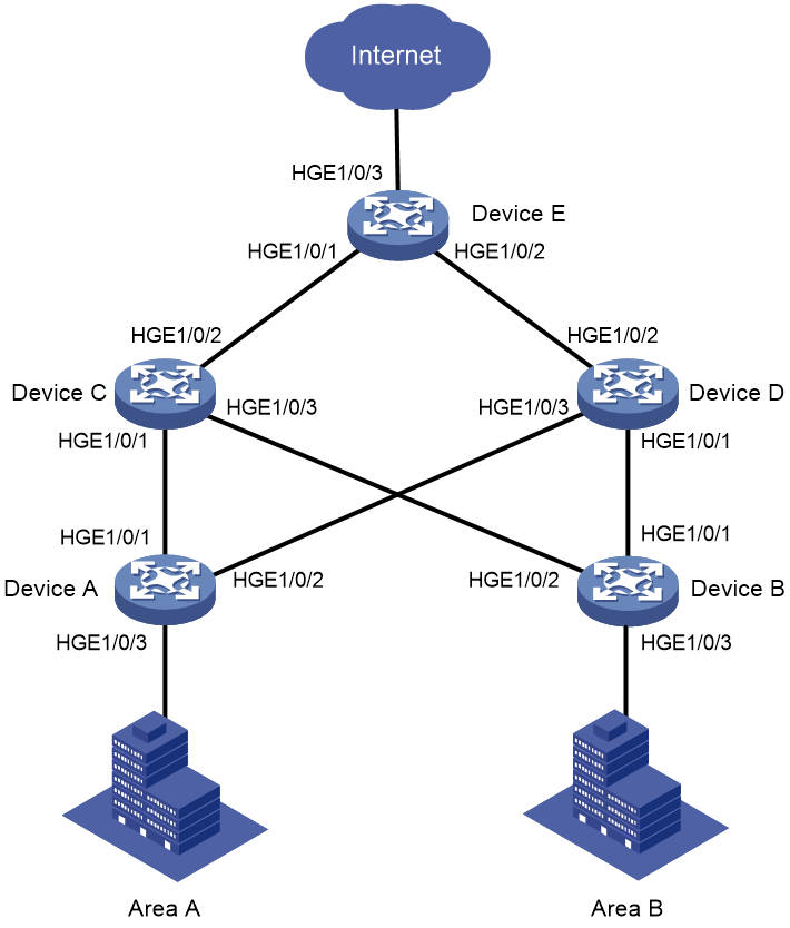

Example: Configuring Smart Link load sharing
As shown in Figure 1, VLAN 10 and VLAN 11 are assigned to the Finance department and the Marketing department of an enterprise, respectively. Traffic of VLAN 10 and VLAN 11 on Device A is dually uplinked to Device D by Device B and Device C. Configure Smart Link to meet the following requirements:
·     When the link between Device A and Device B and the link between Device A and Device C are both available, the traffic of the Finance department is forwarded trough the link between Device A and Device B. The traffic of the Marketing department is forwarded through the link between Device A and Device C.
·     When one link fails, the traffic on the link is switched to another link. When the link recovers, the traffic is switched back to the link.
Figure 1 Network diagram
Device
Interface
VLAN
Device
Interface
VLAN
Device A
HGE1/0/1
10, 11
Device C
HGE1/0/1
10, 11
HGE1/0/2
10, 11
HGE1/0/2
10, 11
HGE1/0/3
10
Device D
HGE1/0/1
10, 11
HGE1/0/4
11
HGE1/0/2
10, 11
Device B
HGE1/0/1
10, 11
HGE1/0/3
10, 11
HGE1/0/2
10, 11
Analysis
To implement load sharing on the two uplinks, create two smart link groups with the same member ports on Device A. The role of each port must be different in the two smart link groups. Use the VLANs of the Finance department and Marketing department as the protected VLANs of the corresponding smart link groups.
For the traffic to switch back to the recovered link, enable role preemption for the two smart link groups.
For the upstream device to refresh MAC address entries and ARP/ND entries when link switchover occurs in a smart link group, perform the following tasks:
·     Enable flush message sending on Device A.
·     Enable flush message receiving on ports of the primary and secondary links from Device A to Device D.

1.     Verify the smart link group configuration when Device A is operating correctly:
# Display information about all smart link groups on Device A.
[DeviceA] display smart-link group all
Smart link group 1 information:
  Device ID       : 0000-fc00-2500
  Preemption mode : Role
  Preemption delay: 10(s)
  Control VLAN    : 10
  Protected VLAN  : Reference Instance 1
  Member                  Role      State   Flush-count     Last-flush-time
  HGE1/0/1                PRIMARY   ACTIVE  0               NA
  HGE1/0/2                SECONDARY STANDBY 2               16:22:40 2014/12/29
Smart link group 2 information:
  Control VLAN    : 11
  Protected VLAN  : Reference Instance 2
  HGE1/0/2                PRIMARY   ACTIVE  2               16:22:40 2014/12/29
  HGE1/0/1                SECONDARY STANDBY 0               NA
The output shows the following information:
¡     In smart link group 1, the primary port HundredGigE 1/0/1 is active to transmit traffic from VLAN 10.
¡     In smart link group 2, the primary port HundredGigE 1/0/2 is active to transmit traffic from VLAN 11.
2.     Verify the smart link group configuration when HundredGigE 1/0/1 on Device A is down:
  Control VLAN    : 10
  HGE1/0/1                PRIMARY   DOWN    0               NA
  HGE1/0/2                SECONDARY ACTIVE  3               16:43:06 2014/12/29
  Control VLAN    : 11
  HGE1/0/1                SECONDARY DOWN    0               NA
¡     In smart link group 1, the secondary port HundredGigE 1/0/2 is active to transmit traffic from VLAN 10.
¡     In smart link group 2, the primary port HundredGigE 1/0/2 remains active to transmit traffic from VLAN 11.
# Display information about the received flush messages on Device B.
[DeviceB] display smart-link flush
 Received flush packets                       : 1
 Receiving interface of the last flush packet : HundredGigE1/0/2
 Receiving time of the last flush packet      : 16:43:08 2014/10/29
 Device ID of the last flush packet           : 0000-fc00-2500
 Control VLAN of the last flush packet        : 10

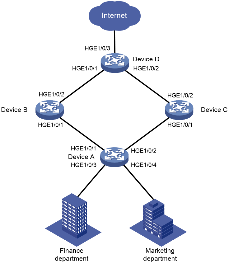

Example: Configuring Smart Link and Monitor Link collaboration
As shown in Figure 2, VLAN 10 and VLAN 11 are assigned to Zone A and Zone B, respectively. Traffic of VLAN 10 is dually uplinked from Device A to Device E by Device C and Device D. Traffic of VLAN 11 is dually uplinked from Device B to Device E by Device C and Device D. Configure Smart Link and Monitor Link to meet the following requirements:
·     When the link between Device A and Device C and the link between Device A and Device D are both available, the traffic of Zone A is forwarded trough the link between Device A and Device C. When the link between Device A and Device C fails, the traffic is switched to the link between Device A and Device D. When the link between Device A and Device C recovers, the traffic switches back to the link.
·     When the link between Device B and Device C and the link between Device B and Device D are both available, the traffic of Zone B is forwarded trough the link between Device B and Device D. When the link between Device B and Device D fails, the traffic is switched to the link between Device B and Device C. When the link between Device B and Device D recovers, the traffic switches back to the link.
·     Configure Monitor Link on Device C and Device D to associate the state of downlink interfaces with the state of uplink interfaces. When Monitor link shuts down the downlink interfaces because of an uplink failure, Smart Link triggers a link switchover.
Figure 2 Network diagram
Device
Interface
VLAN
Device
Interface
VLAN
Device A
HGE1/0/1
10
Device D
HGE1/0/1
11
HGE1/0/2
10
HGE1/0/2
10, 11
HGE1/0/3
10
HGE1/0/3
10
Device B
HGE1/0/1
11
Device E
HGE1/0/1
10, 11
HGE1/0/2
11
HGE1/0/2
10, 11
HGE1/0/3
11
HGE1/0/3
10, 11
Device C
HGE1/0/1
10
HGE1/0/2
10, 11
HGE1/0/3
11
Analysis
To implement dual uplink backup on Device A and Device B, perform the following tasks:
·     Create a smart link group on Device A and Device B, respectively.
·     Configure the VLANs of Zone A and Zone B as the protected VLANs of the corresponding smart link groups.
For the upstream device to refresh MAC address forwarding entries and ARP/ND entries when link switchover occurs in a smart link group, perform the following tasks:
·     Enable flush message sending on Device A and Device B.
·     Enable flush message receiving on the downlink ports on Device C and Device D.

6.     Configure smart link group 1.
# Create smart link group 1 and configure the VLAN mapped to MSTI 1, VLAN 11, as the protected VLAN.
[DeviceB] smart-link group 1
[DeviceB-smlk-group1] protected-vlan reference-instance 1
# Configure HundredGigE 1/0/1 as the primary port and HundredGigE 1/0/2 as the secondary port.
[DeviceB-smlk-group1] port hundredgige 1/0/1 primary
[DeviceB-smlk-group1] port hundredgige 1/0/2 secondary
# Enable flush message sending, and configure VLAN 11 as the transmit control VLAN.
[DeviceA-smlk-group1] flush enable control-vlan 11
# Enable role preemption and set the preemption delay to 10 seconds.
[DeviceB-smlk-group1] preemption mode role
[DeviceB-smlk-group1] preemption delay 10
[DeviceB-smlk-group1] quit
7.     Bring up HundredGigE 1/0/1 and HundredGigE 1/0/2:
[DeviceB] interface hundredgige 1/0/1
[DeviceB-HundredGigE1/0/1] undo shutdown
[DeviceB-HundredGigE1/0/1] quit
[DeviceB] interface hundredgige 1/0/2
[DeviceB-HundredGigE1/0/2] undo shutdown
[DeviceB-HundredGigE1/0/2] quit
Configuring Device C
1.     Create VLAN 10 and VLAN 11.
<DeviceC> system-view
[DeviceC] vlan 10 to 11
2.     Configure HundredGigE 1/0/1:
# Configure HundredGigE 1/0/1 as a trunk port.
[DeviceC] interface hundredgige 1/0/1
[DeviceC-HundredGigE1/0/1] port link-type trunk
# Assign the port to VLAN 10.
[DeviceC-HundredGigE1/0/1] port trunk permit vlan 10
# Remove the port from VLAN 1.
[DeviceC-HundredGigE1/0/1] undo port trunk permit vlan 1
# Disable the spanning tree feature on the port.
[DeviceC-HundredGigE1/0/1] undo stp enable
# Enable flush message receiving and configure VLAN 10 as the receive control VLAN on the port.
[DeviceC-HundredGigE1/0/1] smart-link flush enable control-vlan 10
# Bring up the port.
[DeviceC-HundredGigE1/0/1] undo shutdown
[DeviceC-HundredGigE1/0/1] quit
3.     Configure HundredGigE 1/0/2:
# Configure HundredGigE 1/0/2 as a trunk port.
[DeviceC] interface hundredgige 1/0/2
[DeviceC-HundredGigE1/0/2] port link-type trunk
# Assign the port to VLAN 10 and VLAN 11.
[DeviceC-HundredGigE1/0/2] port trunk permit vlan 10 11
[DeviceC-HundredGigE1/0/2] undo port trunk permit vlan 1
# Enable flush message receiving and configure VLAN 10 and VLAN 11 as the receive control VLANs on the port.
[DeviceC-HundredGigE1/0/2] smart-link flush enable control-vlan 10 11
[DeviceC-HundredGigE1/0/2] undo shutdown
[DeviceC-HundredGigE1/0/2] quit
4.     Configure HundredGigE 1/0/3:
# Configure HundredGigE 1/0/3 as a trunk port.
[DeviceC] interface hundredgige 1/0/3
[DeviceC-HundredGigE1/0/3] port link-type trunk
# Assign the port to VLAN 11.
[DeviceC-HundredGigE1/0/3] port trunk permit vlan 11
[DeviceC-HundredGigE1/0/3] undo port trunk permit vlan 1
[DeviceC-HundredGigE1/0/3] undo stp enable
# Enable flush message receiving and configure VLAN 11 as the receive control VLAN on the port.
[DeviceC-HundredGigE1/0/3] smart-link flush enable control-vlan 11
[DeviceB-HundredGigE1/0/3] undo shutdown
[DeviceB-HundredGigE1/0/3] quit
5.     Configure monitor link group 1:
# Create monitor link group 1.
[DeviceC] monitor-link group 1
# Configure the uplink interface threshold for triggering monitor link group state switchover as 1.
[DeviceC-mtlk-group1] uplink up-port-threshold 1
# Configure HundredGigE 1/0/2 as the uplink port and HundredGigE 1/0/1 and HundredGigE 1/0/3 as the downlink ports.
[DeviceC-mtlk-group1] port hundredgige 1/0/2 uplink
[DeviceC-mtlk-group1] port hundredgige 1/0/1 downlink
[DeviceC-mtlk-group1] port hundredgige 1/0/3 downlink
[DeviceC-mtlk-group1] quit
Configuring Device D
<DeviceD> system-view
[DeviceD] vlan 10 to 11
[DeviceD] interface hundredgige 1/0/1
[DeviceD-HundredGigE1/0/1] port link-type trunk
[DeviceD-HundredGigE1/0/1] port trunk permit vlan 11
[DeviceD-HundredGigE1/0/1] undo port trunk permit vlan 1
[DeviceD-HundredGigE1/0/1] undo stp enable
[DeviceD-HundredGigE1/0/1] smart-link flush enable control-vlan 11
[DeviceD-HundredGigE1/0/1] undo shutdown
[DeviceD-HundredGigE1/0/1] quit
[DeviceD] interface hundredgige 1/0/2
[DeviceD-HundredGigE1/0/2] port link-type trunk
[DeviceD-HundredGigE1/0/2] port trunk permit vlan 10 11
[DeviceD-HundredGigE1/0/2] undo port trunk permit vlan 1
[DeviceD-HundredGigE1/0/2] smart-link flush enable control-vlan 10 11
[DeviceD-HundredGigE1/0/2] undo shutdown
[DeviceD-HundredGigE1/0/2] quit
[DeviceD] interface hundredgige 1/0/3
[DeviceD-HundredGigE1/0/3] port link-type trunk
[DeviceD-HundredGigE1/0/3] port trunk permit vlan 10
[DeviceD-HundredGigE1/0/3] undo port trunk permit vlan 1
[DeviceD-HundredGigE1/0/3] undo stp enable
[DeviceD-HundredGigE1/0/3] smart-link flush enable control-vlan 10
[DeviceD-HundredGigE1/0/3] undo shutdown
[DeviceD-HundredGigE1/0/3] quit
[DeviceD] monitor-link group 1
[DeviceD-mtlk-group1] uplink up-port-threshold 1
[DeviceD-mtlk-group1] port hundredgige 1/0/2 uplink
[DeviceD-mtlk-group1] port hundredgige 1/0/1 downlink
[DeviceD-mtlk-group1] port hundredgige 1/0/3 downlink
[DeviceD-mtlk-group1] quit
Configuring Device E
<DeviceE> system-view
[DeviceE] vlan 10 to 11
[DeviceE] interface hundredgige 1/0/1
[DeviceE-HundredGigE1/0/1] port link-type trunk
[DeviceE-HundredGigE1/0/1] port trunk permit vlan 10 11
[DeviceE-HundredGigE1/0/1] undo port trunk permit vlan 1
[DeviceE-HundredGigE1/0/1] smart-link flush enable control-vlan 10 11
[DeviceE-HundredGigE1/0/1] undo shutdown
[DeviceE-HundredGigE1/0/1] quit
3.     Configure HundredGigE 1/0/2 in the same way HundredGigE 1/0/1 is configured.
[DeviceE] interface hundredgige 1/0/2
[DeviceE-HundredGigE1/0/2] port link-type trunk
[DeviceE-HundredGigE1/0/2] port trunk permit vlan 10 11
[DeviceE-HundredGigE1/0/2] undo port trunk permit vlan 1
[DeviceE-HundredGigE1/0/2] smart-link flush enable control-vlan 10 11
[DeviceE-HundredGigE1/0/2] undo shutdown
[DeviceE-HundredGigE1/0/2] quit
[DeviceE] interface hundredgige 1/0/3
[DeviceE-HundredGigE1/0/3] port link-type trunk
[DeviceE-HundredGigE1/0/3] port trunk permit vlan 10 11
[DeviceE-HundredGigE1/0/3] undo port trunk permit vlan 1
[DeviceE-HundredGigE1/0/3] undo shutdown
[DeviceE-HundredGigE1/0/3] quit
1.     Verify the smart link group configuration when Device A and Device B are operating correctly:
  Control VLAN    : 10
  HGE1/0/1                PRIMARY   ACTIVE  1               17:37:49 2014/12/29
  HGE1/0/2                SECONDARY STANDBY 3               17:43:06 2014/12/29
The output shows that in smart link group 1, the primary port HundredGigE 1/0/1 is active to transmit traffic from VLAN 10.
# Display information about all smart link groups on Device B.
[DeviceB] display smart-link group all
  Device ID       : 0000-fc01-2501
  Control VLAN    : 11
  HGE1/0/1                PRIMARY   ACTIVE  2               17:22:40 2014/12/29
  HGE1/0/2                SECONDARY STANDBY 0               NA
The output shows that in smart link group 1, the primary port HundredGigE 1/0/1 is active to transmit traffic from VLAN 11.
2.     Verify the monitor link group configuration when Device C and Device D are operating correctly:
# Display information about all monitor link groups on Device C.
[DeviceC] display monitor-link group all
Monitor link group 1 information:
  Group status     : UP
  Downlink up-delay: 0(s)
  Last-up-time     : 17:07:26 2014/12/29
  Last-down-time   : -
  Up-port-threshold: 1
  Member                    Role       Status
  HGE1/0/2                  UPLINK     UP
  HGE1/0/1                  DOWNLINK   UP
  HGE1/0/3                  DOWNLINK   UP
The output shows that in monitor link group 1, the uplink port HundredGigE 1/0/2 is up, and the downlink ports HundredGigE 1/0/1 and HundredGigE 1/0/3 are up.
# Display information about all monitor link groups on Device D.
[DeviceD] display monitor-link group all
  Group status     : UP
  Last-up-time     : 17:09:33 2014/12/29
  Last-down-time   : -
  Member                    Role       Status
  HGE1/0/2                  UPLINK     UP
3.     Verify the smart link group configuration when HundredGigE 1/0/1 on Device A is down:
  Control VLAN    : 10
  HGE1/0/1                PRIMARY   DOWN    1               17:37:49 2014/12/29
  HGE1/0/2                SECONDARY ACTIVE  4               17:49:06 2014/12/29
The output shows that in smart link group 1, the secondary port HundredGigE 1/0/2 is active to transmit traffic from VLAN 10.
# Display information about the received flush messages on Device C.
[DeviceC] display smart-link flush
 Receiving time of the last flush packet      : 17:49:08 2014/12/29
4.     Verify the monitor link group configuration when the uplink port HundredGigE 1/0/2 on Device C is down:
  Group status     : DOWN
  Last-down-time   : 18:01:05 2014/12/29
  Member                    Role       Status
  HGE1/0/2                  UPLINK     DOWN
  HGE1/0/1                  DOWNLINK   DOWN
  HGE1/0/3                  DOWNLINK   DOWN
The output shows that monitor link group 1 is down, and the downlink ports HundredGigE 1/0/1 and HundredGigE 1/0/3 in monitor link group 1 are down.
  Group status     : UP
  Last-down-time   : -
  Member                    Role       Status
  HGE1/0/2                  UPLINK     UP
The output shows that monitor link group 1 is up, and the downlink ports HundredGigE 1/0/1 and HundredGigE 1/0/3 in monitor link group 1 are up.
  Control VLAN    : 10

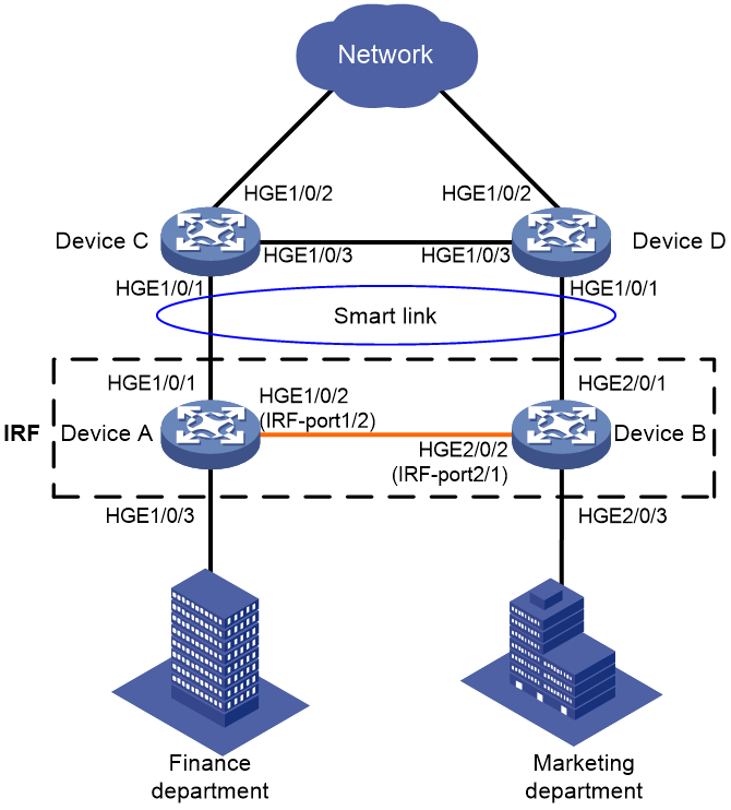

Example: Configuring Smart Link in an IRF fabric
As shown in Figure 3, the Finance department in VLAN 10 and the Marketing department in VLAN 11 are connected to Device A and Device B, respectively. Device A and Device B form an IRF fabric and are connected to Device C and Device D.
·     When the uplinks of Device A and Device B are available, traffic is forwarded through the link between Device A and Device C.
·     When the link between Device A and Device C fails, the traffic switches to another link.
·     When the link recovers, the traffic is switched back to the link.
Figure 3 Network diagram
Device
Interface
VLAN
Device
Interface
Device
Device A
HGE1/0/1
10, 11
Device B
HGE2/0/1
10, 11
HGE1/0/3
10
HGE2/0/3
11
Device C
HGE1/0/1
10, 11
Device D
HGE1/0/1
10, 11
HGE1/0/2
10, 11
HGE1/0/2
10, 11
Analysis
To implement dual uplink redundancy on Device A and Device B, configure a smart link group for the IRF fabric formed by Device A and Device B.
·     Enable flush message receiving on HundredGigE 1/0/1 on Device C and Device D.
