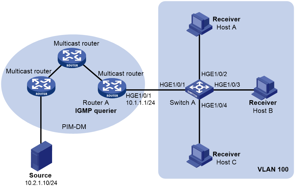

Example: Configuring multicast group policies
As shown in Figure 1:
·     Router A runs IGMP and acts as the IGMP querier.
·     Switch A runs IGMP snooping.
Configure multicast group policies on Switch A to meet the following requirements:
·     Host A receives only the multicast data addressed to multicast group 224.1.1.1.
·     Host B and Host C receive only the multicast data addressed to multicast group 225.1.1.1.
Figure 1 Network diagram
Analysis
To meet the network requirements, you must perform the following tasks:
·     IGMPv2 snooping cannot process IGMPv3 messages. It floods IGMPv3 messages in the VLAN to which the IGMPv3 messages belong. To avoid this problem, specify IGMP snooping version 3 for VLAN 100.
·     To avoid receiver hosts in VLAN 100 from receiving multicast data addressed to other groups, enable dropping unknown multicast data in VLAN 100.
·     To configure multicast group policies, specify a basic ACL and create ACL rules to define the groups that you want the receiver hosts to join.

1.     Assign an IP address and subnet mask to each interface on the routers in the PIM-DM domain. (Details not shown.)
2.     Configure a unicast routing protocol on the routers in the PIM-DM domain. (Details not shown.)
3.     Enable multicast routing globally on the routers in the PIM-DM domain. (Details not shown.)
4.     Enable PIM-DM for the interfaces through which routers connects with each other on the routers in the PIM-DM domain. (Details not shown.)
5.     Configure Router A:
# Enable IP multicast routing globally.
<RouterA> system-view
[RouterA] multicast routing
[RouterA-mrib] quit
# Enable IGMPv3 on HundredGigE 1/0/1.
[RouterA] interface hundredgige 1/0/1
[RouterA-HundredGigE1/0/1] igmp enable
[RouterA-HundredGigE1/0/1] igmp version 3
[RouterA-HundredGigE1/0/1] quit
6.     Configure Switch A:
# Enable IGMP snooping globally.
<SwitchA> system-view
[SwitchA] igmp-snooping
[SwitchA-igmp-snooping] quit
# Create VLAN 100, and assign HundredGigE 1/0/1 through HundredGigE 1/0/4 to VLAN 100.
[SwitchA] vlan 100
[SwitchA-vlan100] port hundredgige 1/0/1 to hundredgige 1/0/4
# Enable IGMPv3 snooping and enable dropping unknown multicast data for VLAN 100.
[SwitchA-vlan100] igmp-snooping enable
[SwitchA-vlan100] igmp-snooping version 3
[SwitchA-vlan100] igmp-snooping drop-unknown
[SwitchA-vlan100] quit
# Configure a multicast group policy for VLAN 100 on HundredGigE 1/0/2 so that Host A can join only multicast group 224.1.1.1.
[SwitchA] acl basic 2000
[SwitchA-acl-ipv4-basic-2000] rule permit source 224.1.1.1 0
[SwitchA-acl-ipv4-basic-2000] quit
[SwitchA] interface hundredgige 1/0/2
[SwitchA-HundredGigE1/0/2] igmp-snooping group-policy 2000 vlan 100
[SwitchA-HundredGigE1/0/2] quit
# Configure a multicast group policy globally for VLAN 100 so that Host B and Host C can join only multicast group 225.1.1.1.
[SwitchA] acl basic 2001
[SwitchA-acl-ipv4-basic-2001] rule permit source 225.1.1.1 0
[SwitchA-acl-ipv4-basic-2001] quit
[SwitchA-igmp-snooping] group-policy 2001 vlan 100
# Send IGMP reports from Host A, Host B, and Host C to join multicast groups 224.1.1.1, 224.2.2.2, and 225.1.1.1. (Details not shown.)
# Send multicast data from the source to the multicast groups. (Details not shown.)
# Display dynamic IGMP snooping group entries for VLAN 100 on Switch A.
[SwitchA] display igmp-snooping group vlan 100
Total 2 entries.
VLAN 100: Total 2 entries.
  (0.0.0.0, 224.1.1.1)
    Host ports (1 in total):
      HGE1/0/2                                     (00:03:09)
  (0.0.0.0, 225.1.1.1)
    Host ports (2 in total):
      HGE1/0/3                                     (00:04:04)
      HGE1/0/4                                     (00:02:38)
The output shows the following information:
·     Host A has joined multicast group 224.1.1.1 through HundredGigE 1/0/2, and it has not joined multicast groups 224.2.2.2 and 225.1.1.1.
·     Host B and Host C have joined multicast group 225.1.1.1 through HundredGigE 1/0/3 and HundredGigE 1/0/4, respectively. They have not joined multicast groups 224.1.1.1 and 224.2.2.2.
·     Multicast group policies have taken effect.

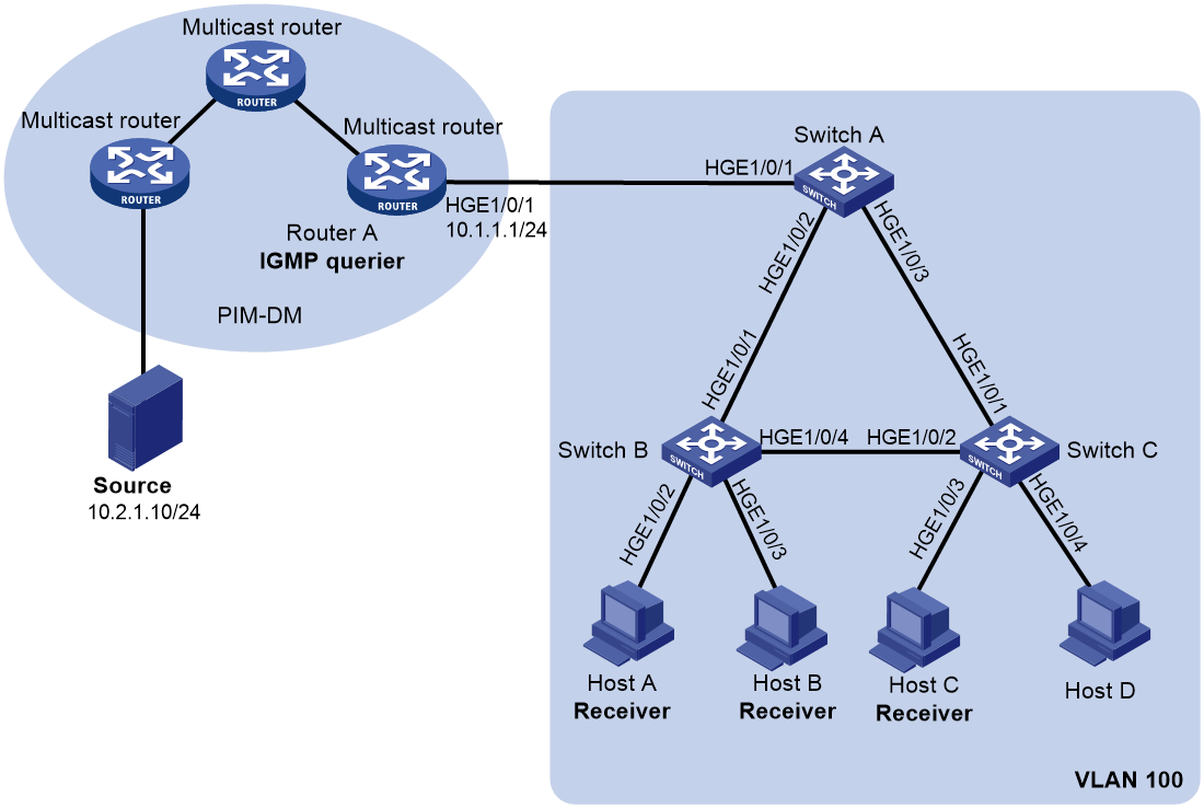

Example: Configuring IGMP snooping static ports
As shown in Figure 2:
·     All switches in VLAN 100 run IGMP snooping.
·     Router A runs IGMPv2 and acts as the IGMP querier.
·     STP runs in VLAN 100. The direct route between Switch A and Switch B or the route from Switch A to Switch B with Switch C as the intermediate device is blocked to avoid loops.
Configure IGMP snooping static ports to meet the following requirements:
·     Multicast data uninterruptedly flows to the receiver hosts after a link switchover occurs between Switch A and Switch B.
·     Host A, Host B, and Host C permanently receive the multicast data addressed to multicast group 224.1.1.1.
Figure 2 Network diagram
Analysis
·     By default, when a link switchover occurs, multicast data can flow along the new link after a minimum of one IGMP query-response cycle. Multicast delivery is interrupted during this process.
Configure HundredGigE 1/0/2 and HundredGigE 1/0/3 on Switch A, HundredGigE 1/0/4 on Switch B, and HundredGigE 1/0/2 on Switch C as static router ports. Then, multicast data will be forwarded to these ports.
·     Configure HundredGigE 1/0/2 and HundredGigE 1/0/3 on Switch B, and HundredGigE 1/0/3 on Switch C as static member ports of multicast group 224.1.1.1. Then, multicast data for the group will always be forwarded out of these ports, and Host A, Host B, and Host C can always receive the data.

Procedures
2.     Configure OSPF on the routers in the PIM-DM domain. (Details not shown.)
4.     Enable PIM-DM for the interfaces through which routers connects with each other in the PIM-DM domain. (Details not shown.)
# Enable IP multicast routing.
[RouterA-mrib] quit
# Enable IGMP on HundredGigE 1/0/1.
# Create VLAN 100, assign HundredGigE 1/0/1 through HundredGigE 1/0/4 to this VLAN, and enable IGMP snooping for this VLAN.
[SwitchA] vlan 100
# Configure HundredGigE 1/0/2 and HundredGigE 1/0/3 as static router ports.
[SwitchA-HundredGigE1/0/2] igmp-snooping static-router-port vlan 100
[SwitchA] interface hundredgige 1/0/3
[SwitchA-HundredGigE1/0/3] igmp-snooping static-router-port vlan 100
[SwitchA-HundredGigE1/0/3] quit
7.     Configure Switch B:
<SwitchB> system-view
[SwitchB] igmp-snooping
[SwitchB-igmp-snooping] quit
# Create VLAN 100, assign HundredGigE 1/0/1 and HundredGigE 1/0/4 to this VLAN, and enable IGMP snooping for this VLAN.
[SwitchB] vlan 100
[SwitchB-vlan100] port hundredgige 1/0/1 hundredgige 1/0/4
[SwitchB-vlan100] igmp-snooping enable
[SwitchB-vlan100] quit
# Configure HundredGigE 1/0/4 as a static router port.
[SwitchB] interface hundredgige 1/0/4
[SwitchB-HundredGigE1/0/4] igmp-snooping static-router-port vlan 100
[SwitchB-HundredGigE1/0/4] quit
# Configure HundredGigE 1/0/2 and HundredGigE 1/0/3 as static member ports for multicast group 224.1.1.1 in VLAN 100.
[SwitchB] interface hundredgige 1/0/2
[SwitchB-HundredGigE1/0/2] igmp-snooping static-group 224.1.1.1 vlan 100
[SwitchB-HundredGigE1/0/2] quit
[SwitchB] interface hundredgige 1/0/3
[SwitchB-HundredGigE1/0/3] igmp-snooping static-group 224.1.1.1 vlan 100
[SwitchB-HundredGigE1/0/3] quit
8.     Configure Switch C:
<SwitchC> system-view
[SwitchC] igmp-snooping
[SwitchC-igmp-snooping] quit
[SwitchC] vlan 100
[SwitchC-vlan100] port hundredgige 1/0/1 to hundredgige 1/0/4
[SwitchC-vlan100] igmp-snooping enable
[SwitchC-vlan100] quit
# Configure HundredGigE 1/0/2 as a static router port in VLAN 100.
[SwitchC] interface hundredgige 1/0/2
[SwitchC-HundredGigE1/0/2] igmp-snooping static-router-port vlan 100
[SwitchC-HundredGigE1/0/2] quit
# Configure HundredGigE 1/0/3 as a static member port of multicast group 224.1.1.1 in VLAN 100.
[SwitchC] interface hundredgige 1/0/3
[SwitchC-HundredGigE1/0/3] igmp-snooping static-group 224.1.1.1 vlan 100
[SwitchC-HundredGigE1/0/3] quit
Verify the configuration before hosts join any multicast groups.
# Display static router port information for VLAN 100 on Switch A.
[SwitchA] display igmp-snooping static-router-port vlan 100
VLAN 100:
  Router ports (2 in total):
    HGE1/0/2
    HGE1/0/3
The output shows that HundredGigE 1/0/2 and HundredGigE 1/0/3 on Switch A have become static router ports in VLAN 100.
# Display static router port information for VLAN 100 on Switch B.
[SwitchB] display igmp-snooping static-router-port vlan 100
VLAN 100:
  Router ports (1 in total):
    HGE1/0/4
The output shows that HundredGigE 1/0/4 on Switch B has become a static router port in VLAN 100.
# Display static IGMP snooping group entries for VLAN 100 on Switch B.
[SwitchB] display igmp-snooping static-group vlan 100
Total 1 entries.
VLAN 100: Total 1 entries.
      HGE1/0/2
      HGE1/0/3
The output shows that HundredGigE 1/0/2 and HundredGigE 1/0/3 on Switch B have become static member ports of multicast group 224.1.1.1 in VLAN 100.
# Display static router port information for VLAN 100 on Switch C.
[SwitchC] display igmp-snooping static-router-port vlan 100
VLAN 100:
    HGE1/0/2
The output shows that HundredGigE 1/0/2 on Switch C has become a static router port in VLAN 100.
# Display static IGMP snooping group entries for VLAN 100 on Switch C.
[SwitchC] display igmp-snooping static-group vlan 100
Total 1 entries.
      HGE1/0/3
The output shows that HundredGigE 1/0/3 on Switch C has become a static group member of multicast group 224.1.1.1.
Configuration files
·     Router A:
interface HundredGigE1/0/1
 port link-mode route
 igmp enable
multicast routing
·     Switch A:
igmp-snooping
vlan 100
 port link-mode bridge
 port access vlan 100
interface HundredGigE1/0/2
interface HundredGigE1/0/3
·     Switch B:
igmp-snooping
vlan 100
interface HundredGigE1/0/4
·     Switch C:
igmp-snooping
vlan 100
Related documentation
Use this document in conjunction with the following documents for the product and software version you are working with:
·     IP Multicast Configuration Guide
·     IP Multicast Command Reference
