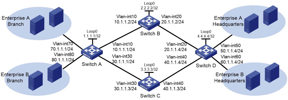

Example: Establishing MPLS TE tunnels with RSVP-TE
As shown in Figure 1, use RSVP-TE to establish two MPLS TE tunnels between Switch A and Switch D. The MPLS TE tunnel for Enterprise A requires a bandwidth of 20000 kbps. The MPLS TE tunnel for Enterprise B requires a bandwidth of 30000 kbps.
The maximum bandwidth of the link that each tunnel traverses is 50000 kbps and the maximum reservable bandwidth is 40000 kbps.
Figure 1 Network diagram
Analysis
To establish MPLS TE tunnels through RSVP-TE, you must perform the following tasks:
·     Enable MPLS, MPLS TE, and RSVP-TE on nodes that the MPLS TE tunnels traverse.
·     On each interface that the MPLS TE tunnels traverse, configure link TE attributes, including the maximum link bandwidth and the maximum reservable bandwidth.
·     On each node that the MPLS TE tunnels traverse, configure the IGP TE extension to advertise the link TE attributes, which generates a TEDB on each node.
Based on the TEDB, CSPF calculates the shortest, TE constraints-compliant path to the tunnel destination. If you do not configure the IGP TE extension, the path is created based on IGP routing. The supported IGP TE extensions are OSPF TE and ISIS TE. This example uses OSPF TE.
·     Create a tunnel interface on the ingress node of each MPLS TE tunnel, and perform the following tasks on the tunnel interface:
¡     Specify the tunnel destination address.
¡     Specify the tunnel bandwidth as required (20000 kbps for Enterprise A and 30000 kbps for Enterprise B).
¡     Specify the MPLS TE signaling protocol as RSVP-TE.
RSVP-TE advertises labels to establish CRLSPs and reserves bandwidth resources on each node along the calculated path.
·     On the ingress node of each MPLS TE tunnel, configure static routing to direct traffic to the MPLS TE tunnel.

6.     Configure MPLS TE tunnels on Switch A:
# Configure MPLS TE tunnel interface Tunnel 1 to forward traffic of Enterprise A.
[SwitchA] interface tunnel 1 mode mpls-te
[SwitchA-Tunnel1] ip address 7.1.1.1 255.255.255.0
# Specify the tunnel destination address as the LSR ID of Switch D, use RSVP-TE to establish the tunnel, and assign 20000 kbps bandwidth to the tunnel.
[SwitchA-Tunnel1] destination 4.4.4.4
[SwitchA-Tunnel1] mpls te signaling rsvp-te
[SwitchA-Tunnel1] mpls te bandwidth 20000
# Enable route recording for MPLS TE tunnel 1.
[SwitchA-Tunnel1] mpls te record-route
[SwitchA-Tunnel1] quit
# Configure MPLS TE tunnel interface Tunnel 2 to forward traffic of Enterprise B.
[SwitchA] interface tunnel 2 mode mpls-te
[SwitchA-Tunnel2] ip address 8.1.1.1 255.255.255.0
# Specify the tunnel destination address as the LSR ID of Switch D, use RSVP-TE to establish the tunnel, and assign 30000 kbps bandwidth to the tunnel.
[SwitchA-Tunnel2] destination 4.4.4.4
[SwitchA-Tunnel2] mpls te signaling rsvp-te
[SwitchA-Tunnel2] mpls te bandwidth 30000
# Enable route recording for MPLS TE tunnel 2.
[SwitchA-Tunnel2] mpls te record-route
[SwitchA-Tunnel2] quit
7.     Configure static routing on Switch A to direct traffic to the MPLS TE tunnels:
# Configure a static route to direct traffic destined for 50.1.1.0/24 to MPLS TE tunnel interface Tunnel 1.
[SwitchA] ip route-static 50.1.1.0 24 tunnel 1 preference 1
# Configure a static route to direct traffic destined for 60.1.1.0/24 to MPLS TE tunnel interface Tunnel 2.
[SwitchA] ip route-static 60.1.1.0 24 tunnel 2 preference 1
# Execute the display interface tunnel brief command on Switch A. The output shows that the two tunnel interfaces are up.
[SwitchA] display interface tunnel brief
Brief information on interfaces in route mode:
Link: ADM - administratively down; Stby - standby
Protocol: (s) - spoofing
Interface            Link Protocol Primary IP      Description
Tun1                 UP   UP       7.1.1.1
Tun2                 UP   UP       8.1.1.1

# Execute the display ip routing-table command on Switch A. The output shows two static route entries with output interfaces of Tunnel 1 and Tunnel 2.
[SwitchA] display ip routing-table
Destinations : 28        Routes : 29
Destination/Mask    Proto   Pre  Cost         NextHop         Interface
0.0.0.0/32          Direct  0    0            127.0.0.1       InLoop0
1.1.1.1/32          Direct  0    0            127.0.0.1       InLoop0
2.2.2.2/32          O_INTRA 10   1            10.1.1.2        Vlan10
3.3.3.3/32          O_INTRA 10   1            30.1.1.3        Vlan30
4.4.4.4/32          O_INTRA 10   2            10.1.1.2        Vlan10
                                             30.1.1.3        Vlan30
7.1.1.0/24          Direct  0    0            7.1.1.1         Tun1
7.1.1.0/32          Direct  0    0            7.1.1.1         Tun1
7.1.1.1/32          Direct  0    0            127.0.0.1       InLoop0
7.1.1.255/32        Direct  0    0            7.1.1.1         Tun1
8.1.1.0/24          Direct  0    0            8.1.1.1         Tun2
8.1.1.0/32          Direct  0    0            8.1.1.1         Tun2
8.1.1.1/32          Direct  0    0            127.0.0.1       InLoop0
8.1.1.255/32        Direct  0    0            8.1.1.1         Tun2
10.1.1.0/24         Direct  0    0            10.1.1.1        Vlan10
10.1.1.0/32         Direct  0    0            10.1.1.1        Vlan10
10.1.1.1/32         Direct  0    0            127.0.0.1       InLoop0
10.1.1.255/32       Direct  0    0            10.1.1.1        Vlan10
50.1.1.0/24         Static  1    0            0.0.0.0         Tun1
30.1.1.0/24         Direct  0    0            30.1.1.1        Vlan30
30.1.1.0/32         Direct  0    0            30.1.1.1        Vlan30
30.1.1.1/32         Direct  0    0            127.0.0.1       InLoop0
30.1.1.255/32       Direct  0    0            30.1.1.1        Vlan30
60.1.1.0/24         Static  1    0            0.0.0.0         Tun2
127.0.0.0/8         Direct  0    0            127.0.0.1       InLoop0
127.0.0.0/32        Direct  0    0            127.0.0.1       InLoop0
127.0.0.1/32        Direct  0    0            127.0.0.1       InLoop0
127.255.255.255/32  Direct  0    0            127.0.0.1       InLoop0
255.255.255.255/32  Direct  0    0            127.0.0.1       InLoop0
# Execute the display rsvp lsp verbose command on Switch A to verify the following information:
·     Tunnel 1 uses path Switch A—Switch B—Switch D, and has a bandwidth of 20000 kbps.
·     Tunnel 2 uses path Switch A—Switch C—Switch D, and has a bandwidth of 30000 kbps.
[SwitchA] display rsvp lsp verbose
Tunnel name: SwitchA_t1
Destination: 4.4.4.4                      Source: 1.1.1.1
Tunnel ID: 1                              LSP ID: 27415
LSR type: Ingress                         Direction: Unidirectional
Setup priority: 7                         Holding priority: 7
In-Label: -                               Out-Label: 1146
In-Interface: -                           Out-Interface: Vlan10
Nexthop: 10.1.1.2                         Exclude-any: 0
Include-Any: 0                            Include-all: 0
Mean rate (CIR): 20000 kbps               Mean burst size (CBS): 1000.00 bytes
Path MTU: 1500                            Class type: CT0
RRO number: 6
  10.1.1.1/32        Flag: 0x00 (No FRR)
  10.1.1.2/32        Flag: 0x00 (No FRR)
  2.2.2.2/32         Flag: 0x20 (No FRR/Node-ID)
  20.1.1.2/32        Flag: 0x00 (No FRR)
  20.1.1.4/32        Flag: 0x00 (No FRR)
  4.4.4.4/32         Flag: 0x20 (No FRR/Node-ID)
Fast Reroute protection: None
Tunnel name: SwitchA_t2
Tunnel ID: 2                              LSP ID: 27302
In-Label: -                               Out-Label: 1150
In-Interface: -                           Out-Interface: Vlan30
Nexthop: 30.1.1.3                         Exclude-any: 0
Mean rate (CIR): 30000 kbps               Mean burst size (CBS): 1000.00 bytes
RRO number: 6
  30.1.1.1/32        Flag: 0x00 (No FRR)
  30.1.1.3/32        Flag: 0x00 (No FRR)
  3.3.3.3/32         Flag: 0x20 (No FRR/Node-ID)
  40.1.1.3/32        Flag: 0x00 (No FRR)
  40.1.1.4/32        Flag: 0x00 (No FRR)

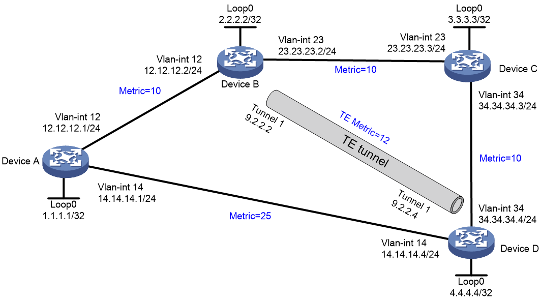

Example: Configuring MPLS TE forwarding adjacency
As shown in Figure 2, Device A, Device B, Device C, and Device D run OSPF.
Establish an MPLS TE tunnel from Device B to Device D that uses the path Device B—Device C—Device D, and configure MPLS TE forwarding adjacency for the tunnel.
Before the tunnel is established, traffic from Device A to Device D is forwarded through the direct link Device A—Device D. After the tunnel is established, the traffic is forwarded through the MPLS TE tunnel.
Figure 2 Network diagram
Analysis
·     Enable MPLS TE on nodes and interfaces that the MPLS TE tunnels traverse.
·     To make forwarding adjacency take effect, you must establish two MPLS TE tunnels in opposite directions between Device B and Device D, and enable forwarding adjacency on both devices.
·     For the MPLS TE tunnel to use the path Device B—Device C—Device D, configure the path as the explicit path for the tunnel.
·     For traffic from Device A to Device D to be forwarded through the MPLS TE tunnel, make sure the tunnel's metric is less than 15 (metric 25 minus 10). This example uses 12.

1.     Configure IP addresses for interfaces, configure basic OSPF, and set OSPF costs. (Details not shown.) For the configuration, see "Configuration files."
2.     Enable MPLS TE on each node and interface that the MPLS TE tunnel traverses:
# On Device B, configure an LSR ID, and enable MPLS, MPLS TE, and RSVP-TE.
<DeviceB> system-view
[DeviceB] mpls lsr-id 2.2.2.2
[DeviceB] mpls te
[DeviceB-te] quit
[DeviceB] rsvp
[DeviceB-rsvp] quit

4.     Configure MPLS TE tunnels:
# On Device B, configure MPLS TE tunnel interface Tunnel 1, and specify the tunnel destination address as the LSR ID of Device D.
[DeviceB] interface tunnel 1 mode mpls-te
[DeviceB-Tunnel1] ip address 9.2.2.2 255.255.255.0
[DeviceB-Tunnel1] destination 4.4.4.4
# Configure MPLS TE to use RSVP-TE to establish the tunnel.
[DeviceB-Tunnel1] mpls te signaling rsvp-te
[DeviceB-Tunnel1] quit
# Configure an explicit path named tun1.
[DeviceB] explicit-path tun1
[DeviceB-explicit-path-tun1] nexthop 23.23.23.3
[DeviceB-explicit-path-tun1] nexthop 34.34.34.4
[DeviceB-explicit-path-tun1]quit
# Specify explicit path tun1 for the tunnel.
[DeviceB–Tunnel1] mpls te path preference 1 explicit-path tun1
# Enable forwarding adjacency for the tunnel.
[DeviceB-Tunnel1] mpls te igp advertise
# Enable OSPF on tunnel interface Tunnel 1 and set the OSPF cost to 12 for the tunnel interface.
[DeviceB-Tunnel1] ospf 1 area 0
[DeviceB-Tunnel1] ospf cost 12
# On Device D, configure MPLS TE tunnel interface Tunnel 1, and specify the tunnel destination address as the LSR ID of Device B.
[DeviceD] interface tunnel 1 mode mpls-te
[DeviceD-Tunnel1] ip address 9.2.2.4  255.255.255.0
[DeviceD-Tunnel1] destination 2.2.2.2
[DeviceD-Tunnel1] mpls te signaling rsvp-te
[DeviceD-Tunnel1] quit
[DeviceD] explicit-path tun1
[DeviceD-explicit-path-tun1] nexthop 34.34.34.3
[DeviceD-explicit-path-tun1] nexthop 23.23.23.2
[DeviceD-explicit-path-tun1]quit
[DeviceD–Tunnel1] mpls te path preference 1 explicit-path tun1
[DeviceD-Tunnel1] mpls te igp advertise
[DeviceD-Tunnel1] ospf 1 area 0
[DeviceD-Tunnel1] ospf cost 12
# Execute the display interface tunnel brief command on Device B and Device D. This example uses Device B. The output shows that Tunnel 1 is up.
[DeviceB] display interface tunnel brief
