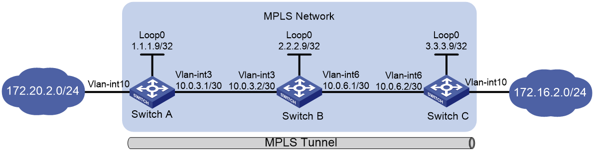

Example: Configuring static LSPs
As shown in Figure 1, establish static LSPs between Switch A and Switch C to allow communication between subnets 172.20.2.0/24 and 172.16.2.0/24 over the MPLS network.
Figure 1 Network diagram
Analysis
LSPs are unidirectional. To ensure that data can be bidirectionally forwarded, configure an LSP for each direction of the data forwarding path, and specify the ingress, transit, and egress nodes for each LSP.
To direct traffic to an LSP for MPLS forwarding, make sure the ingress node has a route to the FEC destination of the LSP. This example uses a static route. Route configuration is not needed on the transit and egress nodes.

When you configure a static LSP, follow these restrictions and guidelines:
·     Make sure the outgoing label specified on an LSR is the same as the incoming label specified on the directly connected downstream LSR.
·     If you configure a static IP route for the LSP, specify the same next hop or outgoing interface for the static route and the static LSP.
·     On the ingress or transit node of the static LSP, do not specify the public address of a local interface as the next hop address of the static LSP.
·     MPLS adds a label or multiple labels to packets. After MPLS is enabled on a VLAN interface, configure jumboframe support on the ports in the VLAN to avoid MPLS packet dropping when the packet size exceeds the interface MTU.
Procedures
1.     Configure IP addresses and masks for interfaces, including the loopback interfaces, as shown in Figure 1. (Details not shown.)
2.     Configure a static route to the destination address of each LSP:
# Configure a static route to the FEC destination of the LSP from Switch A to Switch C.
<SwitchA> system-view
[SwitchA] ip route-static 172.16.2.1 24 10.0.3.2
# Configure a static route to the FEC destination of the LSP from Switch C to Switch A.
<SwitchC> system-view
[SwitchC] ip route-static 172.20.2.1 24 10.0.6.1
# Verify that the static route has been created on the ingress nodes, for example, on Switch A.
[SwitchA] display ip routing-table
Destinations : 13        Routes : 13
0.0.0.0/32          Direct 0    0            127.0.0.1       InLoop0
172.16.2.1/24       Static 60   0            10.0.3.2        Vlan3
10.0.3.0/24         Direct 0    0            10.0.3.1        Vlan3
10.0.3.0/32         Direct 0    0            10.0.3.1        Vlan3
10.0.3.1/32         Direct 0    0            127.0.0.1       InLoop0
1.1.1.9/32          Direct 0    0            127.0.0.1       InLoop0
127.0.0.0/8         Direct 0    0            127.0.0.1       InLoop0
127.0.0.0/32        Direct 0    0            127.0.0.1       InLoop0
127.0.0.1/32        Direct 0    0            127.0.0.1       InLoop0
127.255.255.255/32  Direct 0    0            127.0.0.1       InLoop0
224.0.0.0/4         Direct 0    0            0.0.0.0         NULL0
224.0.0.0/24        Direct 0    0            0.0.0.0         NULL0
255.255.255.255/32  Direct 0    0            127.0.0.1       InLoop0
3.     Configure basic MPLS on the switches:
# Configure Switch A.
[SwitchA] mpls lsr-id 1.1.1.9
[SwitchA] interface vlan-interface 3
[SwitchA-Vlan-interface3] mpls enable
[SwitchA-Vlan-interface3] quit
# Configure Switch B.
[SwitchB] mpls lsr-id 2.2.2.9
[SwitchB] interface vlan-interface 3
[SwitchB-Vlan-interface3] mpls enable
[SwitchB-Vlan-interface3] quit
[SwitchB] interface vlan-interface 6
[SwitchB-Vlan-interface6] mpls enable
[SwitchB-Vlan-interface6] quit
# Configure Switch C.
[SwitchC] mpls lsr-id 3.3.3.9
[SwitchC] interface vlan-interface 6
[SwitchC-Vlan-interface6] mpls enable
[SwitchC-Vlan-interface6] quit
4.     Configure a static LSP from Switch A to Switch C:
# Configure the ingress node Switch A. Specify the LSP name as AtoC, destination address as 172.16.2.1/24, next hop as 10.0.3.2, and outgoing label as 30.
[SwitchA] static-lsp ingress AtoC destination 172.16.2.1 24 nexthop 10.0.3.2 out-label 30
# Configure the transit node Switch B. Specify the LSP name as AtoC, incoming label as 30, next hop as 10.0.6.2, and outgoing label as 50.
[SwitchB] static-lsp transit AtoC in-label 30 nexthop 10.0.6.2 out-label 50
# Configure the egress node Switch C. Specify the LSP name as AtoC and incoming label as 50.
[SwitchC] static-lsp egress AtoC in-label 50
5.     Configure a static LSP from Switch C to Switch A:
# Configure the ingress node Switch C. Specify the LSP name as CtoA, destination address as 172.20.2.1/24, next hop as 10.0.6.1, and outgoing label as 40.
[SwitchC] static-lsp ingress CtoA destination 172.20.2.1 24 nexthop 10.0.6.1 out-label 40
# Configure the transit node Switch B. Specify the LSP name as CtoA, incoming label as 40, next hop as 10.0.3.1, and outgoing label as 70.
[SwitchB] static-lsp transit CtoA in-label 40 nexthop 10.0.3.1 out-label 70
# Configure the egress node Switch A. Specify the LSP name as CtoA and incoming label as 70.
[SwitchA] static-lsp egress CtoA in-label 70
# Display static LSP information on switches, for example, on Switch A.
[SwitchA] display mpls static-lsp
Total: 2
Name            FEC                In/Out Label Nexthop/Out Interface    State
AtoC            172.16.2.1/24      NULL/30      10.0.3.2                 Up
CtoA            -/-                70/NULL      -                        Up
# Test the connectivity of the LSP from Switch A to Switch C.
[SwitchA] ping mpls -a 172.20.2.1 ipv4 172.16.2.0 24
MPLS ping FEC 172.16.2.0/24 with 100 bytes of data:
100 bytes from 10.0.6.2: Sequence=1 time=3 ms
100 bytes from 10.0.6.2: Sequence=2 time=2 ms
100 bytes from 10.0.6.2: Sequence=3 time=2 ms
100 bytes from 10.0.6.2: Sequence=4 time=2 ms
100 bytes from 10.0.6.2: Sequence=5 time=27 ms
--- Ping statistics for FEC 172.16.2.0/24 ---
5 packets transmitted, 5 packets received, 0.0% packet loss
Round-trip min/avg/max = 2/7/27 ms
# Test the connectivity of the LSP from Switch C to Switch A.
[SwitchC] ping mpls -a 172.16.2.1 ipv4 172.20.2.0 24
MPLS ping FEC 172.20.2.0/24 with 100 bytes of data:
100 bytes from 10.0.3.2: Sequence=1 time=3 ms
100 bytes from 10.0.3.2: Sequence=2 time=2 ms
100 bytes from 10.0.3.2: Sequence=3 time=2 ms
100 bytes from 10.0.3.2: Sequence=4 time=2 ms
100 bytes from 10.0.3.2: Sequence=5 time=27 ms
--- Ping statistics for FEC 172.20.2.0/24 ---

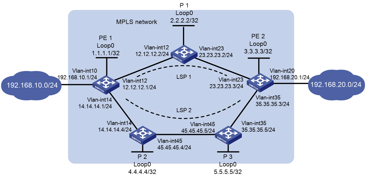

Example: Configuring LDP LSPs
As shown in Figure 2, two paths are available for PE 1 and PE 2 to communicate with each other.
·     Configure LDP to establish LSPs between PE 1 and PE 2 to allow communication between subnets 192.168.10.0/24 and 192.168.20.0/24 over the MPLS network.
¡     Use LSP 1 as the primary path.
¡     Use LSP 2 as the backup path, which takes over LSP 1 when LSP 1 fails.
·     Configure LDP to establish LSPs only for destinations 1.1.1.1/32, 2.2.2.2/32, 3.3.3.3/32, 4.4.4.4/32, 5.5.5.5/32, 192.168.10.0/24, and 192.168.20.0/24.
Figure 2 Network diagram
Analysis
To establish LDP LSPs, configure a routing protocol to ensure IP connectivity among the devices. This example uses OSPF.
To use LSP 1 as the primary path and LSP 2 as the backup, configure the routes for LSP 1 and LSP 2 as the primary and backup routes, respectively. This example uses OSPF. The OSPF cost of the route for LSP 1 is smaller than that for LSP 2. Therefore, LSP 1 is used when it is available.
To control LSP establishment, configure LSP generation policies on each LSR.

Before configuring LDP LSPs, make sure STP is disabled or each VLAN has been mapped to an MSTP instance.
1.     Configure IP addresses and masks for interfaces, including the loopback interfaces, as shown in Figure 2. (Details not shown.)
2.     Configure OSPF on each switch to ensure IP connectivity:
# Configure PE 1.
[PE1] ospf
[PE1-ospf-1] area 0
[PE1-ospf-1-area-0.0.0.0] network 1.1.1.1 0.0.0.0
[PE1-ospf-1-area-0.0.0.0] network 12.12.12.0 0.0.0.255
[PE1-ospf-1-area-0.0.0.0] network 14.14.14.0 0.0.0.255
[PE1-ospf-1-area-0.0.0.0] network 192.168.10.0 0.0.0.255
[PE1-ospf-1-area-0.0.0.0] quit
[PE1-ospf-1] quit
# Configure P 1.
[P1] ospf
[P1-ospf-1] area 0
[P1-ospf-1-area-0.0.0.0] network 2.2.2.2 0.0.0.0
[P1-ospf-1-area-0.0.0.0] network 12.12.12.0 0.0.0.255
[P1-ospf-1-area-0.0.0.0] network 23.23.23.0 0.0.0.255
[P1-ospf-1-area-0.0.0.0] quit
[P1-ospf-1] quit
# Configure P 2.
[P2] ospf
[P2-ospf-1] area 0
[P2-ospf-1-area-0.0.0.0] network 4.4.4.4 0.0.0.0
[P2-ospf-1-area-0.0.0.0] network 14.14.14.0 0.0.0.255
[P2-ospf-1-area-0.0.0.0] network 45.45.45.0 0.0.0.255
[P2-ospf-1-area-0.0.0.0] quit
[P2-ospf-1] quit
# Configure P 3.
[P3] ospf
[P3-ospf-1] area 0
[P3-ospf-1-area-0.0.0.0] network 5.5.5.5 0.0.0.0
[P3-ospf-1-area-0.0.0.0] network 45.45.45.0 0.0.0.255
[P3-ospf-1-area-0.0.0.0] network 35.35.35.0 0.0.0.255
[P3-ospf-1-area-0.0.0.0] quit
[P3-ospf-1] quit
# Configure PE 2.
[PE2] ospf
[PE2-ospf-1] area 0
[PE2-ospf-1-area-0.0.0.0] network 3.3.3.3 0.0.0.0
[PE2-ospf-1-area-0.0.0.0] network 23.23.23.0 0.0.0.255
[PE2-ospf-1-area-0.0.0.0] network 35.35.35.0 0.0.0.255
[PE2-ospf-1-area-0.0.0.0] network 192.168.20.0 0.0.0.255
[PE2-ospf-1-area-0.0.0.0] quit
[PE2-ospf-1] quit
# On each switch, for example, on PE 1, verify that the switches have learned the routes to each other.
[PE1] display ospf routing
          OSPF Process 1 with Router ID 1.1.1.1
                   Routing Table
                Topology base (MTID 0)
 Routing for network
 Destination        Cost     Type    NextHop         AdvRouter       Area
 45.45.45.0/24      2        Transit 14.14.14.4      5.5.5.5         0.0.0.0
 35.35.35.0/24      3        Transit 14.14.14.4      5.5.5.5         0.0.0.0
 35.35.35.0/24      3        Transit 12.12.12.2      5.5.5.5         0.0.0.0
 192.168.10.0/24    1        Stub    192.168.10.1    1.1.1.1         0.0.0.0
 5.5.5.5/32         2        Stub    14.14.14.4      5.5.5.5         0.0.0.0
 14.14.14.0/24      1        Transit 14.14.14.1      4.4.4.4         0.0.0.0
 23.23.23.0/24      2        Transit 12.12.12.2      3.3.3.3         0.0.0.0
 4.4.4.4/32         1        Stub    14.14.14.4      4.4.4.4         0.0.0.0
 3.3.3.3/32         2        Stub    12.12.12.2      3.3.3.3         0.0.0.0
 12.12.12.0/24      1        Transit 12.12.12.1      2.2.2.2         0.0.0.0
 2.2.2.2/32         1        Stub    12.12.12.2      2.2.2.2         0.0.0.0
 1.1.1.1/32         0        Stub    1.1.1.1         1.1.1.1         0.0.0.0
 192.168.20.0/24    3        Stub    12.12.12.2      3.3.3.3         0.0.0.0
# On each switch, for example, on PE 1, verify that OSPF neighbor relationships in Full state have been established between PE 1, P devices, and PE 2.
[PE1] display ospf peer verbose
                  Neighbors
 Area 0.0.0.0 interface 14.14.14.1(Vlan-interface14)'s neighbors
 Router ID: 4.4.4.4          Address: 14.14.14.4       GR state: Normal
   State: Full  Mode: Nbr is master  Priority: 1
   DR: 14.14.14.4  BDR: 14.14.14.1  MTU: 0
   Options is 0x42 (-|O|-|-|-|-|E|-)
   Dead timer due in 40  sec
   Neighbor is up for 00:03:30
   Authentication Sequence: [ 0 ]
   Neighbor state change count: 6
   BFD status: Disabled
                  Neighbors
 Area 0.0.0.0 interface 12.12.12.1(Vlan-interface12)'s neighbors
 Router ID: 2.2.2.2          Address: 12.12.12.2       GR state: Normal
   DR: 12.12.12.2  BDR: 12.12.12.1  MTU: 0
   Dead timer due in 36  sec
   Neighbor is up for 00:03:24
 Last Neighbor Down Event:
 Router ID: 4.4.4.4
 Local Address: 14.14.14.1
 Remote Address: 14.14.14.4
 Time: May 14 09:07:19 2014
 Reason: Reset ospf command was performed
3.     Configure basic MPLS and MPLS LDP:
# Configure PE 1.
[PE1] mpls lsr-id 1.1.1.1
[PE1] mpls ldp
[PE1-ldp] quit
[PE1] interface vlan-interface 12
[PE1-Vlan-interface12] mpls enable
[PE1-Vlan-interface12] mpls ldp enable
[PE1-Vlan-interface12] quit
[PE1] interface vlan-interface 14
[PE1-Vlan-interface14] mpls enable
[PE1-Vlan-interface14] mpls ldp enable
[PE1-Vlan-interface14] quit
# Configure P 1.
[P1] mpls lsr-id 2.2.2.2
[P1] mpls ldp
[P1-ldp] quit
[P1] interface vlan-interface 12
[P1-Vlan-interface12] mpls enable
[P1-Vlan-interface12] mpls ldp enable
[P1-Vlan-interface12] quit
[P1] interface vlan-interface 23
[P1-Vlan-interface23] mpls enable
[P1-Vlan-interface23] mpls ldp enable
[P1-Vlan-interface23] quit
# Configure P 2.
[P2] mpls lsr-id 4.4.4.4
[P2] mpls ldp
[P2-ldp] quit
[P2] interface vlan-interface 14
[P2-Vlan-interface14] mpls enable
[P2-Vlan-interface14] mpls ldp enable
[P2-Vlan-interface14] quit
[P2] interface vlan-interface 45
[P2-Vlan-interface45] mpls enable
[P2-Vlan-interface45] mpls ldp enable
[P2-Vlan-interface45] quit
# Configure P 3.
[P3] mpls lsr-id 5.5.5.5
[P3] mpls ldp
[P3-ldp] quit
[P3] interface vlan-interface 45
[P3-Vlan-interface45] mpls enable
[P3-Vlan-interface45] mpls ldp enable
[P3-Vlan-interface45] quit
[P3] interface vlan-interface 35
[P3-Vlan-interface35] mpls enable
[P3-Vlan-interface35] mpls ldp enable
[P3-Vlan-interface35] quit
# Configure PE 2.
[PE2] mpls lsr-id 3.3.3.3
[PE2] mpls ldp
[PE2-ldp] quit
[PE2] interface vlan-interface 23
[PE2-Vlan-interface23] mpls enable
[PE2-Vlan-interface23] mpls ldp enable
[PE2-Vlan-interface23] quit
[PE2] interface vlan-interface 35
[PE2-Vlan-interface35] mpls enable
[PE2-Vlan-interface35] mpls ldp enable
[PE2-Vlan-interface35] quit
# On each switch, for example, on PE 1, verify that LDP sessions in Operational state have been established between PE 1, P devices, and PE 2.
[PE1 display mpls ldp peer
Total number of peers: 2
Peer LDP ID             State         Role     GR   MD5  KA Sent/Rcvd
2.2.2.2:0               Operational   Passive  Off  Off  55/55
4.4.4.4:0               Operational   Passive  Off  Off  6/6
4.     Configure LSP generation policies:
# On PE 1, create IP prefix list PE1, and configure LDP to use only the routes permitted by the prefix list to establish LSPs.
[PE1] ip prefix-list PE1 index 10 permit 1.1.1.1 32
[PE1] ip prefix-list PE1 index 20 permit 2.2.2.2 32
[PE1] ip prefix-list PE1 index 30 permit 3.3.3.3 32
[PE1] ip prefix-list PE1 index 40 permit 4.4.4.4 32
[PE1] ip prefix-list PE1 index 50 permit 5.5.5.5 32
[PE1] ip prefix-list PE1 index 60 permit 192.168.10.0 24
[PE1] ip prefix-list PE1 index 70 permit 192.168.20.0 24
[PE1] mpls ldp
[PE1-ldp] lsp-trigger prefix-list PE1
[PE1-ldp] quit
# On P 1, create IP prefix list P1, and configure LDP to use only the routes permitted by the prefix list to establish LSPs.
[P1] ip prefix-list P1 index 10 permit 1.1.1.1 32
[P1] ip prefix-list P1 index 20 permit 2.2.2.2 32
[P1] ip prefix-list P1 index 30 permit 3.3.3.3 32
[P1] ip prefix-list P1 index 40 permit 4.4.4.4 32
[P1] ip prefix-list P1 index 50 permit 5.5.5.5 32
[P1] ip prefix-list P1 index 60 permit 192.168.10.0 24
[P1] ip prefix-list P1 index 70 permit 192.168.20.0 24
[P1] mpls ldp
[P1-ldp] lsp-trigger prefix-list P1
[P1-ldp] quit
# On P 2, create IP prefix list P2, and configure LDP to use only the routes permitted by the prefix list to establish LSPs.
[P2] ip prefix-list P2 index 10 permit 1.1.1.1 32
[P2] ip prefix-list P2 index 20 permit 2.2.2.2 32
[P2] ip prefix-list P2 index 30 permit 3.3.3.3 32
[P2] ip prefix-list P2 index 40 permit 4.4.4.4 32
[P2] ip prefix-list P2 index 50 permit 5.5.5.5 32
[P2] ip prefix-list P2 index 60 permit 192.168.10.0 24
[P2] ip prefix-list P2 index 70 permit 192.168.20.0 24
[P2] mpls ldp
[P2-ldp] lsp-trigger prefix-list P2
[P2-ldp] quit
# On P 3, create IP prefix list P3, and configure LDP to use only the routes permitted by the prefix list to establish LSPs.
[P3] ip prefix-list P3 index 10 permit 1.1.1.1 32
[P3] ip prefix-list P3 index 20 permit 2.2.2.2 32
[P3] ip prefix-list P3 index 30 permit 3.3.3.3 32
[P3] ip prefix-list P3 index 40 permit 4.4.4.4 32
[P3] ip prefix-list P3 index 50 permit 5.5.5.5 32
[P3] ip prefix-list P3 index 60 permit 192.168.10.0 24
[P3] ip prefix-list P3 index 70 permit 192.168.20.0 24
[P3] mpls ldp
[P3-ldp] lsp-trigger prefix-list P3
[P3-ldp] quit
# On PE 2, create IP prefix list PE2, and configure LDP to use only the routes permitted by the prefix list to establish LSPs.
[PE2] ip prefix-list PE2 index 10 permit 1.1.1.1 32
[PE2] ip prefix-list PE2 index 20 permit 2.2.2.2 32
[PE2] ip prefix-list PE2 index 30 permit 3.3.3.3 32
[PE2] ip prefix-list PE2 index 40 permit 4.4.4.4 32
[PE2] ip prefix-list PE2 index 50 permit 5.5.5.5 32
[PE2] ip prefix-list PE2 index 60 permit 192.168.10.0 24
[PE2] ip prefix-list PE2 index 70 permit 192.168.20.0 24
[PE2] mpls ldp
[PE2-ldp] lsp-trigger prefix-list PE2
[PE2-ldp] quit
# Display LDP LSP information on PE 1. The output shows that the next hop is P 1 for the LSP associated with FEC 192.168.20.0/24.
[PE1] display mpls ldp lsp
Status Flags: * - stale, L - liberal, B - backup, N/A – unavailable
FECs: 7            Ingress: 5          Transit: 5      Egress: 2
FEC                In/Out Label        Nexthop         OutInterface/LSINDEX
1.1.1.1/32         3/-
                   -/1151(L)
                   -/1151(L)
2.2.2.2/32         -/3                 12.12.12.2      Vlan12
                   1151/3              12.12.12.2      Vlan12
                   -/1150(L)
3.3.3.3/32         -/1150              12.12.12.2      Vlan12
                   1150/1150           12.12.12.2      Vlan12
                   -/1148(L)
4.4.4.4/32         -/1149(L)
                   -/3                 14.14.14.4      Vlan14
                   1149/3              14.14.14.4      Vlan14
5.5.5.5/32         -/1148(L)
                   -/1149              14.14.14.4      Vlan14
                   1148/1149           14.14.14.4      Vlan14
192.168.10.0/24    1147/-
192.168.20.0/24    -/1147              12.12.12.2      Vlan12
                   1146/1147           12.12.12.2      Vlan12
                   -/1147(L)
# Power down P 1 and execute the display mpls ldp lsp command on PE 1. The output shows that the next hop becomes P 2 for the LSP associated with FEC 192.168.20.0/24.
1.1.1.1/32         3/-
                   -/1150(L)
2.2.2.2/32         -/1149              14.14.14.4      Vlan14
                   1150/1149           14.14.14.4      Vlan14
3.3.3.3/32         -/1148              14.14.14.4      Vlan14
                   1147/1148           14.14.14.4      Vlan14
4.4.4.4/32         -/3                 14.14.14.4      Vlan14
5.5.5.5/32         -/1151              14.14.14.4      Vlan14
                   1148/1151           14.14.14.4      Vlan14
192.168.10.0/24    1151/-
                   -/1146(L)
192.168.20.0/24    -/1147              14.14.14.4      Vlan14
                   1146/1147           14.14.14.4      Vlan14
# Use the following command on PE 1 to verify its connectivity to PE 2.
[PE1] ping mpls -a 192.168.10.1 ipv4 192.168.20.0 24
MPLS ping FEC 192.168.20.0/24 with 100 bytes of data:
100 bytes from 23.23.23.3: Sequence=1 time=2 ms
100 bytes from 23.23.23.3: Sequence=2 time=2 ms
100 bytes from 23.23.23.3: Sequence=3 time=2 ms
100 bytes from 23.23.23.3: Sequence=4 time=2 ms
100 bytes from 23.23.23.3: Sequence=5 time=2 ms
--- Ping statistics for FEC 192.168.20.0/24 ---
Round-trip min/avg/max = 2/2/2 ms
Configuration files

 ip address 45.45.45.4 255.255.255.0
 mpls enable
 mpls ldp enable
·     P 3:
ospf 1
 area 0.0.0.0
 mpls lsr-id 5.5.5.5
vlan 35
vlan 45
mpls ldp
interface LoopBack0
 ip address 2.2.2.2 255.255.255.255
interface Vlan-interface35
 ip address 35.35.35.5 255.255.255.0
 mpls enable
 mpls ldp enable
interface Vlan-interface45
 ip address 45.45.45.5 255.255.255.0
 mpls enable
 mpls ldp enable
·     PE 2:
ospf 1
 area 0.0.0.0
 mpls lsr-id 3.3.3.3
vlan 20
vlan 23
vlan 35
mpls ldp
interface LoopBack0
 ip address 3.3.3.3 255.255.255.255
interface Vlan-interface20
 ip address 192.168.20.1 255.255.255.0
interface Vlan-interface23
 ip address 23.23.23.3 255.255.255.0
 mpls enable
 mpls ldp enable
 ip address 5.35.35.3 255.255.255.0
mpls enable
 mpls ldp enable
