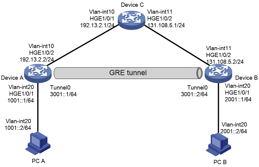

As shown in Figure 1, Device A, Device B, and Device C are all on an IPv4 network. Dual stack devices Device A and Device B each connect to an IPv6 host.
Configure a GRE/IPv4 tunnel between Device A and Device B, so PC A and PC B can communicate with each other over the IPv4 network.
Figure 1 Network diagram
Analysis
To meet the network requirements, perform the following tasks:
·     To enable the IPv6 hosts to communicate over the IPv4 network, specify the GRE tunnel mode as GRE/IPv4 and configure IPv6 addresses for the tunnel interfaces.
·     To transmit packets between PC A and PC B through the GRE tunnel, configure a route reaching the destination network through the tunnel interface on Device A and Device B. You can configure the routes by using either of the following methods:
¡     Configure static routes, using the peer tunnel interface as the next hop or using the local tunnel interface as the outgoing interface.
¡     Enable a dynamic routing protocol on both the tunnel interfaces and the Layer 3 interfaces connected to PC A and PC B.
·     For both ends of the GRE tunnel to reach each other, configure a static route reaching the remote end on Device A and Device B.

When you configure the GRE tunnel, follow these restrictions and guidelines:
·     You must configure the tunnel source address and destination address at both ends of the tunnel. The tunnel source or destination address at one end must be the tunnel destination or source address at the other end.
·     Encapsulated packets cannot be forwarded on Layer 3 according to the destination IP addresses and routing tables. You must create a service loopback group of the tunnel service type to loop encapsulated packets back to the forwarding module for Layer 3 forwarding.
