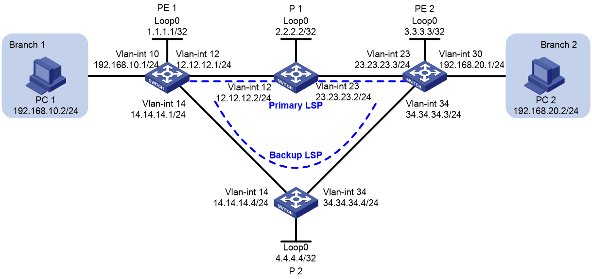

Example: Configuring BFD for an LSP
As shown in Figure 1, a company has two branches that are connected to the MPLS backbone. It requires the MPLS backbone to establish LSPs for communication between the branches, and to provide high availability services for uninterrupted business between the branches.
To meet the requirements:
·     Establish LSPs by using LDP.
·     Configure OSPF FRR on the MPLS backbone so LDP can establish a primary LSP and a backup LSP.
·     Configure BFD for the primary LSP. When the primary LSP fails, BFD can quickly detect the failure and notify LDP of the failure, so LDP can immediately switch traffic to the backup LSP.
Figure 1 Network diagram

Before configuration, disable the spanning tree feature globally or map each VLAN to an MSTI.

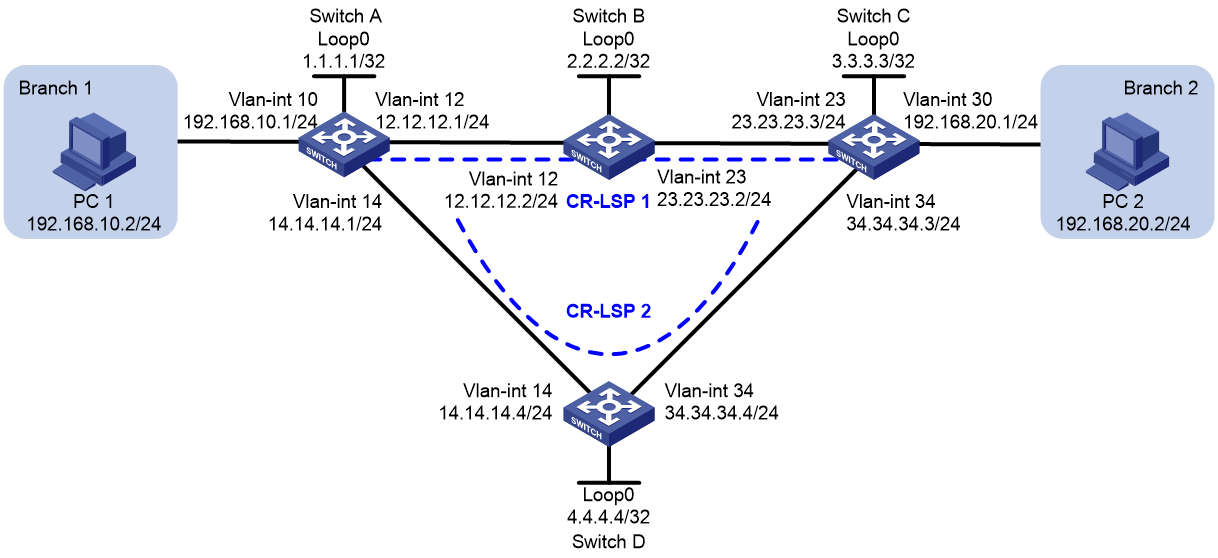

Example: Configuring BFD for an MPLS TE tunnel
As shown in Figure 2, a company has two branches that are connected to the MPLS backbone. It requires the MPLS backbone to establish an MPLS TE tunnel for communication between the branches, and to provide high availability services for uninterrupted business between the branches.
·     Use RSVP-TE to establish an MPLS TE tunnel between Switch A and Switch C.
·     Configure CRLSP backup for the MPLS TE tunnel to simultaneously establish a primary CRLSP (CR-LSP 1) and a backup CRLSP (CR-LSP 2).
·     Configure BFD for the MPLS TE tunnel. When the primary CRLSP fails, BFD can quickly detect the failure and notify RSVP of the failure, so RSVP can immediately switch traffic to the backup CRLSP.
Figure 2 Network diagram

# Execute the display rsvp lsp verbose command on Switch A. The output shows detailed information about the primary and backup CRLSPs. The primary CRLSP uses the output interface VLAN-interface 12 and the next hop 12.12.12.2. The backup CRLSP uses the output interface VLAN-interface 14 and the next hop 14.14.14.4.
[SwitchA] display rsvp lsp destination 3.3.3.3 verbose
Tunnel name: Tunnel3
Destination: 3.3.3.3                      Source: 1.1.1.1
Tunnel ID: 3                              LSP ID: 37161
LSR type: Ingress                         Direction: Unidirectional
Setup priority: 7                         Holding priority: 7
In-Label: -                               Out-Label: 1149
In-Interface: -                           Out-Interface: Vlan12
Nexthop: 12.12.12.2                       Exclude-any: 0
Include-Any: 0                            Include-all: 0
Mean rate (CIR): 0 kbps                   Mean burst size (CBS): 1000.00 bytes
Path MTU: 1500                            Class type: CT0
RRO number: 6
  12.12.12.1/32      Flag: 0x00 (No FRR)
  12.12.12.2/32      Flag: 0x00 (No FRR)
  2.2.2.2/32         Flag: 0x20 (No FRR/Node-ID)
  23.23.23.2/32      Flag: 0x00 (No FRR)
  23.23.23.3/32      Flag: 0x00 (No FRR)
  3.3.3.3/32         Flag: 0x20 (No FRR/Node-ID)
Fast Reroute protection: None
Tunnel ID: 3                              LSP ID: 37162
In-Interface: -                           Out-Interface: Vlan14
Nexthop: 14.14.14.4                       Exclude-any: 0
RRO number: 6
  14.14.14.1/32      Flag: 0x00 (No FRR)
  14.14.14.4/32      Flag: 0x00 (No FRR)
  4.4.4.4/32         Flag: 0x20 (No FRR/Node-ID)
  34.34.34.4/32      Flag: 0x00 (No FRR)
  34.34.34.3/32      Flag: 0x00 (No FRR)
2.     Display BFD information for the MPLS TE tunnel on Switch A. The output shows that BFD sessions have been established for the primary and backup CRLSPs and the state of the session is up.
[SwitchA] display mpls bfd te tunnel 3
 Total number of sessions: 2, 2 up, 0 down, 0 init
 FEC Type: TE Tunnel
 FEC Info:
   Send Addr: 1.1.1.1
   End  Addr: 3.3.3.3
   Tunnel ID: 3
   LSP ID   : 37161
 NHLFE ID: 1029
 Local Discr: 34                     Remote Discr: 33
 Source IP: 1.1.1.1                  Destination IP: 127.0.0.1
 Session State: Up                   Session Role: Passive
 Template Name: -
 FEC Type: TE Tunnel
 FEC Info:
   Send Addr: 1.1.1.1
   End  Addr: 3.3.3.3
   Tunnel ID: 3
   LSP ID   : 37162
 NHLFE ID: 1031
 Local Discr: 33                     Remote Discr: 36
 Source IP: 1.1.1.1                  Destination IP: 127.0.0.4
 Template Name: -
3.     Shut down VLAN-interface 23 on Switch B, and display MPLS TE tunnel information and BFD information:
# Shut down VLAN-interface 23 on Switch B.
[SwitchB] interface vlan-interface 23
[SwitchB-Vlan-interface23] shutdown
# Execute the display mpls te tunnel-interface command on Switch A. The output shows that the primary CRLSP is down and the backup CRLSP is up.
[SwitchA] display mpls te tunnel-interface
Tunnel Name            : Tunnel 3
Tunnel State           : Up (Main CRLSP down, Backup CRLSP up)
Tunnel Attributes      :
  LSP ID               : 0               Tunnel ID            : 3
  Admin State          : Normal
  Ingress LSR ID       : -               Egress LSR ID        : 3.3.3.3
  Signaling            : RSVP-TE         Static CRLSP Name    : -
  Resv Style           : SE
  Tunnel mode          : -
  Reverse-LSP name     : -
  Reverse-LSP LSR ID   : -               Reverse-LSP Tunnel ID: -
  Class Type           : CT0             Tunnel Bandwidth     : 0 kbps
  Reserved Bandwidth   : 0 kbps
  Setup Priority       : 7               Holding Priority     : 7
  Affinity Attr/Mask   : 0/0
  Explicit Path        : -
  Backup Explicit Path : -
  Metric Type          : TE
  Record Route         : Enabled         Record Label         : Disabled
  FRR Flag             : Disabled        Bandwidth Protection : Disabled
  Backup Bandwidth Flag: Disabled        Backup Bandwidth Type: -
  Backup Bandwidth     : -
  Bypass Tunnel        : No              Auto Created         : No
  Route Pinning        : Disabled
  Retry Limit          : 3               Retry Interval       : 2 sec
  Reoptimization       : Disabled        Reoptimization Freq  : -
  Backup Type          : Hot Standby     Backup LSP ID        : 37162
  Auto Bandwidth       : Disabled        Auto Bandwidth Freq  : -
  Min Bandwidth        : -               Max Bandwidth        : -
  Collected Bandwidth  : -
# Display BFD information for CR-LSP 2 on Switch A.
 Total number of sessions: 1, 1 up, 0 down, 0 init
 FEC Type: TE Tunnel
 FEC Info:
   Send Addr: 1.1.1.1
   End  Addr: 3.3.3.3
   Tunnel ID: 3
   LSP ID   : 37162
 NHLFE ID: 1031
 Template Name: -
4.     Bring up VLAN-interface 23 on Switch B and display MPLS TE tunnel information:
# Bring up VLAN-interface 23 on Switch B.
[SwitchB-Vlan-interface23] undo shutdown
# Execute the display mpls te tunnel-interface command on Switch A. The output shows that the primary CRLSP becomes available again.
Tunnel State           : Up (Main CRLSP up, Backup CRLSP up)
Tunnel Attributes      :
  LSP ID               : 37177           Tunnel ID            : 3
  Ingress LSR ID       : 1.1.1.1         Egress LSR ID        : 3.3.3.3
  Resv Style           : SE
  Tunnel mode          : -
  Explicit Path        : cr-lsp1
  Metric Type          : TE
  Backup Type          : Hot Standby     Backup LSP ID        : 37178
