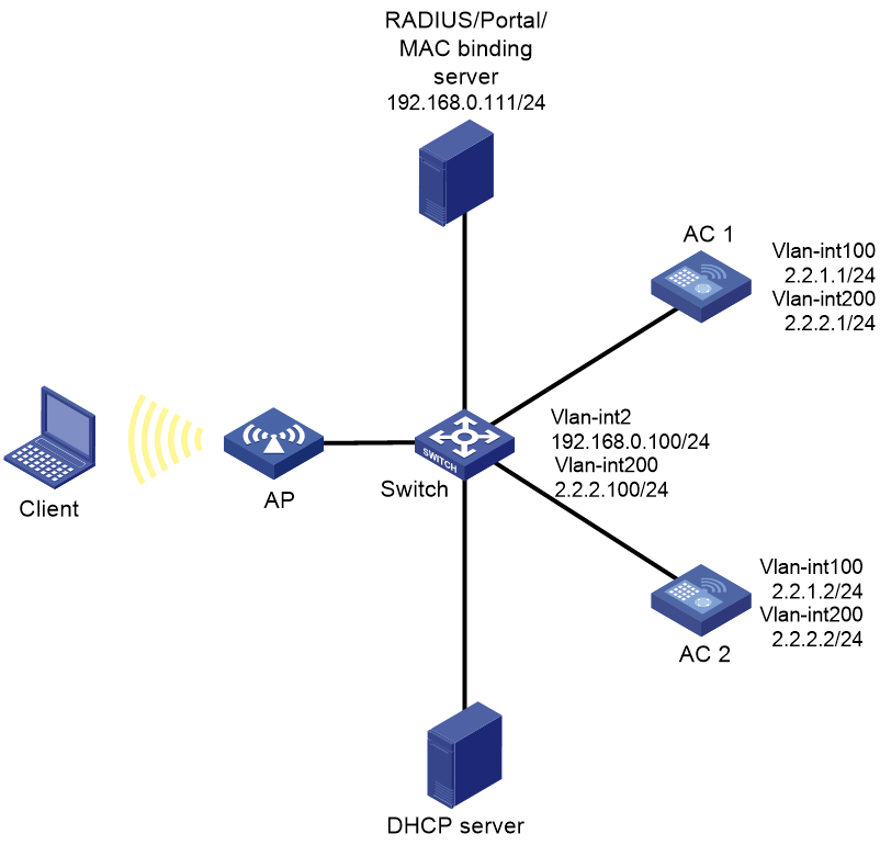

Example: Configuring remote portal authentication for dual-link AC backup and local forwarding

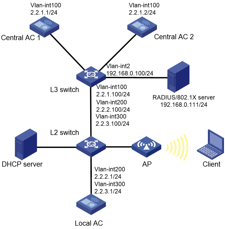

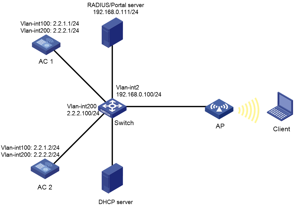

As shown in Figure 1, the AP and the client obtain IP addresses from the DHCP server. The IMC server acts as the portal authentication server, portal Web server, RADIUS server, and MAC binding server.
Configure the devices to meet the following requirements:
· The AP associates with both ACs and the two ACs to back up each other. When the master AC (AC 1) fails, the backup AC (AC 2) takes over, and the AP can provide services correctly through the backup AC.
· Direct portal authentication is used for wireless clients.
· Before passing portal authentication, the client can access only the portal Web server. After passing the authentication, the client can access other network resources.
· The AP forwards all the client traffic.
· The client can access network resources through any Layer 2 ports in its access VLAN without re-authentication.
· The IMC server can dynamically modify user authorization information and log off clients.

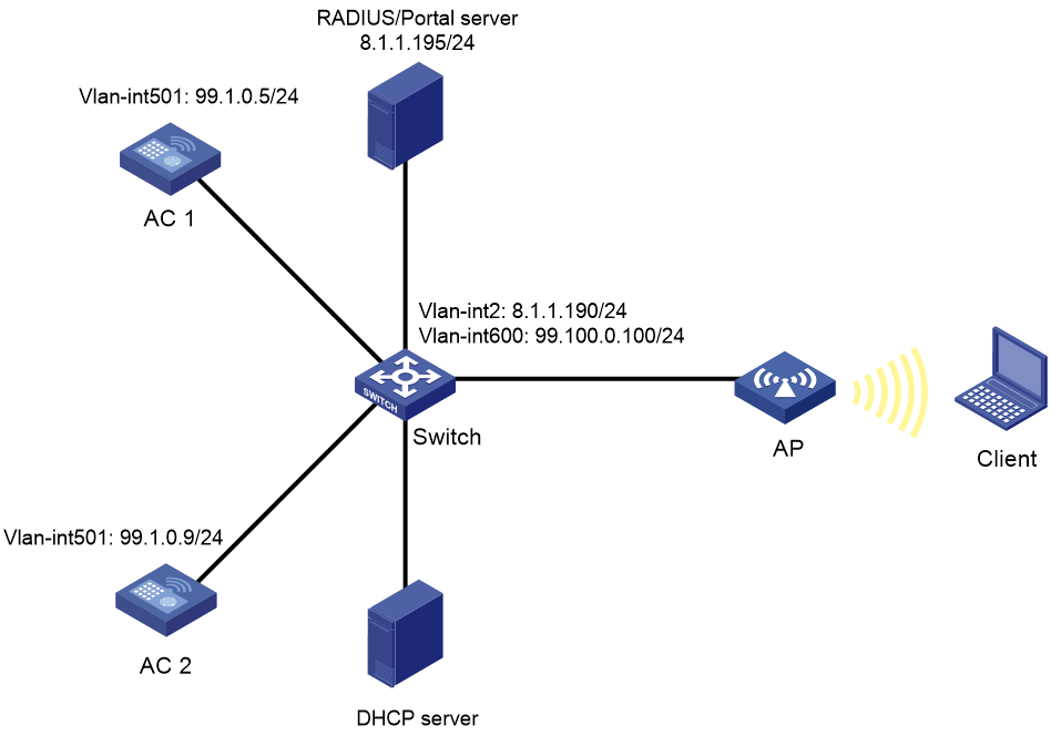

· You must upload the AP configuration file to both the master and backup ACs.
Procedures
Editing the AP configuration file
# Use a text editor to edit the AP configuration file, name the file map.txt, and then upload the file to the storage medium of the ACs. The file content and format are as follows:
vlan 600
interface gigabitethernet1/0/1
port link-type trunk
port trunk permit vlan 600
Configuring AC 1
1. Configure AC interfaces:
# Create VLAN 100 and VLAN-interface 100. Assign the VLAN interface an IP address. The AC will use this IP address to establish a CAPWAP tunnel with the AP.
<AC1> system-view
[AC1] vlan 100
[AC1-vlan100] quit
[AC1] interface vlan-interface 100
[AC1-Vlan-interface100] ip address 2.2.1.1 24
[AC1-Vlan-interface100] quit
# Create VLAN 200 and VLAN-interface 200. Assign the VLAN interface an IP address. Clients will use this VLAN to access the WLAN.
[AC1] vlan 200
[AC1-vlan200] quit
[AC1] interface vlan-interface 200
[AC1-Vlan-interface200] ip address 2.2.2.1 24
[AC1-Vlan-interface200] quit
# Configure GigabitEthernet 1/0/1 that connects AC 1 to the switch as a trunk port, and assign it to VLAN 100 and VLAN 200.
[AC1] interface gigabitethernet 1/0/1
[AC1-GigabitEthernet1/0/1] port link-type trunk
[AC1-GigabitEthernet1/0/1] port trunk permit vlan 100 200
[AC1-GigabitEthernet1/0/1] quit
2. Configure a static route to the IMC server.
[AC1] ip route-static 192.168.0.0 255.255.255.0 2.2.2.100

Configuring AC 2
# Create VLAN 501 and VLAN-interface 100. Assign the VLAN interface an IP address. The AC will use this IP address to establish a CAPWAP tunnel with the AP.
<AC2> system-view
[AC2] vlan 100
[AC2-vlan100] quit
[AC2] interface vlan-interface 100
[AC2-Vlan-interface100] ip address 2.2.1.2 24
[AC2-Vlan-interface100] quit
[AC2] vlan 200
[AC2-vlan200] quit
[AC2] interface vlan-interface 200
[AC2-Vlan-interface200] ip address 2.2.2.2 24
[AC2-Vlan-interface200] quit
[AC2] interface gigabitethernet 1/0/1
[AC2-GigabitEthernet1/0/1] port link-type trunk
[AC2-GigabitEthernet1/0/1] port trunk permit vlan 100 200
[AC2-GigabitEthernet1/0/1] quit
[AC2] ip route-static 192.168.0.0 255.255.255.0 2.2.2.100

Configuring the switch
# Create VLAN 100 for forwarding CAPWAP tunnel traffic between AC and AP.
<Switch> system-view
[Switch] vlan 100
[Switch-vlan100] quit
# Create VLAN 200 for forwarding client traffic.
[Switch] vlan 200
[Switch-vlan200] quit
# Create VLAN 2 for connecting to the IMC server.
[Switch] vlan 2
[Switch-vlan2] quit
# Add the interface that connects the switch to the IMC server to VLAN 2. (Details not shown.)
# Configure GigabitEthernet 1/0/1 that connects the switch to AC 1 as a trunk port, and assign it to VLAN 100 and VLAN 200.
[Switch] interface gigabitethernet 1/0/1
[Switch-GigabitEthernet1/0/1] port link-type trunk
[Switch-GigabitEthernet1/0/1] port trunk permit vlan 100 200

# Configure GigabitEthernet 1/0/4 that connects the switch to AC 2 as a trunk port, and assign it to VLAN 100 and VLAN 200.
[Switch] interface gigabitethernet 1/0/4
[Switch-GigabitEthernet1/0/4] port link-type trunk
[Switch-GigabitEthernet1/0/4] port trunk permit vlan 100 200
[Switch-GigabitEthernet1/0/4] quit
# Configure GigabitEthernet 1/0/2 that connects the switch to the AP as a trunk port, set the PVID to VLAN 100, and assign the interface to VLAN 100 and VLAN 200.
[Switch] interface gigabitethernet 1/0/2
[Switch-GigabitEthernet1/0/2] port link-type trunk
[Switch-GigabitEthernet1/0/2] port trunk pvid vlan 100
[Switch-GigabitEthernet1/0/2] port trunk permit vlan 100 200
# Enable PoE.
[Switch-GigabitEthernet1/0/2] poe enable
[Switch-GigabitEthernet1/0/2] quit
# Configure GigabitEthernet 1/0/3 that connects the switch to the DHCP server as a trunk port, and assign it to VLAN 100 and VLAN 200.
[Switch] interface gigabitethernet 1/0/3
[Switch-GigabitEthernet1/0/3] port link-type trunk
[Switch-GigabitEthernet1/0/3] port trunk permit vlan 100 200
[Switch-GigabitEthernet1/0/3] quit
# Assign an IP address to VLAN-interface 200.
[Switch] interface vlan-interface 200
[Switch-Vlan-interface200] ip address 2.2.2.100 255.255.255.0
[Switch-Vlan-interface200] quit
# Assign an IP address to VLAN-interface 2. This address will be used as the gateway address for the IMC server.
[Switch-Vlan-interface2] ip address 192.168.0.100 255.255.255.0
[Switch-Vlan-interface2] quit

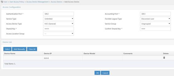

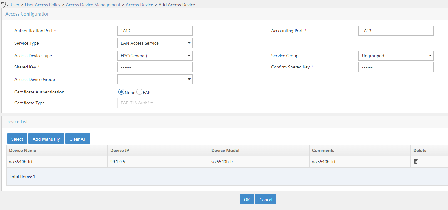

1. Add AC 1 as an access device:
a. Log in to IMC and click the User tab.
b. From the navigation pane, select User Access Policy > Access Device Management > Access Device.
c. Click Add.
The Add Access Device page opens.
d. In the Access Configuration area, configure the following parameters:
- Enter radius in the Shared Key and Confirm Shared Key fields. Make sure the key is the same as the key configured on the ACs.
- Use the default values for other parameters.
e. In the Device List area, click Select or Add Manually to add AC 1 at 2.2.2.1 as an access device.
f. Click OK.
Figure 2 Adding an access device
2. Repeat the previous step to add AC 2 as an access device.
The IP address of AC 2 is 2.2.2.2.

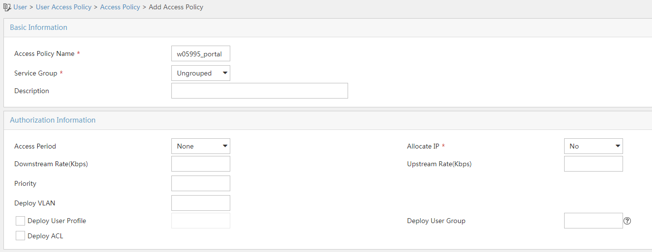

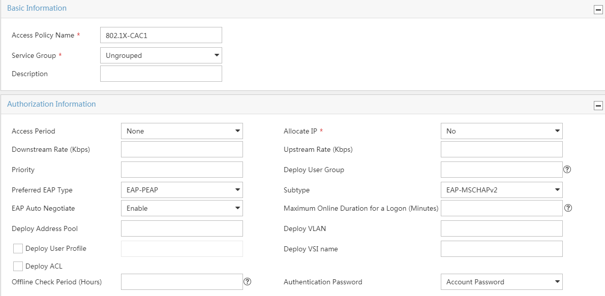

3. Add an access policy.
a. From the navigation pane, select User Access Policy > Access Policy.
b. Click Add.
c. Enter the access policy name. In this example, the name is AccessPolicy.
d. Select the Ungrouped service group.
e. Use the default settings for other parameters.
Figure 3 Adding an access policy

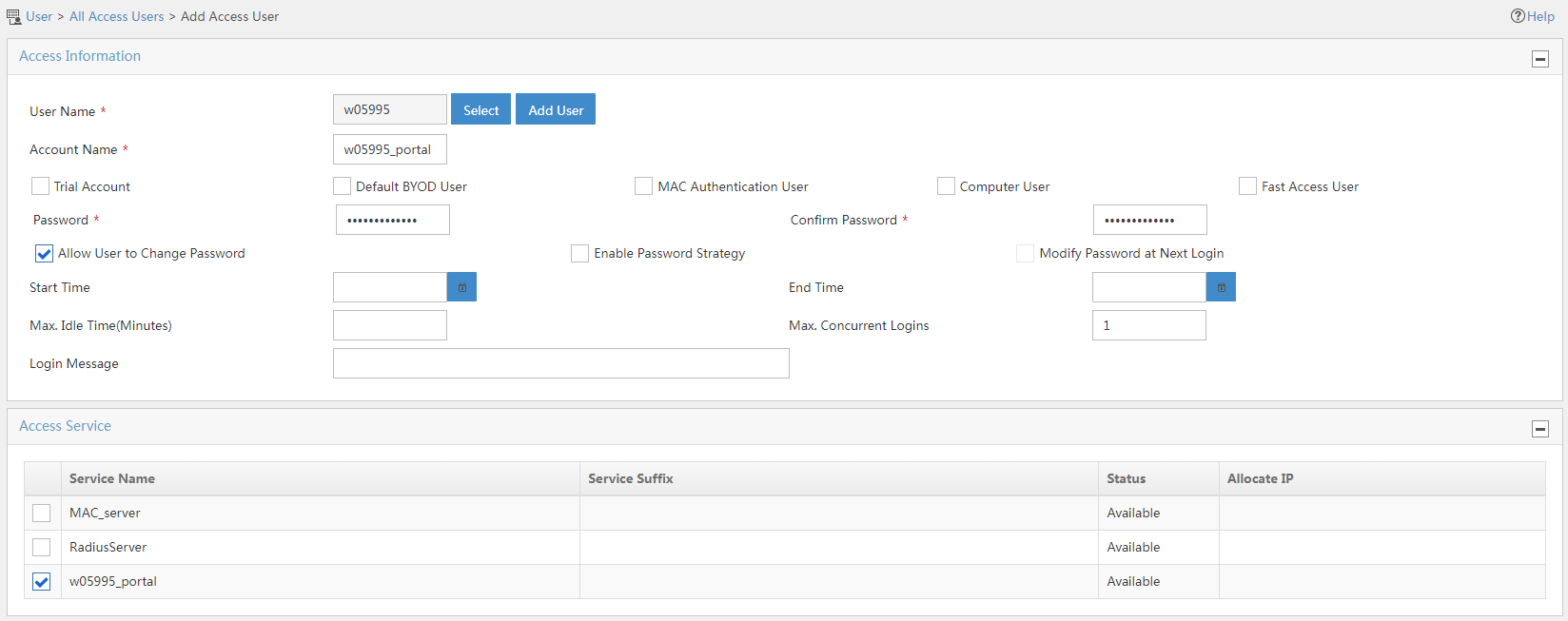

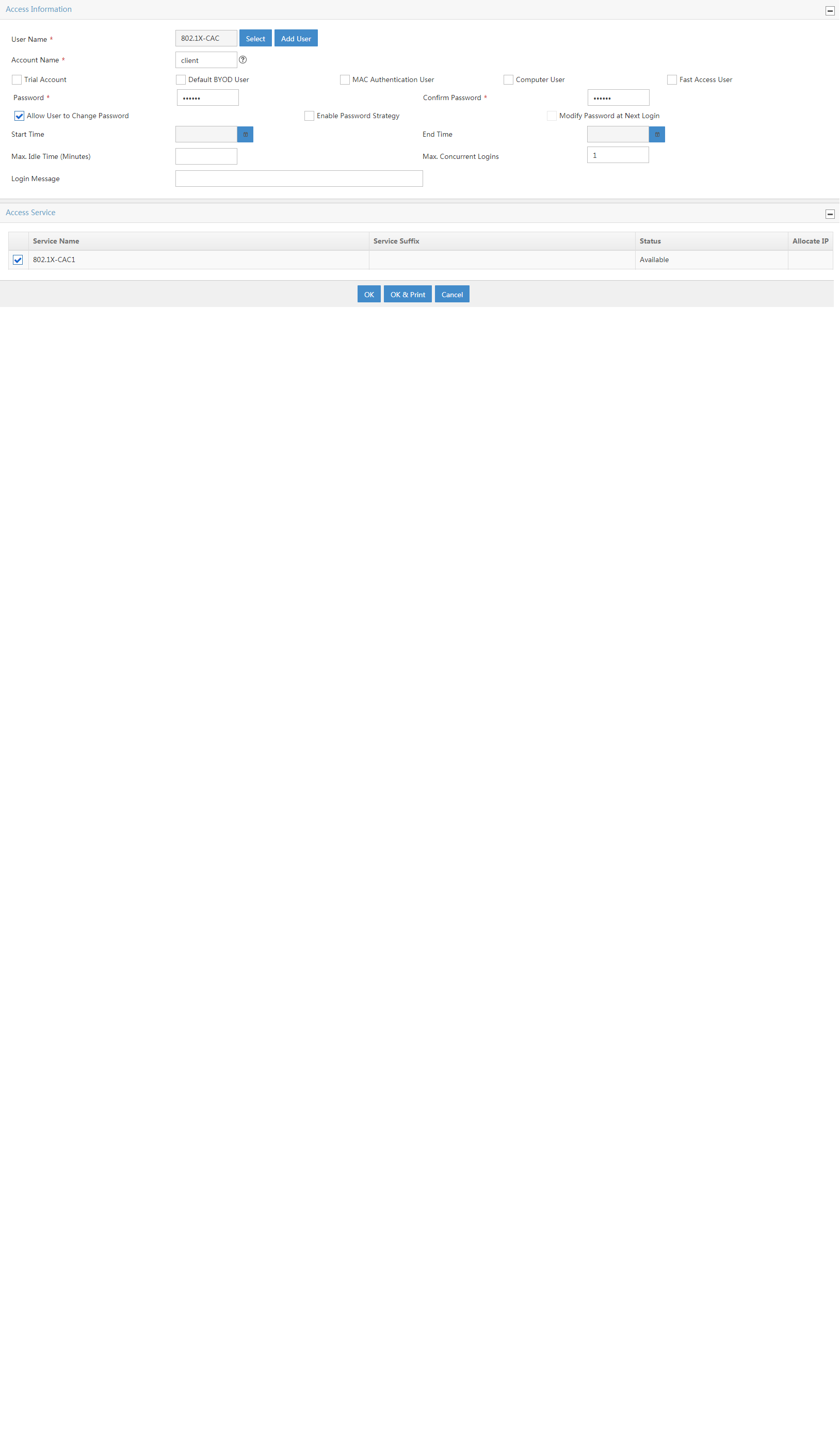

5. Add an access user.
a. From the navigation pane, select Access User > All Access Users.
b. Click Add.
c. Select an existing access user or click Add User to add a new access user.
d. Specify the account name. In this example, the name is client.
e. Set the password.
f. Select service RadiusServer.
g. Use the default settings for other parameters.
h. Click OK.
Figure 5 Adding an access user

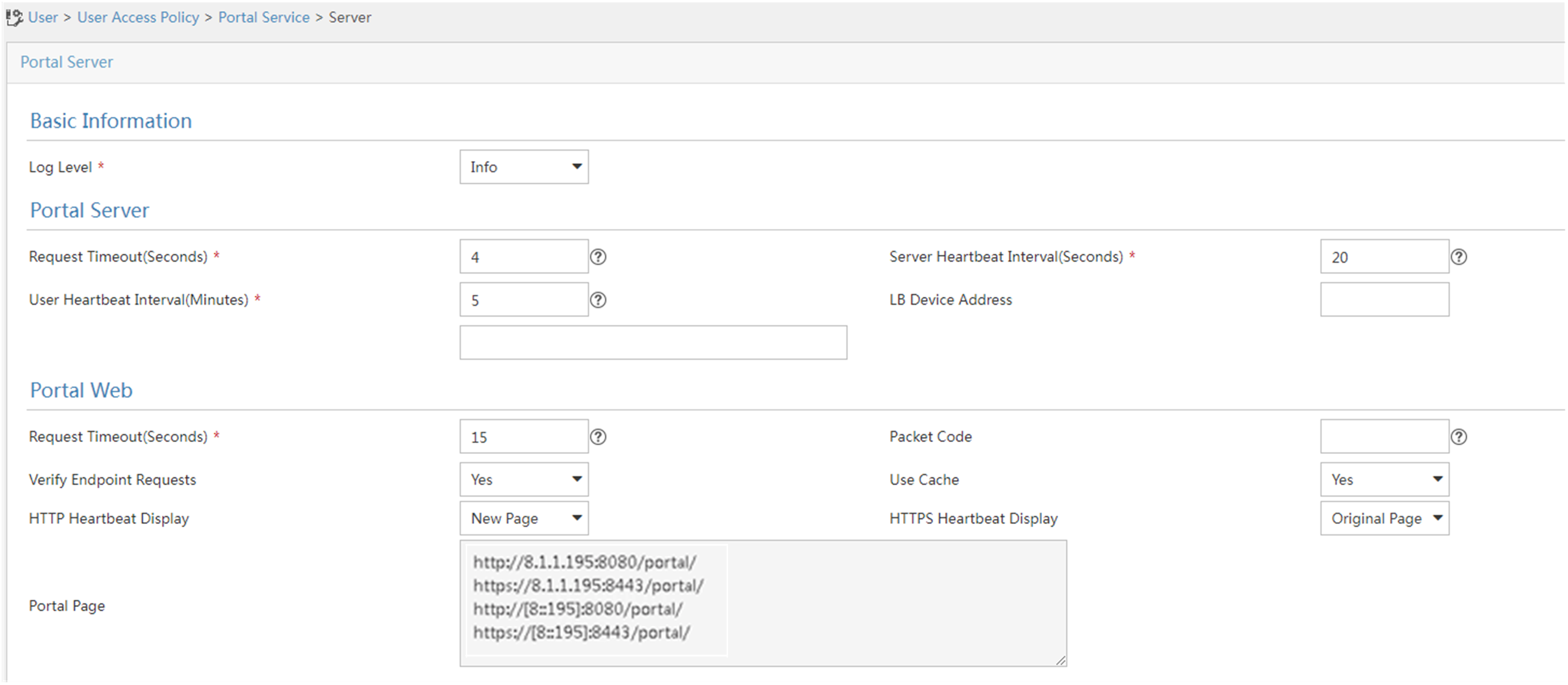

Configure the portal server
1. Configure portal authentication:
a. Click the User tab.
b. Select User Access Policy > Portal Service > Server from the navigation tree to open the portal server configuration page.
c. Permit different ports to be bound to the same IP address group, and configure the other portal server parameters as needed.
This example uses the default settings.
d. Click OK.
Figure 6 Portal authentication server configuration

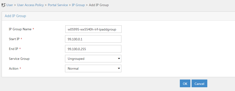

2. Configure the IP address group:
a. Select User Access Policy > Portal Service > IP Group from the navigation tree to open the portal IP address group configuration page.
b. Click Add to open the page as shown in Figure 7.
c. Enter the IP group name. In this example, the name is Portal_user.
d. Enter the start IP address and end IP address of the IP group.
Make sure the client IP address is in the IP group.
e. Select a service group.
This example uses the default group Ungrouped.
f. Select Normal from the Action list.
g. Click OK.
Figure 7 Adding an IP address group

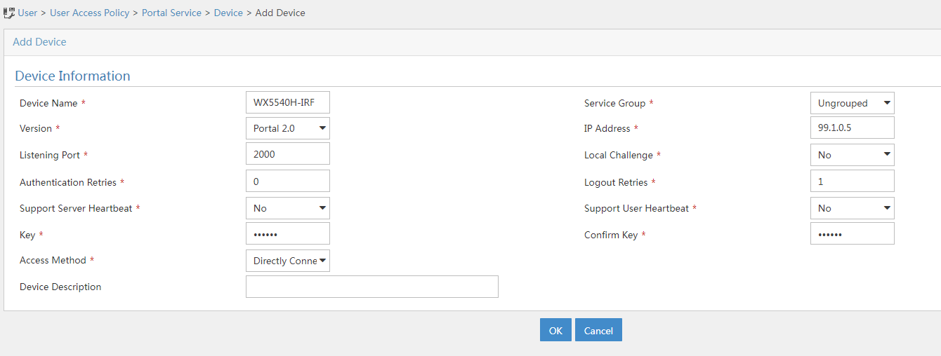

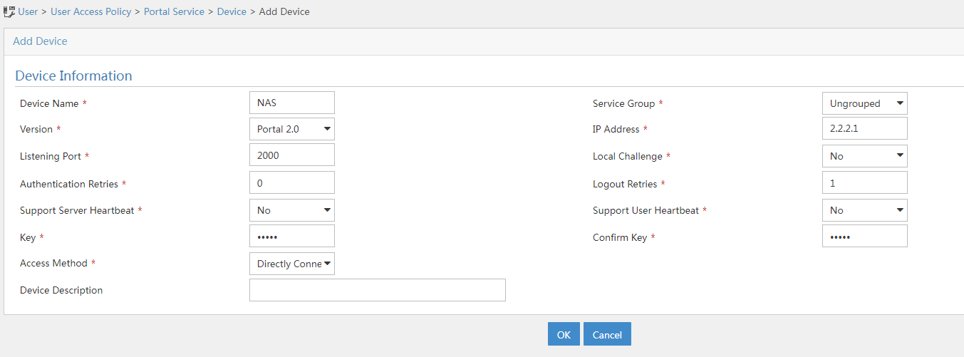

3. Add AC 1 as a portal device:
a. Select User Access Policy > Portal Service > Device from the navigation tree to open the portal device configuration page.
b. Click Add to open the page as shown in Figure 8.
c. Enter the device name.
d. Specify the version as Portal 2.0.
e. Enter the portal BAS-IP configured on AC 1 as the IP address.
f. Set whether to support the portal server heartbeat and user heartbeat functions.
In this example, select No for both Support Server Heartbeat and Support User Heartbeat.
g. Enter the key, which must be the same as that configured on the AC.
h. Select Directly Connected from the Access Method list.
i. Use the default settings for other parameters.
j. Click OK.
Figure 8 Adding a portal device
4. Repeat the previous step to add AC 2 as a portal device.

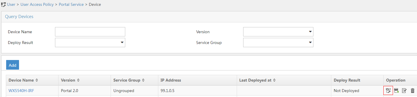

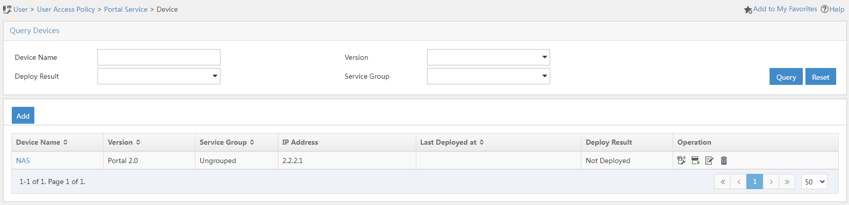

5. Associate AC 1 with the IP address group:
a. As shown in Figure 9,
click the Port Group Information Management icon for the device to
open the port group configuration page.

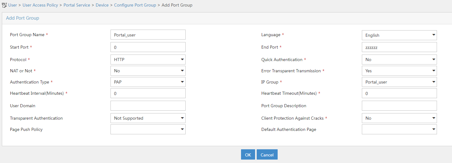

b. Click Add to open the page as shown in Figure 10.
c. Enter the port group name. In this example, the name is Portal_user.
d. Select the configured IP address group.
The IP address used by the user to access the network must be within this IP address group.
f. Click OK.
6. Repeat the previous step to associate AC 2 with the IP address group.
