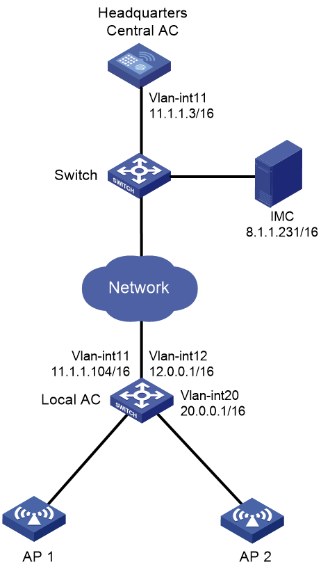

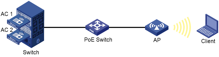

As shown in Figure 1, the AP and the client obtain IP addresses from the DHCP server. The IMC server acts as a portal authentication server, a portal Web server, a MAC binding server, and a RADIUS server.
Configure direct portal authentication and MAC-trigger authentication to meet the following requirements:
· The client can access only the portal Web server before passing portal authentication and can access other network resources after passing portal authentication.
· The client can access the network resources through any Layer 2 ports in its access VLAN without re-authentication.
· The RADIUS server can dynamically change the user authorization information or forcibly disconnect users.

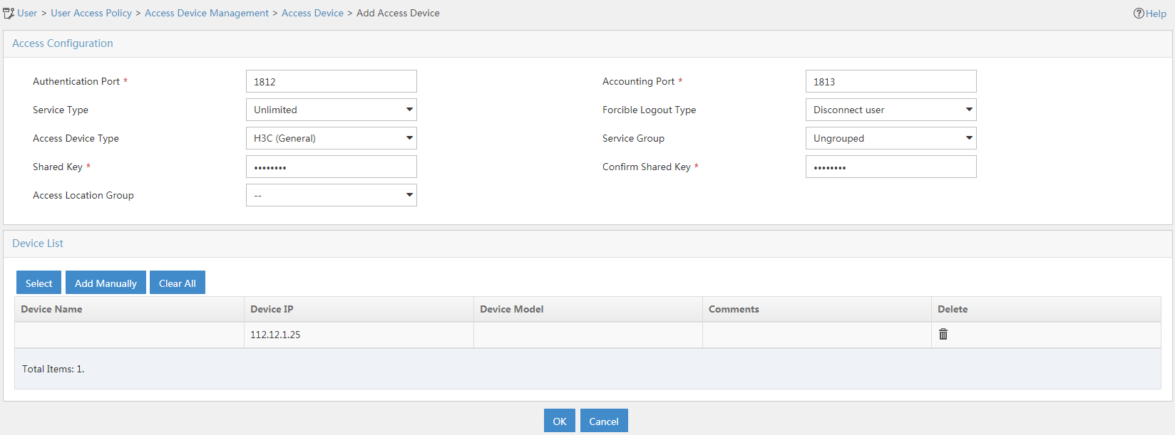

Add the AC to IMC as an access device:
1. Log in to IMC and click the User tab.
2. From the navigation tree, select User Access Policy > Access Device Management > Access Device.
3. Click Add to open the page as shown in Figure 2.
4. In the Access Configuration area, configure the parameters as follows:
¡ Set the shared key to radius, which must be the same as that on the AC.
¡ Use the default values for other parameters.
5. In the Device List area, click Add Manually to open the Add Access Device Manually page. Enter 2.2.2.1 in the Start IP field and then click OK.
6. Click OK.
Figure 2 Adding the AC as an access device

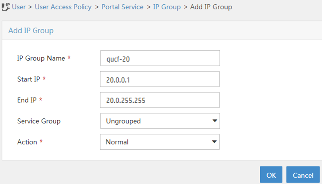

2. Configure an IP address group:
a. From the navigation tree, select User Access Policy > Portal Service > IP Group.
b. Click Add to open the page as shown in Figure 4.
c. Enter the IP group name.
d. Enter the start IP address and end IP address of the IP group.
Make sure the client IP address is in the IP group.
e. Select a service group.
This example uses the default value Ungrouped.
f. From the Action list, select Normal.
g. Click OK.
Figure 4 Adding an IP address group

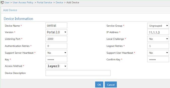

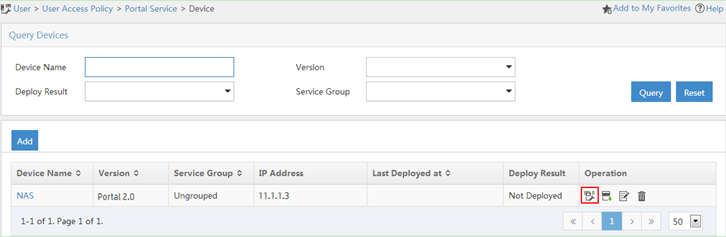

3. Add a portal device:
a. From the navigation tree, select User Access Policy > Portal Service > Device.
b. Click Add to open the page as shown in Figure 5.
c. Enter the device name.
d. Select CMCC 1.0 for Version.
e. Enter the IP address of the AC's interface connected to the client.
f. Set whether to support the portal server heartbeat and user heartbeat functions.
In this example, select No for both Support Server Heartbeat and Support User Heartbeat.
g. Enter the key, which must be the same as that configured on the AC.
h. Select Directly Connected from the Access Method list.
i. Use the default settings for other parameters.
j. Click OK.
Figure 5 Adding a portal device
4. Associate the portal device with the IP address group:
a. As shown in Figure 6, click
the Port Group icon in the Operation field for device NAS to open the port group
configuration page.
b. Click Add to open the page as shown in Figure 7.
c. Enter the port group name.
d. Select the configured IP address group.
The IP address used by the user to access the network must be within this IP address group.
e. Select Supported for Transparent Authentication.
f. Use the default settings for other parameters.
g. Click OK.

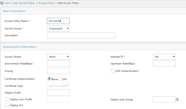

1. Add an access policy:
a. From the navigation tree, select User Access Policy > Access Policy.
b. Click Add to open the page as shown in Figure 8.
c. Enter the access policy name.
d. Select a service group.
e. Use the default settings for other parameters.
f. Click OK.
Figure 8 Adding an access policy

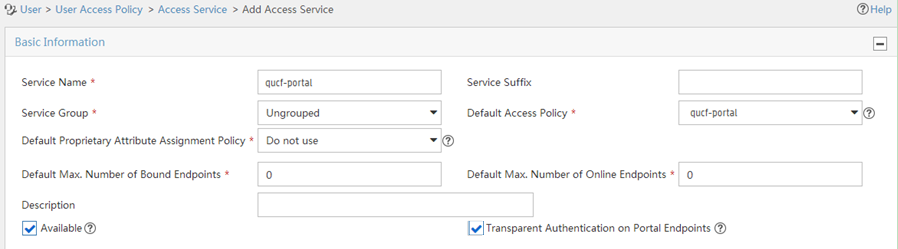

2. Add an access service:
a. From the navigation tree, select User Access Policy > Access Service.
b. Click Add to open the page as shown in Figure 9.
c. Enter the service name.
d. Select the Transparent Authentication on Portal Endpoints option.
f. Click OK.
Figure 9 Adding an access service

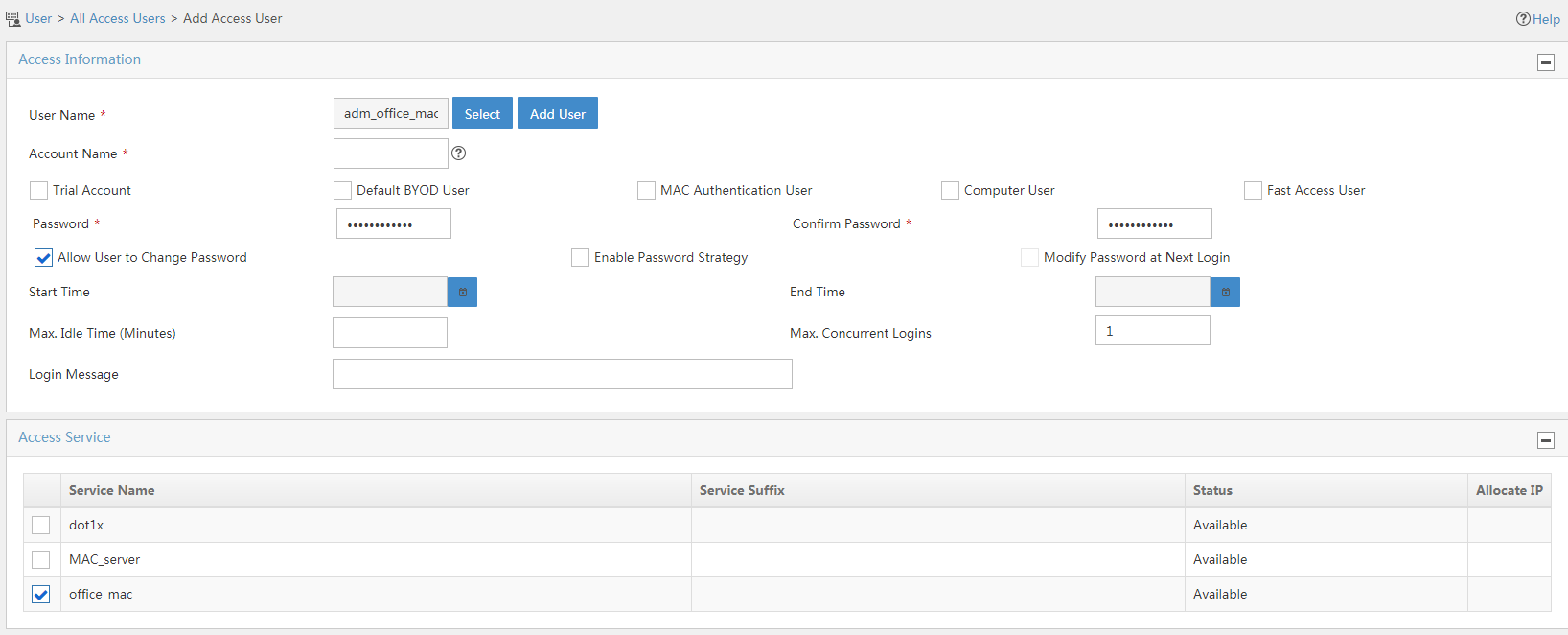

3. Add an access user:
a. From the navigation tree, select Access User > All Access Users.
b. Click Add to open the page as shown in Figure 10.
c. Select an existing access user or click Add User to add a new access user.
d. Enter the account name.
e. Set the password.
f. In the Access Service area, select the access policy configured in a previous step.
g. Use the default settings for other parameters.
h. Click OK.
Figure 10 Adding an access user
