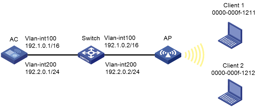

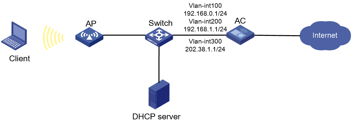

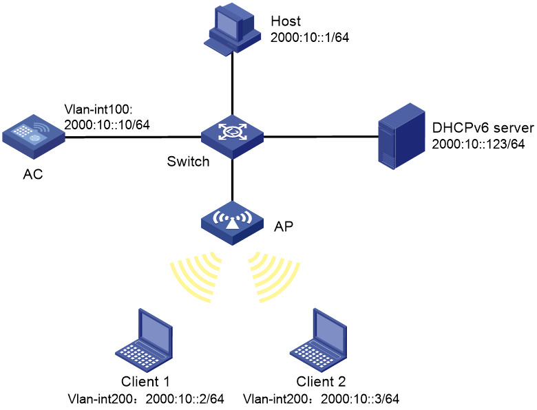

Example: Configuring NAT to allow internal users to access the external network
As shown in Figure 1, the AP and the clients obtain IP addresses through DHCP. Configure dynamic NAT on the AC's interface that connect to the external network to allow only the clients at the 192.168.1.0/24 to access the Internet.
When you configure NAT to allow internal users to access the external network, follow these restrictions and guidelines:
· If you configure NAT on VLAN interfaces, use the address group as a best practice for dynamic NAT.
· Do not include the public IP address of the VLAN interface in the nat address-group.
· If the AC uses only one public IP address of the VLAN interface for dynamic NAT, use the port-range command to specify a proper port range. As a best practice, use the port range from 10000 to 65535 to ensure that the service ports on the AC are not used by NAT.
· Make sure the devices can reach each other. In this example, the routing configuration is not shown.

[AC-wlan-st-1] client forwarding-location ac
# Enable the service template.
[AC-wlan-st-1] service-template enable
[AC-wlan-st-1] quit
Configuring the AP
In large-scale networks, configure AP groups instead of single APs as a best practice.
# Create AP officeap with model WA6320, and set the serial ID to 219801A28N819CE0002T.
[AC] wlan ap officeap model WA6320
[AC-wlan-ap-officeap] serial-id 219801A28N819CE0002T
# Create AP group group1 and add AP officeap to AP group group1.
[AC] wlan ap-group group1
[AC-wlan-ap-group-group1] ap officeap
# Bind service template 1 to radio 2 in AP group group1.
[AC-wlan-ap-group-group1] ap-model WA6320
[AC-wlan-ap-group-group1-ap-model-WA6320] radio 2
[AC-wlan-ap-group-group1-ap-model-WA6320-radio-2] service-template 1 vlan 200
# Enable radio 2.
[AC-wlan-ap-group-group1-ap-model-WA6320-radio-2] radio enable
[AC-wlan-ap-group-group1-ap-model-WA6320-radio-2] quit
[AC-wlan-ap-group-group1-ap-model-WA6320] quit
[AC-wlan-ap-group-group1] quit
Configuring dynamic NAT
# Configure address group 0. Add two public IP addresses 202.38.1.2 and 202.38.1.3 to the address range.
[AC] nat address-group 0
[AC-address-group-1] address 202.38.1.2 202.38.1.3
[AC-address-group-1] quit
# Configure ACL 2000 to identify packets sourced from 192.168.1.0/24.
[AC] acl basic 2000
[AC-acl-ipv4-adv-2000] rule permit source 192.168.1.0 0.0.0.255
[AC-acl-ipv4-adv-3000] quit
# Configure outbound dynamic IP and port translation on VLAN-interface 3000 to translate the source IP address of outgoing packets permitted by ACL 2000 into addresses in the address group 0.
[AC] interface vlan-interface 300
[AC-Vlan-interface300] nat outbound 2000 address-group 0
[AC-Vlan-interface300] quit
Configuring the switch
# Create VLAN 100. The switch will use this VLAN to forward traffic on the CAPWAP tunnel between the AC and AP.
<Switch> system-view
[Switch] vlan 100
[Switch-vlan100] quit
# Create VLAN 200. This VLAN is used to forward packets from the client.
[Switch] vlan 200
[Switch-vlan200] quit
# Configure GigabitEthernet 1/0/1, the interface that connects to the AC, as a trunk port, and assign it to VLAN 100 and VLAN 200.
[Switch] interface gigabitethernet 1/0/1
[Switch-GigabitEthernet1/0/1] port link-type trunk
[Switch-GigabitEthernet1/0/1] port trunk permit vlan 100 200
[Switch-GigabitEthernet1/0/1] quit
# Configure GigabitEthernet 1/0/1, the interface that connects to the AP, as an access port, and assign it to VLAN 100.
[Switch] interface gigabitethernet 1/0/2
[Switch-GigabitEthernet1/0/2] port link-type access
[Switch-GigabitEthernet1/0/2] port access vlan 100
# Enable PoE.
[Switch-GigabitEthernet1/0/2] poe enable
[Switch-GigabitEthernet1/0/2] quit

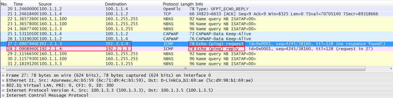

# Verify that when a user on the subnet 192.168.1.0/24 accesses the Internet, dynamic NAT is performed on the packets from the user. Execute the display nat session verbose command to display the NAT session information.
[AC] display nat session verbose
Slot 1:
Initiator:
Source IP/port: 192.168.1.2/1628
Destination IP/port: 202.38.1.100/21
DS-Lite tunnel peer: -
VPN instance/VLAN ID/Inline ID: -/-/-
Protocol: TCP(6)
Inbound interface: Vlan-interface200
Responder:
Source IP/port: 202.38.1.100/21
Destination IP/port: 202.38.1.2/1024
Protocol: TCP(6)
Inbound interface: Vlan-interface300
State: TCP_ESTABLISHED
Application: FTP
Start time: 2015-11-28 16:54:35 TTL: 2699s
Initiator->Responder: 1 packets 84 bytes
Responder->Initiator: 1 packets 84 bytes
Total sessions found: 1 s
