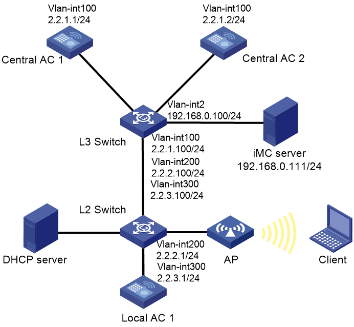

As shown in Figure 1, the AC hierarchy network contains two central ACs. The AP and client obtain an IP address from the DHCP server, and the IMC server acts as both the portal authentication server and RADIUS server. Configure the devices to meet the following requirements:
· The central ACs operate in master/backup mode and back up each other. Central AC 1 acts as the master central AC, and central AC 2 acts as the backup central AC
· The AP obtains the IP addresses of the central ACs from the DHCP server through DHCP Option 43. The AC rediscovery feature is configured on the central ACs. For the AP to associate with the local AC, enable the AC rediscovery feature in the view of the manual AP. In addition, configure the central ACs to add the IP address of the local AC to the CAPWAP Control IP Address message element in the discovery responses sent to the AP. The AP, central ACs, and the local AC are reachable to each other so that the AP can associate with a central AC when the local AC fails.
· Use direct portal authentication for wireless clients.
· Use the central ACs as the authenticator.
· Configure the AP to forward client data traffic.

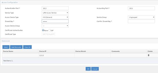

1. Add central AC 1 as an access device.
a. Log in to IMC and click the User tab.
b. From the navigation pane, select User Access Policy > Access Device Management > Access Device.
c. Click Add.
d. In the Device List area, click Add Manually to open the Add Access Device Manually page. Enter 2.2.1.1 in the Start IP field and then click OK.
e. In the Access Configuration area, set the shared key to 123456, which must be the same as that configured on the AC.
f. Use the default settings for other parameters.
g. Click OK.
Figure 2 Adding central AC 1 as an access device

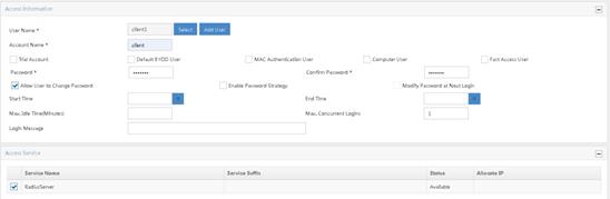

4. Add an access user.
a. From the navigation pane, select Access User > All Access Users.
b. Click Add.
c. Select an existing access user or click Add User to add a new access user.
d. In the Access Service area, select RadiusServer from the list.
e. Set the password.
g. Click OK.
Figure 5 Adding an access user

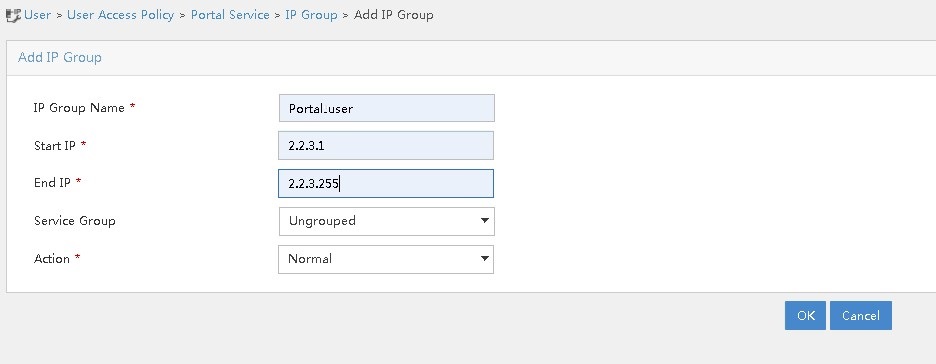

2. Configure an IP address group:
a. From the navigation pane, select User Access Policy > Portal Service > IP Group.
b. Click Add.
c. Enter the IP group name.
d. Enter the start IP address and end IP address of the IP group.
Make sure the client IP address is in the IP group.
e. Select a service group.
This example uses the default group Ungrouped.
f. Select Normal from the Action list.
g. Click OK.
Figure 7 Adding an IP address group

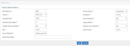

3. Add a portal device:
a. From the navigation pane, select User Access Policy > Portal Service > Device.
b. Click Add.
c. Enter the device name.
d. Select CMCC 1.0 for Version.
e. Enter the IP address of the AC's interface connected to the client.
f. Set whether to support the portal server heartbeat and user heartbeat functions.
In this example, select No for both Support Server Heartbeat and Support User Heartbeat.
g. Enter the key, which must be the same as that configured on the AC.
h. Select Directly Connected for Access Method.
i. Use the default settings for other parameters.
j. Click OK.
Figure 8 Adding a portal device

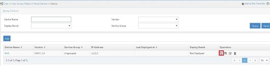

4. Associate the portal device with the IP address group:
a. Click the Port Group icon in the Operation field of device NAS.
b. Click Add.
c. Enter the port group name.
d. Select the configured IP address group.
The IP address used by the user to access the network must be within this IP address group.
e. Use the default settings for other parameters.
f. Click OK.
