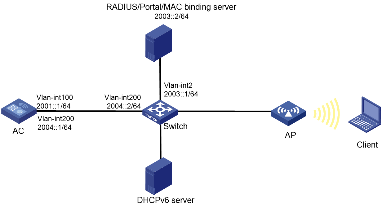

As shown in Figure 1:
· The AP and the client obtain IP addresses from the DHCP server.
· The AP and the AC use VLAN 100 to establish CAPWAP tunnels, and the client uses VLAN 200 to access the wireless network.
· The AP directly forwards traffic of the client.
· The IMC server acts as the portal authentication server, portal Web server, and RADIUS server.
· The AC performs direct portal authentication on clients. Before passing portal authentication, the client can access only the portal Web server. After passing portal authentication, the client can access other network resources.
· The client user can access network resources on any Layer 2 ports in its access VLAN without re-authentication.
· The IMC server can dynamically change authorization information for the user and can log out the user.

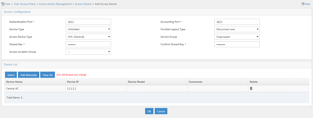

1. Add an access device:
a. Log in to IMC and click the User tab.
b. From the navigation tree, select User Access Policy > Access Device Management > Access Device.
c. Click Add to open the Add Access Device page.
d. Configure the shared key as radius.
The shared key must be the same as that configured for the RADIUS server on the AC.
e. In the Device List area, click Add Manually to open the Add Access Device Manually page. Enter the start IP address 2.2.2.1 and click OK.
f. Use the default settings for other parameters.
g. Click OK.
Figure 2 Adding an access device

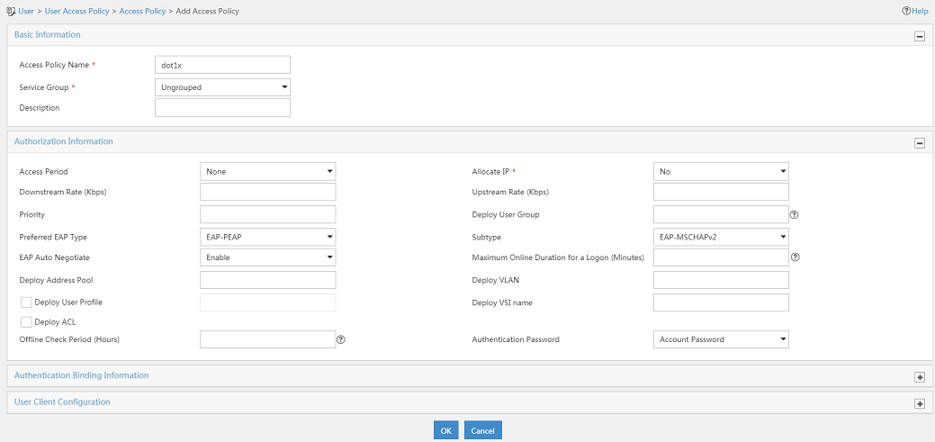

2. Add an access policy:
a. From the navigation tree, select User Access Policy > Access Policy.
b. Click Add to open the Add Access Policy page.
c. Enter the policy name.
d. Select the service group.
This example uses the default service group (Ungrouped).
e. Use the default settings for other parameters.
f. Click OK.
Figure 3 Adding an access policy

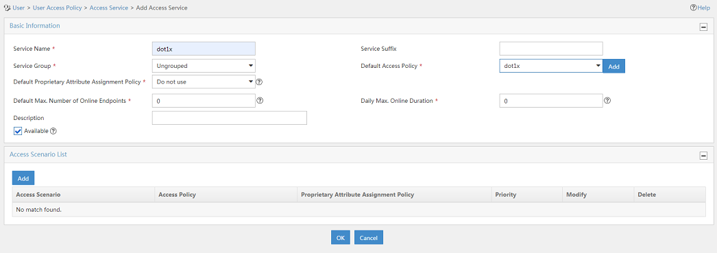

3. Add an access service:
a. From the navigation tree, select User Access Policy > Access Service.
b. Click Add to open the Add Access Service page.
c. Enter the service name.
d. Select the access policy configured in the previous step as the default access policy.
f. Click OK.
Figure 4 Adding an access service

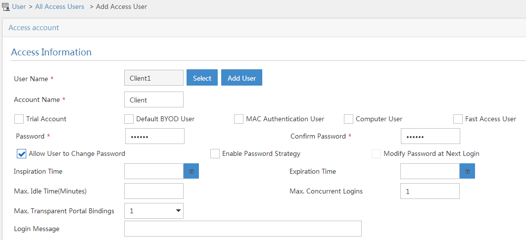

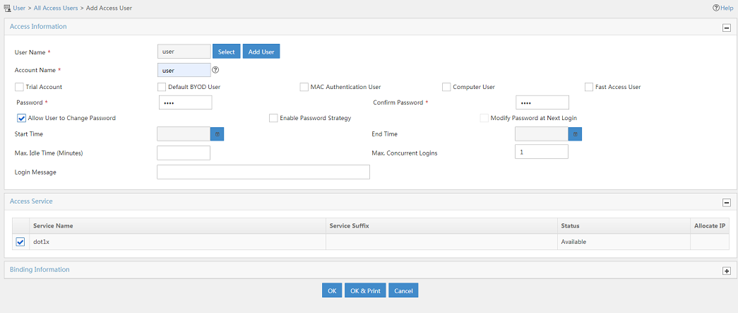

4. Add an access user:
a. From the navigation tree, select Access User > All Access Users.
b. Click Add to open the Add Access User page.
c. Set the user. If the user exists, click Select to select the existing user. If the user does not exist, click Add User to add a new user.
d. Enter the account name.
e. Enter and confirm the password.
f. In the Access Service area, select the access service configured in the previous step.
g. Use the default settings for other parameters.
h. Click OK.

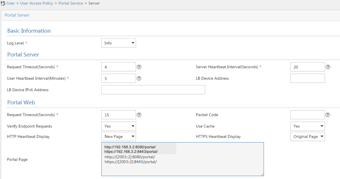

Configuring the portal server
1. Configure the portal authentication service:
b. From the navigation tree, select User Access Policy > Portal Service > Server.
c. Configure the portal server parameters.
This example uses the default settings.
d. Click OK.
Figure 6 Configuring the portal server

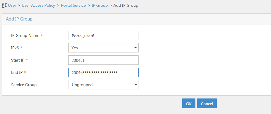

2. Configure an IP address group:
a. From the navigation tree, select User Access Policy > Portal Service > IP Group to open the portal IP address group configuration page.
b. Click Add to open the Add IP Group page.
c. Enter the IP group name.
d. Enter the start IP address and end IP address of the IP group.
Make sure the client IP address is in the IP group.
e. Select a service group.
This example uses the default group Ungrouped.
f. Select Normal from the Action list.
g. Click OK.
Figure 7 Adding an IP group
