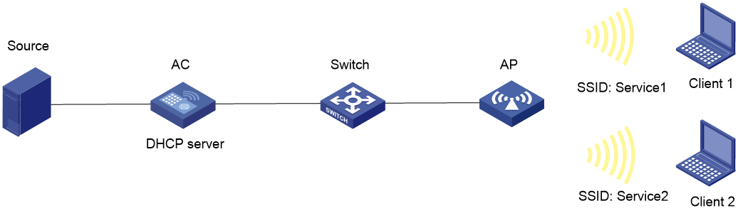

Example: Configuring local MAC authentication for wireless clients
As shown in Figure 1:
· The AC centrally forwards the client traffic.
· The AC acts as a DHCP server to provide IP addresses for the AP and the client.
Configure the AC to perform local MAC authentication to control the network access of the client. The MAC address of the client is used as the username and password for authentication. The MAC address is in hexadecimal notation without hyphens, and letters are in lower case.
When you configure local MAC authentication for wireless clients, follow these restrictions and guidelines:
· Use the serial ID labeled on the AP's rear panel to specify an AP.
· Make sure the username and password configured on the AC are the same as the MAC address of the client. The username and password formats comply with the MAC authentication user account format.
· Remove the ports that connect the AC to the AP from VLAN 1 in case there are too many packets in VLAN 1.
· Some endpoints by default use random MAC addresses. To ensure successful MAC authentication for such an endpoint, disable the endpoint from using a random MAC address.

# Create an ISP domain named local-mac and configure the ISP domain to use local authentication for LAN access wireless clients. The AC does not perform authorization and accounting for LAN access nodes (in this example, wireless clients) in the ISP domain.
[AC] domain local-mac
[AC-isp-local-mac] authentication lan-access local
[AC-isp-local-mac] accounting lan-access none
[AC-isp-local-mac] authorization lan-access none
# Configure the idle cut feature for clients in ISP domain local-mac.
[AC-isp-local-mac] authorization-attribute idle-cut 15 1024
[AC-isp-local-mac] quit
4. Configure a local user:
# Add a network access user. Configure both the username and password as the client's MAC address 3ca9f4144c20.
[AC] local-user 3ca9f4144c20 class network
[AC-luser-network-3ca9f4144c20] password simple 3ca9f4144c20
# Set the service type to lan-access.
[AC-luser-network-3ca9f4144c20] service-type lan-access
[AC-luser-network-3ca9f4144c20] quit
5. Configure the AC to use the MAC address of each user as both the username and password for MAC authentication. The MAC addresses are in hexadecimal notation without hyphens and with letters in lower case. (The configuration in this step is the default configuration. This step is optional.)
[AC] mac-authentication user-name-format mac-address without-hyphen lowercase
6. Configure a wireless service:
# Create a service template named 1 and enter its view.
[AC] wlan service-template 1
# Configure the SSID of service template 1 as service.
[AC-wlan-st-1] ssid service
# Assign clients coming online through the service template to VLAN 200.
[AC-wlan-st-1] vlan 200
# Set the PSK AKM mode and configure simple character string of 12345678 as the PSK.
[AC-wlan-st-1] akm mode psk
[AC-wlan-st-1] preshared-key pass-phrase simple 12345678
# Set the CCMP cipher suite for frame encryption and enable the RSN IE in beacon and probe responses.
[AC-wlan-st-1] cipher-suite ccmp
[AC-wlan-st-1] security-ie rsn
# Enable the AC to forward client data traffic. If the AC forwards client data traffic by default, skip this step.
[AC-wlan-st-1] client forwarding-location ac
# Set the authentication mode to MAC authentication.
[AC-wlan-st-1] client-security authentication-mode mac
# Specify ISP domain local-mac for MAC authentication clients on the service template.
[AC-wlan-st-1] mac-authentication domain local-mac
# Enable the service template.
[AC-wlan-st-1] service-template enable
[AC-wlan-st-1] quit
7. Configure AP settings:
IMPORTANT: In a large-scale network, configure AP groups as a best practice. |
# Create a manual AP named officeap, and specify the AP model and serial ID.
[AC] wlan ap officeap model WA6320
[AC-wlan-ap-officeap] serial-id 219801A28N819CE0002T
[AC-wlan-ap-officeap] quit
# Create AP group group1 and create an AP grouping rule by AP names to add AP officeap to AP group group1.
[AC] wlan ap-group group1
[AC-wlan-ap-group-group1] ap officeap
# Bind service template 1 to radio 2 in AP group group1.
[AC-wlan-ap-group-group1] ap-model WA6320
[AC-wlan-ap-group-group1-ap-model-WA6320] radio 2
[AC-wlan-ap-group-group1-ap-model-WA6320-radio-2] service-template 1
# Enable radio 2.
[AC-wlan-ap-group-group1-ap-model-WA6320-radio-2] radio enable
[AC-wlan-ap-group-group1-ap-model-WA6320-radio-2] quit
[AC-wlan-ap-group-group1-ap-model-WA6320] quit
[AC-wlan-ap-group-group1] quit
Configuring the switch
# Create VLAN 100. The switch will use this VLAN to forward the traffic on the CAPWAP tunnels between the AC and AP.
<Switch> system-view
[Switch] vlan 100
[Switch-vlan100] quit
# Create VLAN 200. The switch will use this VLAN to forward packets for wireless clients.
[Switch] vlan 200
[Switch-vlan200] quit
# Configure GigabitEthernet 1/0/1 (the port connected to the AC) as a trunk port, remove the port from VLAN 1, and assign the trunk port to VLAN 100.
[Switch] interface gigabitethernet 1/0/1
[Switch-GigabitEthernet1/0/1] port link-type trunk
[Switch-GigabitEthernet1/0/1] undo port trunk permit vlan 1
[Switch-GigabitEthernet1/0/1] port trunk permit vlan 100
[Switch-GigabitEthernet1/0/1] quit
# Configure GigabitEthernet 1/0/2 (the port connected to the AP) as an access port. Assign the access port to VLAN 100.
[Switch] interface gigabitethernet 1/0/2
[Switch-GigabitEthernet1/0/2] port link-type access
[Switch-GigabitEthernet1/0/2] port access vlan 100
# Enable PoE on GigabitEthernet 1/0/2.
[Switch-GigabitEthernet1/0/2] poe enable
[Switch-GigabitEthernet1/0/2] quit
# The client requests to access the network. On the AC, verify that the client has passed MAC authentication and come online on VLAN 200.
[AC] display wlan client
Total number of clients: 1
MAC address User name AP name R IP address VLAN
3ca9-f414-4c20 3ca9f4144c20 officeap 2 112.13.0.2 200
