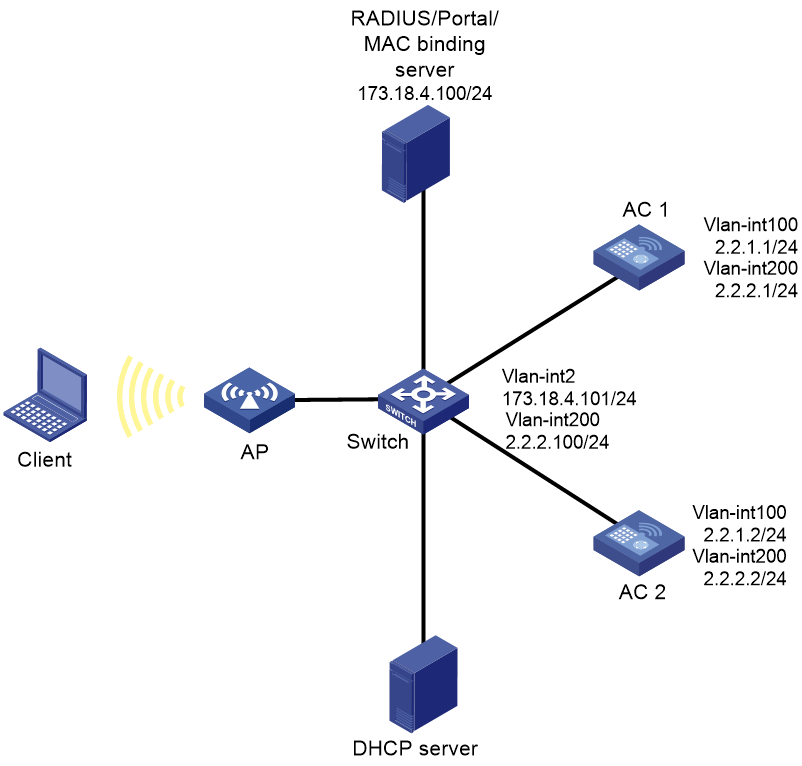

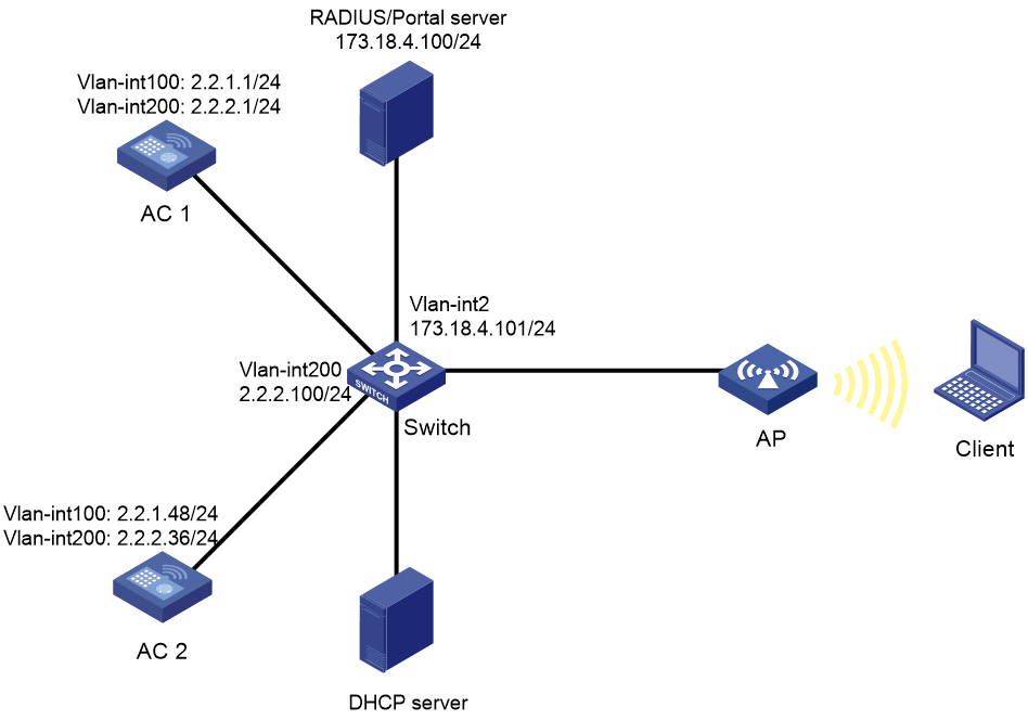

Example: Configuring remote portal MAC-trigger authentication for dual-link AC backup and centralized forwarding

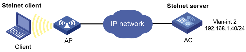

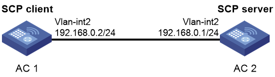

As shown in Figure 1, the AP and the client obtain IP addresses from the DHCP server. The IMC server acts as the portal authentication server, portal Web server, and RADIUS server.
Configure the devices to meet the following requirements:
· The AP associates with both ACs and the two ACs to back up each other. When the master AC (AC 1) fails, the backup AC (AC 2) takes over, and the AP can provide services correctly through the backup AC.
· Before passing portal authentication, the client can access only the portal Web server. After passing the authentication, the client can access other network resources.
· The client can access network resources through any Layer 2 ports in its access VLAN without re-authentication.
· The IMC server can dynamically modify user authorization information and log off clients.

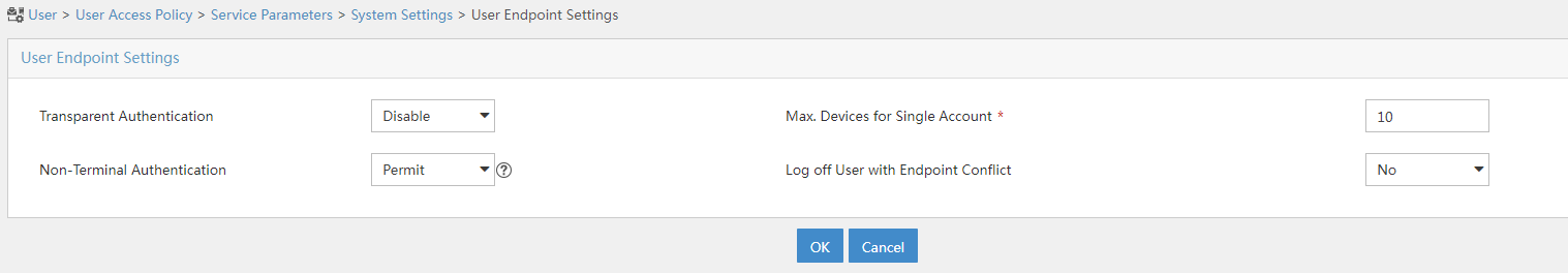

When you configure remote portal MAC-trigger authentication for dual-link AC backup and centralized forwarding, follow these restrictions and guidelines:
· Use the actual serial ID of an AP to uniquely identify that AP.
· Make sure the portal authentication server type, portal Web server type, and MAC binding server type configured on the ACs are the same as the actual server type. This example uses a China Mobile server.
· URLs redirected from the ACs to the portal Web server do not carry parameters by default. You can configure the parameters to carry as needed.
· To avoid possible authentication failure caused by frequent logins and logouts of portal clients in a short time, disable the Rule ARP entry feature.
· If you configure manual APs, make sure the manual APs configured on the two ACs have the same AP name and identifier (serial ID or MAC address).
· Make sure the two ACs are of the same version.
· Some clients are enabled with MAC randomization by default, which might cause seamless roaming failures. As a best practice, disable MAC randomization.

[AC1] interface gigabitethernet 1/0/1
[AC1-GigabitEthernet1/0/1] port link-type trunk
[AC1-GigabitEthernet1/0/1] port trunk permit vlan 100 200
[AC1-GigabitEthernet1/0/1] quit
2. Create a static route to the IMC server.
[AC1] ip route-static 173.18.4.0 255.255.255.0 2.2.2.100

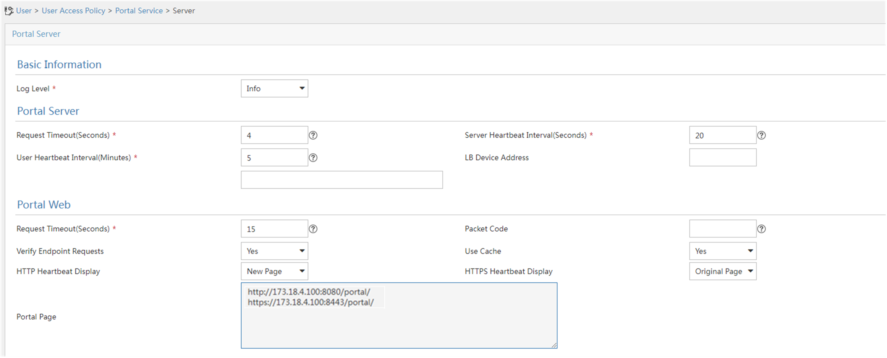

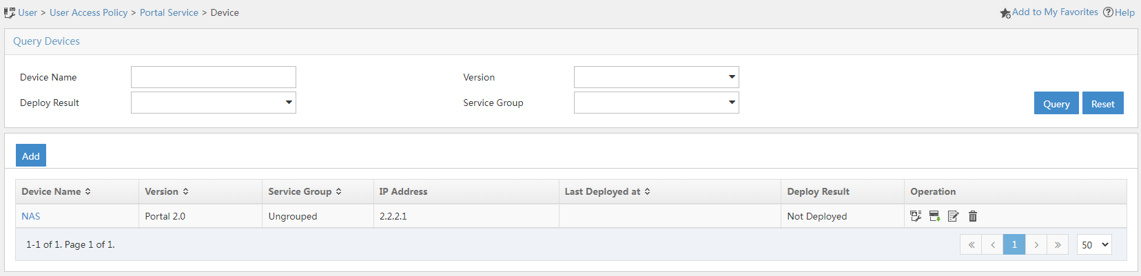

7. Configure portal authentication:
# Create the portal authentication server newpt, specify the server IP address as 173.18.4.100, and set the destination UDP port number to 50100 for the AC to send unsolicited portal packets to the portal authentication server.
[AC1] portal server newpt
[AC1-portal-server-newpt] ip 173.18.4.100 key simple newpt
[AC1-portal-server-newpt] port 50100
# Specify the portal authentication server type as CMCC.
[AC1-portal-server-newpt] server-type cmcc
[AC1-portal-server-newpt] quit
# Configure the URL for the portal Web server newpt as http://173.18.4.100:8080/portal.
[AC1] portal web-server newpt
[AC1-portal-websvr-newpt] url http://173.18.4.100:8080/portal

Configuring AC 2
1. Configure AC interfaces:
# Create VLAN 100 and VLAN-interface 100. Assign the VLAN interface an IP address. The AC will use this IP address to establish a CAPWAP tunnel with the AP.
<AC2> system-view
[AC2] vlan 100
[AC2-vlan100] quit
[AC2] interface vlan-interface 100
[AC2-Vlan-interface100] ip address 2.2.1.2 24
[AC2-Vlan-interface100] quit
# Create VLAN 200. This VLAN will be used for wireless client access.
[AC2] vlan 200
[AC2-vlan200] quit
[AC2] interface vlan-interface 200
[AC2-Vlan-interface200] ip address 2.2.2.2 24
[AC2-Vlan-interface200] quit
# Configure GigabitEthernet1/0/1 that connects AC 2 to the switch as a trunk port, and assign it to VLAN 100 and VLAN 200.
[AC2] interface gigabitethernet 1/0/1
[AC2-GigabitEthernet1/0/1] port link-type trunk
[AC2-GigabitEthernet1/0/1] port trunk permit vlan 100 200
[AC2-GigabitEthernet1/0/1] quit
[AC2] ip route-static 173.18.4.0 255.255.255.0 2.2.2.100

Configuring the switch
# Create VLAN 100 for forwarding CAPWAP tunnel traffic between AC and AP.
<Switch> system-view
[Switch] vlan 100
[Switch-vlan100] quit
# Create VLAN 200 for forwarding client traffic.
[Switch] vlan 200
[Switch-vlan200] quit
# Create VLAN 2 for connecting to the IMC server.
[Switch] vlan 2
[Switch-vlan2] quit
# Add the interface that connects the switch to the IMC server to VLAN 2. (Details not shown.)
# Configure the interface that connects the switch to the DHCP server. (Details not shown.)
# Configure GigabitEthernet 1/0/1 that connects the switch to AC 1 as a trunk port, and assign it to VLAN 100 and VLAN 200.
[Switch] interface gigabitethernet 1/0/1
[Switch-GigabitEthernet1/0/1] port link-type trunk
[Switch-GigabitEthernet1/0/1] port trunk permit vlan 100 200
[Switch-GigabitEthernet1/0/1] quit
# Configure GigabitEthernet 1/0/3 that connects the switch to AC 2 as a trunk port, and assign it to VLAN 100 and VLAN 200.
[Switch] interface gigabitethernet 1/0/3
[Switch-GigabitEthernet1/0/3] port link-type trunk
[Switch-GigabitEthernet1/0/3] port trunk permit vlan 100 200
[Switch-GigabitEthernet1/0/3] quit
# Configure GigabitEthernet 1/0/2 that connects the switch to the AP as an access port, and assign it to VLAN 100.
[Switch] interface gigabitethernet 1/0/2
[Switch-GigabitEthernet1/0/2] port link-type access
[Switch-GigabitEthernet1/0/2] port access vlan 100
# Enable PoE.
[Switch-GigabitEthernet1/0/2] poe enable
[Switch-GigabitEthernet1/0/2] quit
# Assign an IP address to VLAN-interface 200.
[Switch] interface vlan-interface 200
[Switch-Vlan-interface200] ip address 2.2.2.100 255.255.255.0
[Switch-Vlan-interface200] quit
# Assign an IP address to VLAN-interface 2. This address will be used as the gateway address for the IMC server.
[Switch-Vlan-interface2] ip address 173.18.4.101 255.255.255.0
[Switch-Vlan-interface2] quit

1. Configure portal authentication:
a. Click the User tab.
b. Select User Access Policy > Portal Service > Server from the navigation tree to open the portal server configuration page.
c. Configure the portal server parameters as needed.
This example uses the default settings.
d. Click OK.
Figure 3 Portal authentication server configuration

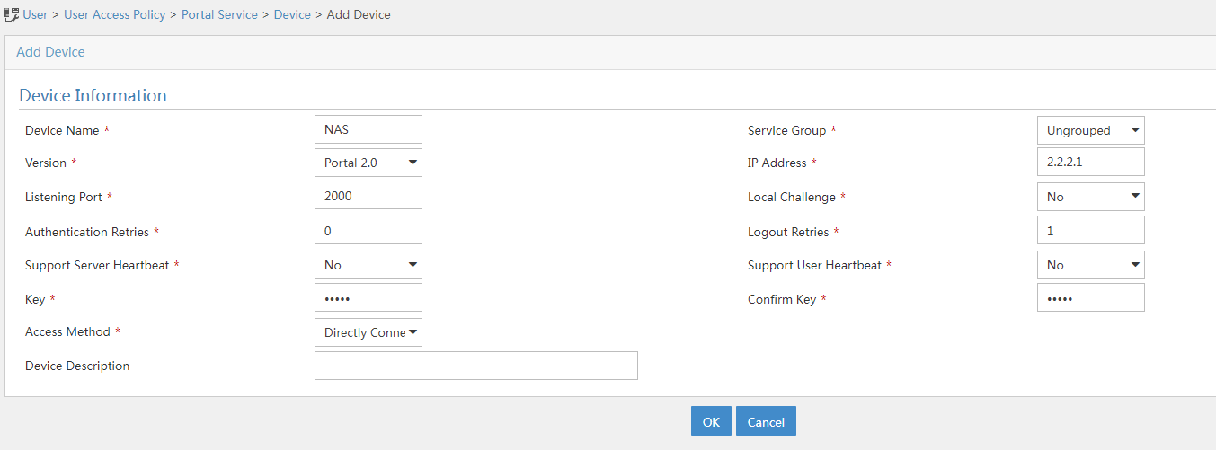

3. Add a portal device:
a. Select User Access Policy > Portal Service > Device from the navigation tree to open the portal device configuration page.
b. Click Add to open the page as shown in Figure 5.
c. Enter the device name. In this example, the name is NAS.
d. Specify the version as Portal 2.0.
e. Enter the IP address (2.2.2.1) of the AC's interface connected to the client.
f. Set whether to support the portal server heartbeat and user heartbeat functions.
In this example, select No for both Support Server Heartbeat and Support User Heartbeat.
g. Enter the key, which must be the same as that configured on the AC.
h. Select Directly Connected from the Access Method list.
i. Use the default settings for other parameters.
j. Click OK.
Figure 5 Adding a portal device

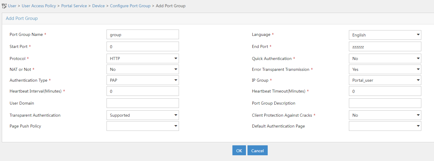

4. Associate the portal device with the IP address group:
a. As shown in Figure 6,
click the Port Group Information Management icon for the device to
open the port group configuration page.
b. Click Add to open the page as shown in Figure 7.
c. Enter the port group name. In this example, the name is group.
d. Select the configured IP address group.
The IP address used by the user to access the network must be within this IP address group.
e. Select Supported for Transparent Authentication.
f. Use the default settings for other parameters.
g. Click OK.
h. From the navigation tree, select Intelligent Portal Management > User Management > Users.

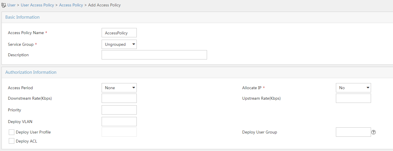

1. Add an access policy:
a. Select User Access Policy > Access Policy from the navigation tree to open the access policy page.
b. Click Add to open the page as shown in Figure 8.
c. Enter the access policy name. In this example, the name is AccessPolicy.
d. Select Ungrouped from the service group list.
e. Use the default settings for other parameters.
f. Click OK.
Figure 8 Adding an access policy

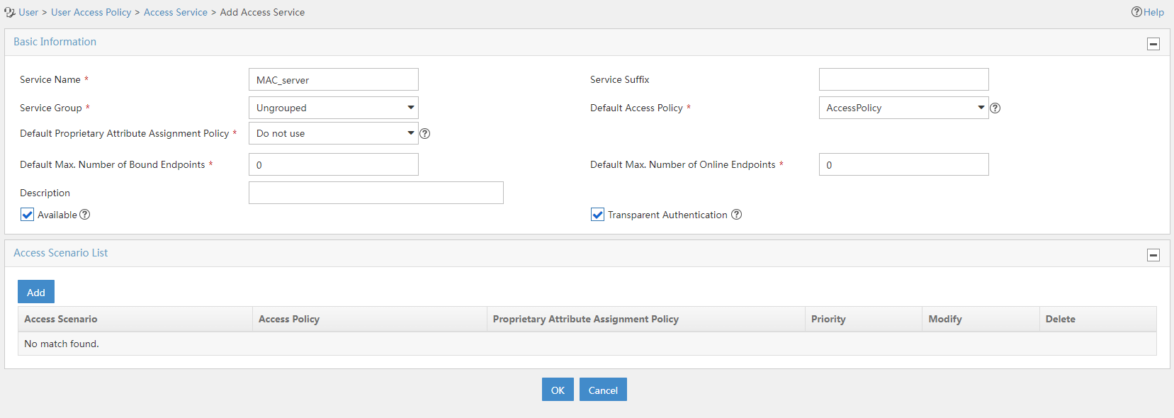

2. Add an access service:
a. Select User Access Policy > Access Service from the navigation tree to open the access service page.
b. Click Add to open the page as shown in Figure 9.
c. Enter the service name. In this example, the service name is MAC_server.
d. Select the Transparent Authentication on Portal Endpoints option.
f. Click OK.
Figure 9 Adding an access service

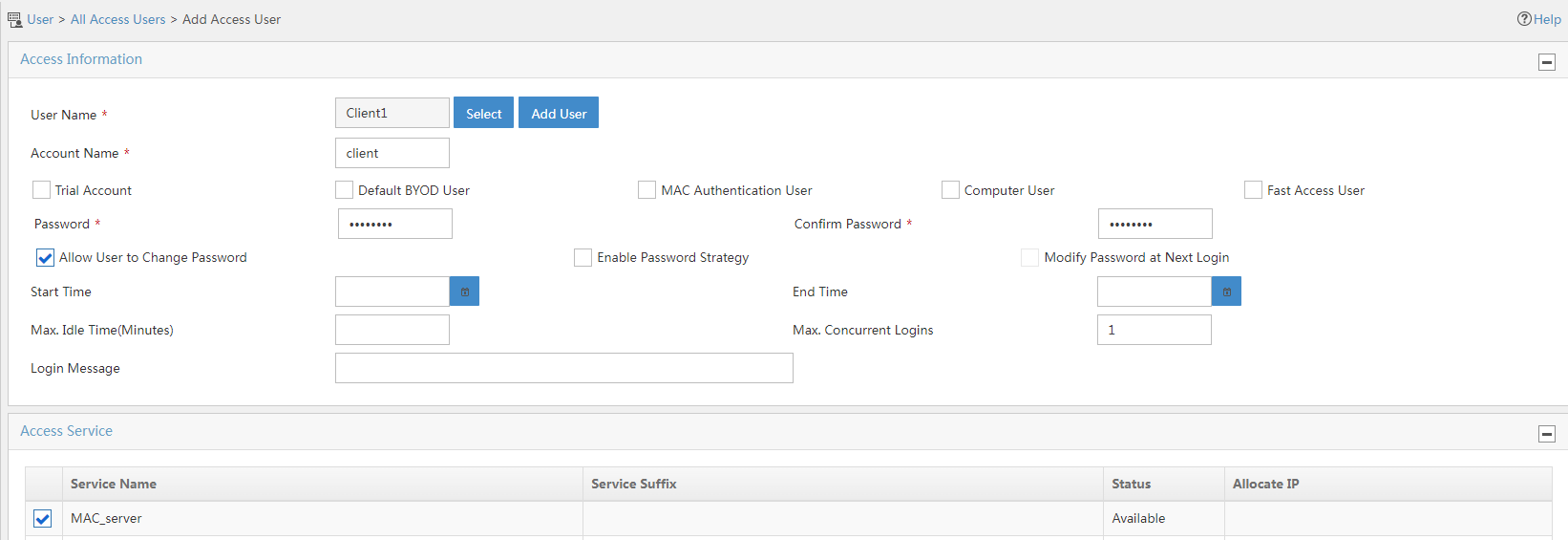

3. Add an access user:
a. Select Access User > All Access Users from the navigation tree to open the access user page.
b. Click Add to open the page as shown in Figure 10.
c. Select or add an access user. In this example, the account name is client.
d. Set the password. In this example, the password is wireless.
e. Specify the number of limited online clients.
f. Retain the default settings for other parameters.
g. Select the configured service.
h. Click OK.
Figure 10 Adding an access user

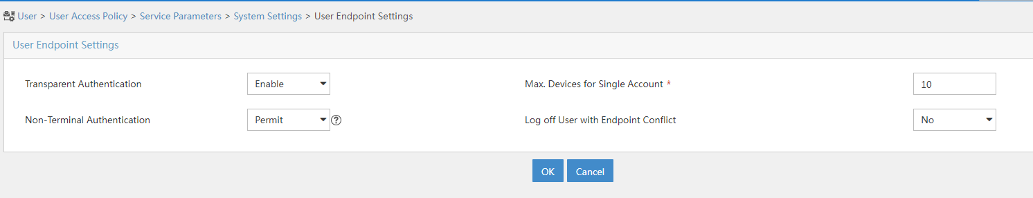

4. Configure system parameters:
a. Select User Access Policy > Service Parameters > System Settings from the navigation tree to open the system settings page.
b. Click the Configure
icon for User Endpoint Settings to open the page as shown in Figure 11.
c. Enable Transparent MAC Authentication.
d. Select whether to enable transparent portal authentication on non-smart devices.
In this example, select Enable for Non-Terminal Authentication.
e. Click OK.

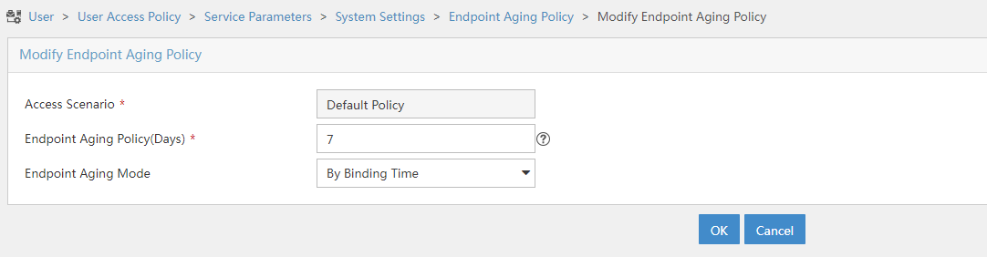

f. Click the Configure
icon for Endpoint Aging Time to open the page as shown in Figure 12.
g. Set the endpoint aging time as needed.
This example uses the default value.
Figure 11 Configuring user endpoint settings

# Make the AP come online.
# Verify that the AP first associates with AC 1. Shut down VLAN-interface 100 on AC 1, wait 3 minutes, and verify that the AP associates with AC 2 and the AP state on AC 2 is R/M.
[AC2] display wlan ap all
Total number of APs: 1
Total number of connected APs: 1
Total number of connected manual APs: 1
Total number of connected auto APs: 0
Total number of connected common APs: 1
Total number of connected WTUs: 0
Total number of inside APs: 0
Maximum supported APs: 10
Remaining APs: 9
Total AP licenses: 10
Local AP licenses: 10
Server AP licenses: 0
Remaining Local AP licenses: 9
Sync AP licenses: 0
AP information
State : I = Idle, J = Join, JA = JoinAck, IL = ImageLoad
C = Config, DC = DataCheck, R = Run, M = Master, B = Backup
AP name APID State Model Serial ID
office 1 R/M WA6320 219801A28N819CE0002T
# Bring up VLAN-interface 100 on AC 1. Verify that the AP state becomes R/M on AC 1 and R/B on AC 2.
[AC1] display wlan ap all
Remaining APs: 9
Sync AP licenses: 0
AP information
Remaining APs: 9
Remaining Local AP licenses: 10
Sync AP licenses: 0
AP information
office 1 R/B WA6320 219801A28N819CE0002T
