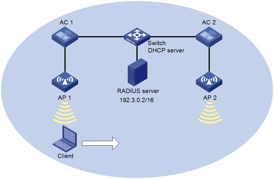

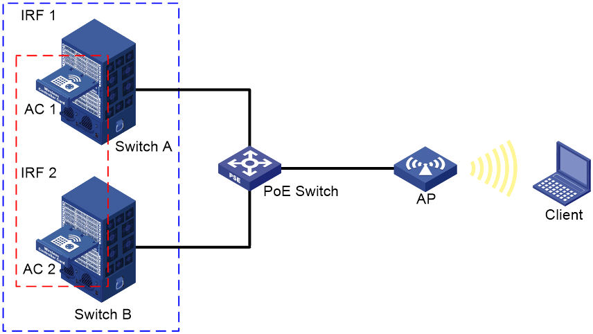

As shown in Figure 1, AP 1 and AP 2 are managed by AC 1 and AC 2, respectively. Clients associated with AC 1 belong to VLAN 200. Clients associated with AC 2 belong to VLAN 400.
Complete the following tasks:
· Configure inter-AC roaming to enable clients to roam between AP 1 and AP 2.
· Configure VLAN-based user isolation to improve user security and reduce radio resources consumption caused by multicast and broadcast packets.
Interface |
IP address |
Device |
Interface |
IP address |
AC 1 |
VLAN-interface 100 |
192.1.0.2/16 |
Switch |
192.1.0.1/16 |
VLAN-interface 200 |
192.2.0.2/16 |
192.2.0.1/16 |
AC 2 |
192.1.0.3/16 |
VLAN-interface 300 |
192.3.0.1/16 |
VLAN-interface 400 |
192.4.0.2/16 |
192.4.0.1/16 |

2. Configure 802.1X authentication:
# Set the EAP message handling method to EAP.
[AC1] dot1x authentication-method eap
# Create a RADIUS scheme named office and enter its view.
[AC1] radius scheme office
# Specify the server at 192.3.0.2 as the primary authentication server.
[AC1-radius-office] primary authentication 192.3.0.2
# Specify the server at 192.3.0.2 as the primary accounting server.
[AC1-radius-office] primary accounting 192.3.0.2
# Set the shared key to 12345678 for secure communication with the primary authentication server and accounting server.
[AC1-radius-office] key authentication simple 12345678
[AC1-radius-office] key accounting simple 12345678
# Set the source IP address to 192.1.0.2 for outgoing RADIUS packets.
[AC1-radius-office] nas-ip 192.1.0.2
[AC1-radius-office] quit
# Create an ISP domain named office and enter its view.
[AC1] domain office
# Configure the ISP domain to use RADIUS scheme office for authentication, authorization, and accounting of LAN users.
[AC1-isp-office] authentication lan-access radius-scheme office
[AC1-isp-office] authorization lan-access radius-scheme office
[AC1-isp-office] accounting lan-access radius-scheme office
[AC1-isp-office] quit
3. Configure the wireless service:
# Create service template 1 and enter its view.
[AC1] wlan service-template 1
# Set the SSID to service.
[AC1-wlan-st-1] ssid service
# Assign clients coming online through the service template to VLAN 200.
[AC1-wlan-st-1] vlan 200
# Use the AC to forward client traffic.
[AC1-wlan-st-1] client forwarding-location ac
# Set the AKE mode to 802.1X.
[AC1-wlan-st-1] akm mode dot1x
# Set the authentication mode to 802.1X for wireless clients.
[AC1-wlan-st-1] client-security authentication-mode dot1x
# Specify ISP domain office as the authentication domain for 802.1X clients.
[AC1-wlan-st-1] dot1x domain office
# Specify AES-CCMP as the cipher suite used for frame encryption.
[AC1-wlan-st-1] cipher-suite ccmp
# Enable the RSN IE in beacon and probe responses.
[AC1-wlan-st-1] security-ie rsn
# Enable the service template.
[AC1-wlan-st-1] service-template enable
[AC1-wlan-st-1] quit
4. Configure an AP:
NOTE: In a large-scale network, configure AP settings in AP group view instead of AP view as a best practice. |
# Create an AP named ap1, and specify its model and the serial ID.
[AC1] wlan ap ap1 model WA6320
[AC1-wlan-ap-ap1] serial-id 219801A28N819CE0002X
# Create AP group group1 and configure an grouping rule by AP name to add AP ap1 to the group.
[AC1] wlan ap-group group1
[AC1-wlan-ap-group-group1] ap ap1
[AC1-wlan-ap-group-group1] ap-model WA6320
# Bind service template 1 to radio 1 and enable radio 1.
[AC1-wlan-ap-group-group1-ap-model-WA6320] radio 1
[AC1-wlan-ap-group-group1-ap-model-WA6320-radio-1] service-template 1
[AC1-wlan-ap-group-group1-ap-model-WA6320-radio-1] radio enable
[AC1-wlan-ap-group-group1-ap-model-WA6320-radio-1] quit
[AC1-wlan-ap-group-group1-ap-model-WA6320] quit
[AC1-wlan-ap-group-group1] quit
5. Configure WLAN roaming:
# Create mobility group 1.
[AC1] wlan mobility group 1
# Set the source IP address for establishing IACTP tunnels to 192.1.0.2.
[AC1-wlan-mg-1] source ip 192.1.0.2
# Add AC 2 to the mobility group.
[AC1-wlan-mg-1] member ip 192.1.0.3
# Enable the mobility group.
[AC1-wlan-mg-1] group enable
[AC1-wlan-mg-1] quit
6. Configure user isolation:
# Enable user isolation for VLAN 200.
[AC1] user-isolation vlan 200 enable
# Specify the MAC address of the gateway for VLAN 200 as a permitted MAC address for VLAN 200.
[AC1] user-isolation vlan 200 permit-mac 000f-e212-7788
7. Configure a default route:
# Configure a default route for AC 1. Set the next hop to 192.1.0.1.
[AC1] ip route-static 0.0.0.0 0.0.0.0 192.1.0.1
Configuring AC 2
1. Configure interfaces on AC 2:
# Create VLAN 100 and VLAN-interface 100, and assign an IP address to the VLAN interface. The AC will use this IP address to establish CAPWAP tunnels with APs.
<AC2> system-view
[AC2] vlan 100
[AC2-vlan100] quit
[AC2] interface vlan-interface 100
[AC2-Vlan-interface100] ip address 192.1.0.3 16
[AC2-Vlan-interface100] quit
# Create VLAN 200. The AC will use VLAN 200 to forward data of the client after the client roams from AP 1 to AP 2.
<AC2> system-view
[AC2] vlan 200
[AC2-vlan200] quit
# Create VLAN 400 and VLAN-interface 400, and assign an IP address to the VLAN interface. The AC will use VLAN 400 for client access.
[AC2] vlan 400
[AC2-vlan400] quit
[AC2] interface vlan-interface 400
[AC2-Vlan-interface400] ip address 192.4.0.2 16
[AC2-Vlan-interface400] quit
# Configure the interface that is connected to the switch as a trunk port, and assign the port to VLAN 100, VLAN 200, and VLAN 400.
[AC2] interface gigabitethernet 1/0/1
[AC2-GigabitEthernet1/0/1] port link-type trunk
[AC2-GigabitEthernet1/0/1] port trunk permit vlan 100 200 400
[AC2-GigabitEthernet1/0/1] quit
# Configure the interface that is connected to AP 2 as an access port, and assign the port to VLAN 100.
[AC2] interface gigabitethernet 1/0/2
[AC2-GigabitEthernet1/0/2] port link-type access
[AC2-GigabitEthernet1/0/2] port access vlan 100
[AC2-GigabitEthernet1/0/2] quit
[AC2] dot1x authentication-method eap
[AC2] radius scheme office
[AC2-radius-office] primary authentication 192.3.0.2
[AC2-radius-office] primary accounting 192.3.0.2
# Set the shared key to 12345678 in plaintext form for secure authentication communication.
[AC2-radius-office] key authentication simple 12345678
# Set the shared key to 12345678 in plaintext form for secure accounting communication.
[AC2-radius-office] key accounting simple 12345678
# Set the source IP address to 192.1.0.3 for outgoing RADIUS packets.
[AC2-radius-office] nas-ip 192.1.0.3
[AC2-radius-office] quit
[AC2] domain office
[AC2-isp-office] authentication lan-access radius-scheme office
[AC2-isp-office] authorization lan-access radius-scheme office
[AC2-isp-office] accounting lan-access radius-scheme office
[AC2-isp-office] quit
[AC2] wlan service-template 1
[AC2-wlan-st-1] ssid service
# Assign clients coming online through the service template to VLAN 400.
[AC2-wlan-st-1] vlan 400
[AC2-wlan-st-1] akm mode dot1x
[AC2-wlan-st-1] client-security authentication-mode dot1x
[AC2-wlan-st-1] dot1x domain office
[AC2-wlan-st-1] cipher-suite ccmp
[AC2-wlan-st-1] security-ie rsn
[AC2-wlan-st-1] service-template enable
[AC2-wlan-st-1] quit
4. Configure an AP:
# Create an AP named ap2, and specify its model and the serial ID.
[AC2] wlan ap ap2 model WA6320
[AC2-wlan-ap-ap2] serial-id 219801A28N819CE0002T
# Create AP group named group2, and add a grouping rule by AP name to add AP ap2 to the group.
[AC2] wlan ap-group group2
[AC2-wlan-ap-group-group2] ap ap2
[AC2-wlan-ap-group-group2] ap-model WA6320
[AC2-wlan-ap-group-group2-ap-model-WA6320] radio 1
[AC2-wlan-ap-group-group2-ap-model-WA6320-radio-1] service-template 1
[AC2-wlan-ap-group-group2-ap-model-WA6320-radio-1] radio enable
[AC2-wlan-ap-group-group2-ap-model-WA6320-radio-1] quit
[AC2-wlan-ap-group-group2-ap-model-WA6320] quit
[AC2-wlan-ap-group-group2] quit
[AC2] wlan mobility group 1
# Set the source IP address for establishing IACTP tunnels to 192.1.0.3.
[AC2-wlan-mg-1] source ip 192.1.0.3
# Add AC 1 to the mobility group.
[AC2-wlan-mg-1] member ip 192.1.0.2
[AC2-wlan-mg-1] group enable
[AC2-wlan-mg-1] quit
# Enable user isolation for VLAN 400.
[AC2] user-isolation vlan 400 enable
# Specify the MAC address of the gateway for VLAN 400 as a permitted MAC address for VLAN 400.
[AC2] user-isolation vlan 400 permit-mac 000f-eeee-1212
# Configure a default route for AC 2. Set the next hop to 192.1.0.1.
[AC2] ip route-static 0.0.0.0 0.0.0.0 192.1.0.1
Configuring the switch
1. Configure interfaces on the switch:
# Create VLAN 100 and VLAN-interface 100, and assign an IP address to the VLAN interface. The switch will use VLAN 100 to forward the traffic on CAPWAP tunnels between the AC and APs.
<Switch> system-view
[Switch] vlan 100
[Switch-vlan100] quit
[Switch-Vlan-interface100] ip address 192.1.0.1 16
# Create VLAN 200 and VLAN-interface 200, and assign an IP address to the VLAN interface. The switch will use VLAN 200 to forward client traffic of AC 1.
[Switch] vlan 200
[Switch-vlan200] quit
[Switch] interface vlan-interface 200
[Switch-Vlan-interface200] ip address 192.2.0.1 16
[Switch-Vlan-interface200] quit
# Create VLAN 400 and VLAN-interface 400, and assign an IP address to the VLAN interface. The switch will use VLAN 400 to forward client traffic of AC 2.
[Switch] vlan 400
[Switch-vlan400] quit
[Switch] interface vlan-interface 400
[Switch-Vlan-interface400] ip address 192.4.0.1 16
[Switch-Vlan-interface400] quit
# Create VLAN 300 and VLAN-interface 300, and assign an IP address to the VLAN interface. The switch will use VLAN 300 to forward traffic to the RADIUS server.
[Switch] vlan 300
[Switch-vlan300] quit
[Switch] interface vlan-interface 300
[Switch-Vlan-interface300] ip address 192.3.0.1 16
[Switch-Vlan-interface300] quit
# Configure the interface that is connected to AC 1 as a trunk port, and assign the port to VLAN 100, VLAN 200, and VLAN 400.
[Switch] interface gigabitethernet 1/0/1
[Switch-GigabitEthernet1/0/1] port link-type trunk
[Switch-GigabitEthernet1/0/1] port trunk permit vlan 100 200 400
[Switch-GigabitEthernet1/0/1] quit
# Configure the interface that is connected to AC 2 as a trunk port, and assign the port to VLAN 100, VLAN 200, and VLAN 400.
[Switch] interface gigabitethernet 1/0/2
[Switch-GigabitEthernet1/0/2] port link-type trunk
[Switch-GigabitEthernet1/0/2] port trunk permit vlan 100 200 400
[Switch-GigabitEthernet1/0/2] quit
# Configure the interface that is connected to the RADIUS server as an access port, and assign the port to VLAN 300.
[Switch] interface gigabitethernet 1/0/3
[Switch-GigabitEthernet1/0/3] port link-type access
[Switch-GigabitEthernet1/0/3] port access vlan 300
[Switch-GigabitEthernet1/0/3] quit
2. Configure the DHCP server:
# Enable the DHCP service.
[Switch] dhcp enable
# Create a DHCP address pool named vlan100 for the APs. Specify the 192.1.0.0/16 subnet for the pool and exclude IP addresses 192.1.0.2 and 192.1.0.3 from dynamic allocation. Set the gateway IP address to 192.1.0.1.
[Switch] dhcp server ip-pool vlan100
[Switch-dhcp-pool-vlan100] network 192.1.0.0 mask 255.255.0.0
[Switch-dhcp-pool-vlan100] forbidden-ip 192.1.0.2 192.1.0.3
[Switch-dhcp-pool-vlan100] gateway-list 192.1.0.1
[Switch-dhcp-pool-vlan100] quit
# Create a DHCP address pool named vlan200 for the clients. Specify the 192.2.0.0/16 subnet for the pool and exclude IP address 192.2.0.2 from dynamic allocation. Set the gateway IP address to 192.2.0.1 and specify the DNS server address. In this example, the gateway also acts as a DNS server.
[Switch] dhcp server ip-pool vlan200
[Switch-dhcp-pool-vlan200] network 192.2.0.0 mask 255.255.0.0
[Switch-dhcp-pool-vlan200] forbidden-ip 192.2.0.2
[Switch-dhcp-pool-vlan200] gateway-list 192.2.0.1
[Switch-dhcp-pool-vlan200] dns-list 192.2.0.1
[Switch-dhcp-pool-vlan200] quit
# Create a DHCP address pool named vlan400 for the clients. Specify the 192.4.0.0/16 subnet for the pool and exclude IP address 192.4.0.2 from dynamic allocation. Set the gateway IP address to 192.4.0.1 and specify the DNS server address. In this example, the gateway also acts as a DNS server.
[Switch] dhcp server ip-pool vlan400
[Switch-dhcp-pool-vlan400] network 192.4.0.0 mask 255.255.0.0
[Switch-dhcp-pool-vlan400] forbidden-ip 192.4.0.2
[Switch-dhcp-pool-vlan400] gateway-list 192.4.0.1
[Switch-dhcp-pool-vlan400] dns-list 192.4.0.1
[Switch-dhcp-pool-vlan400] quit

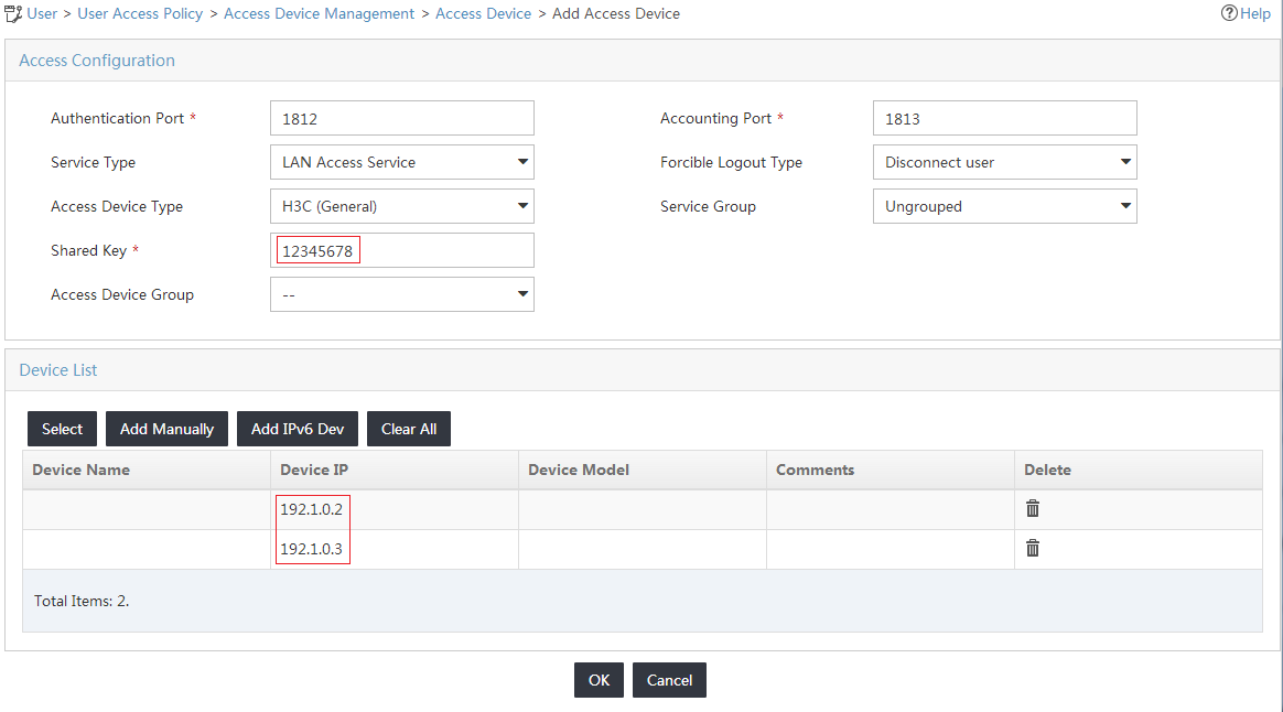

Configuring the RADIUS server
NOTE: In this example, the RADIUS server runs on iMC PLAT 7.2 (E0403P06) and iMC EIA 7.2 (E0409). |

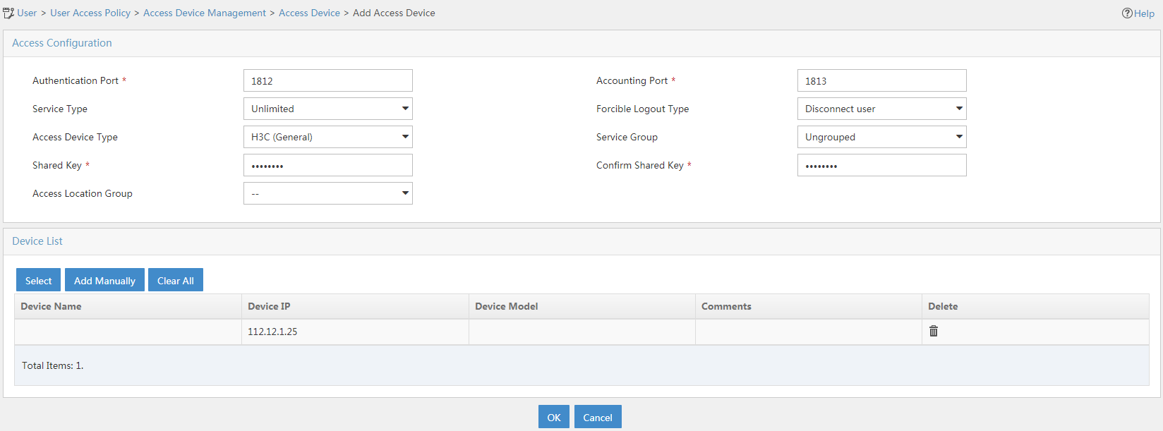

1. Add the ACs to the IMC Platform as access devices:
a. Log in to IMC.
b. Click the User tab.
c. From the navigation tree, select User Access Policy > Access Device Management > Access Device.
d. Click Add to add AC 1 as an access device.
e. Configure the following parameters:
- Enter 192.1.0.2 for AC 1 and 192.1.0.3 for AC 2 in the Device IP field.
- Enter 12345678 in the Shared Key field.
- Use the default settings for other parameters.
f. Click OK.
g. Use the same procedure to add AC 2 as an access device.
Figure 2 Adding an access device

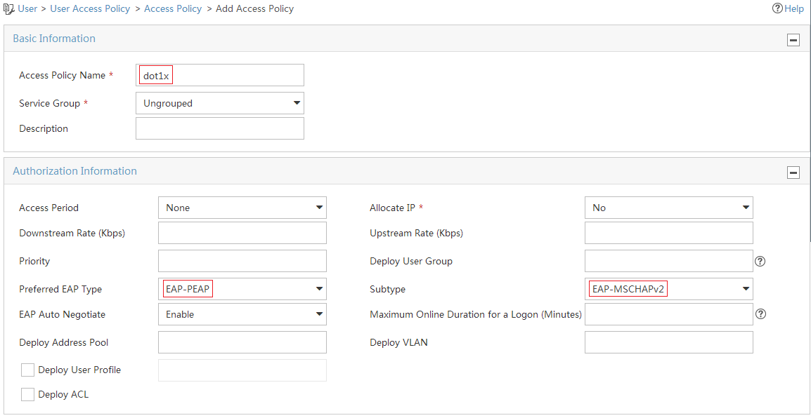

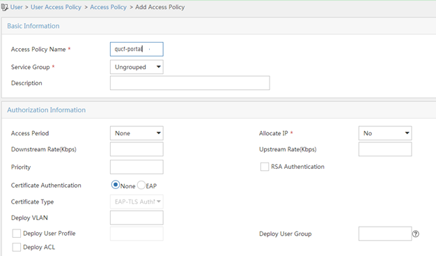

2. Add an access policy:
a. Click the User tab.
b. From the navigation tree, select User Access Policy > Access Policy.
c. Click Add to add an access policy that uses the following settings:
- Access Policy Name—dot1x.
- Preferred EAP Type—EAP-PEAP.
- Subtype—EAP-MSCHAPv2. The subtype must match the client authentication method.
Figure 3 Adding an access policy

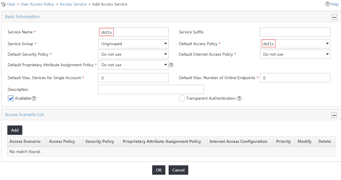

3. Add an access service:
b. From the navigation tree, select User Access Policy > Access Service.
c. Click Add to add an access service that uses the following settings:
- Service Name—dot1x.
- Default Access Policy—dot1x.
Figure 4 Adding an access service

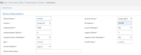

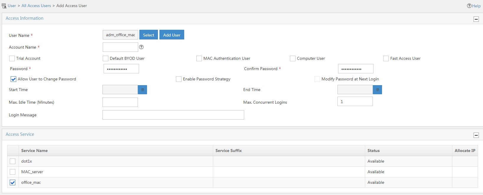

4. Add an access user:
b. From the navigation tree, select All Access Users.
c. Click Add to add an access user that uses the following settings:
- User Name—user.
- Account Name—dot1x.
- Password—dot1x.
d. Select the dot1x service for the user.
Figure 5 Adding an access user

# Enable the client to roam to AP 2.
# On AC 2, verify that the client is associated with AP 2.
<AC2> display wlan client verbose
Total number of clients: 1
MAC address : 0015-00ba-0428
IPv4 address : 192.2.0.3
IPv6 address : N/A
Username : dot1x
AID : 1
AP ID : 1
AP name : ap2
Radio ID : 1
SSID : service
BSSID : 5860-ba71-3960
VLAN ID : 200
Sleep count : 0
Wireless mode : 802.11ac
Channel bandwidth : 40MHz
SM power save : Disabled
Short GI for 20MHz : Supported
Short GI for 40MHz : Supported
STBC RX capability : Supported
STBC TX capability : Not supported
LDPC RX capability : Not supported
Block Ack : N/A
Supported HT MCS set : 0, 1, 2, 3, 4, 5, 6, 7,
8, 9, 10, 11, 12, 13, 14,
15
Supported rates : 6, 9, 12, 18, 24, 36,
48, 54 Mbps
QoS mode : WMM
Listen interval : 250
RSSI : 0
Rx/Tx rate : 0/0
Authentication method : Open system
Security mode : RSN
AKM mode : 802.1X
Cipher suite : CCMP
User authentication mode : 802.1X
Authorization ACL ID : N/A
Authorization user profile : N/A
Roam status : Inter-AC roam
Key derivation : SHA1
PMF status : N/A
Forwarding policy name : N/A
Online time : 0days 0hours 0minutes 17seconds
FT status : Inactive
